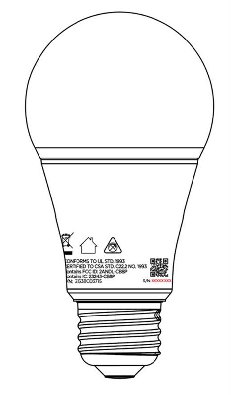

CB8P module and pin mapping for Lenovo bulb #4 21039718 10 Apr 2024 07:55 divadiow divadiow Level 38 Posts: 5195 Help: 446 Rate: 913 Helpful post? (0) CB8P module and pin mapping for Lenovo bulb Post #4 21039718 10 Apr 2024 07:55 https://github.com/OpenBekenIOT/webapp/pull/96 first CB8P module in the device list. Code: JSONLog in, to see the code Code: JSONLog in, to see the code

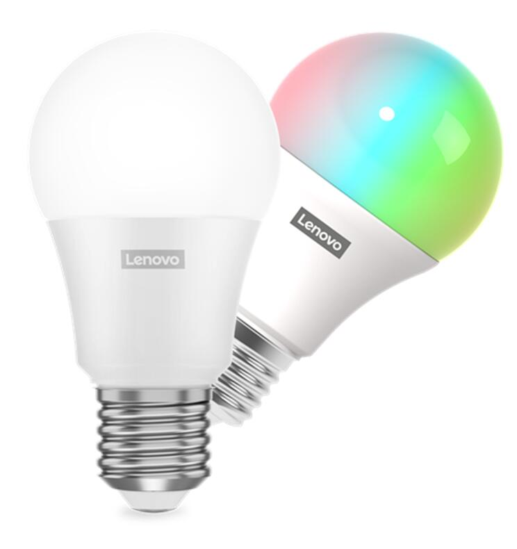

Questioning whether Lenovo Link is just a Tuya reskin #5 21040273 10 Apr 2024 15:55 p.kaczmarek2 p.kaczmarek2 Moderator Smart Home Posts: 14743 Help: 659 Rate: 12839 Helpful post? (+1) Questioning whether Lenovo Link is just a Tuya reskin Post #5 21040273 10 Apr 2024 15:55 Thank you, I've accepted your PR: https://github.com/OpenBekenIOT/webapp/commit/dfd267b558f512e8ef534352418cb3fb307e45e8 We should get soon to 552 devices here: https://openbekeniot.github.io/webapp/devicesList.html Out of curiosity, is this bulb similiar to that one here: https://www.lenovo.com/us/en/p/smart-devices/...rgRef=https%253A%252F%252Fwww.google.com%252F So it's basically Tuya bulb but with Lenovo logo? What is "Lenovo Link App"? Is it just yet another Tuya reskin? I am creating multiplatform open source firmware (Tasmota replacement), right now supporting BK7231T, BK7231N, XR809, BL602, W800, W600, LN882H and soon supporting RTL and W701: https://github.com/openshwprojects/OpenBK7231T If you like my work, support me at: https://paypal.me/openshwprojects Helpful post? Buy me a coffee.
