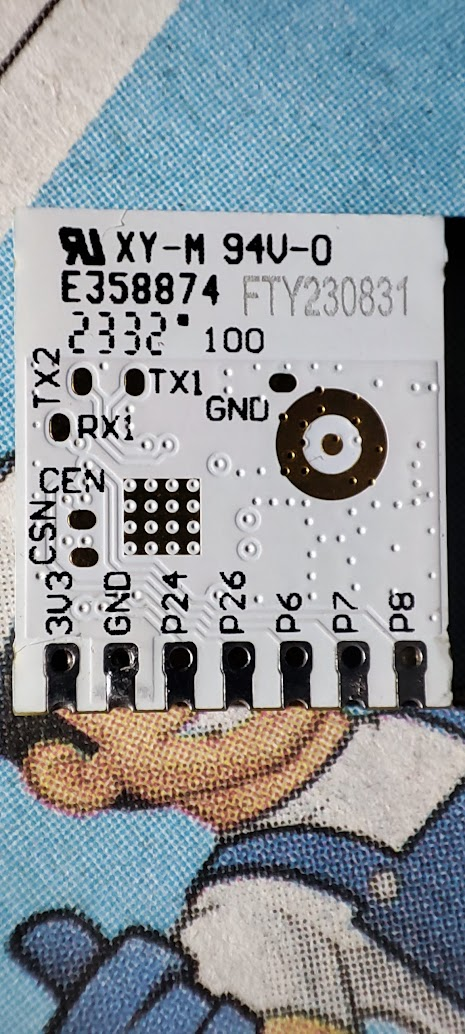

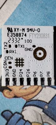

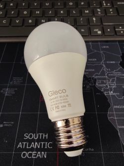

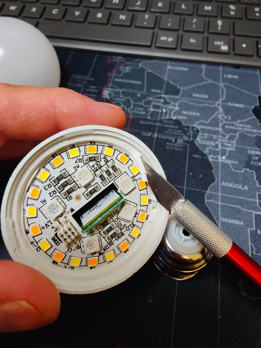

    I recently ordered some smart bulbs from AliExpress: https://www.aliexpress.com/item/1005005481268886.html
    The brand is Gleco.
    Smart Bulb 15W RGB+2700~6500K
    AC 85-265V 50/60Hz
    It seems they're pretty straightforward to work with. They have the CB2L module.
    P6 PWM 3
    P7 PWM 2
    P8 PWM 1
    P24 PWM 5
    P26 PWM 4
    Gleco smart bulb lying on a world map, with a keyboard in the background. Gleco smart bulb with visible LED diodes and circuit board. Close-up of the interior of a smart bulb with electronic components.
    I wrote an article on my blog about it:
    https://cheriches.com/smart-home/2023-10-07-the-anatomy-of-a-smart-bulb.html

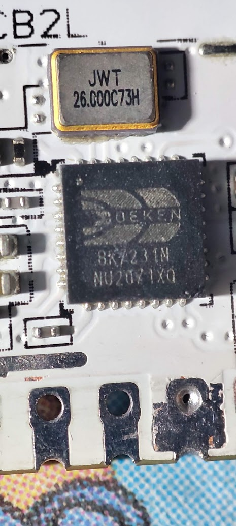

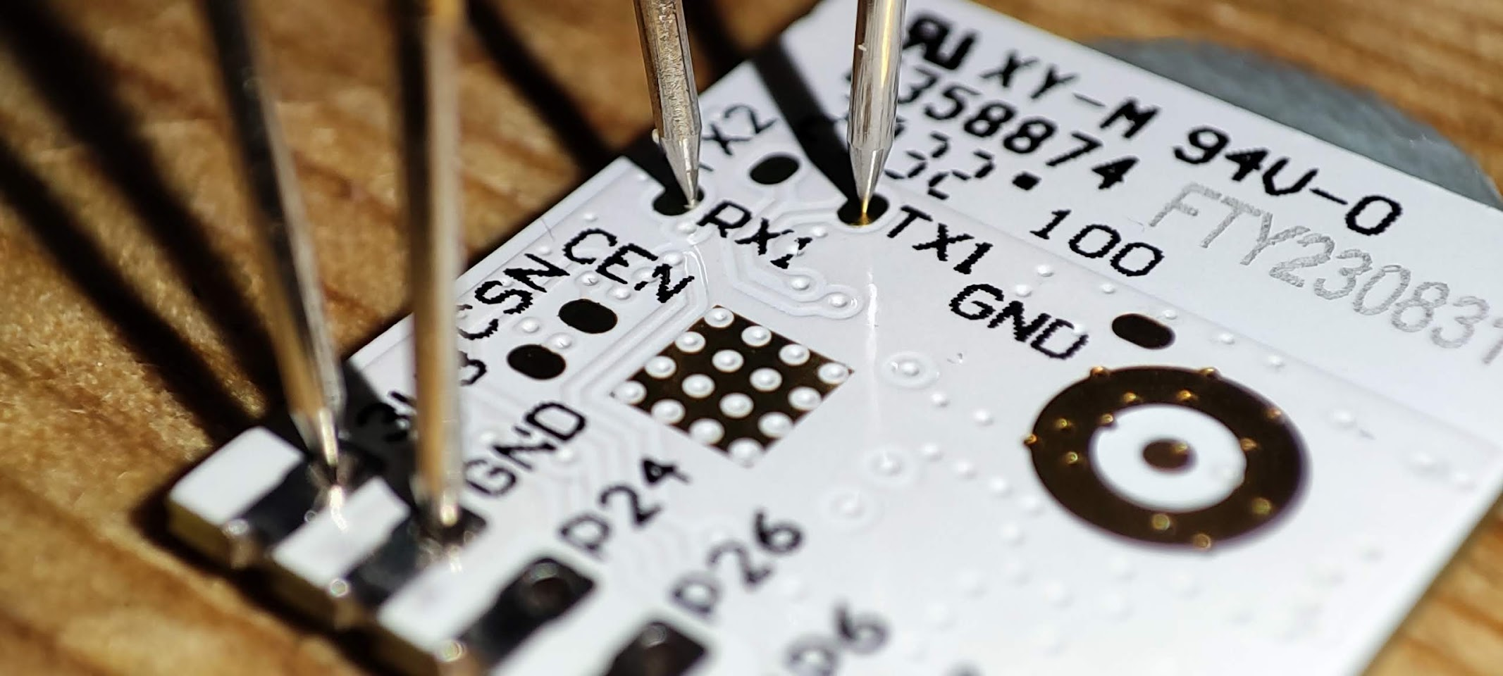

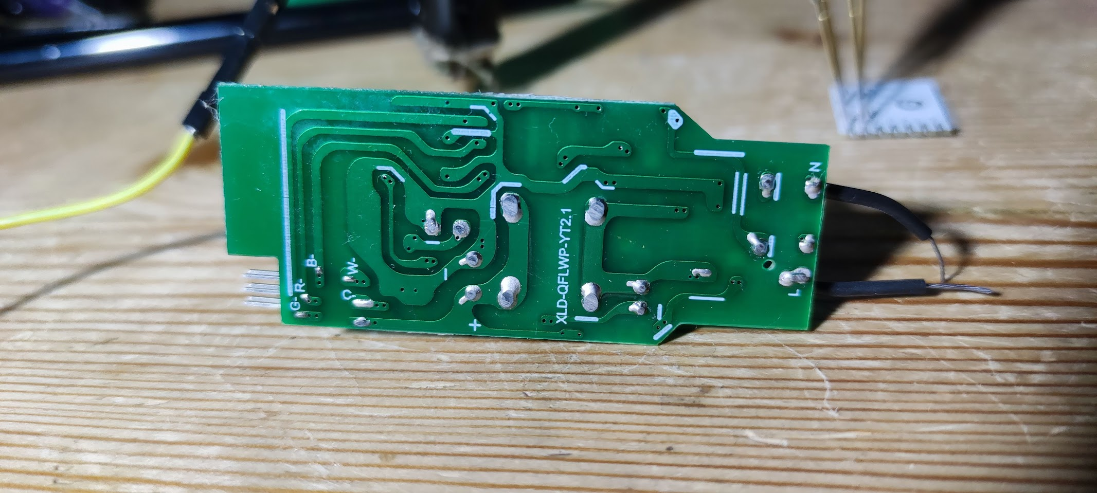

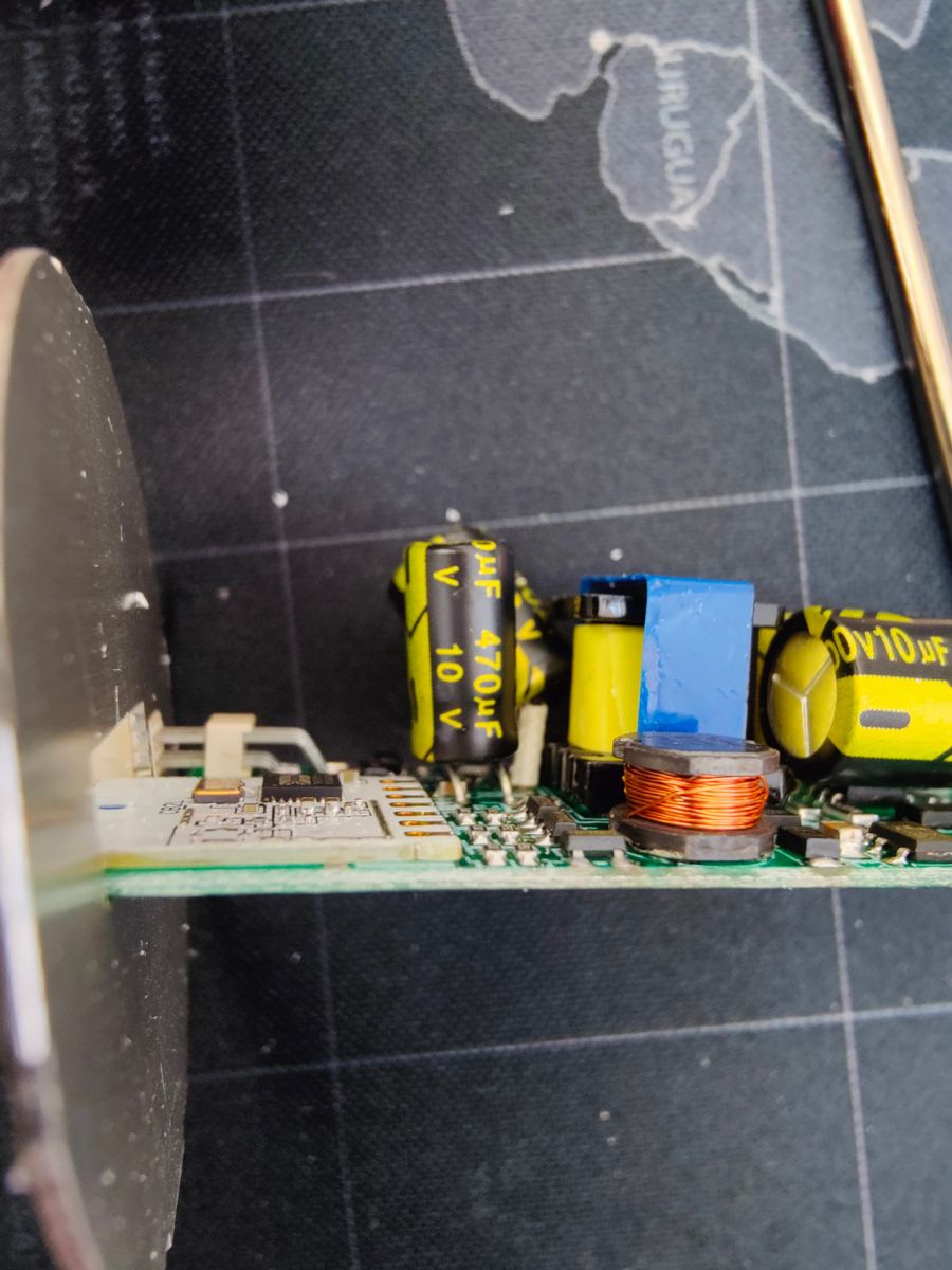

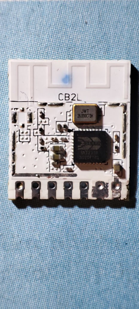

    I have exactly the same bulb. I've managed to unsolder but not yet braved re-soldering.
    my dump and info
    - LED Green (Channel 2) on P7
    - LED Cool (Channel 4) on P26
    - LED Blue (Channel 3) on P6
    - TODOpwmhz
    - LED Red (Channel 1) on P8
    Device seems to be using CB2L module, which is using BK7231N.
    Close-up of a circuit board with probes attached.
    CB2L electronic module on fabric background. Close-up of an electronic module with various markings, pin numbers, and connectors on the circuit board. Close-up of a circuit board featuring the BK7231N chip.
    Close-up of a green PCB with markings and electrical traces. Image of a printed circuit board with electronic components on a wooden table.
    I'm following that same video for tips https://www.youtube.com/watch?v=2e1SUQNMrgY

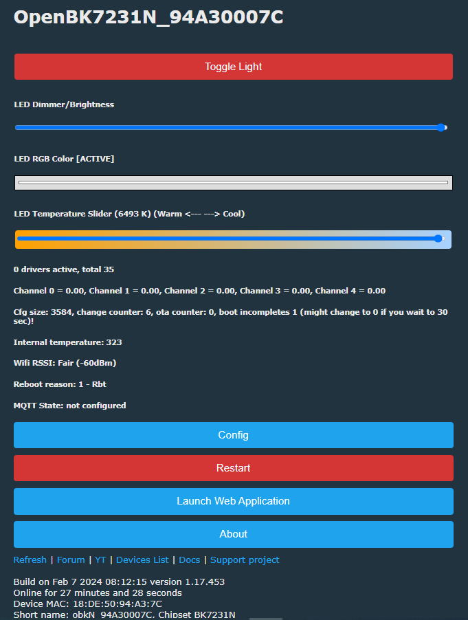

    finally came back to this bulb. I had soldered it back on and it didn't work, so got annoyed and left it for a couple of months.
    I resoldered it today and removed two capacitors closest to the CB2L to check solder hadn't dribbled everywhere. a good clean, resolder and a cautious power-on saw it connect to my network!
    Screenshot of the OpenBK7231N user interface with various LED lighting control options.

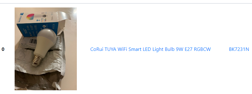

    @synergy4489elektroda where did you get P24 PWM 5 from? If I analyse my bin in BK Easy Flash I get this output
    - PWM Frequency5000
    I only see 1 other device with a matching template in the device list
    CoRui TUYA WiFi Smart LED light bulb with packaging in the background
    PR to add to device list https://github.com/OpenBekenIOT/webapp/pull/7...mits/3c46208e4ce46c99ac81e6ed620e95ea2e7ca8a7
