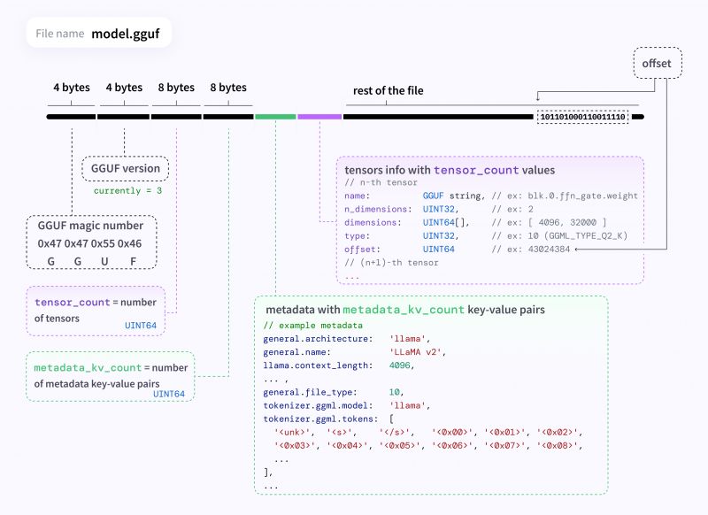

    Let's start with considering what is GGUF.
    GGUF, which stands for GPT-Generated Unified Format, is a successor to GGML (GPT-Generated Model Language) format, released on 21st August 2023. GGUF is a file format used to store GPT-like models for inference. GGUF models can run on both GPU and CPU, and provides extensibility, stability and versatility.
    Diagram of GGUF file structure showing section breakdown and example metadata.
    Details about GGUF can be found on Hugging Face site.

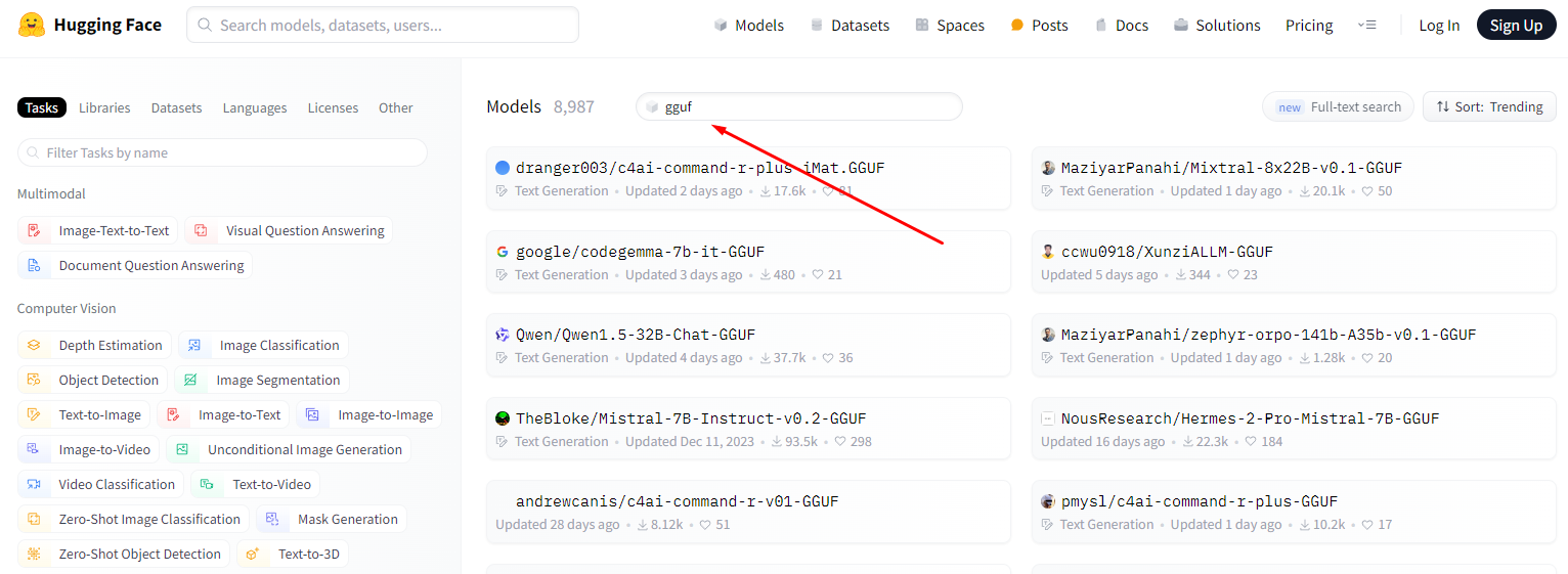

    So first, you will need a GGUF model.
    Go to https://huggingface.co/models and browse the models for download.
    Not all models are available in GGUF. So, filter entries by GGUF:
    Screenshot of Hugging Face website with GGUF model search.

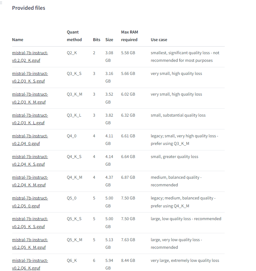

    For example, let's download TheBloke/Mistral-7B-Instruct-v0.2-GGUF
    Screenshot of the Mistral-7B-Instruct model file list.

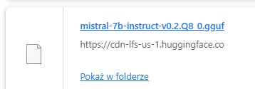

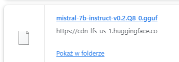

    I've chosen mistral-7b-instruct-v0.2.Q8_0.gguf version.
    Downloading the model mistral-7b-instruct-v0.2.Q8_0.gguf at 10.3 MB/s, 12 minutes remaining.
    Wait for the download to finish:
    Screenshot showing a downloaded GGUF model file named mistral-7b-instruct-v0.2.Q8_0.gguf.

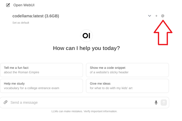

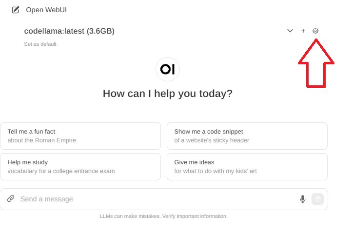

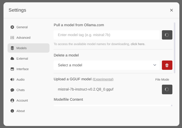

    Now, enter the settings, you will now need to upload the model you've downloaded.
    Screenshot of Open WebUI interface with codellama:latest model loaded.

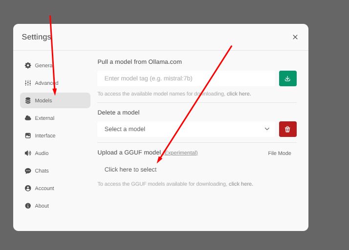

    In models section, find a GGUF upload form:
    Settings panel in Open-WebUI with options for managing GGUF models.

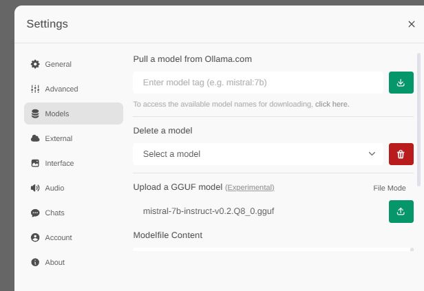

    Select the file you want to upload:
    Screenshot of the settings panel in the Open WebUI application with the Models tab selected.
    Now you need to be very patient. Don't close this page. There is currently no good progress report display.
    Screenshot of Open-WebUI settings with the option to upload a GGUF model selected.

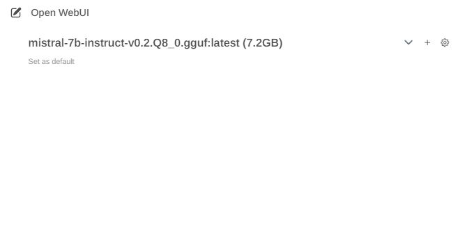

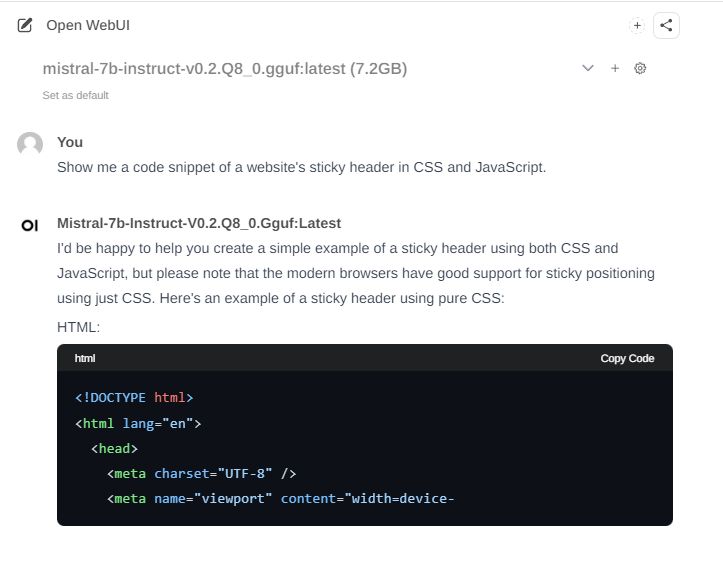

    Finally, once the import is done, you will be able to select new model on the main page:
    Open WebUI interface with loaded model mistral-7b-instruct-v0.2.Q8_0.gguf, size 7.2 GB
    Your model is now ready to run:
    Screenshot of Open WebUI displaying a conversation about creating a sticky website header using CSS and JavaScript.

  • #2 21592563
    jmchiejr
    After the upload completes, can I delete the downloaded file or is Ollama/OpenWebUI using the downloaded file in that location?
  • #3 21592605
    Posts: 14765
    Rate: 12899
    Ollama can't even access this file directly, it's uploaded (copied) there. You can remove the source file.
