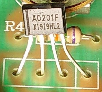

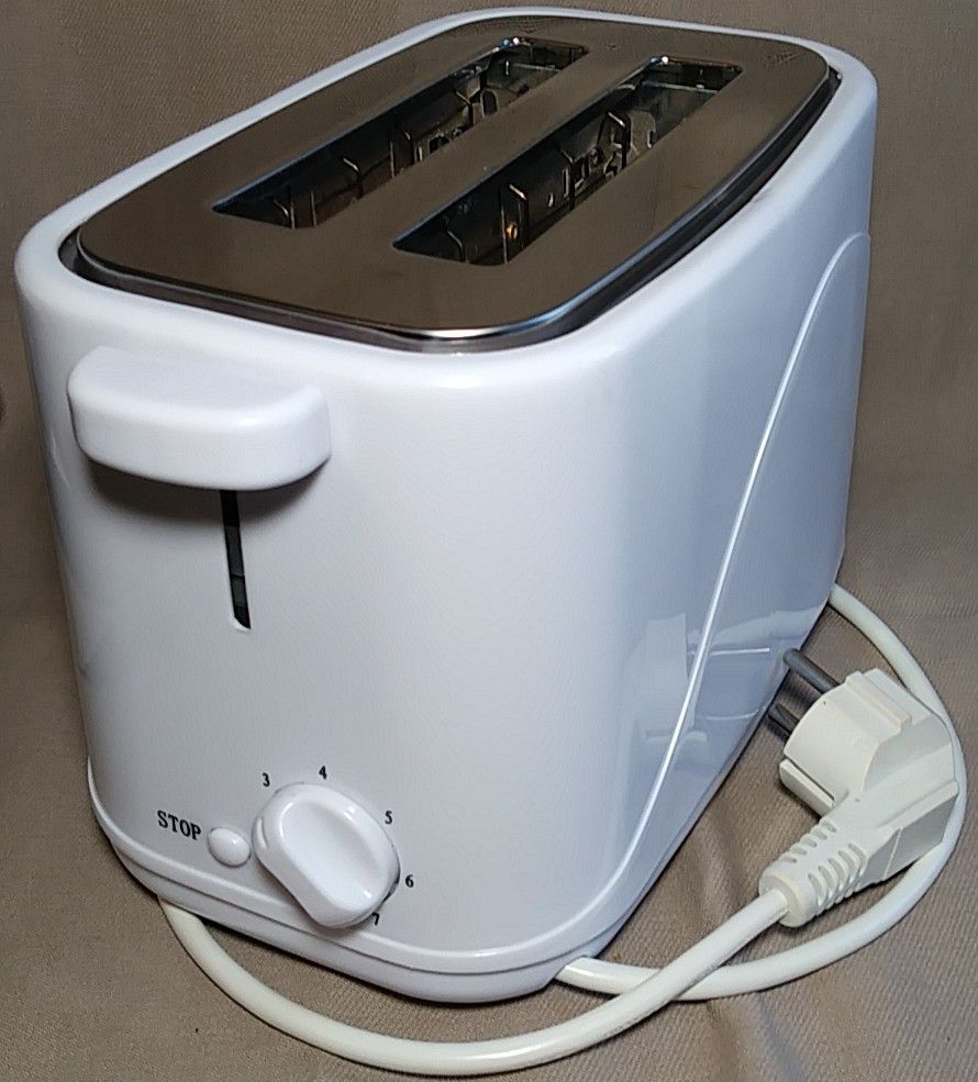

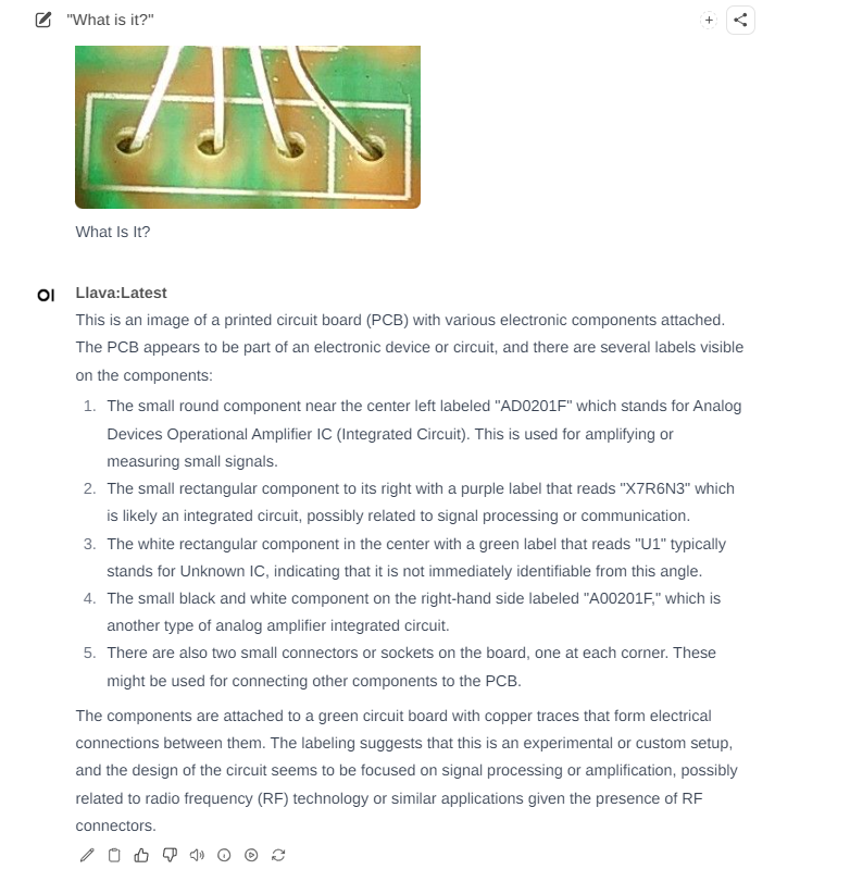

    If you want me to add an image to this model, please post the image in the topic, if I have a moment I will check the results.
    Something more difficult.
    Close-up of electronic components on a green circuit board, including an AO201F transistor and a resistor.
    Something easier.
    White toaster with two slots and a dial for toast browning control.
  • Image recognition misreads chip markings as ICs
    #4 21036590
    Posts: 14765
    Rate: 12899
    Before checking, I will write down my prediction: it will cope with the toaster, not so much with the chip, in the case of the chip it will read the marking incorrectly and write something about the IC.
    Checking:
    White toaster on a surface with two slots and a dial for adjustment.
    As I thought, the second one:
    Close-up of a printed circuit board (PCB) with several electronic components and descriptions.
    Also as expected, but even read well, AD0201F.
    Any other pictures I can check?

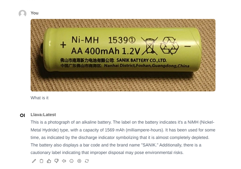

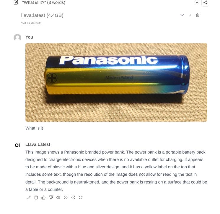

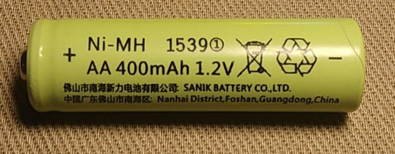

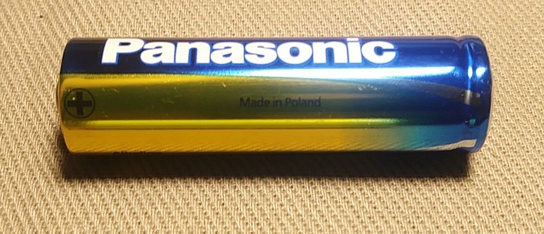

    Especially for my friend, at the same time deliberately not very sophisticated except for the last one.
    Panasonic battery on a beige background with the text Made in Poland. AA Ni-MH 400mAh 1.2V battery on a fabric background. Molex power connector with four cables against a fabric background. Close-up of a 24-pin ATX connector on a fabric background. Two-prong electrical plug on textile material.
  • OCR misreads battery labels and connectors
    #6 21036871
    Posts: 14765
    Rate: 12899
    Battery, a bit weak, read "Panasonic" but made heresy powerbank:
    Close-up of a Panasonic battery on a neutral surface.
    Here again sense and nonsense are mixed (he read 1539 as 1569 but converted it into a capacity), but he also read NiMH and SANIK...
    SANIK NiMH rechargeable battery with 400 mAh capacity and 1.2 V voltage

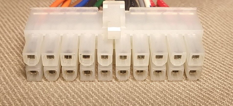

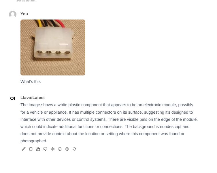

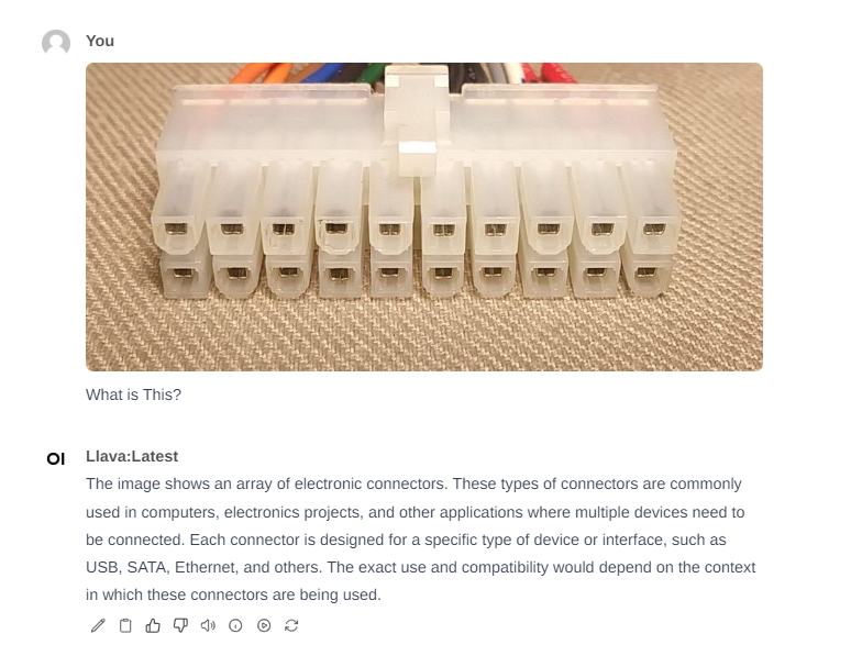

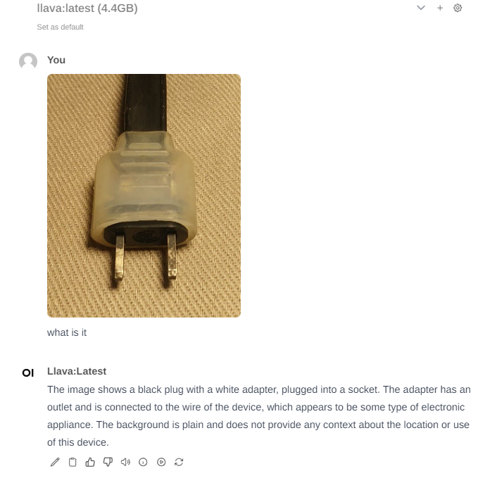

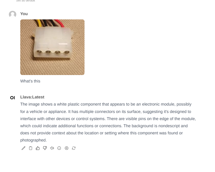

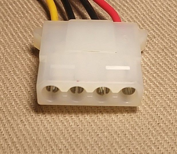

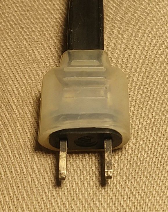

    Next are the connectors, but I know they weren`t in the training data, so we won`t discover anything new:
    The image shows a white plastic component with several wires, likely a Molex connector used in electronics.
    Image of a set of electronic connectors in a multi-pin plug.
    Black plug with a white adapter, plugged into a socket.

    Next are the connectors, but I know they were not in the training data...
    Do we have these connectors added at this point?
    How is this "training" and adding further data performed?

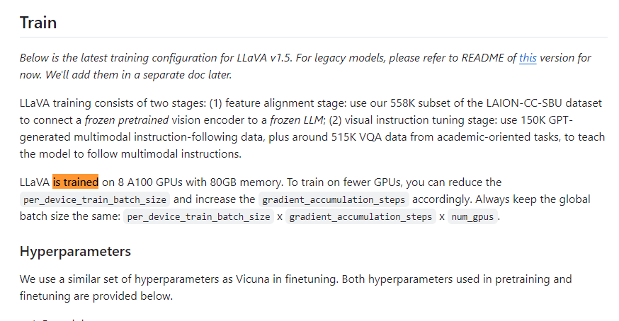

    I see that a topic about the basics of LLM in general will be useful...
    A typical user is not able to train LLM, it requires enormous computing power and a huge number of teaching examples. You can read about teaching LLaVa here:
    ChatGPT locally? AI/LLM assistants to run on your computer - download and installation
    https://github.com/haotian-liu/LLaVA
    🔥[NEW!] LLaVA-1.5 achieves SoTA on 11 benchmarks, with just simple modifications to the original LLaVA, utilizes all public data, completes training in ~1 day on a single 8-A100 node, and surpasses methods that use billion-scale date.
    https://llava-vl.github.io/
    Additionally, training requires a huge amount of well-described training data, for example:
    https://huggingface.co/datasets/liuhaotian/LLaVA-Instruct-150K/viewer?row=0
    Rather, typical users are forced to download already trained models if they are made available.
    LLM also no longer studies while talking to him. LLM is a mechanism like a "mathematical function", you simply provide an image and text as input, and the output is an answer, LLM does not "remember" other conversations you have had with it. What I have is a model trained by others and made available for free, which I only run locally with different inputs. The only thing LLM "remembers" is the course of the current conversation as long as it fits in the context window.

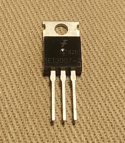

    AND.
    Isn`t it the case that properly selected training examples require a small amount of computing power that is within the capabilities of even a relatively weak home computer? I am thinking of cases such as a transistor in a popular housing photographed in an appropriate way. Generally, the matter comes down to analyzing the shape of a geometric figure?
    I am attaching an example image.
    Transistor in a TO-220 package with three legs, on a fabric background.
    B
    Isn`t there, therefore, a function of sending ready-made results of studies made by individual users to the "cloud", so to speak?
  • Fine-tuning requires image-text training examples
    #10 21037579
    Posts: 14765
    Rate: 12899

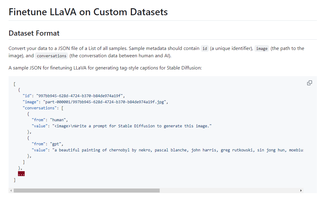

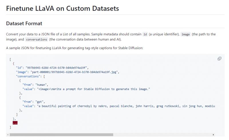

    It doesn`t work like that at all, the process you are asking about is called fine-tuning and it involves providing additional teaching examples in the format of a photo and text description.
    Snippet of documentation on dataset format for fine-tuning the LLaVA model
    You would have to have, for example, a dataset of transistors.
    Source:
    https://github.com/haotian-liu/LLaVA/blob/main/docs/Finetune_Custom_Data.md
