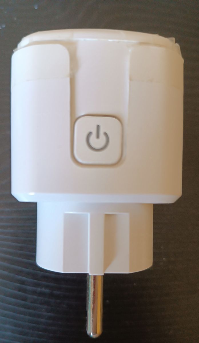

How to Open a Tuya LSPA9 WiFi Smart Plug Without Damaging It?

    I've added plug model name to the title. It's LSPA9 plug I think. They come in variety of types, I had ESP8266-based LSPA9, and CB2S-based and WB2S-based as well. They are sometimes glued well.

    >>21068283
    I managed to open the plug, but how do I put it together again?
    I can glue it together, but then re-opening it may be cause a problem.
    Is there any recommendation on fixing this?

    Are you referring to LSPA9-style model, like shown in this topic?
    Well, as far as I know, there is no other method than a little glue... just a little drop of glue. Not more.
    Those devices are cheap and they capacitors may fail, so be prepared... fix is quick and easy, but do not glue it permanently.
    Also make sure to use PowerSave 1 in OBK.
