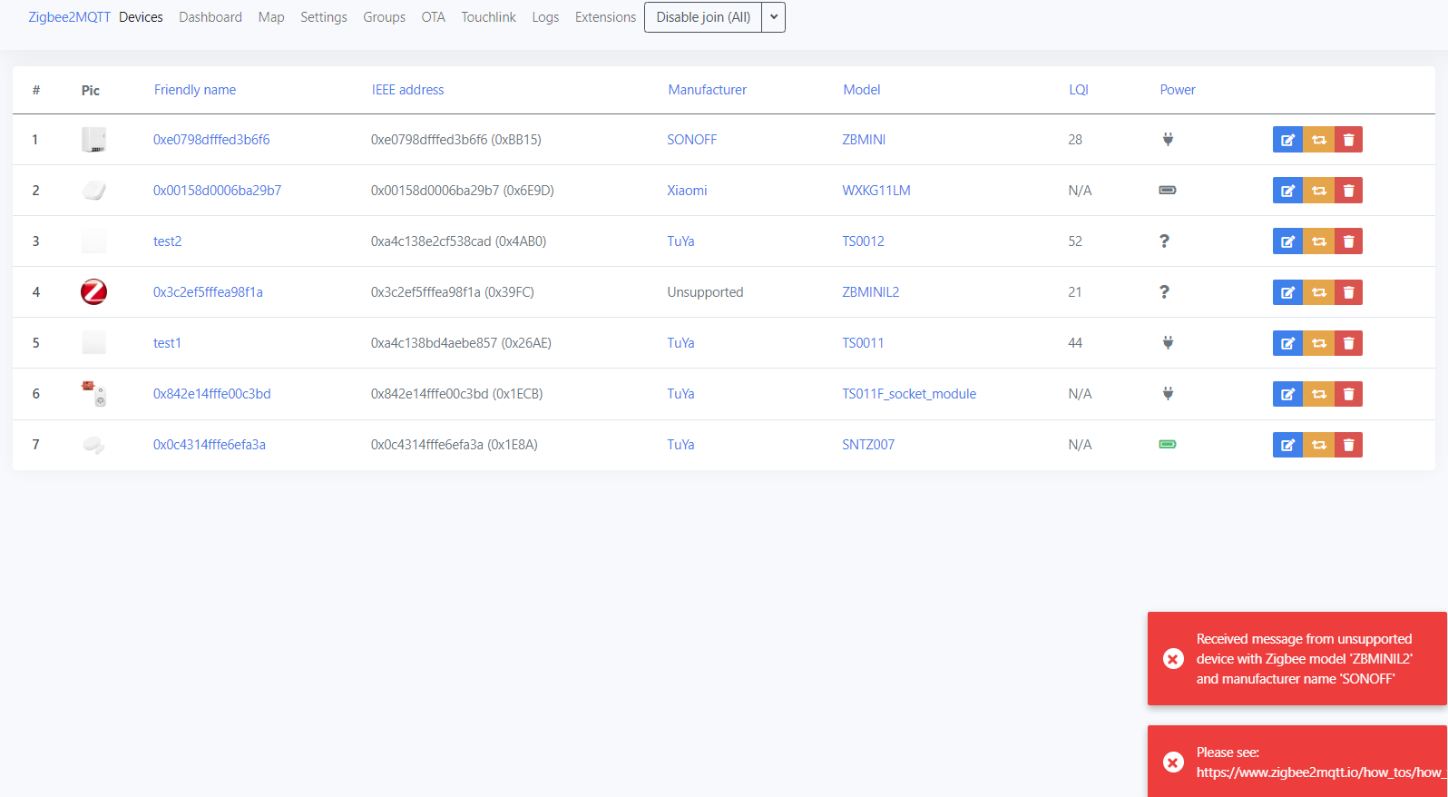

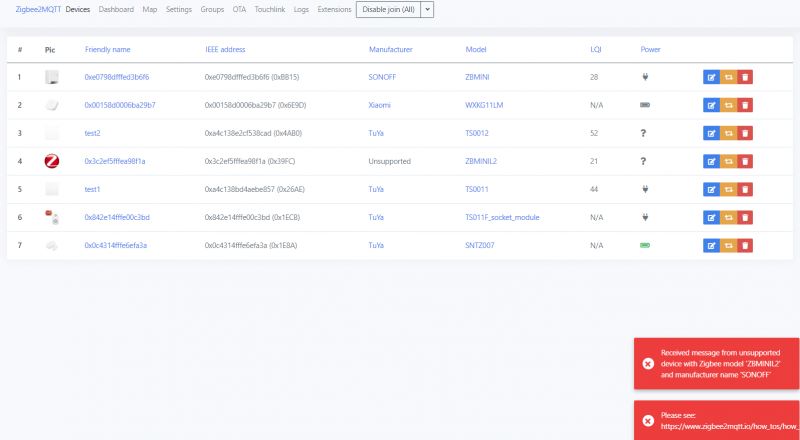

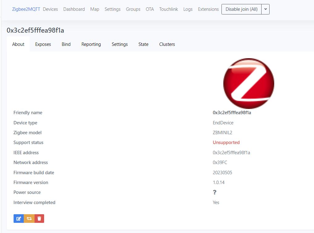

    I have been recently trying to add a new Zigbee device to HA and realized that my HA shows it as "unsupported", even while it's marked as "supported" on official site:
    Screenshot showing a list of Zigbee devices in the Zigbee2MQTT panel.
    The error message:
    Received message from unsupported device with Zigbee model [model] and manufacturer name
    Means that your version of plugin does not support it, but you can clearly check online if the newer one has added support:
    https://www.zigbee2mqtt.io/devices/ZBMINIL2.html
    Screenshot of Zigbee2MQTT panel showing an unsupported device.

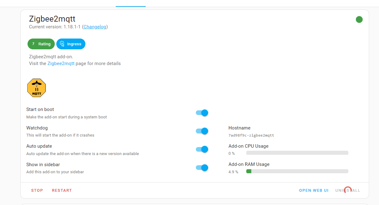

    In my case I had old version, barely 1.18.1-1:
    Zigbee2MQTT add-on management panel in Home Assistant.

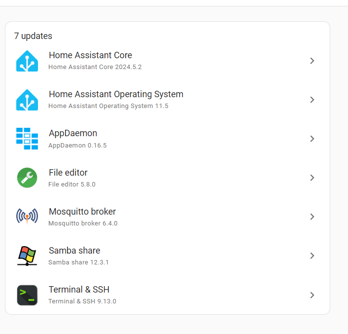

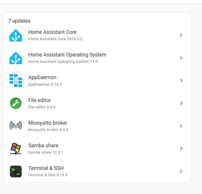

    At first I went to the usual "updates" menu, hoping that I can do update automatically:
    List of available updates for Home Assistant.
    I've applied all updates, but Zigbee2MQTT still stayed old.

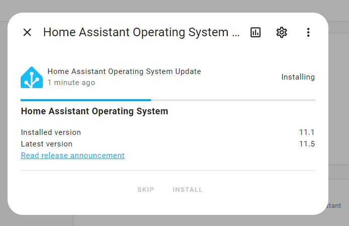

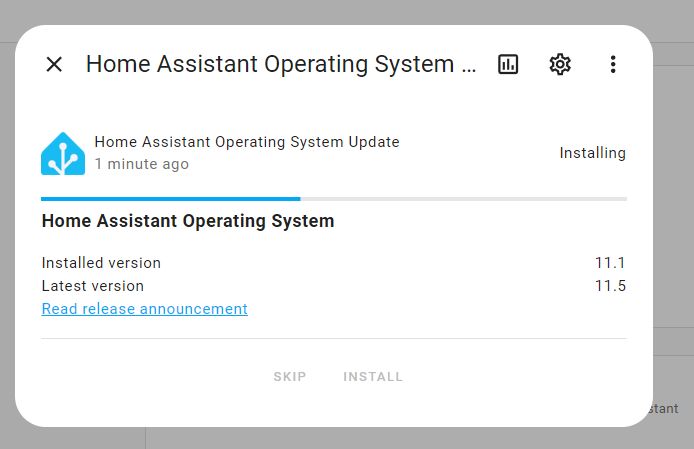

    Home Assistant itself got easily updated to latest version:
    Screenshot of Home Assistant Operating System update

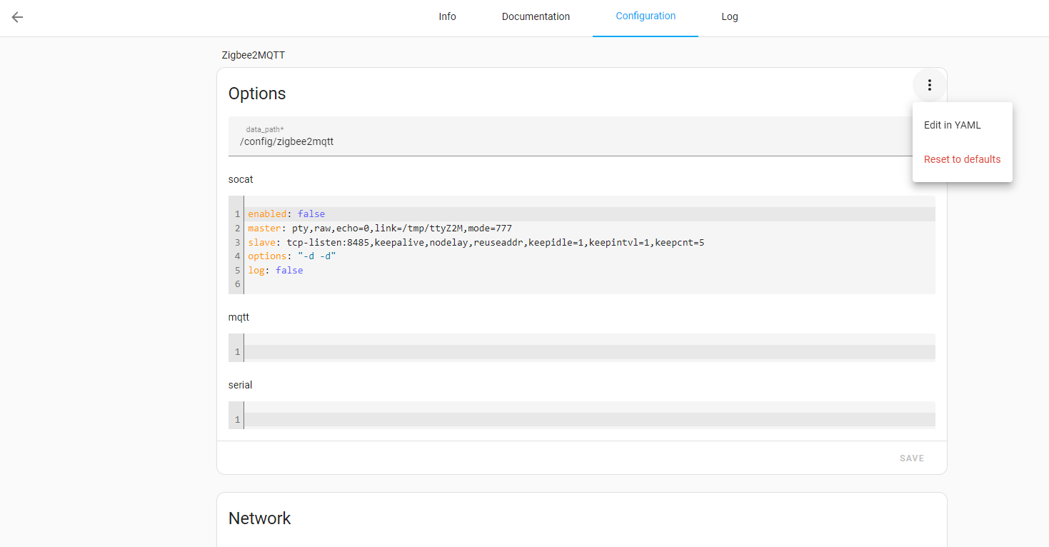

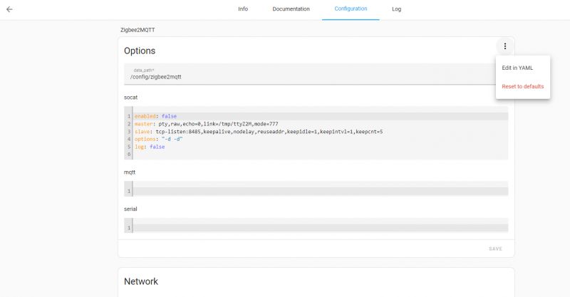

    The next thing I tried was first copying my configuration yaml from Zigbee2MQTT, and then uninstalling it (just to install it later). To copy configuration, select YAML here:
    Screenshot of Zigbee2MQTT configuration in Home Assistant with YAML editing
    Yaml code can be just copied to a text file to make a backup.

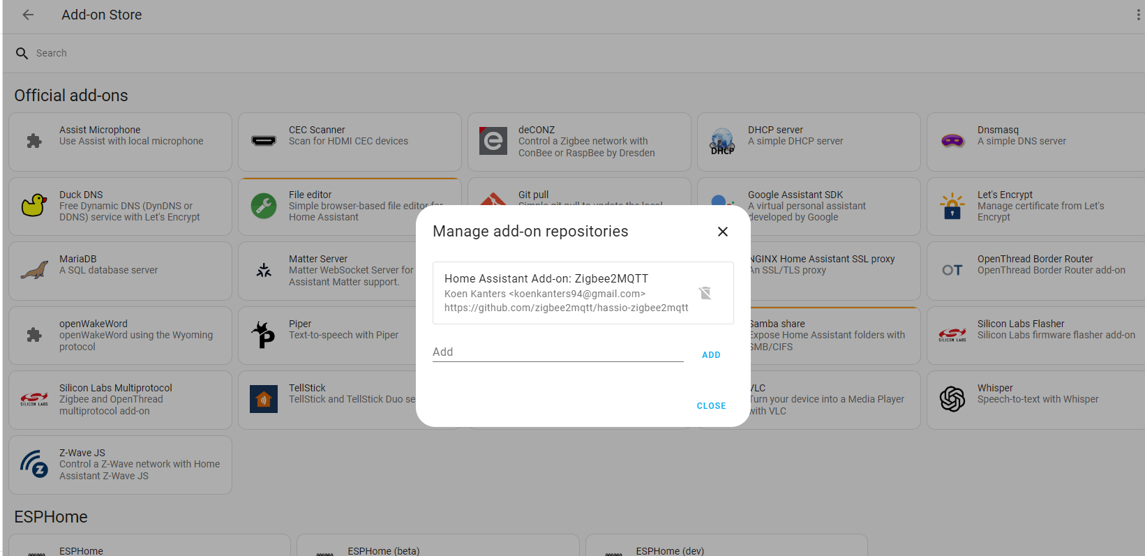

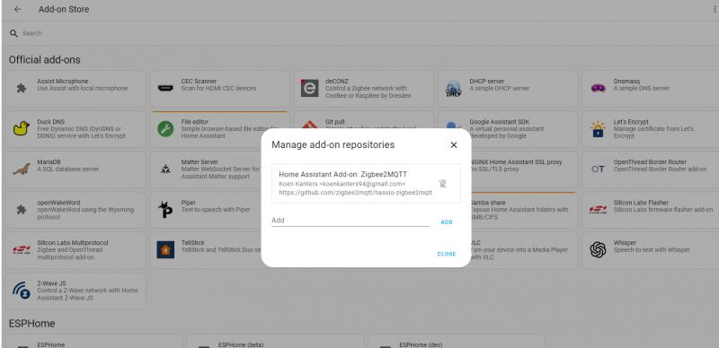

    To update, you need to remove the Add-on repository from addon repositories here:
    Screenshot of the add-on repositories management panel in Home Assistant.
    Then readd it again:
    https://github.com/zigbee2mqtt/hassio-zigbee2mqtt

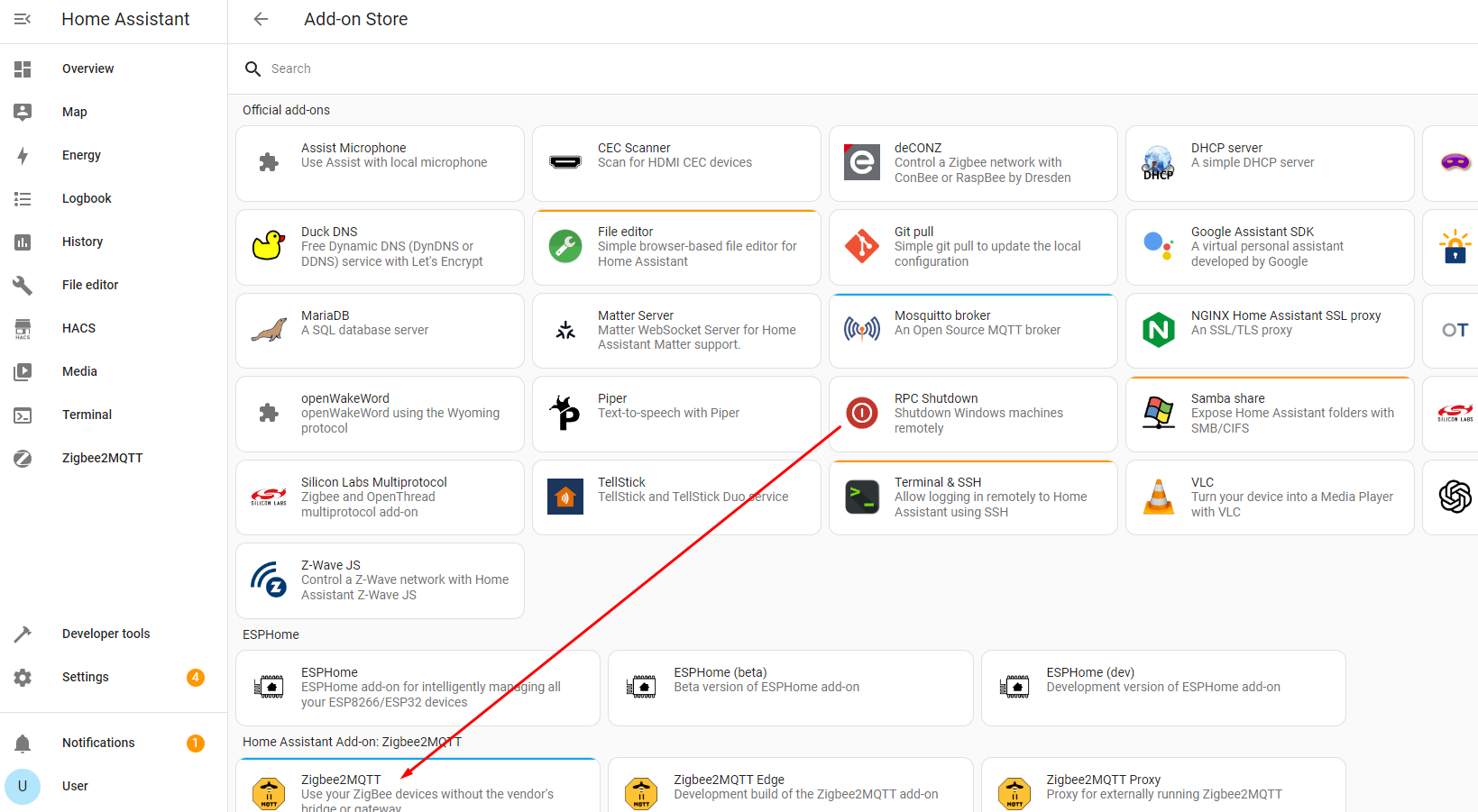

    and then, finally, install zigbee2mqtt from the list:
    View of the Home Assistant panel with the Add-on Store open, highlighting Zigbee2MQTT.

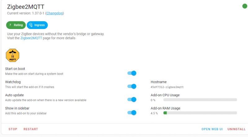

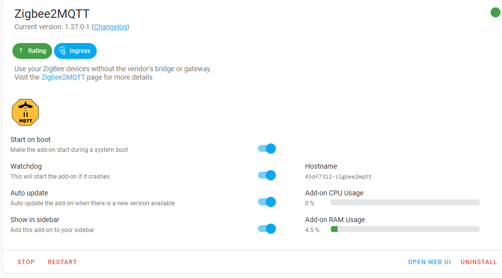

    Then, finally, I got the new version of the plugin:
    Zigbee2MQTT add-on interface in Home Assistant.

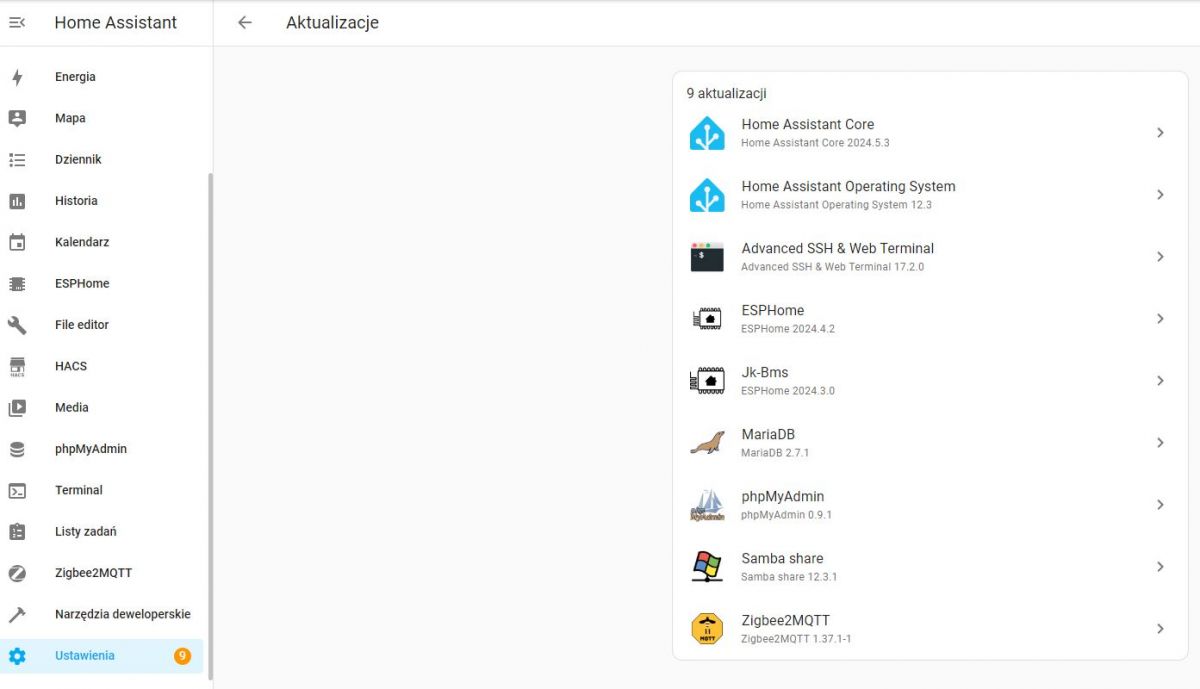

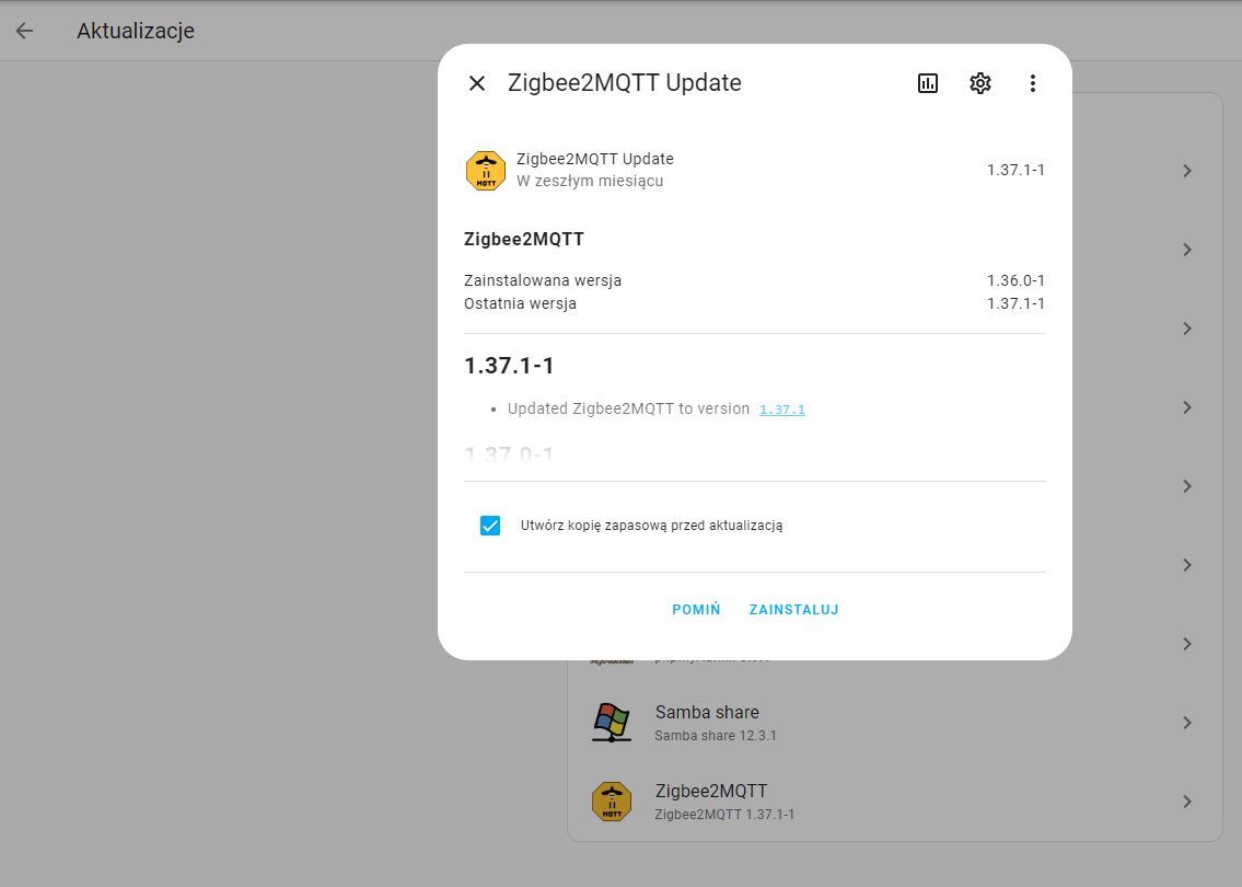

    With me it has always been
    Home Assistant update interface with a list of 9 available updates.
    Zigbee2MQTT update window in a system showing new software versions. .

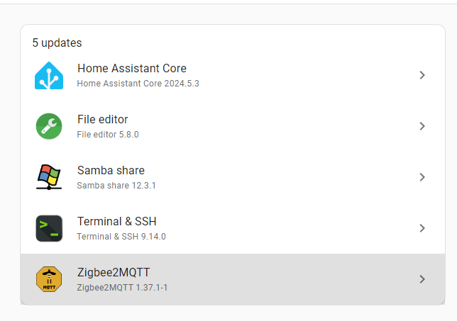

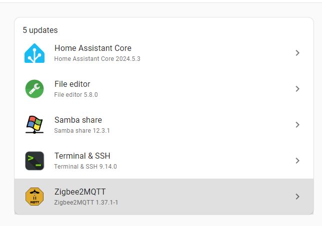

  • #3 21079683
    Posts: 14615
    Help: 655
    Rate: 12632
    They must have added this some time ago, because now I have it too:
    Software updates list with five items: Home Assistant Core, File editor, Samba share, Terminal & SSH, Zigbee2MQTT.
    Older versions you can't update this way, you have to do for them as in the article.
