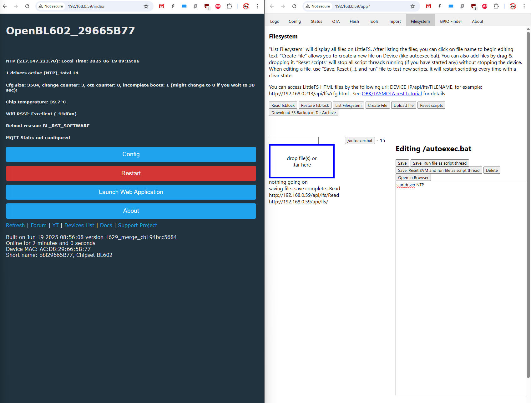

    Why is BL602 LFS (LittleFS) missing in the current build and can it be implemented?

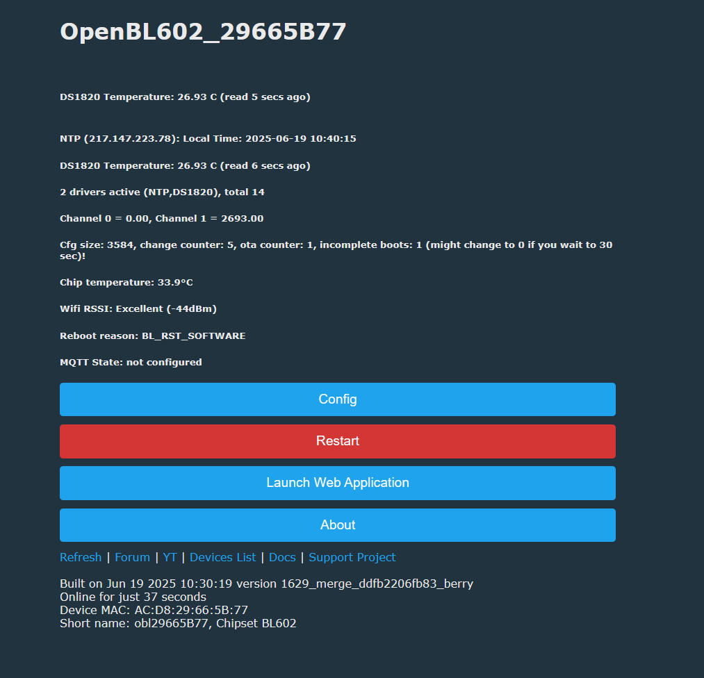

    DS18B20 works...
    Added after 13 [minutes]:
    >>21583624
    OTA to berry passes with the latest build

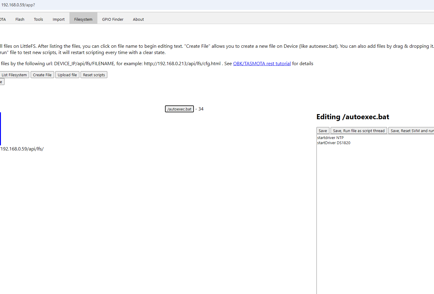

    LSF present/preserved and working

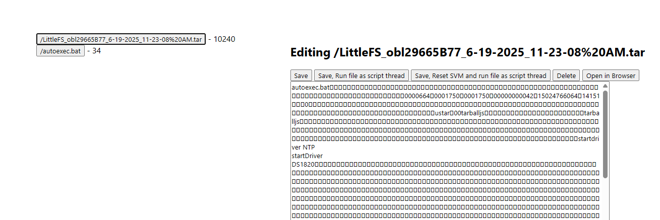

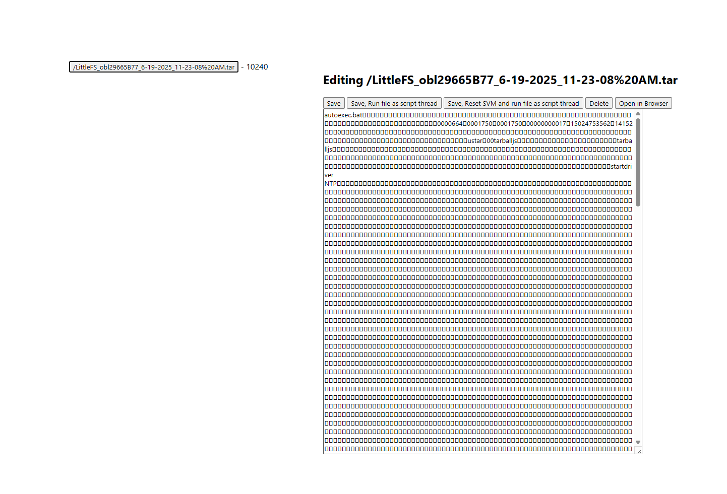

    LFS does work fine and is preserved after OTA, but backup import is broken, at least on BL602.
    Same file just downloaded and reimported as if tar parsing is now being done.
    Ok, that seems to be the problem in the webapp it self, I'll give it a check soon and report back.

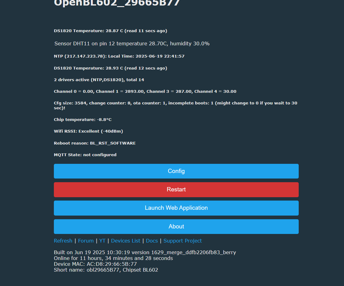

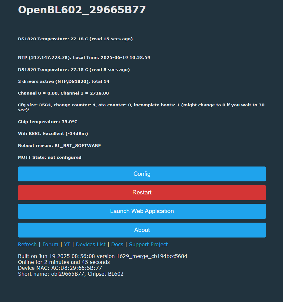

  • BL602 internal temperature tied to CH1 input
    #22 21584294
    DeDaMrAz
    Posts: 621
    Help: 34
    Rate: 130

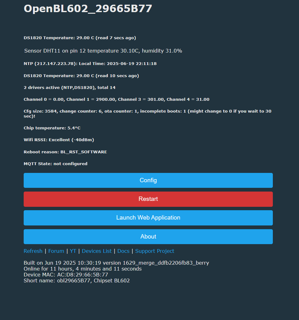

    DHT11 is working on BL602.
    Added after 35 [minutes]:
    @insmod
    Is internal temperature on BL602 now refreshed every second or maybe tied to CH1 somehow??
    I got these reading within seconds if DS was set on CH1
    If I move DS to ch2 it normalizes.

    >>21584294
    I did nothing to temperature sensor, and even then, there should be no correlation between channels and sensor.
    It's likely the same in release version.
  • #24 21584422
    Posts: 5236
    Help: 449
    Rate: 918
    I've definitely seen the behaviour @DeDaMrAz describes. I'd made the connection with the new SDK rather than any PR, but may be misremembering. I can check unless @DeDaMrAz does first.
