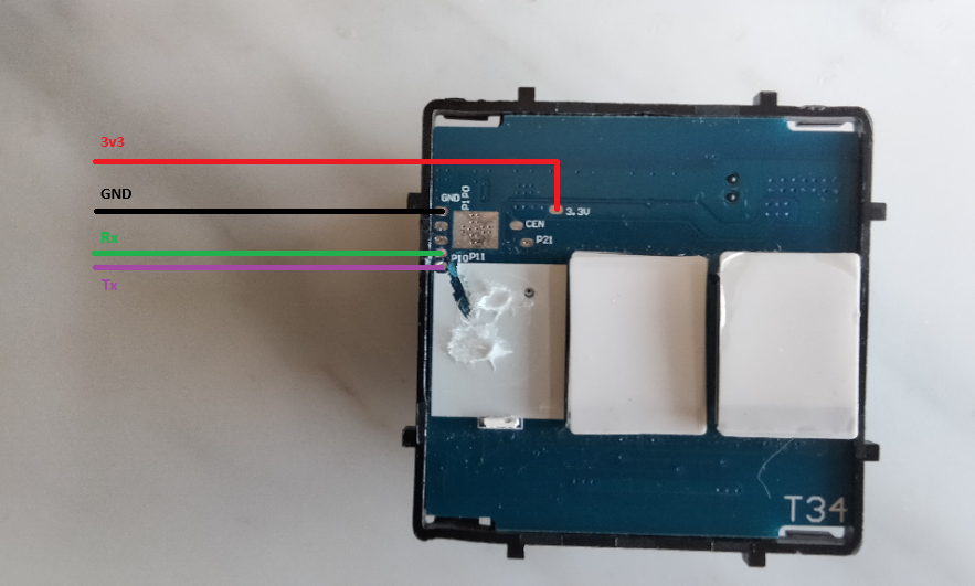

    techathome21
    Modern BSEED wall switch touch panel with three buttons.
    Image of a circuit board with labeled pins: 3V3, GND, Rx, and Tx.
    This is topic for 3Gang version, see 1 gang version here
    The image shows a 3G switch, but the pins are the same (1G, 2G, 3G, Curtain), above 1G you have to lift the button, it is glued, to access the Rx and Tx Pins (P10 P11).
    If you have issues, please swap Rx/Tx connections
    1. Open BK7231Flasher e select your com Port.
    2. Select your BIN file (BK7231N) and flash.
    3. When it shows that it's waitin for CEN, remove the 3,3V jumper cable and then reconnect. (without removing the TTL Serial adaptaer from USB)
    4. The flash should start and after about 20 secs it's finished.

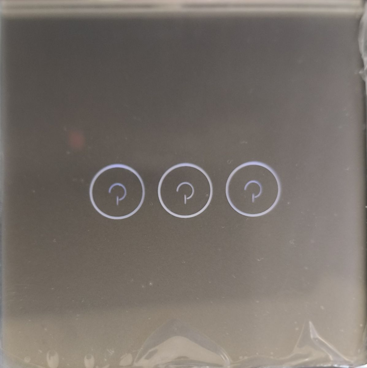

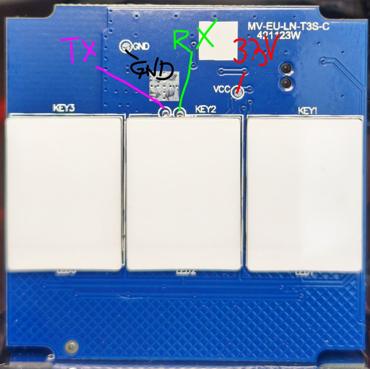

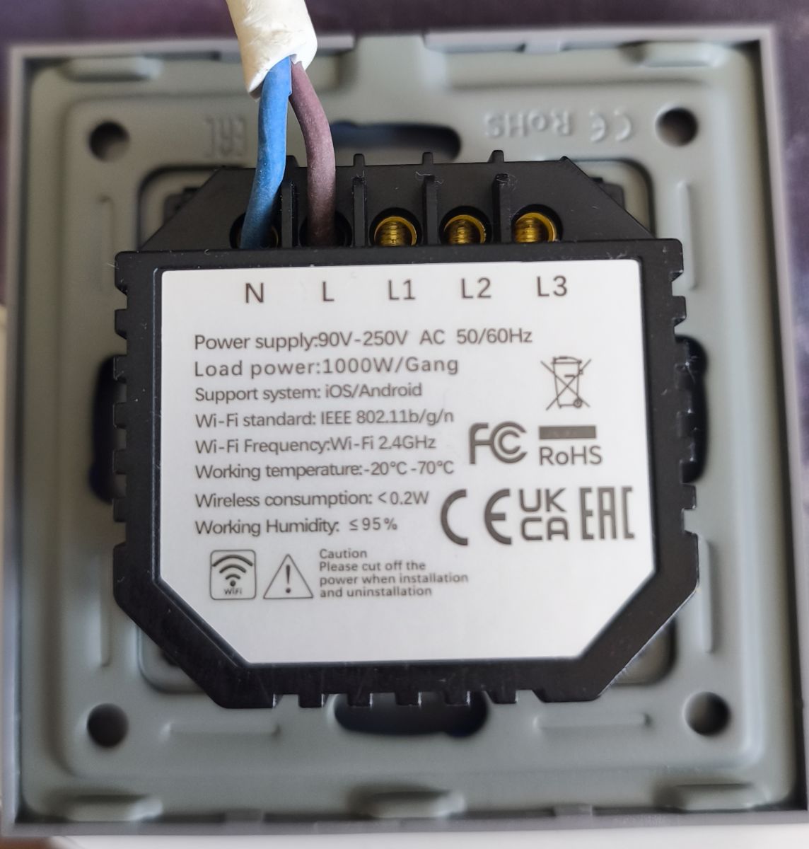

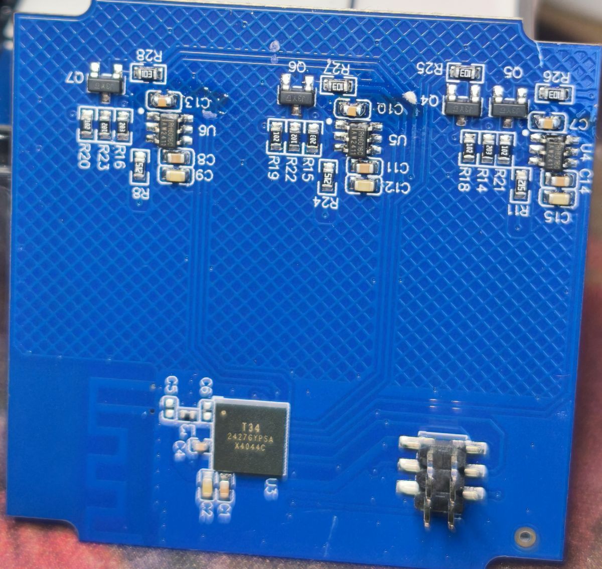

    Another version of the motherboard:
    Glass panel with three illuminated touch buttons in circular shapes
    Back side of a smart wall switch showing technical specifications and wiring.
    Blue PCB with surface-mounted components and integrated circuits
    PCB board with three buttons and labeled pins TX, RX, GND, and 3.3V.

  • #6 21859416
    kajaba
    >>21818324 Hello, I have the same version but with 2 gangs. I don't see any CEN pad. How did you flash the switch? After initiating the flashing, did you disconnect and reconnect 3.3 V? Or any other method? Because I have a problem flashing it.
    Thanks
  • #7 21859491
    pierdata
    Board Language: polish
    Yes.
    I haven't checked if the CEN pin is available. Just press flash and then connect power to the 3.3 V pin.
    Regards,
    prucho
  • #8 21860157
    kajaba
    >>21859491 I can't figure it out. I am using Arduino to flash (not some separate HW). I used this method to flash ESP of various chips. I use BK7231Flasher — it downloaded some bin for chip BK7231N (T2, T34). I used rxtx, rxrx, and combinations. I pressed 'Do Firmware Write' and then connected to 3.3 V and nothing. Thanks for help >>21859491
  • #9 21860229
    pierdata
    >>21860157
    RX programmer to TX PCB, TX programmer to RX PCB.
    I don't know, and I don't use Arduino as a programmer...
    But you can try keep connected 3.3 V, just disconnect GND, press Flash, and connect GND.
    Regards
    prucho
  • #10 21863831
    kajaba
    >>21860229 Thank you. I finally made it, but I needed to cut the TX line that went to some other chip also.
    Thanks.
