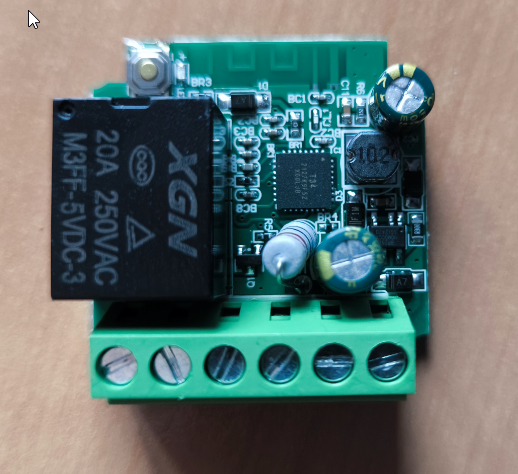

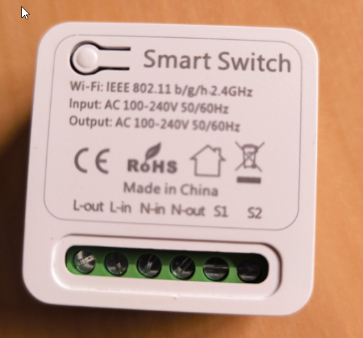

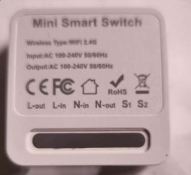

    The latest purchase from Aliexpress bring me 2 new type of the Smart Switch.
    Smart Switch with manufacturer's label and connectors.
    and
    Mini Smart Switch label with technical information.

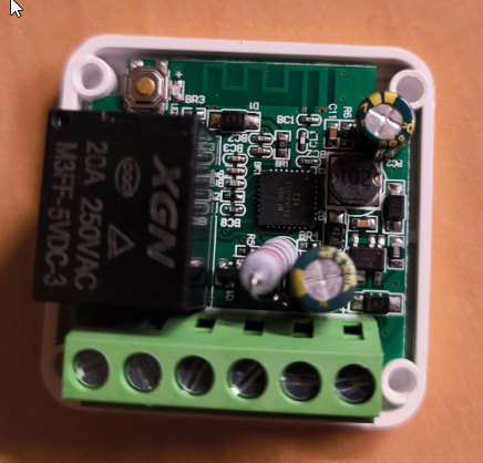

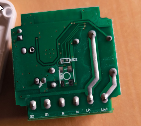

    I've ordered 4 pc, and received in the same box two type :
    DIY Smart Switch box with Amazon Alexa, Google Assistant, and Tmall Genie logos.
    First release have the pushbutton on the back, the second on the front

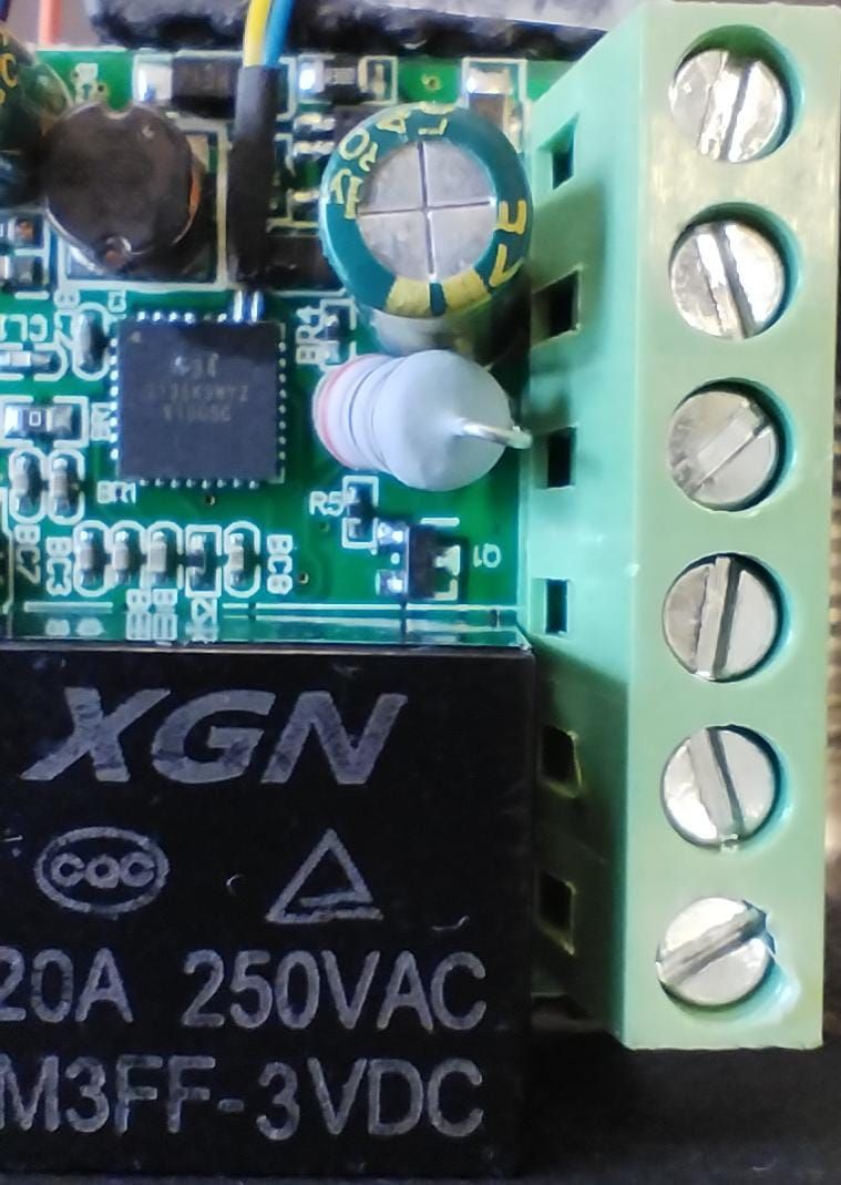

    Close-up of a circuit board with electronic components in a plastic case.
    booth are equipped with the same base board, consist the power adapter, relay and T34 chip.
    Electronic module smart switch with visible components.

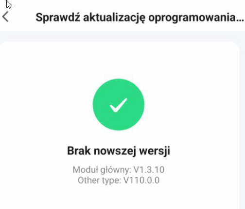

    The first try was with the Tuya Cloudcutter, finally i give up when I've found that the software installed there is as below - 1.3.10, on the other post i found information that this is not flashable by the cloud cutter ...
    Software update screen showing no newer version for the main module and other type.
    So when i opened the boxt i see that T34 is glued to the main board.
    Close-up of a smart switch baseboard with visible electronic components.
    View of the back side of a smart switch baseboard.

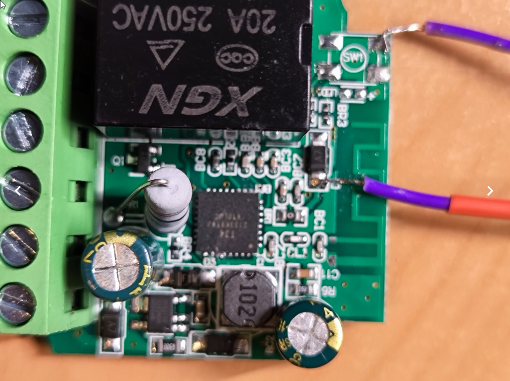

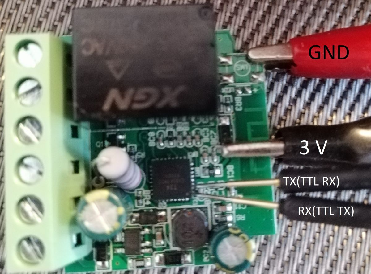

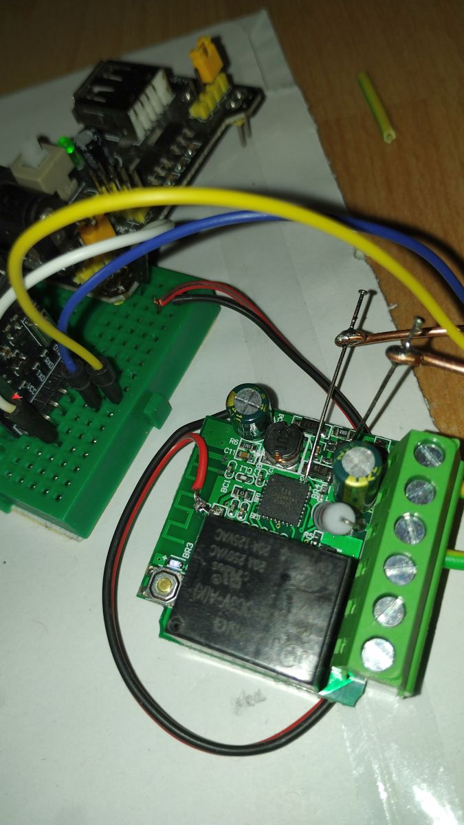

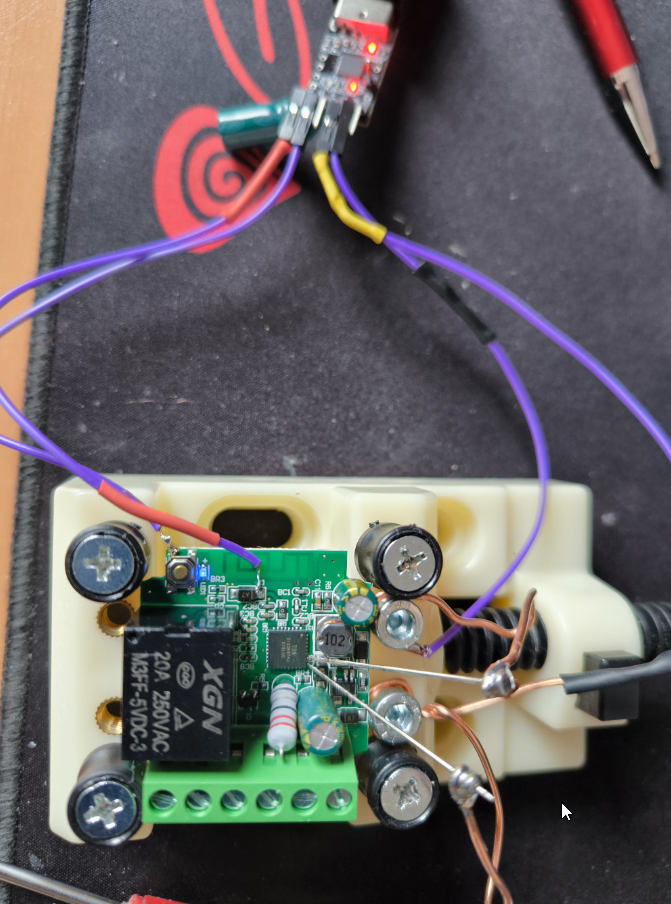

    the power taken from UART module i have connected as in the picture:
    GND- Violet
    3V3 - Violet+RED power
    Close-up of an electronic board with a relay and electronic components.

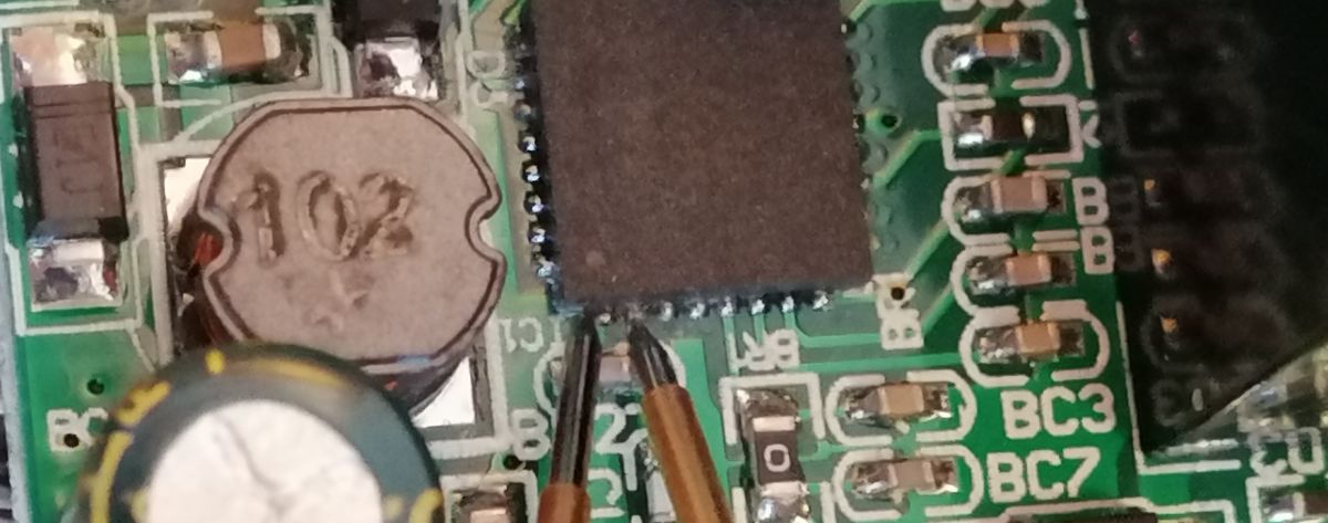

    the tricky part is to get access to the programming pins.

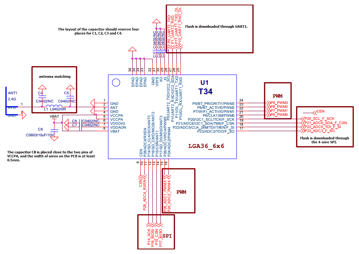

    the reference say:
    Diagram of the T34 circuit with pin and component labels.
    I need access to pins:
    T34 25 (RX) <- UART TX
    and
    T34 26 (TX) <- UART RX

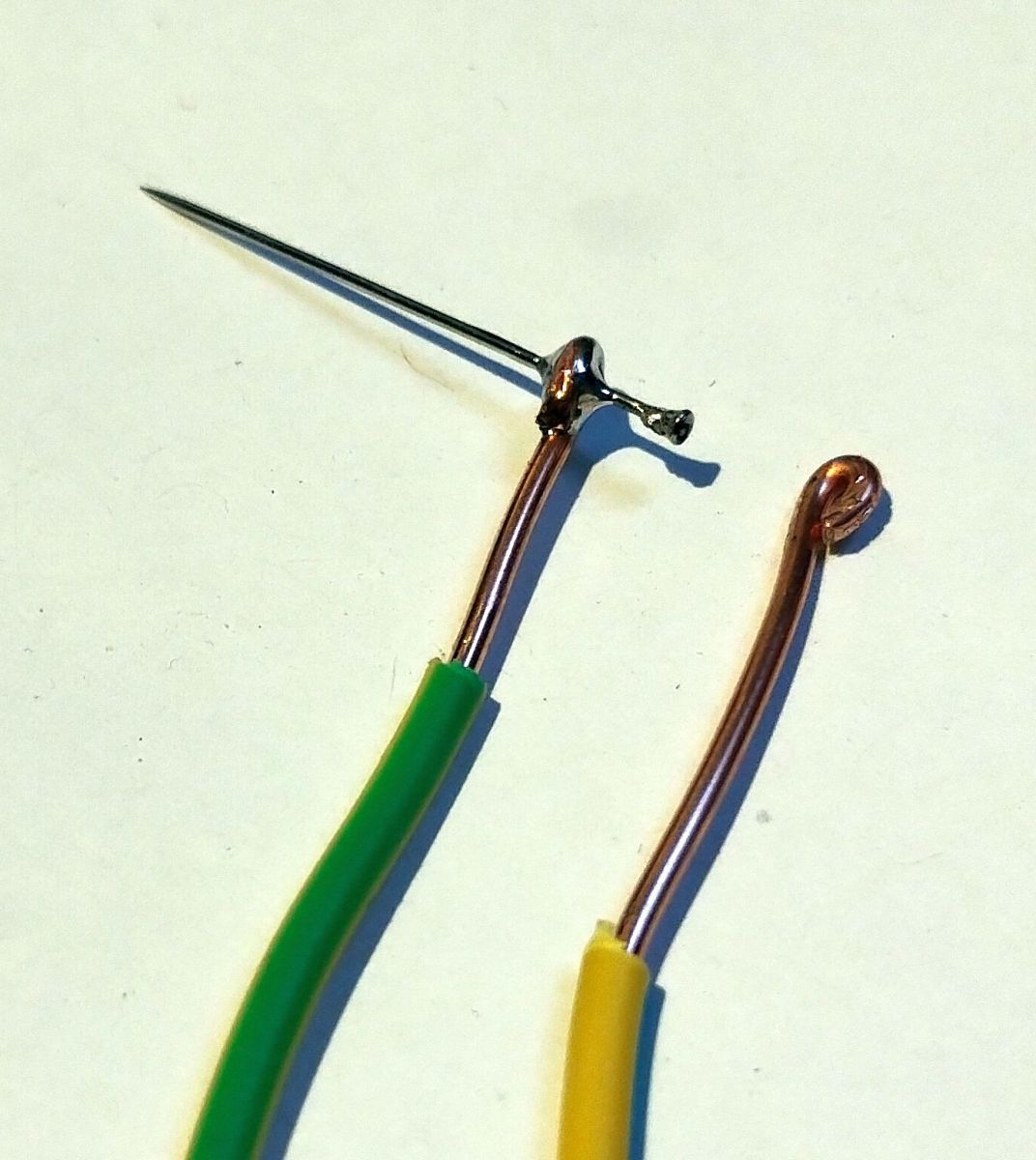

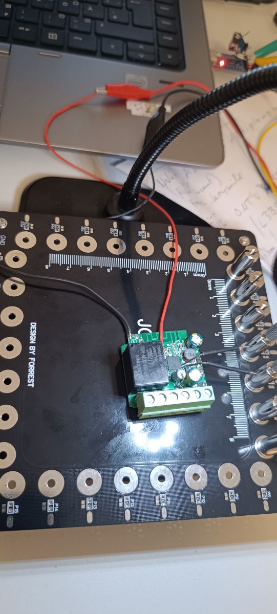

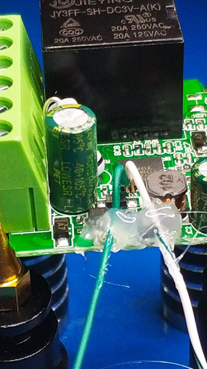

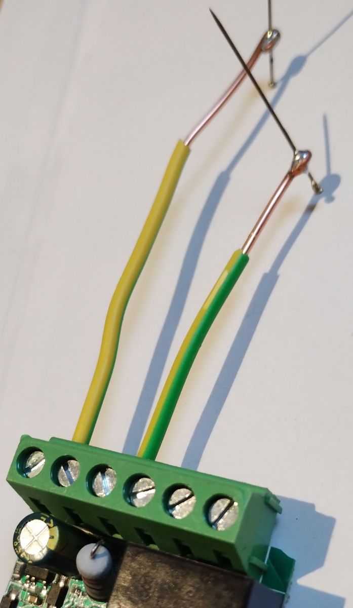

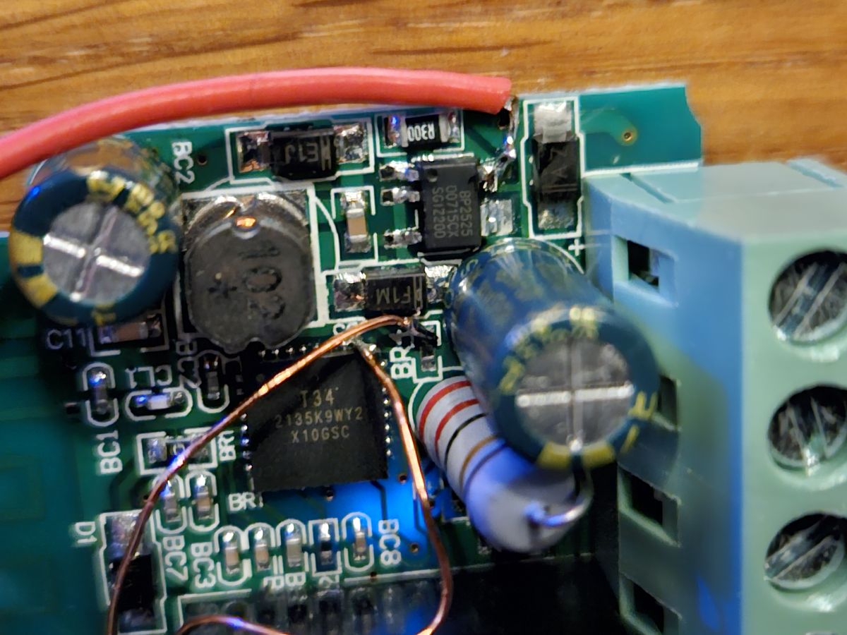

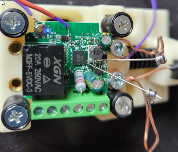

    I've mount board in the bracket and preapre two "Needle arms" made with 1,5mm cooper wire and the sewing needle at the end.
    Close-up of an assembled electronic circuit with a smart relay and wires connected to programming pins.
    the next 30 min it took me to position the needle on the first board in the right way using magnifing glass to get the proper contact and force in the right direction.
    accidently scratching the pins by the sharp end of the needle i took an small piece of the solder between the pins what confused me for an while, so i recommend after placing pins (needles) on - to check with multimeter if they are not shortened just again good magnify glass help.
    Baseboard with connected wires and components.
    After first succesfull flash of the first one, the other 3 units took only 10 min to be also burn with new becken software via "bk7231flasher_1.1.6"

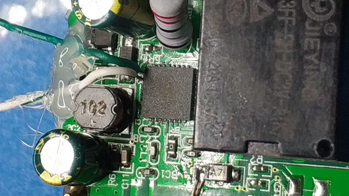

    Good work. These T34s sure look fiddly. I wonder if any come with test/programming pads on the PCB, seems odd there aren't some. Not sure I've seen a T34 device yet with any.

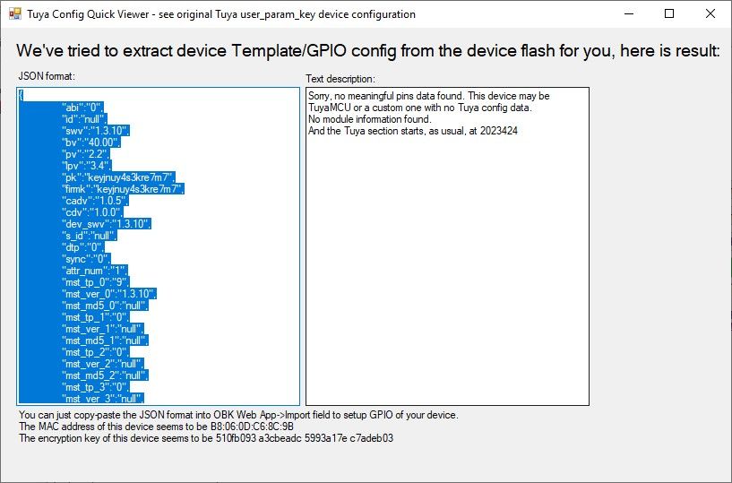

  • T34 board pin mapping and Tuya config dump
    #5 21195371
    zyklop
    Great work!
    I changed the script on PIN 24 to toggle the relay each time to press, no need to hold it down.
    (your script has a " , " too much at the end.)
    I backed up one of them. File is at the end of this post !

    tuya config in source file is from 1D4000   to   1D41C1 and shown as follows:
    {rl1_lv:1,on_off_cnt:10,onoff_rst_m:1,onoff_clear_t:10,rand_dpid:42,net_trig:4,onoff_n:5,netled1_lv:0,jv:110.0.0,onoff_rst_type:2,ffc_select:0,total_bt_pin:24,nety_led:2,total_stat:0,reset_t:5,netled1_pin:6,remote_add_dp:49,remote_list_dp:50,net_type:0,inch_dp:44,module:T34,ch_cddpid1:9,inch_en1:0,onoff1:14,clean_t:5,init_conf:38,zero_select:0,onoff_type:0,series_ctrl:0,total_bt_lv:0,cyc_dpid:43,ch_num:1,rl1_pin:15,netn_led:2,ch_dpid1:1,crc:83,}

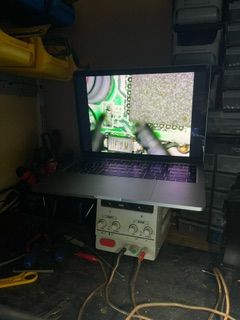

    #6 21207982
    tmordalski
    Computer screen displaying firmware update software. Laptop on desk displaying a circuit board. Dobra robota.
    Wielkie dzięki za ten temat. Jestem po wgrywaniu OB na kilku miniswitchach z Ali (T34)
    i wszystko działa super.
    Jestem zielony w te klocki z JSON, ale myślę, że to mały problem.
    Dla takich początkujących jak ja kilka spostrzeżeń
    1. Podczas wgrywania OB zatrzymywało mi "read" po zbyt szybkim podłączeniu 3.3V w celu resetu. Ale doszedłem do wprawy.
    2. Po zakończeniu flash wyskakiwał problem niezgodności conf obk czy coś takiego, ale po drugim flashu wszystko było ok.
    3. Ustawienia mosquitto pod żadnym pozorem nie należy używać polskich znaków, wtedy integracja z HA banalnie prosta.
    4. OB o wiele szybciej się paruje z wifi w porównaniu z Tasmotą (nie przeszkadza 5 GHz, przy Tasmocie muszę wyłączać radio 5G na routerze, ale to znany problem z
    routerami Asus )
    Bardzo dobra robota panowie.

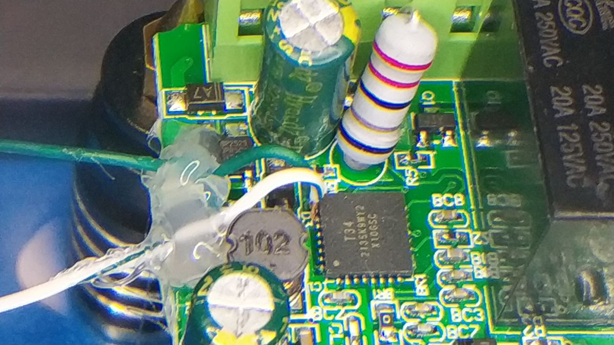

  • #11 21224436
    baudneo
    Posts: 17
    tmordalski wrote:

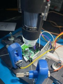

    >>21224052 Ja używam taniego mikroskopu usb (jak widać na zdjęciach) https://obrazki.elektroda.pl/5425301900_1724921161.jpg
    Pin 25 dotykam przy chipie, ale pin 26 dotykam na BR4. Close-up of a circuit board with microchips and electronic components.
    Thank you for the BR4 pad tip, that should make things easier. I am going to order one of those microscopes off AliExpress today!
  • Shorten wires and clear RX/TX for flashing

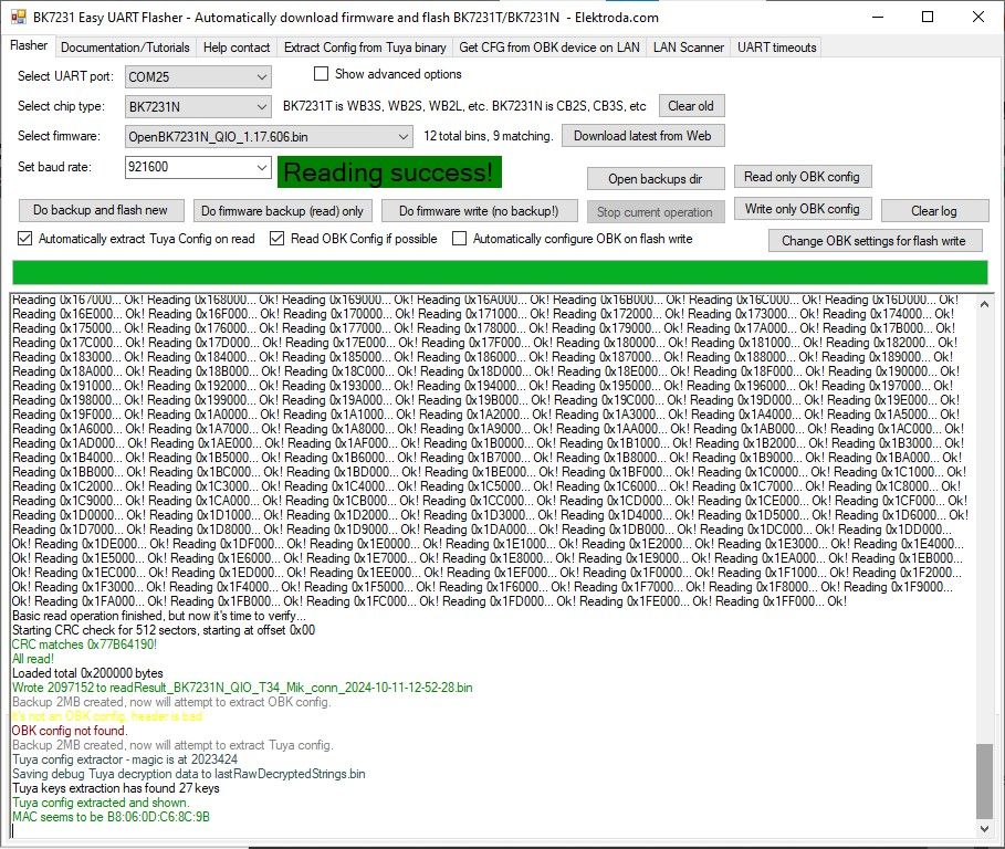

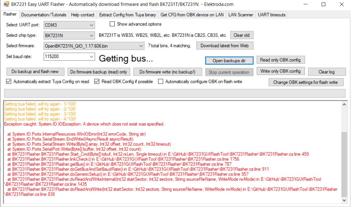

  • BK7231 flash tool errors entering flashing mode
    #13 21224821
    mustafathamer85
    Thank you guys for the quick replies ... unfortunately I did manage to do it.... not short cct btw RX/TX everything seems ok but I couldn't get flashing mode ... every time I try to turn off/on the switch to enter the flashing mode, I get an error on the BK7231 Flash Tool (image below)
    I used the BK7231 Flash Tool v 1.1.6 and also v 1.3.3 (both throw same error)
    Screenshot of BK7231 Easy UART Flasher tool with an error. Close-up of a microcontroller on a PCB with connected probe wires.
  • Correct power-cycling method for UART flashing
    #14 21224826
    Posts: 14754
    Rate: 12875
    You are doing the turn on/off incorrectly. The UART dongle should not reset when you turn on/off the device. By "turn on/off power" we mean that you should:
    - keep UART dongle in USB all the time
    - but disconnect/reconnect power to the device itself
    Long story short, your approach seems invalid.
    Alternatively, you may be doing a simple GND to VDD short which overloads and turns off your USB port. This is also possible.
    Can you show us your whole circuit (how is everything connected) so we can help you a bit more?
  • Avoiding PSU surge when entering flashing mode
    #15 21224827
    Posts: 5208
    Help: 446
    Rate: 914
    >>21224821
    got any broader pics of your whole wiring setup showing every length and start/finish of cable ends?
    also, I've had it before that when using external PSU and you turn on the whole PSU to get into flashing mode that the initial surge seems to not put the device into flashing mode. I now keep the PSU on but bring power to the device by inserting dupont into breadboard - so no PSU powering on surge.
  • USB-TTL stays connected while cycling 3V power
    #16 21224882
    mustafathamer85
    @p.kaczmarek2 @divadiow thank you guys for the help ... I never pulled out the USB-TTL device ... it's always connected ... I only disconnect the 3V wire and reconnect it to emulate the turnoff/on process ..... but every time I disconnect/reconnect the 3V wire I hear the plug/unplug Ms windows sound .. it could be a driver problem ! anyway here is my connection: sorry @divadiow I couldn't take photo of the whole connections, I will do it when I will be back home Close-up view of connections on an electronic board with wires labeled GND, 3V, TX (TTL RX), and RX (TTL TX).
  • Weak power supply or 3.3V short causing startup overload
    #17 21224931
    Posts: 14754
    Rate: 12875
    You are using too weak power supply and the inrush current (large amount of current that flows at the startup) caused by capacitors on the board are overloading your USB port. You need to either use a better power supply or to remove the large capacitor that is on the PCB. You can also try powering device from separate power supply so USB port is not overloaded.
    It is also still possible that you have a short and you just short GND to 3.3V, then it would also act the way you describe.

  • Glue gun UTP adapter for T34 flashing pins
    #21 21257039
    agetntx74
    Hi there!
    Here's my solution, which might be helpful for someone.
    I used a cheap glue gun from Fixprise to fix a UTP pair. Then I adjusted it to fit on pins 25 and 26 of T34.
    The rest of the process is the same as everyone else's: 3.3V, GND, and CEN.
    It's not difficult, and I hope it helps!

  • TX pull-down resistor exposes an easier access point
    #22 21264891

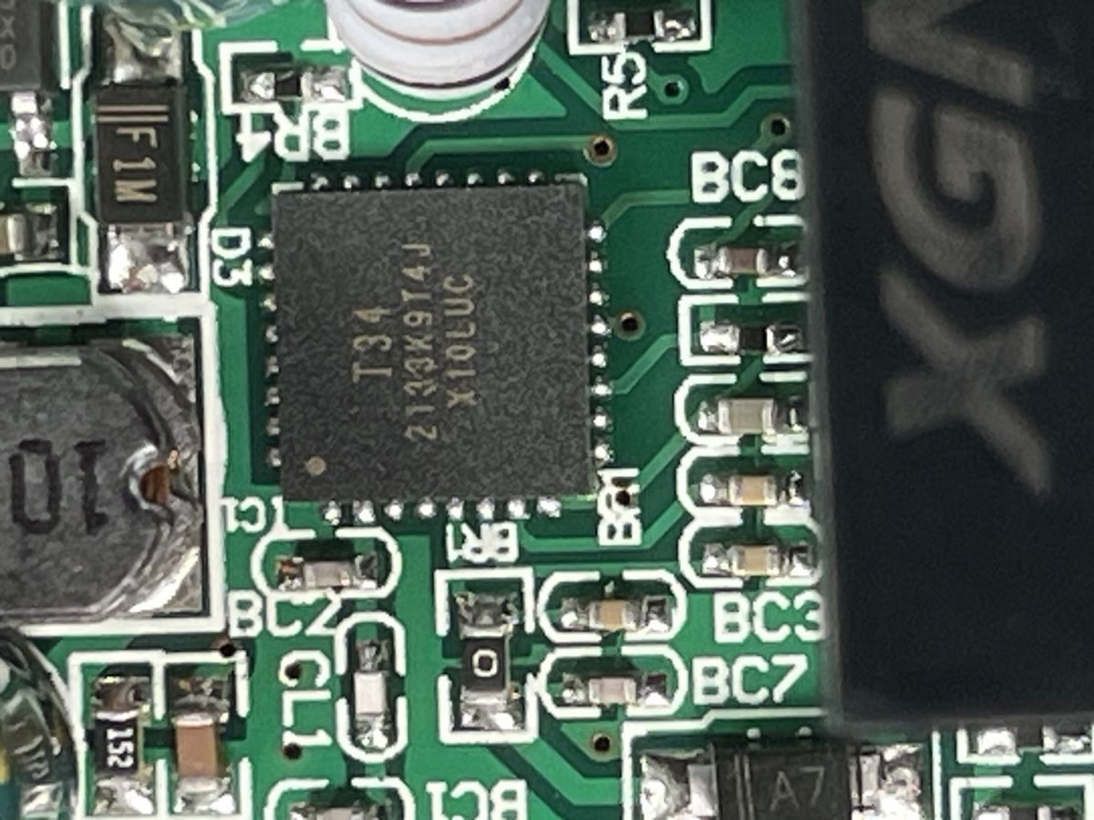

    woessner
    Hello everyone,
    please have a close look at your board, You will find a resistor marked BR4, this is a pull down resistor for the TX pin (26)
    Thus you can easily access the TX pin on the side of the "4" of the resistor. The other side is GND.
    This leaves you with having to access pin 25 on the IC which is way easier than 26 because it is the outermost pin on the corner.
    I did not find RX anywhere else on the PCB.
    PS.: Does anyone have an idea why one would add a pull down resistor to TX? But anyhow, it makes life easier for us.
    Close-up of a PCB with visible electronic components, including capacitors and a resistor labeled BR4.

  • BR4 TX pin method for second unit
    #25 21296769
    morgan_flint
    Posts: 251
    Rate: 63
    I also managed to flash one of these, thanks to all for the information!
    This was my approach to solder the TX/RX pins:
    Printed circuit board with visible electronic components including an integrated circuit, capacitors, and a screw terminal.
    I took a pair of wire wrapping wires, stripped and tinned a short length, and tied them together with a small thermal shrink tubing. I cut the isolated portion to just one mm and adjusted the distance between them to fit the distance between the IC pins. Then, with the help of a drop of flux, I aligned the points with the pins and touched them briefly with the soldering iron fitted with a smaller tip than usual. 3.3V, and GND wires were soldered to C2 capacitor pins.
    I read a backup with OBK flasher and everything went well, although it didn't recognize the configuration:
    Screenshot of the BK7231 flashing software with messages indicating successful reading. Screenshot of the Tuya Config Quick Viewer program displaying device GPIO configuration.
    Then, after flashing OBK config with the flashing tool, I used the JSON posted at the beginning and everything is going OK.
    Thanks again to everybody!
    EDIT: for flashing a second unit, I used the BR4 approach to connect TX pin, as suggested by @tmordalski and @woessner, thanks for the suggestion!
  • Needle probe flashing works at 921600 baud
    #26 21310912
    max4elektroda
    Posts: 758
    Help: 49
    Rate: 189
    Thanks for your input, especially for the solder-less solutions.
    Let me provide some pictures of my approach, kind of a "self contained" variant of the idea in the opening post by @Mati Crawn:
    I left most of the isolation on the wires, so I could connect them to the switches connectors (needs some force to fix them so that they don't move during positioning).
    The needles connected to BR4 for TX and pin 25 for RX.
    Took some time to bend and connect the needles, but I succeeded in the end ;-)
    I set speed to lowest (115200) after the first errors in reading (reading didn't finish).
    In the end, it did work when just writing the image, but only after setting the default speed 921600 (with 115200 erasing was successful, but writing failed).
    Might have also been due to the fact that I did everything on an Ubuntu PC...
    Sadly I lost my logs by closing the program to early :-(.
    So, here are some pictures of my approach (not shown: I soldered breadboard wires to the needle arms)
    Close-up of two copper wires with green and yellow insulation, with curved ends. Two wires with needles connected to a green screw terminal block. Close-up of a prototype electronic circuit with wires and pins connected to a PCB.

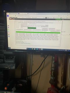

    #29 21321496
    marekvnl
    Good evening, gentlemen,
    I'm having a little problem with the flash of this device. I managed to plug in its UART and do a full firmware dump, so I seem to have a good connection.
    Going to read encryption key...
    Encryption key read done!
    Encryption key: 510fb093 a3cbeadc 5993a17e c7adeb03
    Going to start reading at offset 0x00...
    Basic read operation finished, but now it's time to verify...
    Starting CRC check for 512 sectors, starting at offset 0x00
    CRC matches 0x10CF5951!
    All read!
    Loaded total 0x200000 bytes
    Wrote 2097152 to readResult_BK7231N_QIO_2024-26-11-23-49-23.bin
    I have tried dozens of times - different baud rates, different firmware versions and different flasher versions. The error is always the same:
    Preparing to write data file to chip - resetting bus and baud...
    Getting bus success!
    Going to set baud rate setting (115200)!
    Flash MID loaded: 15701C
    Will now search for Flash def in our database...
    Flash def found! For: 15701C
    Flash information: mid: 15701C, icName: EN25QH16B, manufacturer: ESMT, szMem: 1000000, szSR: 1, cwUnp: 0, cwEnp: 7, cwMsk: 3C, sb: 2, lb: 4, cwdRd: 05-FF-FF-FF, cwdWr: 01-FF-FF-FF
    sr: 0
    final sr: 0
    msk: 3c
    cw: 0, sb: 2, lb: 4
    bfd: 0
    Going to do erase, start 69632, sec count 281!
    failed with serial.BytesToRead 1 (expected 16)
    The beginning of buffer in UART contains 00 data.
    Erasing sector 69632... Erasing sector 69632 failed!
    Writing file data to chip failed.
    Is there still a ground pin there to clear it or overwrite the flash? Documentation only talks about Pin18 being pulled up when loading flash from SPI.
    Could someone please suggest what this could be about? Thank you very much in advance.
    Greetings.
  • Power and baud rate fixes for flashing errors
    #30 21321499
    Posts: 14754
    Rate: 12875
    What kind of connection? Any pictures?
    This problem is quite well known and has already appeared on the forum, the symptoms are quite deceptive, reading works and writing breaks down, but it all usually comes down to improving the power supply, shortening the cables, possibly changing the USB to UART converter, possibly a different baud rate. It's also sometimes worth trying a higher baud as a lower one gives errors (and vice versa).
    Are you running Flasher on Windows?
    And if all else fails.... you can use hid_download_py:
    https://github.com/OpenBekenIOT/hid_download_py
