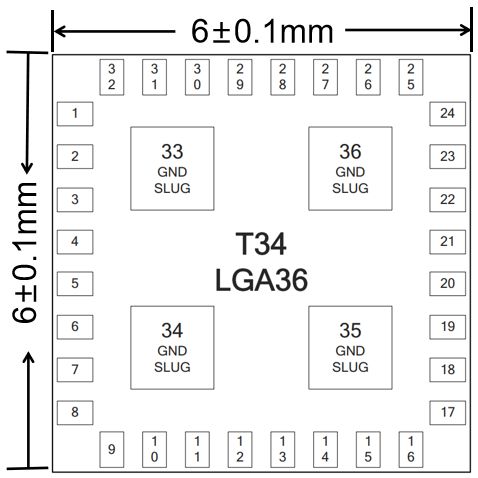

    T34 a Wi-Fi and BT combo chip integrating BK7231N core along with crystal, RF matching component, and most other peripheral components within a tiny SMD case. The T34 dimensions are 6±0.1 mm (W) × 6±0.1 mm (L) × 0.85±0.1 mm (H). This reduces the size required on the board and saves manufacturing cost.
    Diagram of T34 LGA36 chip with dimensions and pin descriptions
    Internally, T34 is compatible with BK7231N firmware, so it can be flashed with OpenBeken.
    But first, let's consider T34 pins:
    Pin No.SymbolI/O typeDescription
    1, 3, 32, 33, 34, 35, and 36GNDPGround pins. 33, 34, 35, and 36 are the ground pads at the back of the chip.
    2ANTI/OExternal antenna with 2.4 GHz RF input and output.
    4 and 5VCCPAPRF PA power input. Voltage range: 3.0V to 3.6V. And 3.3V power supply is recommended.

    For flashing, you just need TX1, RX1 and power (GND and 3.3V).

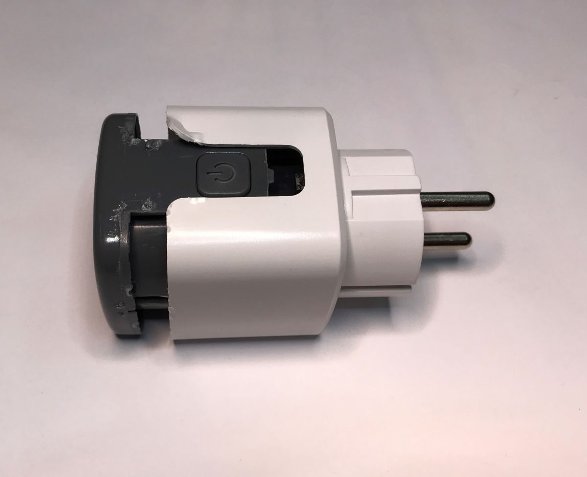

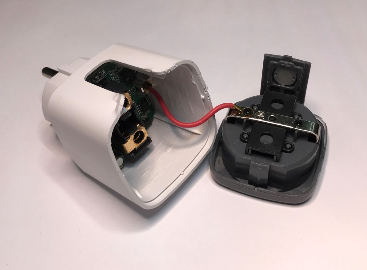

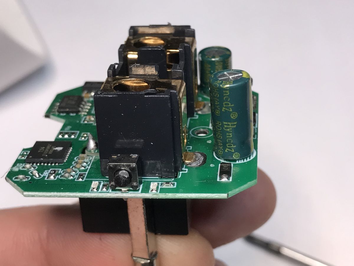

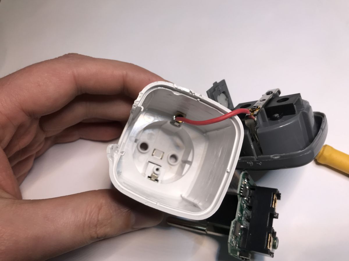

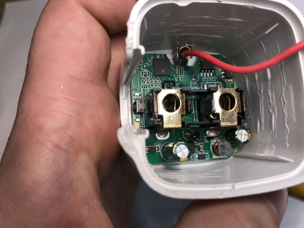

    The device can be opened with vice or by prying, it may be sometimes hard or easy, it depends on how much glue manufacturer used.
    Electrical plug with partially removed casing.
    Disassembled electrical plug with visible internal components.

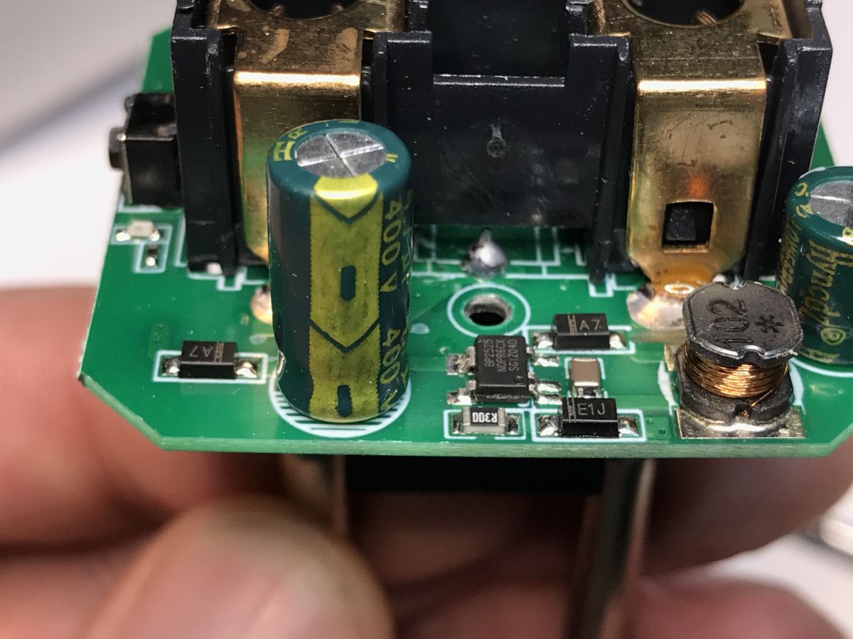

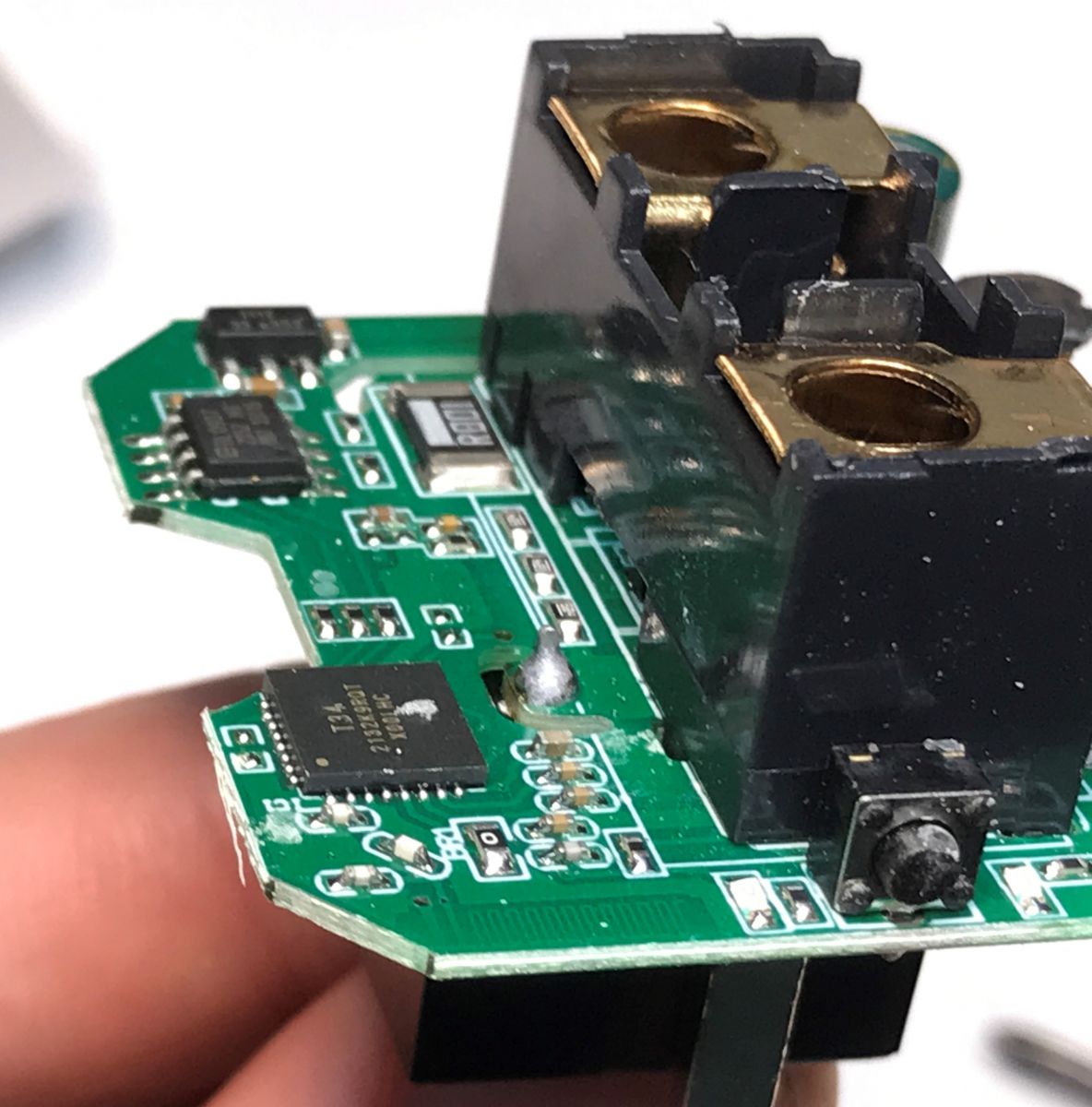

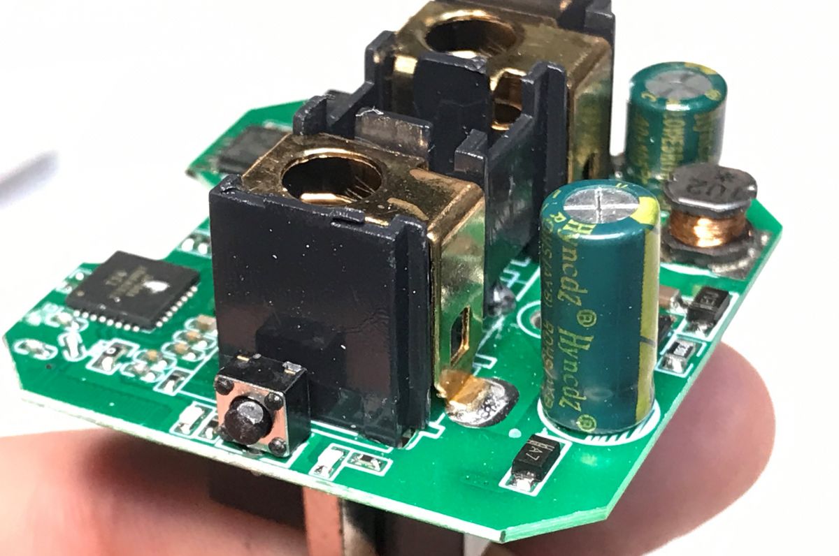

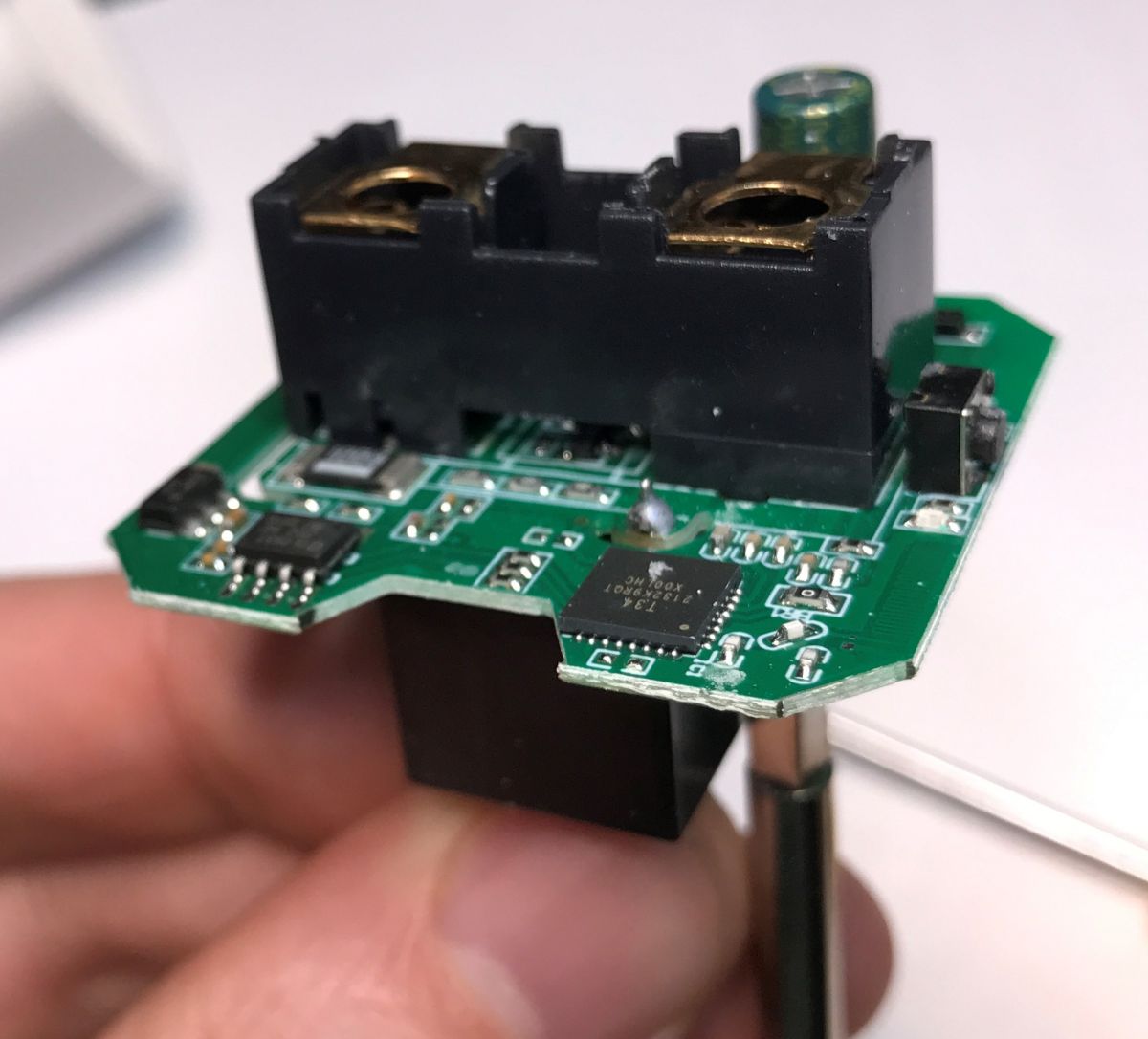

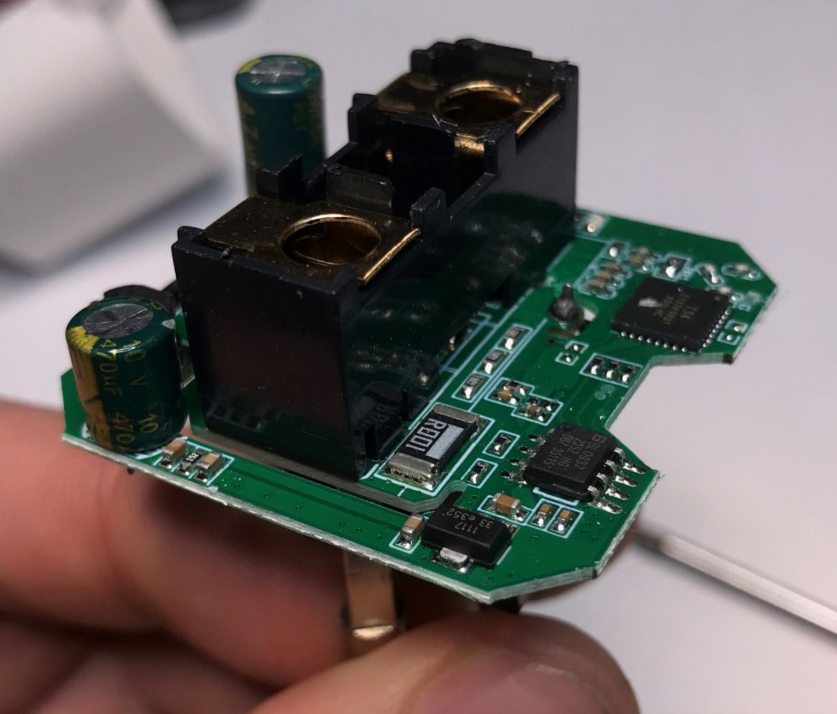

    There is a single board inside, it can be removed by unscrewing one screw:
    View of the interior of an electronic device with visible circuit board and components.
    Close-up of a disassembled electrical plug with visible wires and internal parts.

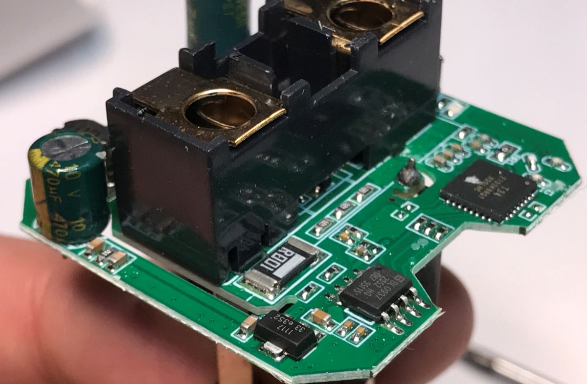

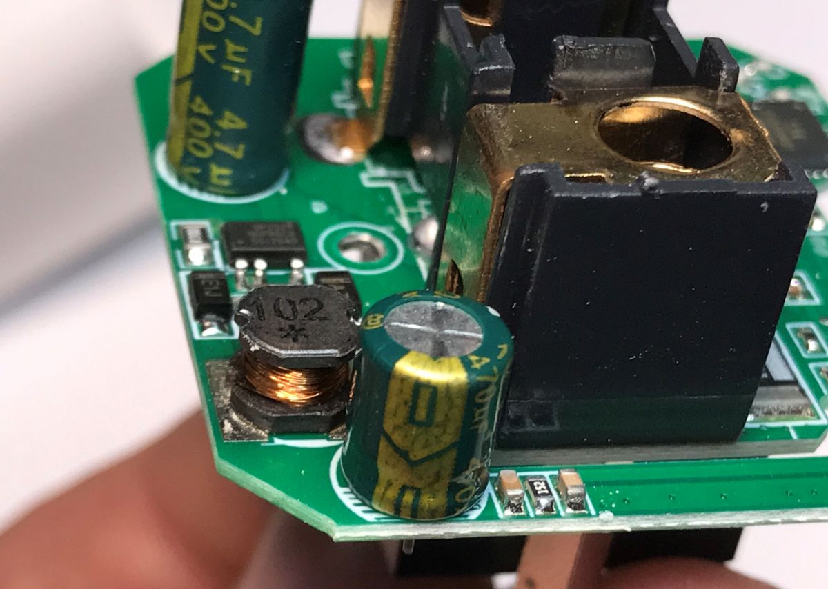

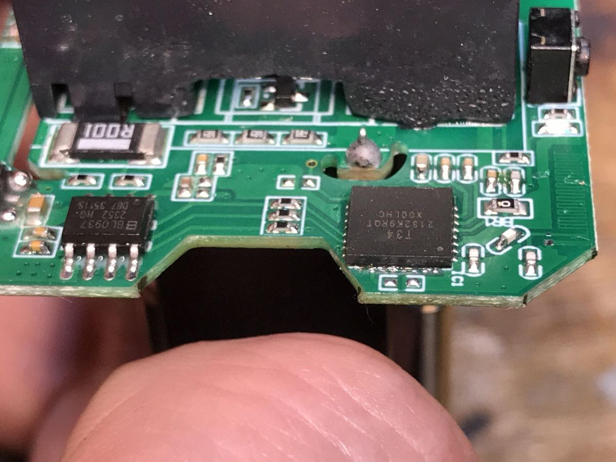

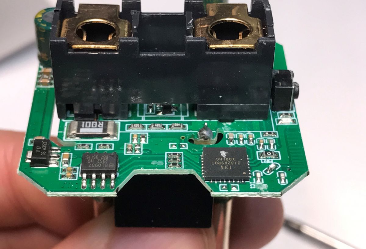

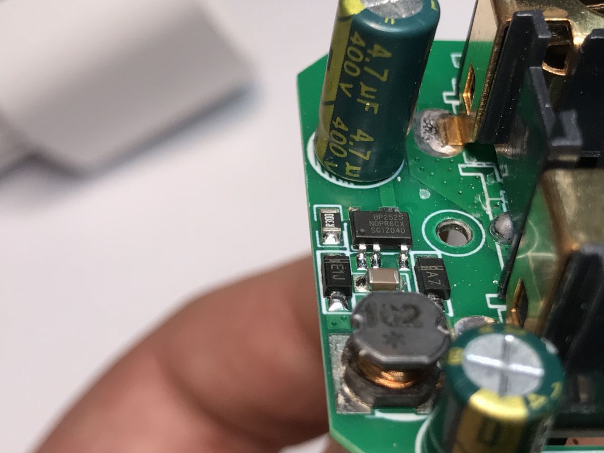

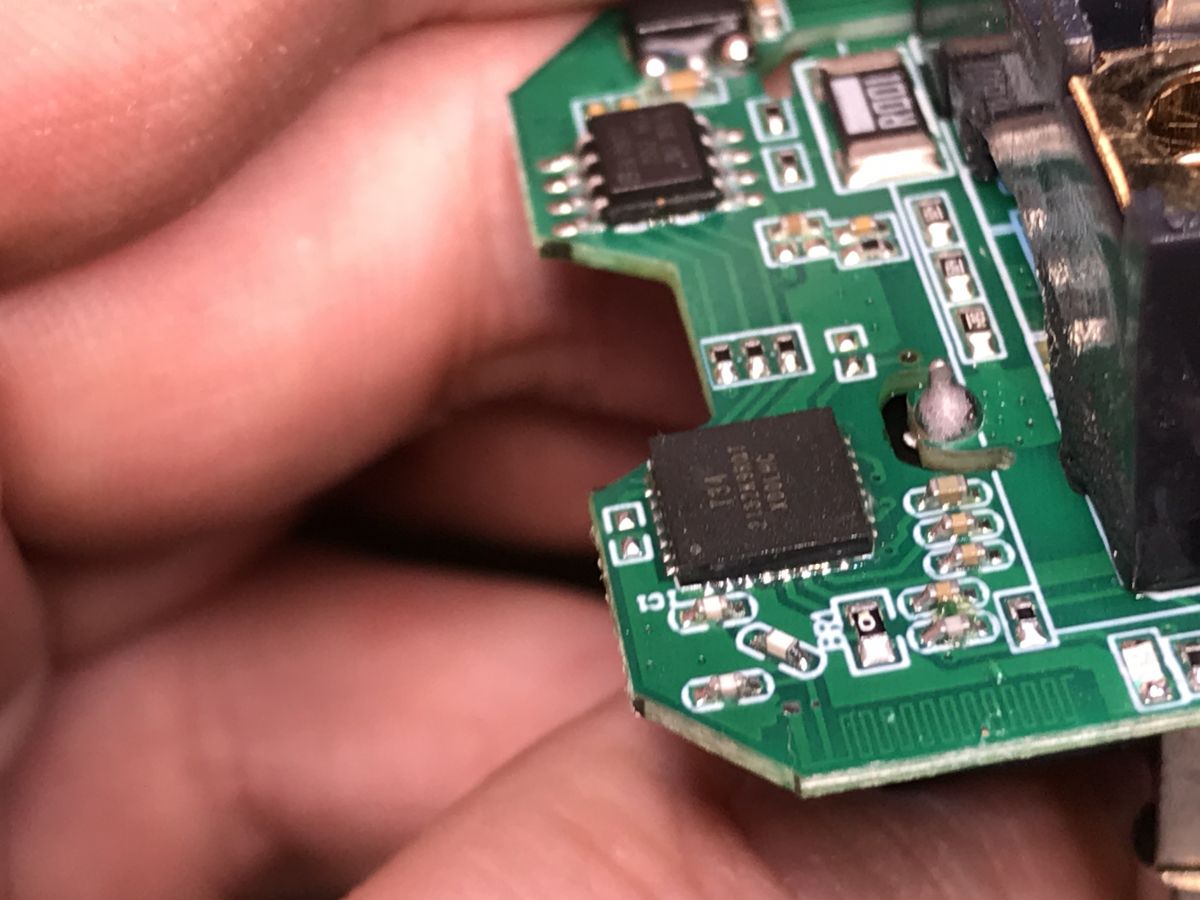

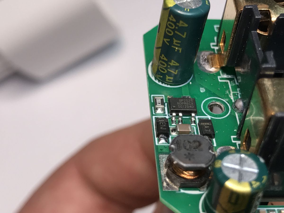

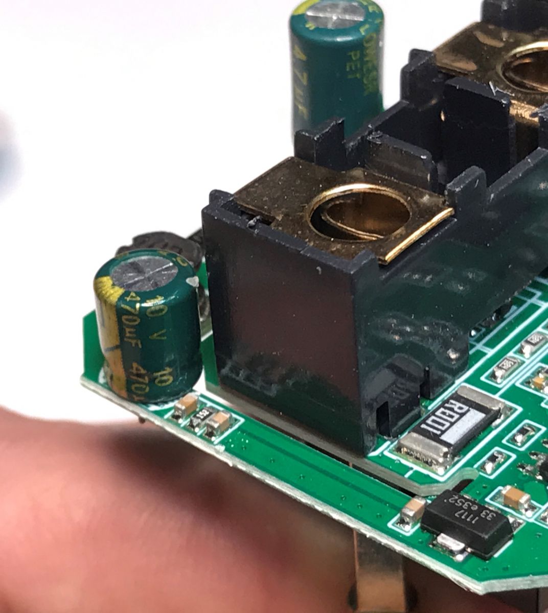

    The device is using T34 chip along with BL0937 for power metering. Futhermore, there is a step down power supply based on BP2525 and a 3.3V LDO to get 3.3V for the WiFi chip.
    Close-up of a green printed circuit board with small electronic components.

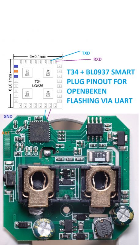

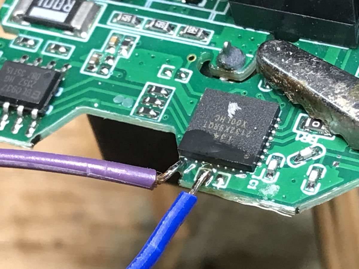

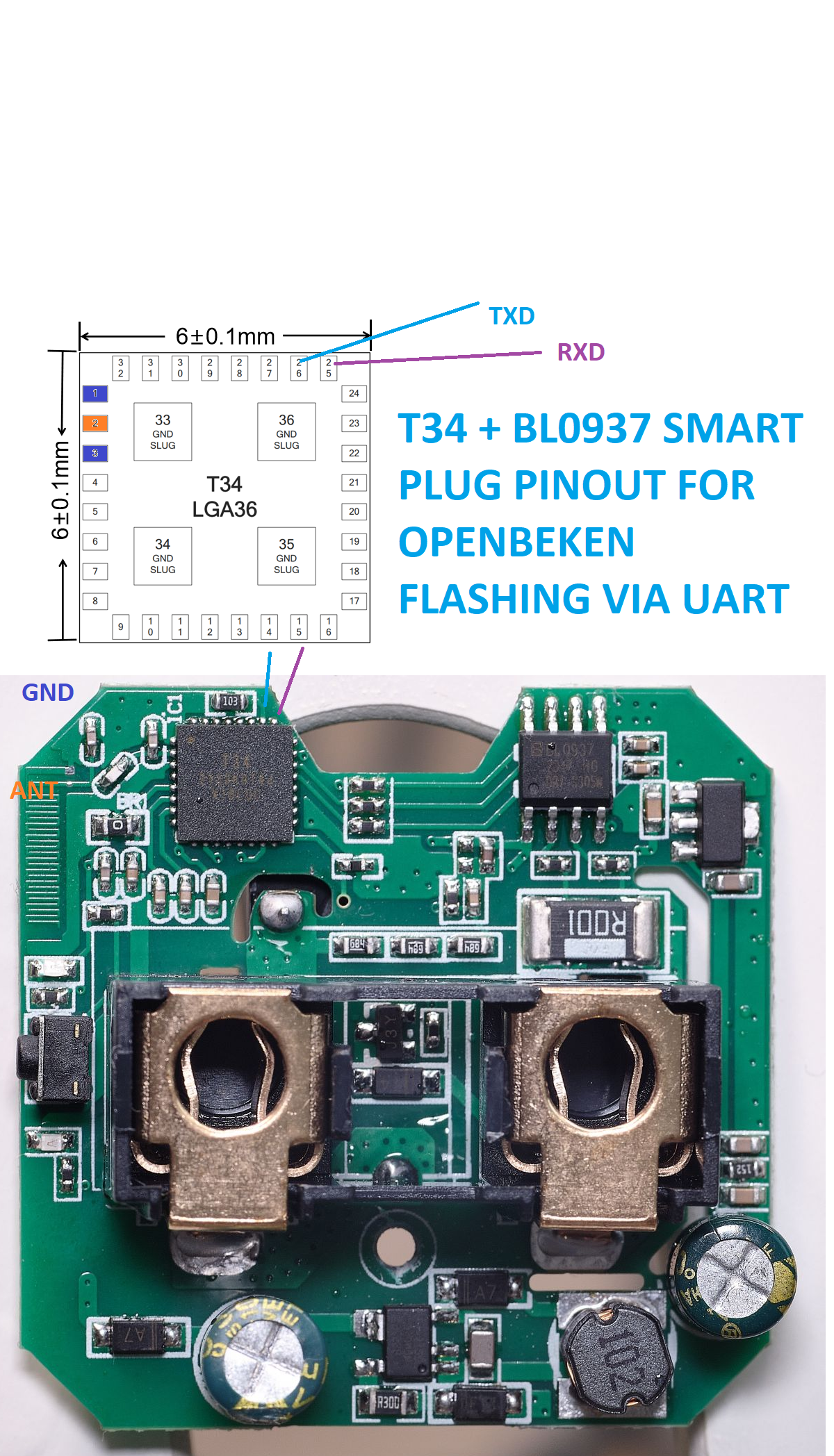

    Flashing attempt - how not to flash
    There are no RX/TX pads, but one of UART signals is routed to small SMD resistor pad. I've wanted to use this, as shown on image below:
    Circuit board of a T34 module with pinout for OpenBeken programming.
    However, I've made a small mistake and used too large wires:
    Close-up of a circuit board with mounted electronic components and attached wires.
    Ultimately, one of the pads fell off and I had to take a different approach.

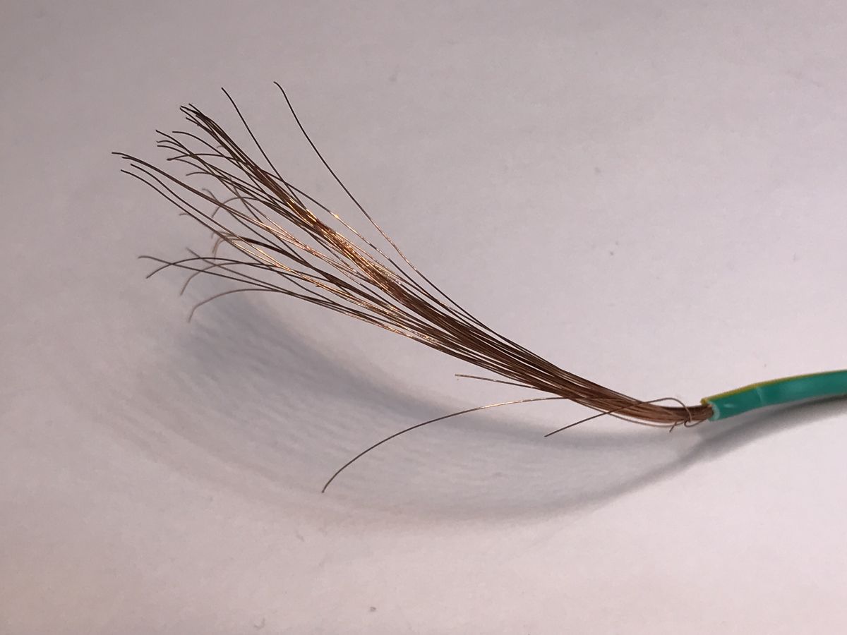

    So, if you are attempting this, use thinner wires! Like this:
    Exposed copper wire with thin, bare strands.

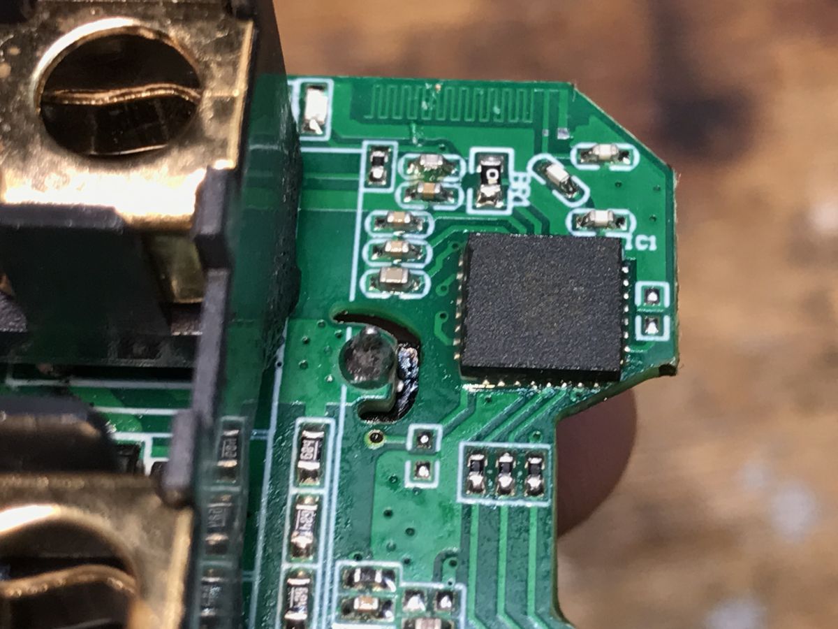

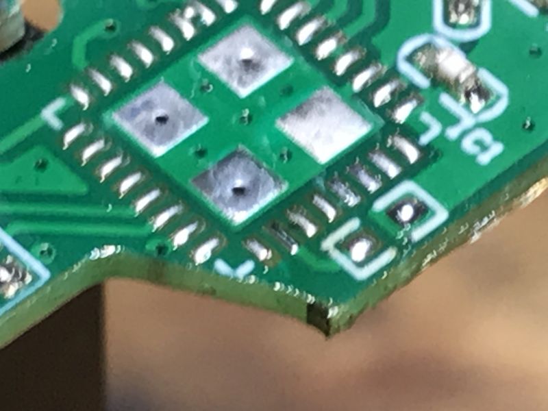

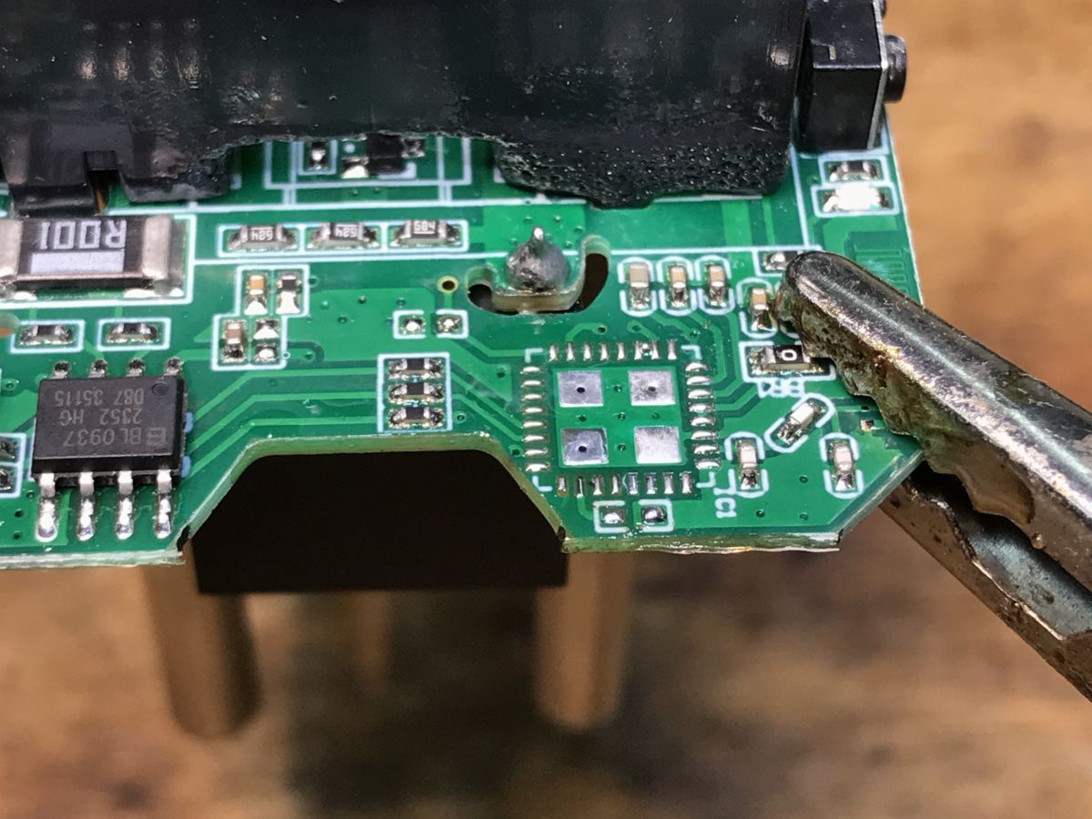

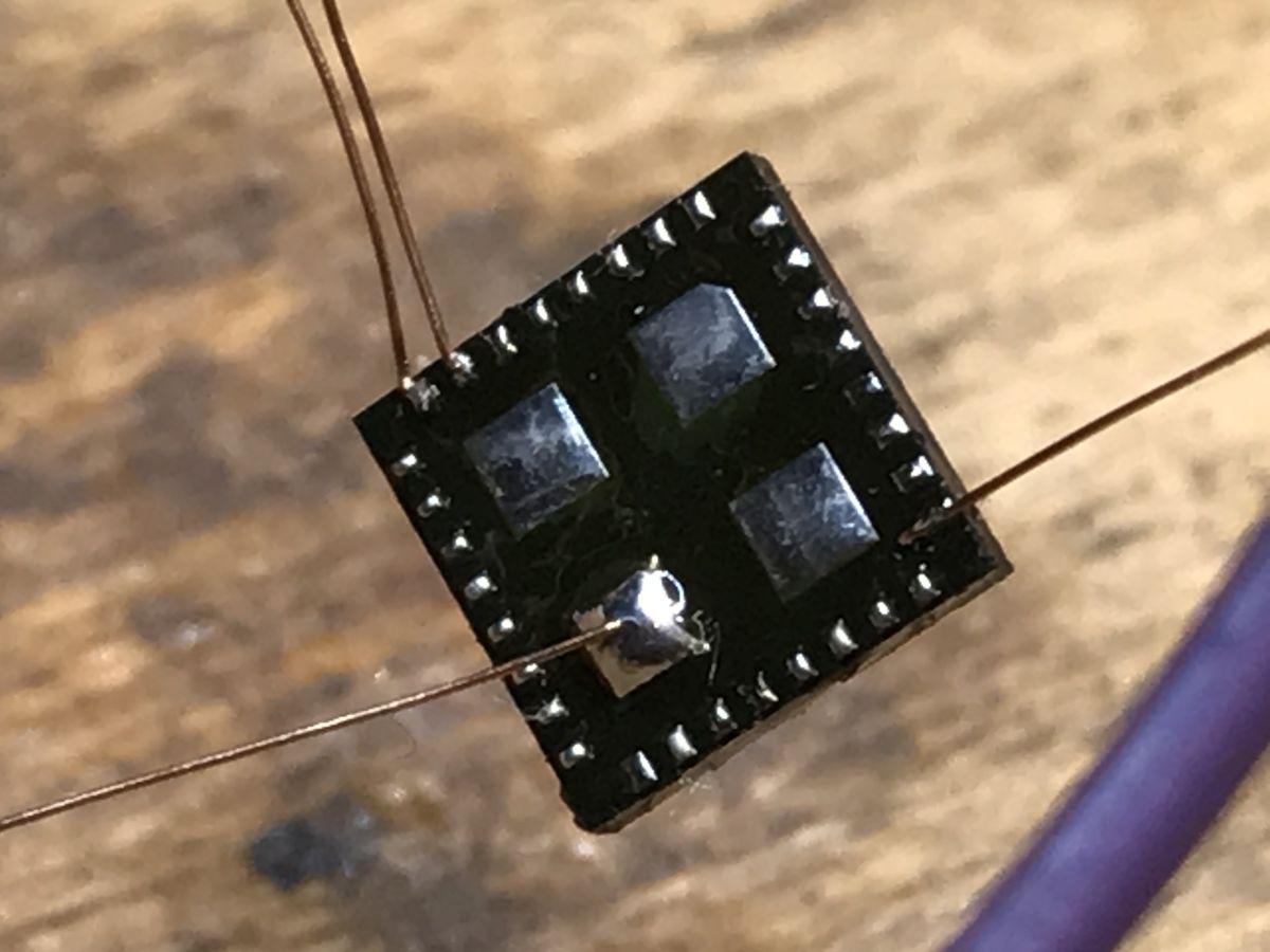

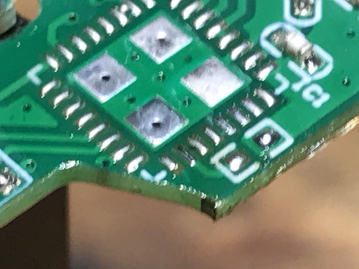

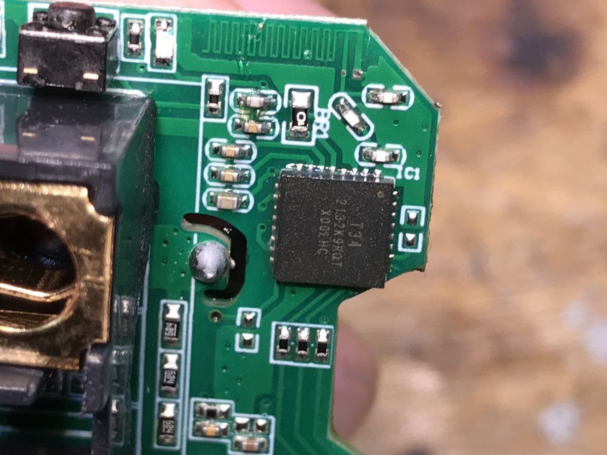

    And so, I had to remove the T34 from the board with hot air. I added some extra flux and lowered the air flow to avoid affecting nearby components.
    Close-up of a circuit board with electronic components.
    Here you can see the pad that I damaged (not the resistor pad, but the tiny pad of the other UART pin):
    Close-up of a green printed circuit board with exposed metal contacts and traces.

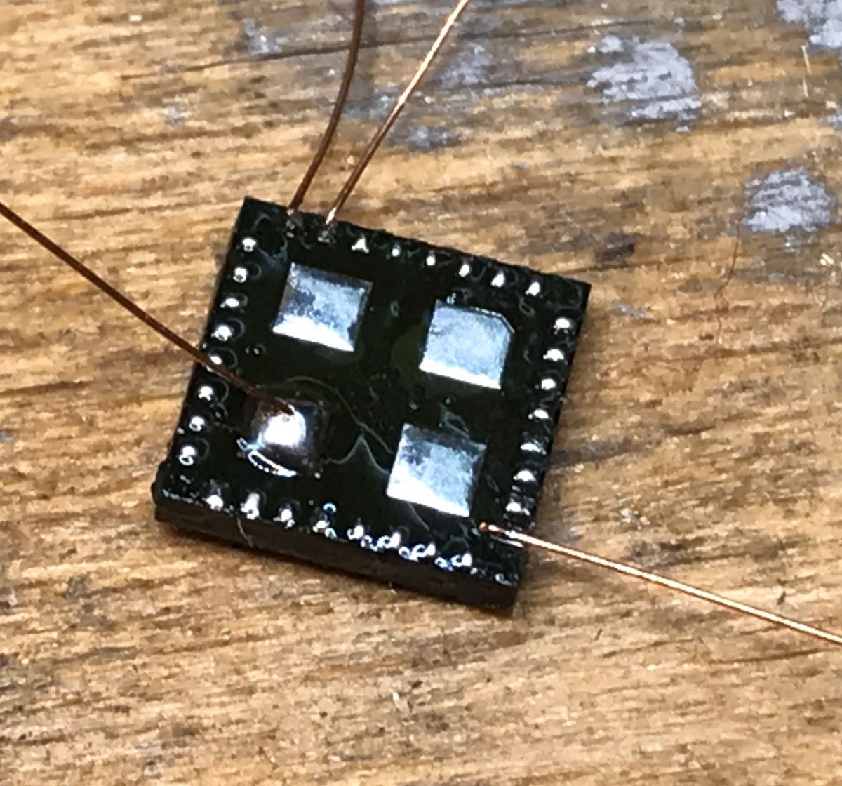

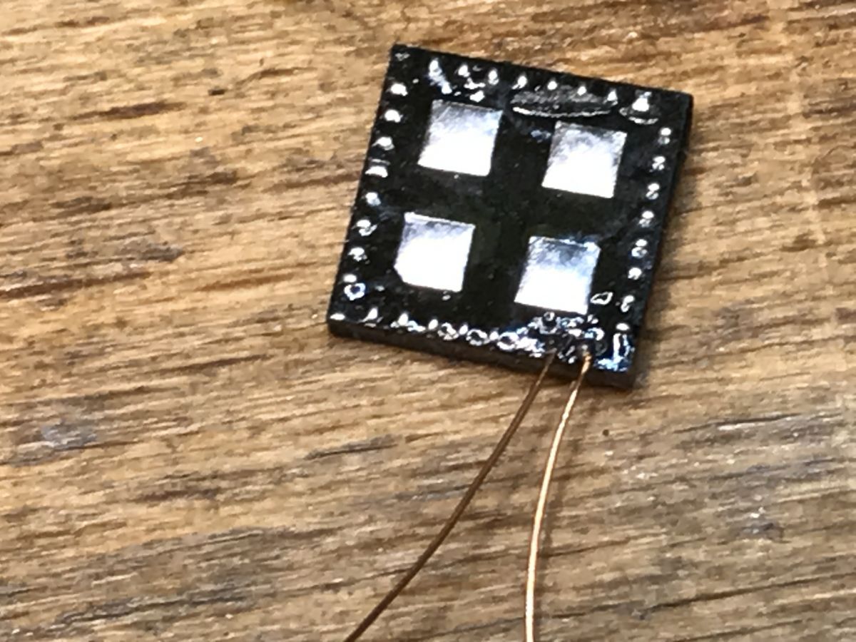

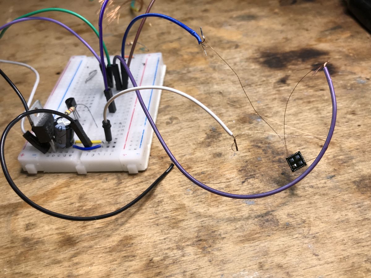

    Then I decided to solder directly to QFN pads, but this time I used thin wires:
    It is also recommended to secure them in place with some hot glue or sticky tape, because it's still very easy to tear the pad.
    Here's UART soldered:
    Small electronic chip with four metallic squares on a brown background.
    And then ground (large pad) and power (3.3V):
    Square electronic component with soldered copper wires on a wooden surface.
    Full circuit:
    Breadboard with electronic components and wires.

    I cleared up the T34 pads with flux and solder wick. Then I added flux on the PCB and decided to reuse the solder that was already there.
    After a brief heating, with a small air flow, the module has slightly moved itself in place and seated itself correctly. I had no corrections to do myself.
    Close-up of a green circuit board with visible integrated circuits and electronic components.
    Close-up of a green printed circuit board with integrated circuits and electronic components.
    Close-up of a green circuit board with a chip and metal components.
    Close-up of a circuit board with visible electronic components.
    Luckily the soldering turned out to be very easy and device worked at the first try.

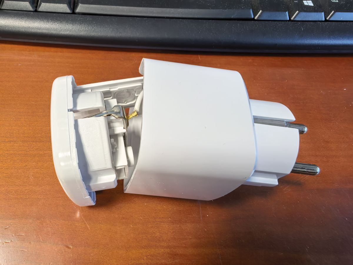

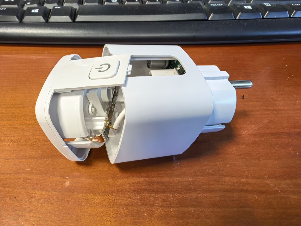

  • #6 21895937
    Blisk
    Level 4  
    Posts: 20
    Thank you for this tutorial I also have few smart power plugs with this chip and I will try to flash openbeken.
    When I flashed tasmota on other smart power plug I need to put GPIO00 to ground and after that I can flash tasmota on it.
    Here I see I need to plug it on and off to make it flashable.
    Also you opened verry bad this power plug. I use some old t shirt and wrap it around at the top and with big adjustable pliers squezze at the top until it pops and I do that all ournd for 4 times and no visible damage on housing of power plug.

  • #7 21895984
    Posts: 14587
    Help: 654
    Rate: 12609
    That's a good idea, thank you! I will try this next time.
    Regarding GPIO0 - no, there is no GPIO0 for Beken. Just supply power from good power supply, connect RX and TX, and do power off/on to reboot.
    Of course, do it with everything disconnected permanently from mains. Let us know if it has worked for you

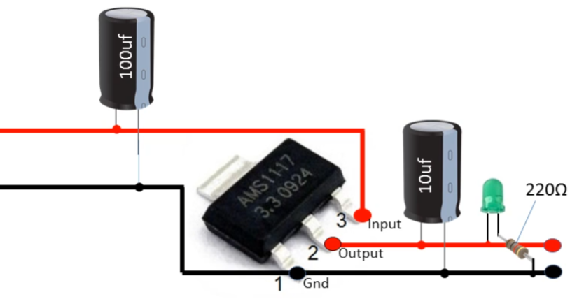

    There are many ways to find GND. You can use LDO regulator as a reference:
    T34 datasheet, pinout, flashing and common mistakes - soldering to QFN pins, LSPA9 clone smart plug
    Or you can find bulk capacitors and use their ground side.
    Circuit diagram with AMS1117, 100µF and 10µF capacitors, and a green LED with 220Ω resistor

    >>21896036 thank you for info. I just ripped off a pad so I have unsoldered chip and now I will try this way. Just one more question what I should flash on that T34 a BK7231T or BK7231N?
    I tried to flash what I get by default and that is BK7231N but can't
    I always get Getting bus failed, will try again... and that goes to 100 but flasihng doesn't work
    Failed to get bus!
    my chip is T34 2547GYYJ9
  • #11 21896661
    Posts: 14587
    Help: 654
    Rate: 12609
    T34 is BK7231N. Getting bus failed is normal, because while it's getting bus, you need to reset the plug - usually via disconnecting 3.3V wire (or 5V one ,depending on how you connected it). Basically, plug must reboot during "getting bus".
  • #12 21896728
    Blisk
    Level 4  
    Posts: 20
    >>21896661 I did that I have unpluged 3.3V and than plug it back but still the same error bus failed
    Added after 3 [hours] 29 [minutes]:
    I manage to flash openbeken on chip and soldered it back and now smart power plug works.
    what I did is power off 3.3V than connecti it and start flashing when it started I connected 3.3V and flasihng worked
  • #13 21900970
    Blisk
    Level 4  
    Posts: 20
    I have tried to flash this chip on board and it looks like I burned the chip. Is it possible to buy that chip or some simillair which will work if I just replace that chip?
    Is there any slot, where I can put that chip and flash it and then solder it back on PCB?
  • #14 21910418
    Posts: 14587
    Help: 654
    Rate: 12609
    I think T34 can't be bought that easily, it would be much easier to get another smart switch for 1-2$, depending on current special deals on Ali.

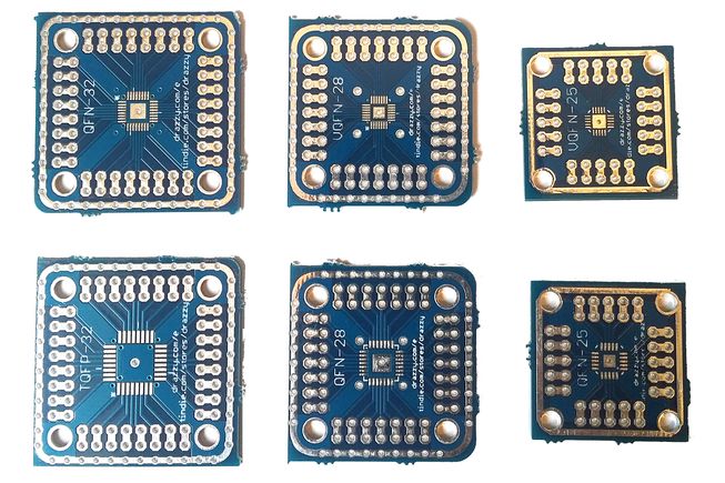

    That's a good idea, but there are no dedicated slots for T34. You can, however, use some generic QFN breakout board. Sample image:
