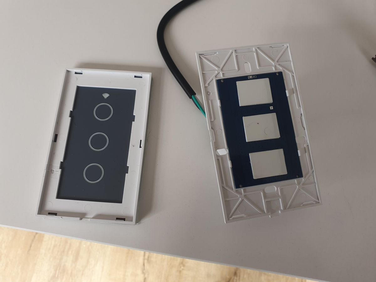

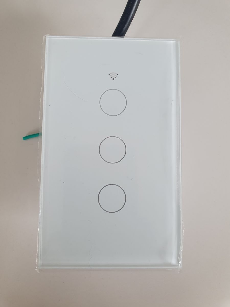

    Here is how you can flash a T34-based wall switch with OpenBeken. This switch has no programming pads available, so desoldering T34 in QFN case is required.
    Purchased from AliExpress: https://www.aliexpress.com/item/1005005732402318.html
    Packaging of a touch light switch with an illustration of a finger touching the panel. Close-up of a green product packaging with technical parameters of a wall switch.
    Nothing special in the box, comes with a capacitor and some screws, and a wiring diagram.

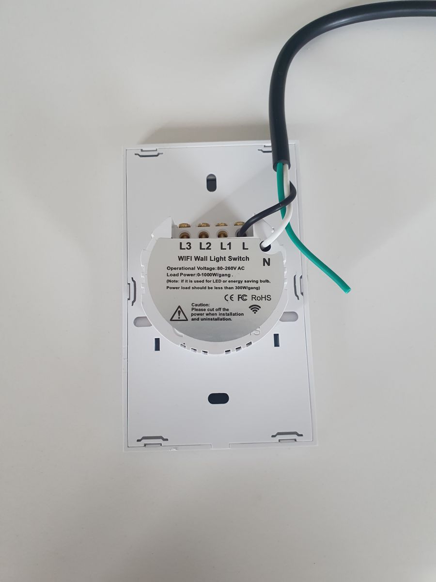

    Back of a WiFi wall switch with labels L3, L2, L1, L, and N. Touch switch with three buttons on a white panel.

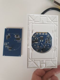

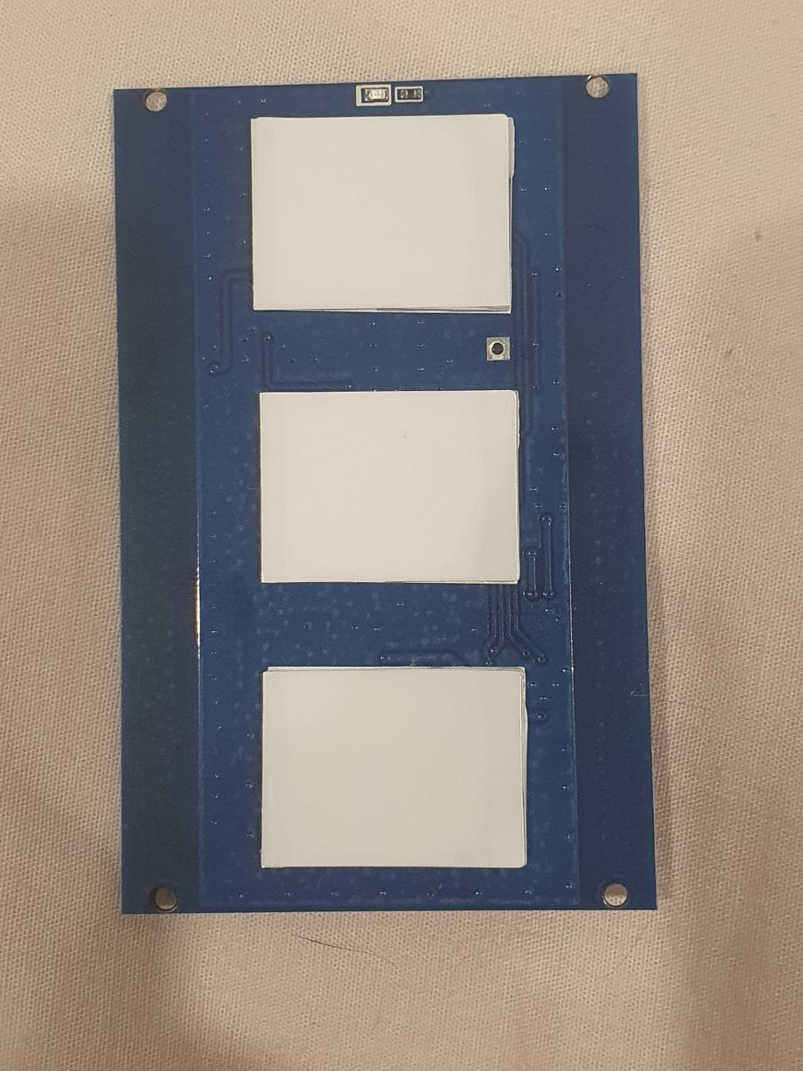

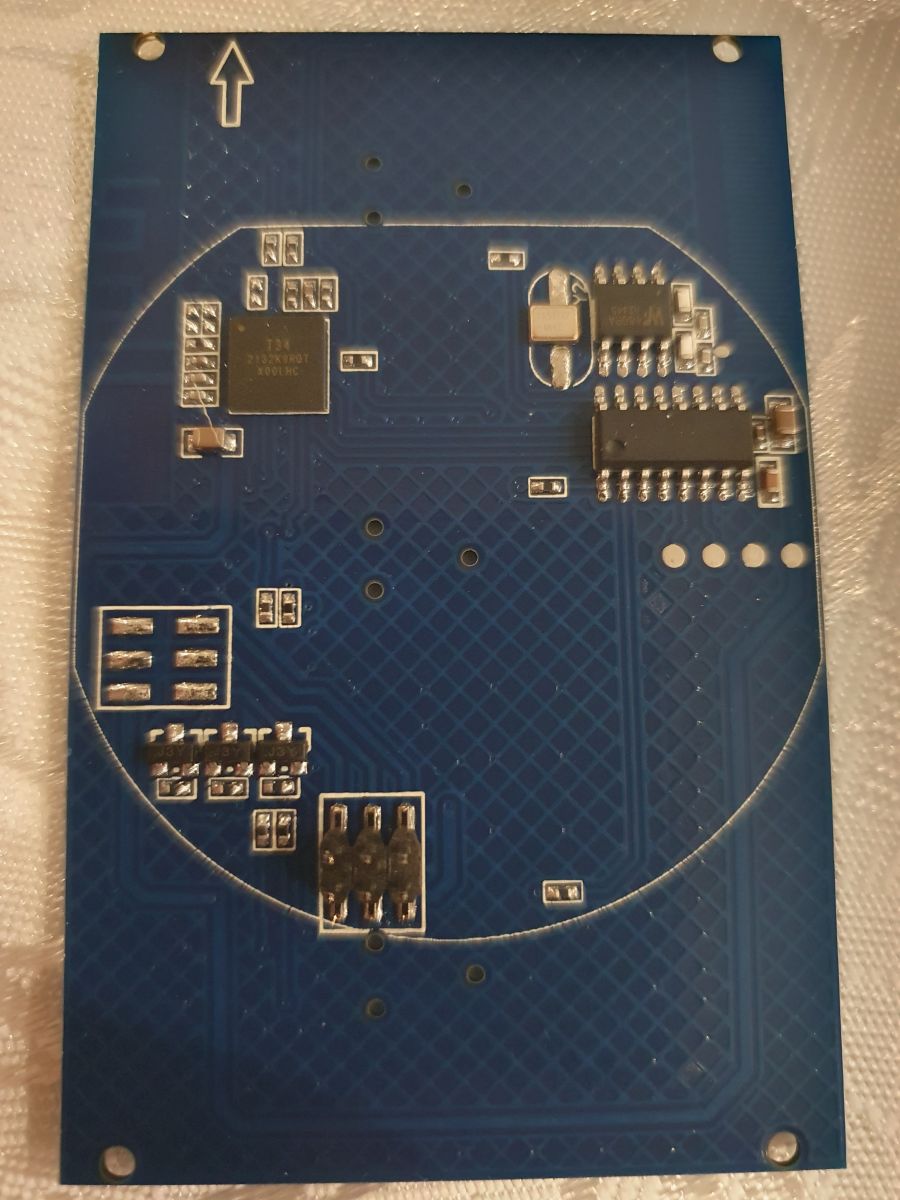

    Teardown is very straightforward, a flat head screwdriver is all that is required: Just gently lever the front glass off (There is an opening at the bottom for this purpose). Removing the motherboard is as simple as unclipping 4 plastic clips and lifting it up. It is joined to the back via 6 pins.
    The image shows a disassembled wall switch with three touch buttons and a circuit board. Two printed circuit boards with electronic components, one placed in a white frame.
    Close-up of a printed circuit board with several electronic components. Close-up of a circuit board with three white rectangles on a blue background.

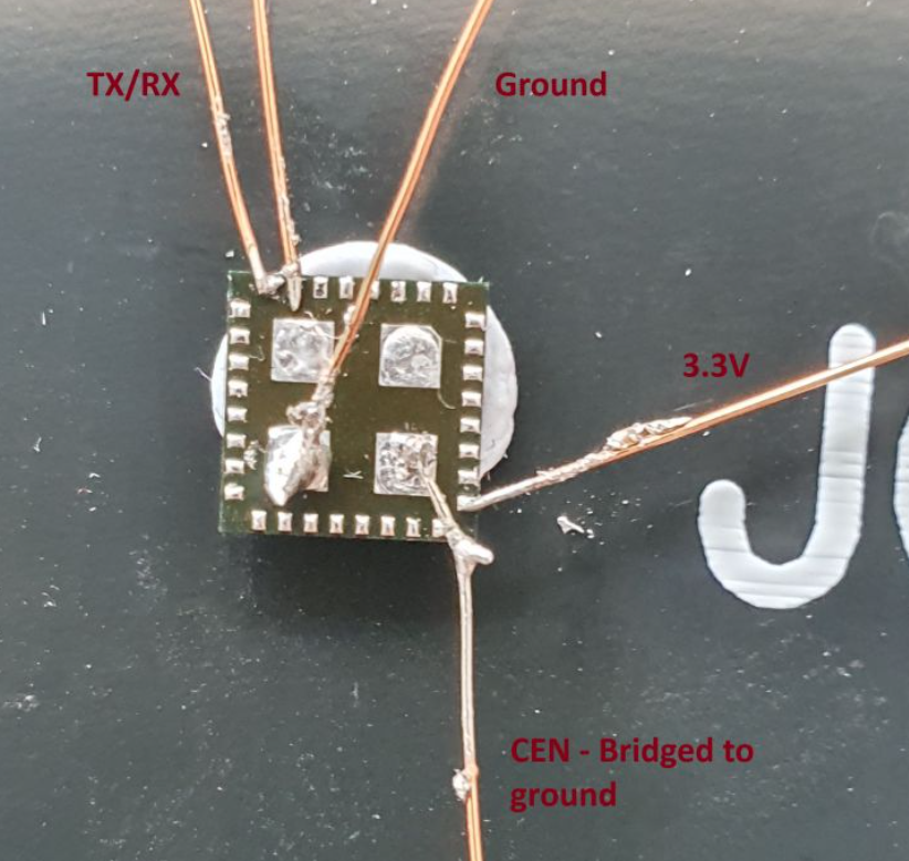

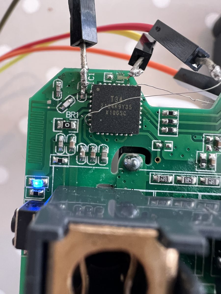

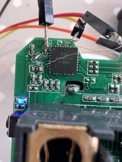

    Flashing is a lot less straightforward. This switch came patched for the cloudcutter exploit. (Firmware 1.3.10).
    The 4 pads on the board don't appear to be connected to the T34 which is the brains of the operation. The far right pad is 3.3V, the one next to it is GND, unsure of the other two.

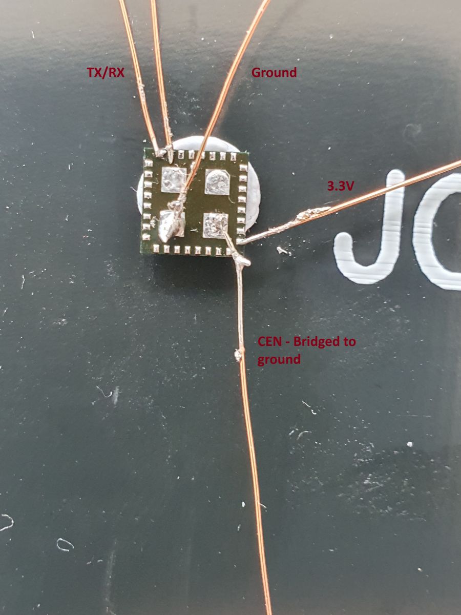

    All the pins of the T34 are hidden, so flashing is non-trivial. I had to hot air desolder it, solder some jumper wires, and then dump/flash it via bk7231flasher. Miraculously, I managed to resolder it successfully. This is not for the faint of heart.
    The dump also failed to extract the tuya config, but I was able to reverse it via inspection.
    Close-up of T34 chip with soldered wires.

    Hope this is helpful to someone, but I would strongly advise not purchasing this one. With the T34 package, and no exposed pads or silk screen, these are non-trivial to flash.

    This is the most pro way of flashing I've ever seen here:
    Image of an electronic circuit with connected wires on a board, labeled: TX/RX, Ground, 3.3V, and CEN bridged to ground.
    Just a quick question - was using CEN really necessary?
    A pro wouldn't have taken 3 hours to do it :D
    Don't know, I didn't try without grounding CEN. I just read somewhere that I needed to ground it.
    Either way, TX/RX are also inaccessible, so it required removing the IC.

    >>20968230
    Hi ! About bridge from PIN 9 - CEN to the GND : do you have it permanently or short up it when flash was started ? and what baud rate did you use ?
  • #19 21007722
    t2004dd
    Posts: 11
    Rate: 8

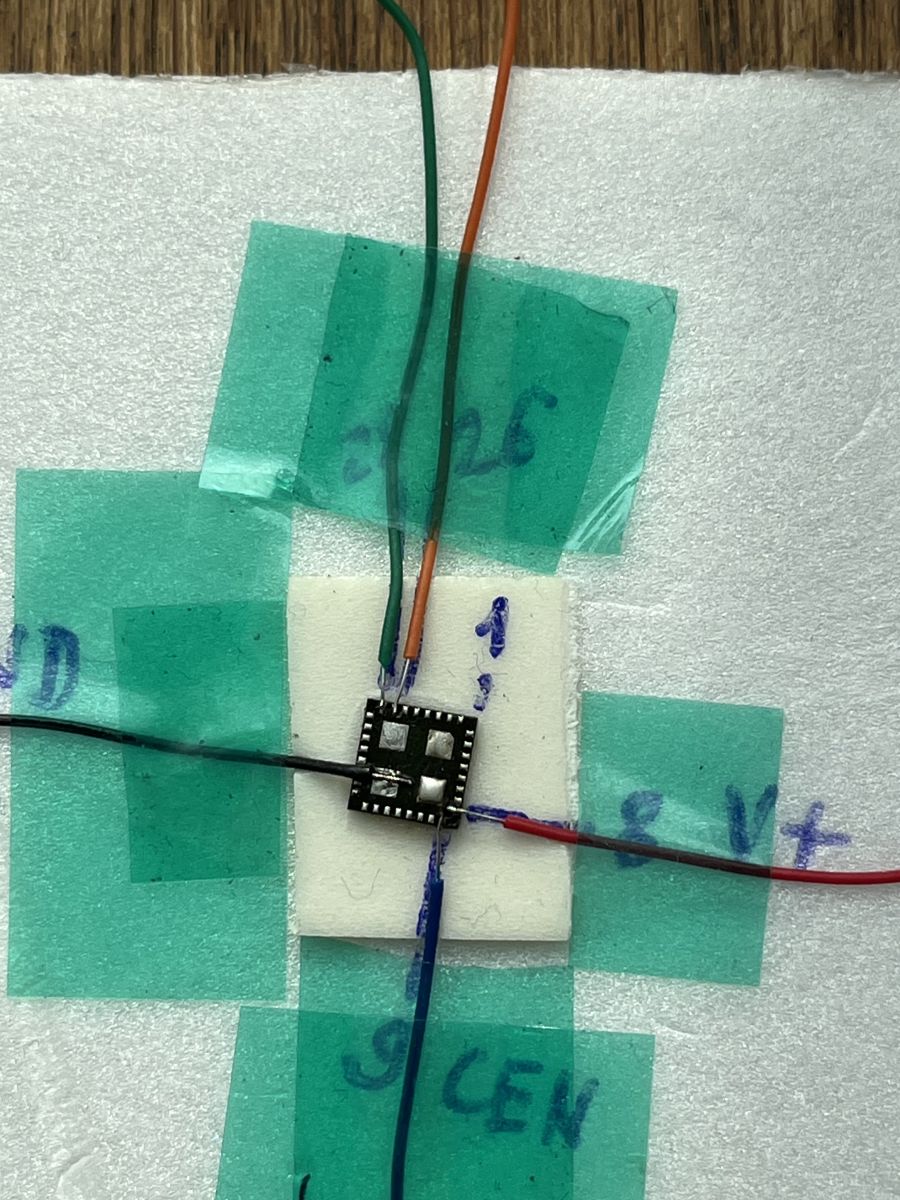

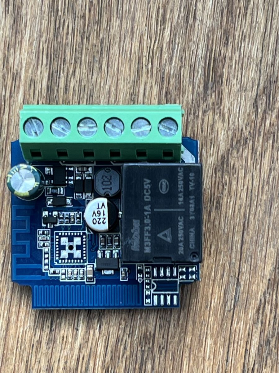

    I flashed T34 chip successfully.
    Bridge CEN is not needed. You can start flashing if you just interrupt 3.3V , attached to the PIN8.
    I flashed it with baud rate 921600.

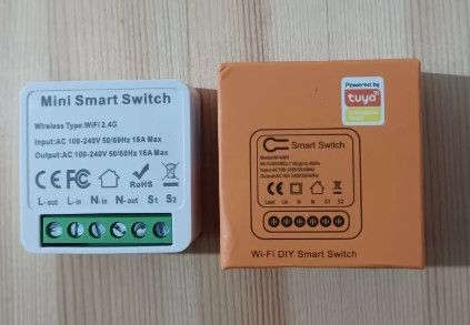

    Btw, Smart switch came from the same seller in Orange box. My advice is not to buy such switches, to avoid having the extra trouble of soldering out the T34 chip.
  • #22 21008328
    CameronDev
    Level 4  
    Posts: 12
    Rate: 15
    I wonder if this is what actually kills 3rd party firnware for Tuya devices. Im definitely not going to buy T34 devices if this is what is required to flash them. Would be nice if Tuya could provide an official flashing method.
  • #23 21008716
    t2004dd
    Posts: 11
    Rate: 8
    I have bought them from Ali very cheap. 1.87 Euro for one. May be it was reason of big discount :) Today 18.03 they are still in Ali for the same price. If it doesn't bother anyone to do a little reflow.

    I attached picture with the box and case, came to me with T34. Better look for old stock in white boxes. They came with PADs for TX/RX.
    Two boxes with a Wi-Fi smart switch on a table.
  • #26 21014447
    Posts: 14580
    Help: 654
    Rate: 12604
    I would like to get one such switch for the upcoming video for our Youtube channel . If anyone has one to spare, let me know.
    @t2004dd I don't think that all orange box switches are T34, or at least some time ago I was flashing a batch in orange boxes that weren't T34. My "orange boxes" were bought on Allegro.
    Added after 1 [hours] 27 [minutes]:
    EDIT: @t2004dd see here:
    https://www.elektroda.com/rtvforum/topic3874289-240.html#20546731
    This user has the same (?) device - even Tuya sticker matches - but in CB2S version:
    Two images of a Wi-Fi switch with a CB2S module and an orange box.

  • #28 21015737
    karayoooo
    Hello guys
    it can be done directly without unsoldering T34.
    Here in a tuya socket.
    Yes It's tricky and yes a pcb pad is quite (but not) broken but it works !
    Close-up of a circuit board with an integrated circuit and a missing capacitor marked as C1.

    CameronDev
    Level 4  
    Posts: 12
    Rate: 15
    @karayoooo Looks like your pads are exposed, so that's helpful. On my switch, they were completely covered. The serial pins were not extended out of the T34 at all. I tried to stick some sharp thin pointy sticks in under the package, but no luck there
