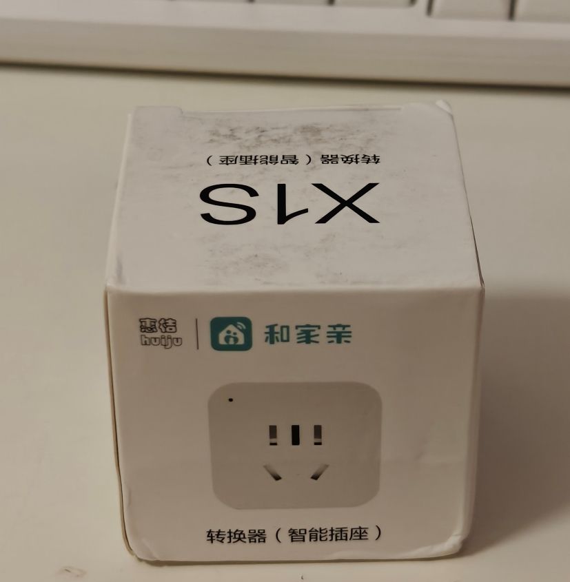

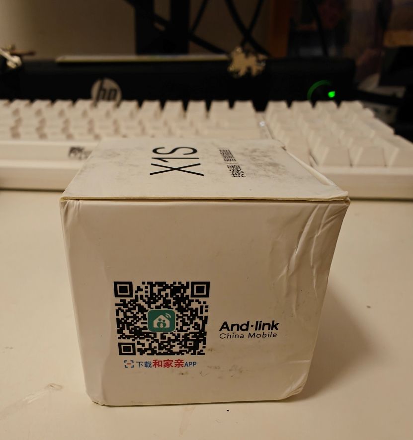

    i bought some cheap smart plus from xianyu, it seems like a product of china mobile smart home family, huiju|合家亲, it is only ¥15, that is ~2$
    Model: X1S
    Voltage:250V~
    Amps:10A
    MaxLoad:2500W
    package:
    Packaging of the X1S model with And-link logo and QR code.
    Packaging of the X1S smart gadget by HuiJu.
    Huiju X1S product box with technical details.

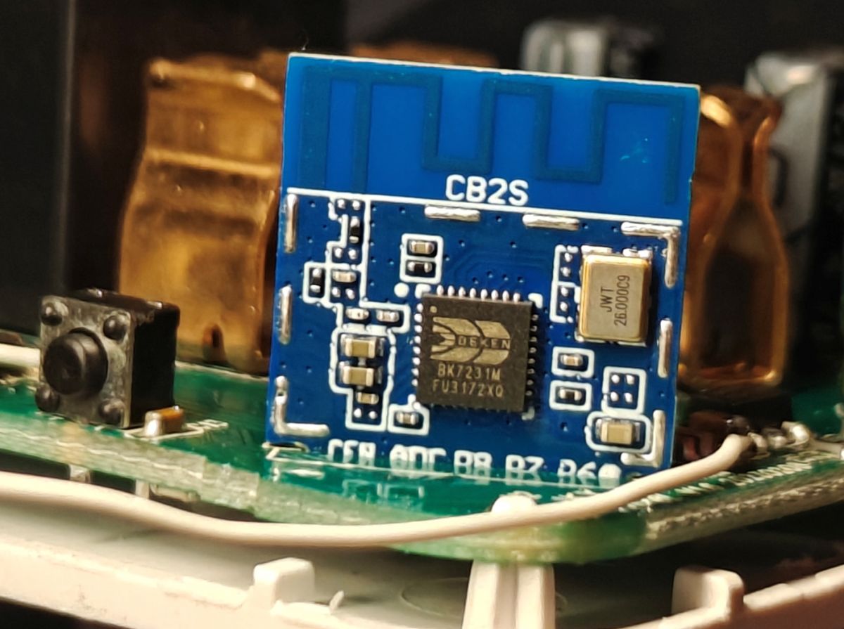

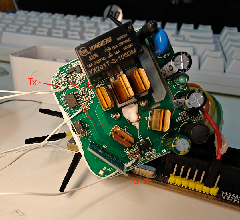

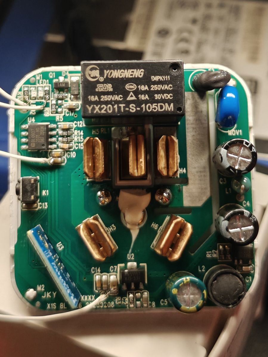

    Close-up of the interior of an electronic component with wires and components.
    Close-up of the CB2S module with BK7231N chip on a circuit board.
    X1S electronic module with components and markings on the circuit board.
    FuncPin
    StatusLedP11
    RelayP8
    Relay LedP10
    RelaySwitchButtonP24
    BL0937 SELP26
    BL0937 CFP6
    BL0937 CF1P7

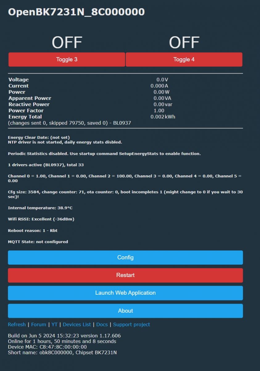

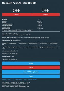

    it uses CB2S module,configuration verified,
    Screenshot of the OpenBK7231N device control panel.
      "vendor": "HuiJu",
      "bDetailed": "0",
      "name": "huiju",
      "model": "X1S",
      "chip": "BK7231N",
      "board": "X1S BL v1.6",
      "flags": "1024",
      "keywords": [
        "TODO",
        "TODO",
        "TODO"
      "pins": {
        "6": "BL0937CF;1",
        "7": "BL0937CF1;2",
        "8": "Rel;3",
        "10": "LED_n;4",
        "11": "LED_n;3",
        "24": "Btn;3",
        "26": "BL0937SEL;5"
      "command": "",
      "image": "https://obrazki.elektroda.pl/6158913500_1719154715_thumb.jpg",
      "wiki": "https://www.elektroda.com/rtvforum/topic3979012.html"
    origional firmware backup from bk7231flasher_1.3.3
    I backuped this origional firmware without first setup
    • readResult_BK7231M_QIO_X1S_2024-23-6-16-16-02.bin (2 MB) You must be logged in to download this attachment.
