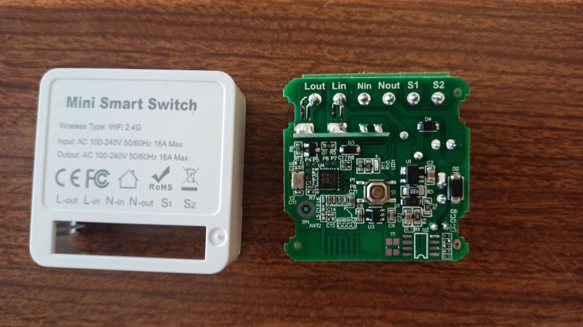

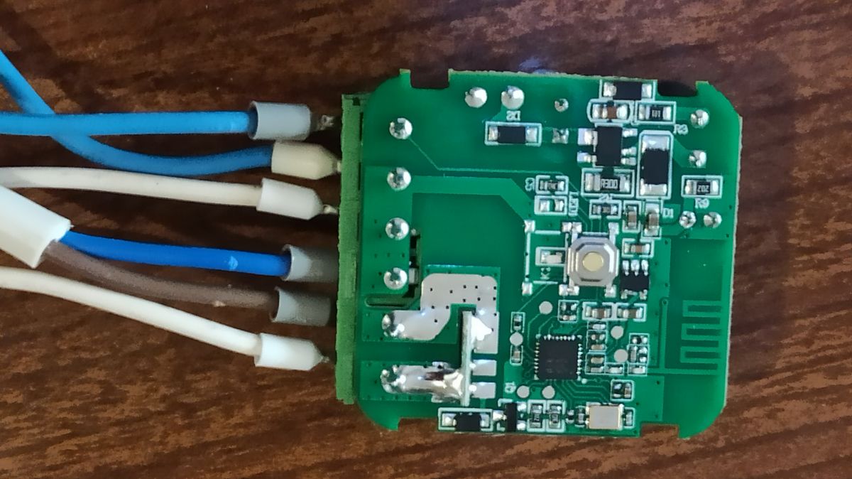

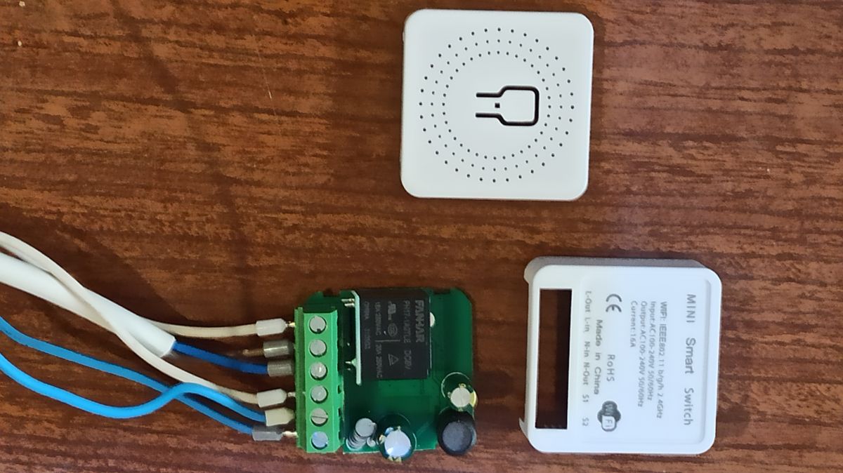

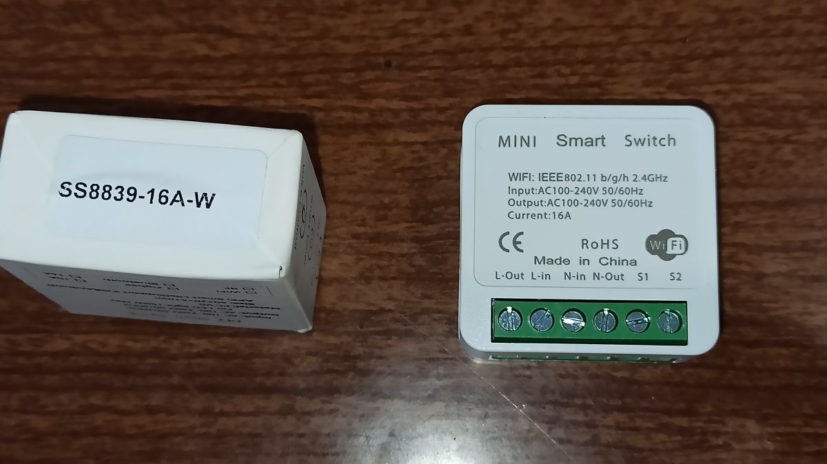

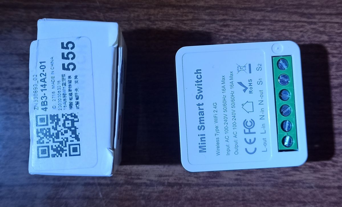

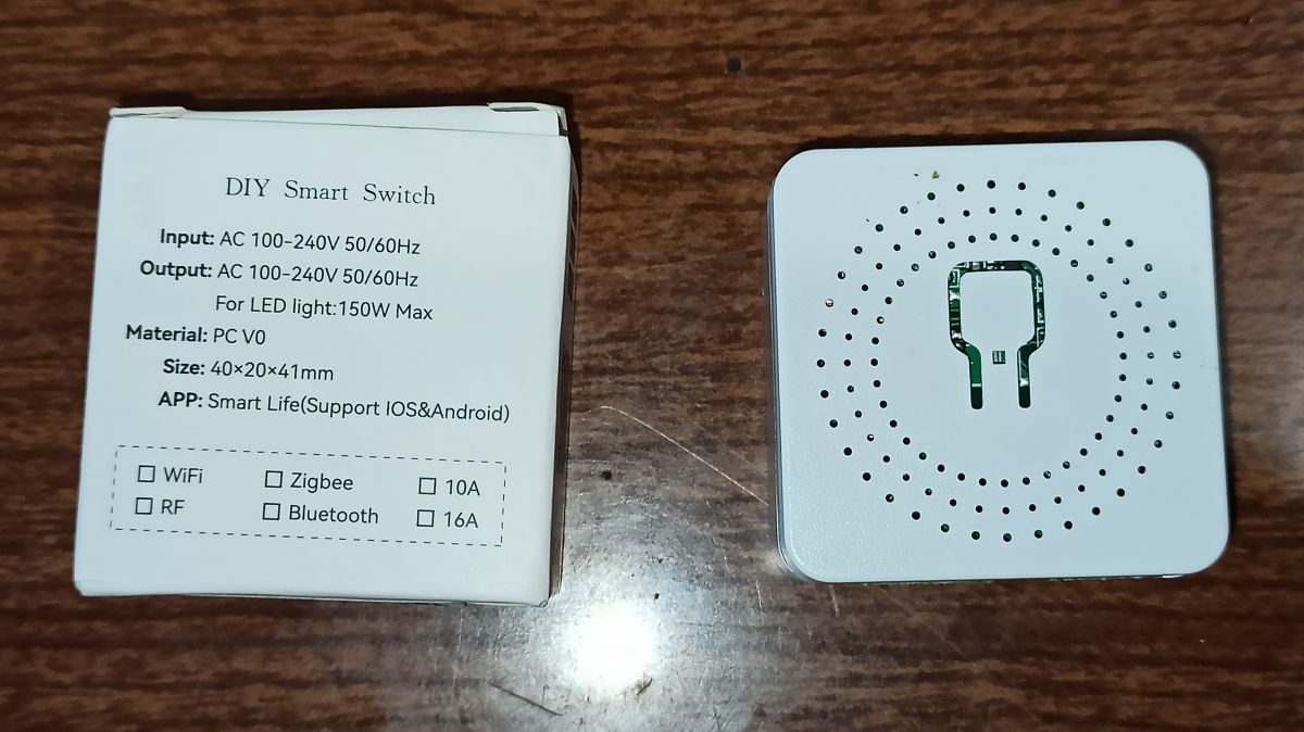

  • This is a short teardown of the DIY Mini Smart Switch 2-way from UNSH model SS8839-16A-W based on BK7231N.
    It uses custom PCB, so no Tuya module to replace, already bought one :-)
    Basic Information
    Brand: UNSH - Tuya
    Model: DIY Smart Switch SS8839-16A-W
    Chip: BK7231N on board
    Seller: AliExpress 16A Tuya WiFi Smart Switch 2-way
    Photos
    The switch is very easy to open so i wont go into details, but remember, this device it's using high voltage, so make sure it's not connected to the mains.
    [BK7231N] (DIY) Mini Smart Switch UNSH SS8839-16A-W
    [BK7231N] (DIY) Mini Smart Switch UNSH SS8839-16A-W [BK7231N] (DIY) Mini Smart Switch UNSH SS8839-16A-W [BK7231N] (DIY) Mini Smart Switch UNSH SS8839-16A-W
    Flashing-Uploading OpenBeken firmware
    Used tuya-cloudcutter to flash OpenBK (had to setup in SmartLife/Tuya app - after first flash device did not connect to cloudcutterflash AP)
    Followed this instructions tuya-cloudcutter INSTRUCTIONS.md
    and video Flash OTA using tuya-cloudcutter
    > By firmware version and name
    > ~ Mini Smart Switch
    > 1.2.1 - BK7231N / oem_bk7231n_control_switch
    OpenBK7231N_UG_1.15.648.bin (CCtr flash)
    Requirements:
    RPi to install GitHub tuya-cloudcutter
    Firmware OpenBK7231N_UG_1.15.648.bin
    Router/AccesPoint for temporary local cloudcutterfalsh AP
    some patience and persistence :-)
    Device could not connect to cloudcutterflash AP after reboot,
    so I needed to create a "second" cloudcutterflash AP on spare Router with internet connection as stated in Note: of INSTRUCTIONS.md.
    Had to disable WiFi on RPi - tuya-cloudcutter
    After that it was possible to enter WiFi credentials thru Tuya app.
    Turned off "second AP", enabled tuya-cloudcutter and the process of flashing OpenBeken continued.

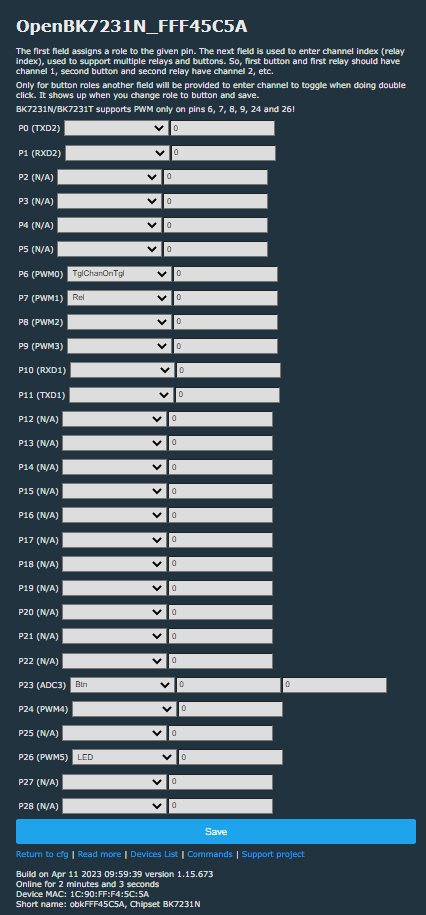

    Pin settings for this device.
    TglChanOnTgl - 6 - PWM0 - ch0
    Rel - 8 - PWM1 - ch0
    Btn - 23 - ADC3 - ch0
    LED - 26 - PWM5 - ch0

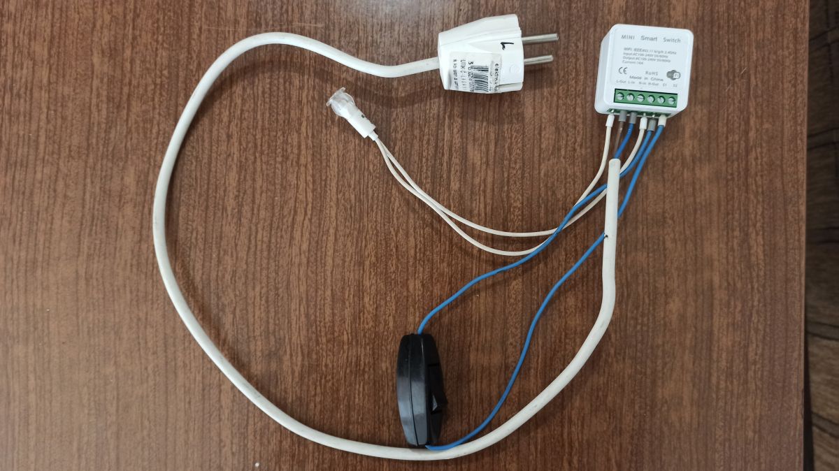

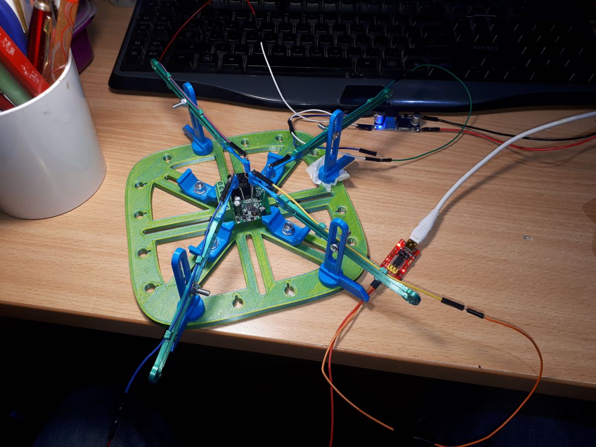

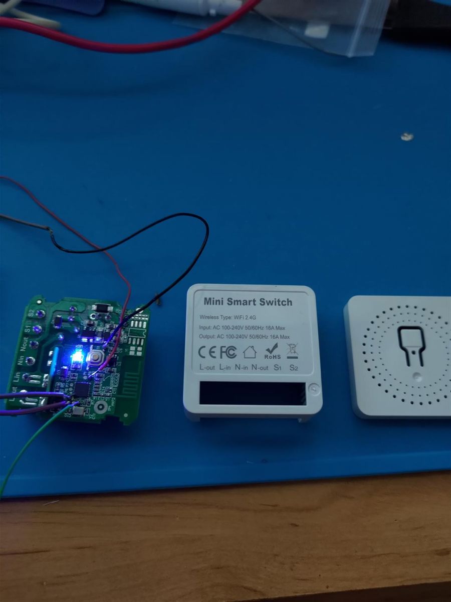

    Simple test environment

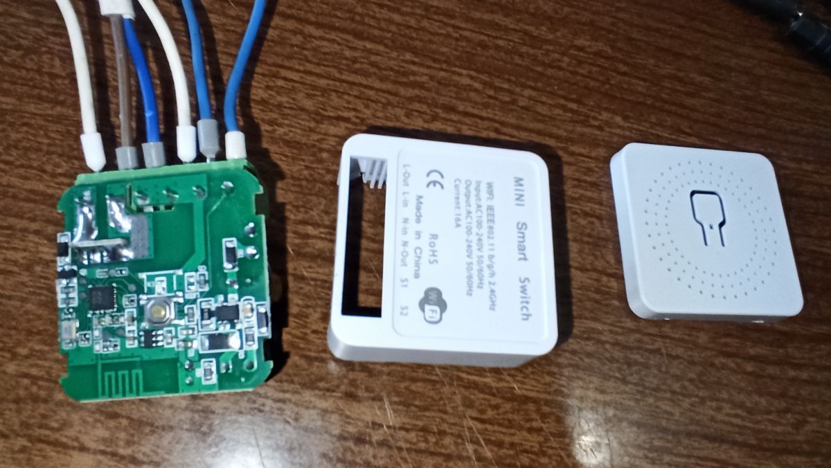

    #3 20537640
    riskorja
    >>20524167
    This is a short teardown of the same seller and the same order and the same package
    Basic Information
    Brand: UNSH - Tuya
    Photos
    but different pins
    Rel - 7 - PWM1 - ch0

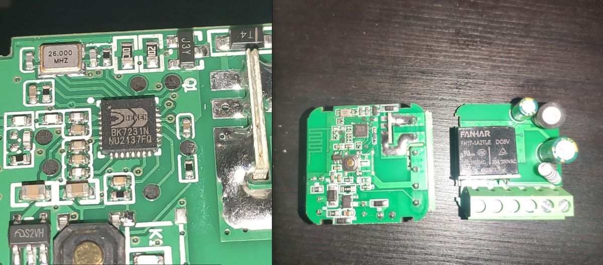

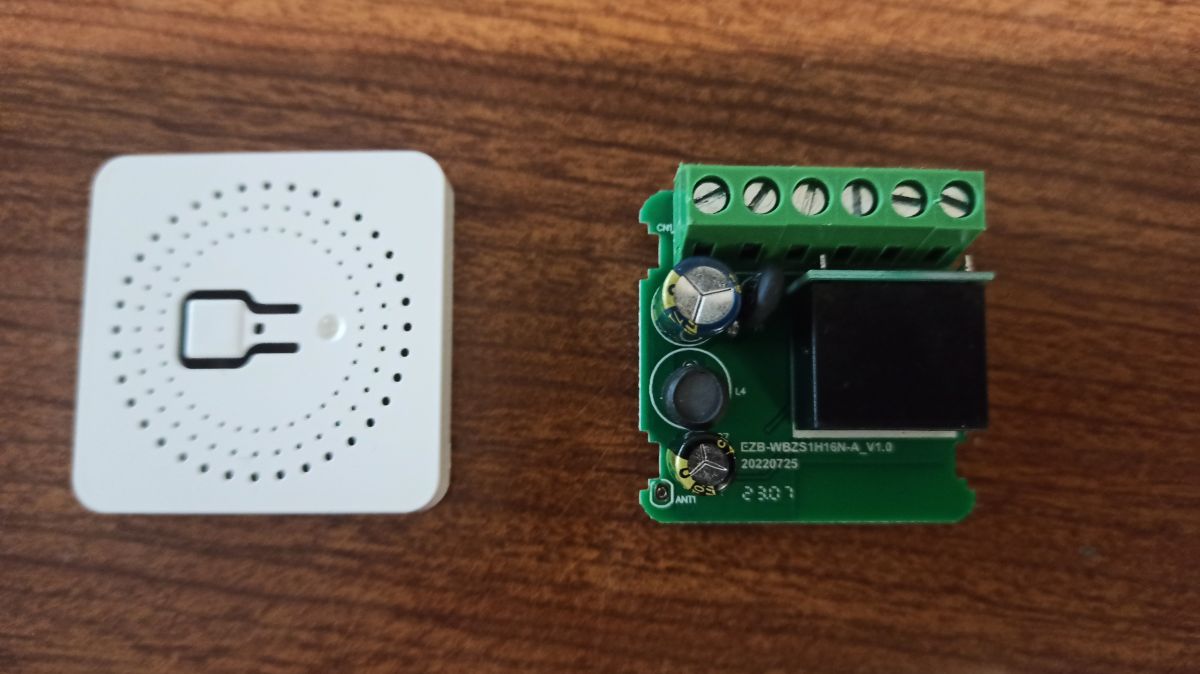

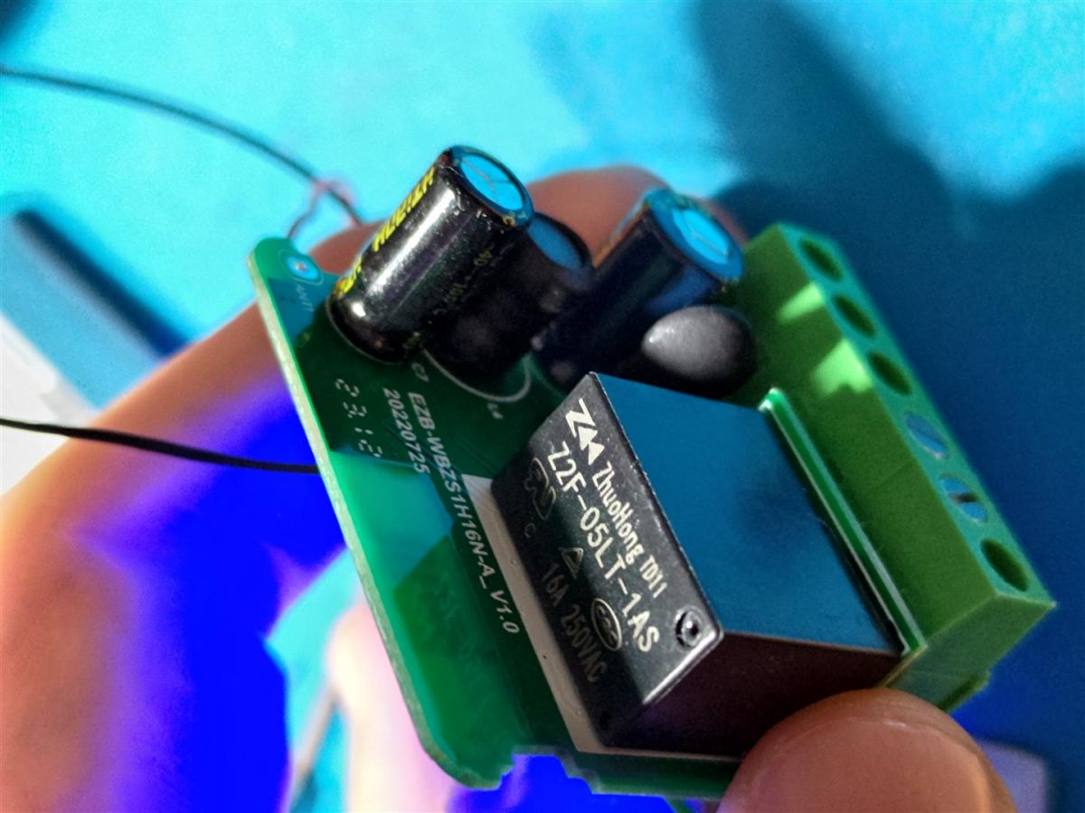

    #4 20538893
    riskorja
    >>20524167
    This is a short teardown of the same seller and the same order and the different package

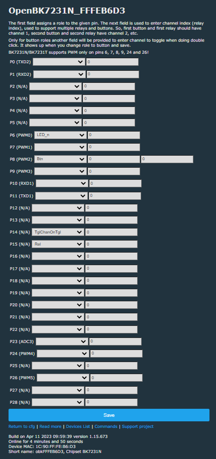

    Smart Mini Switch 2-way from UNSH model EZB-WBZS1H16N-A V1.0 based on BK7231N.
    Basic Information
    Brand: UNSH - Tuya
    Model: EZB-WBZS1H16N-A V1.0
    Photos
    but different board layout and pins
    Relay has marking but should be 16A
    and soldering space for 433 MHz chip and antenna
    LED_n - 6 - PWM0 - ch0
    Btn - 8 - PWM2 - ch0
    TglChanOnTgl - 14 - - ch0
    Rel - 15 - - ch0

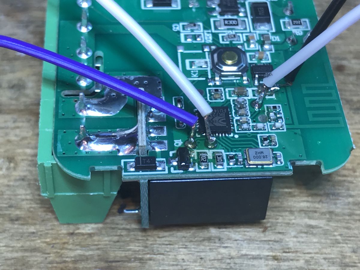

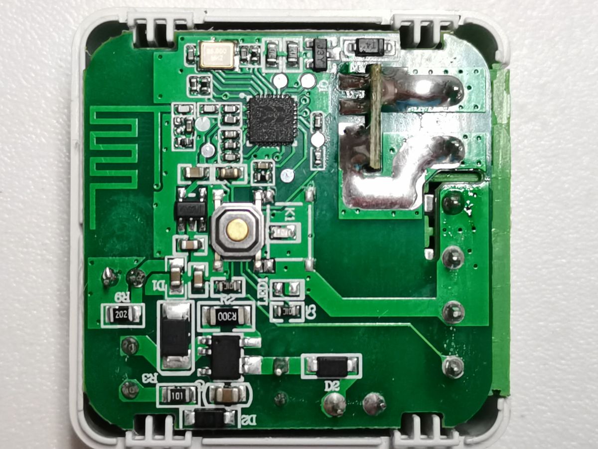

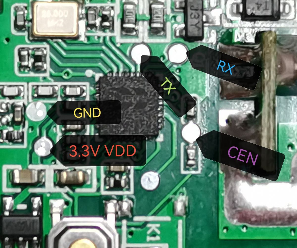

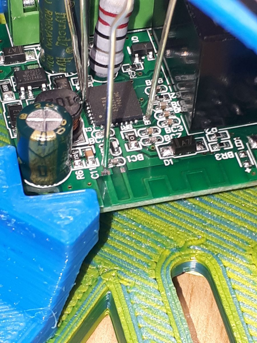

  • #5 20737342
    fot201113
    Close-up of a Mini Smart Switch circuit board with visible components and chip.
    Back view of a Mini Smart Switch with specification and connection information.

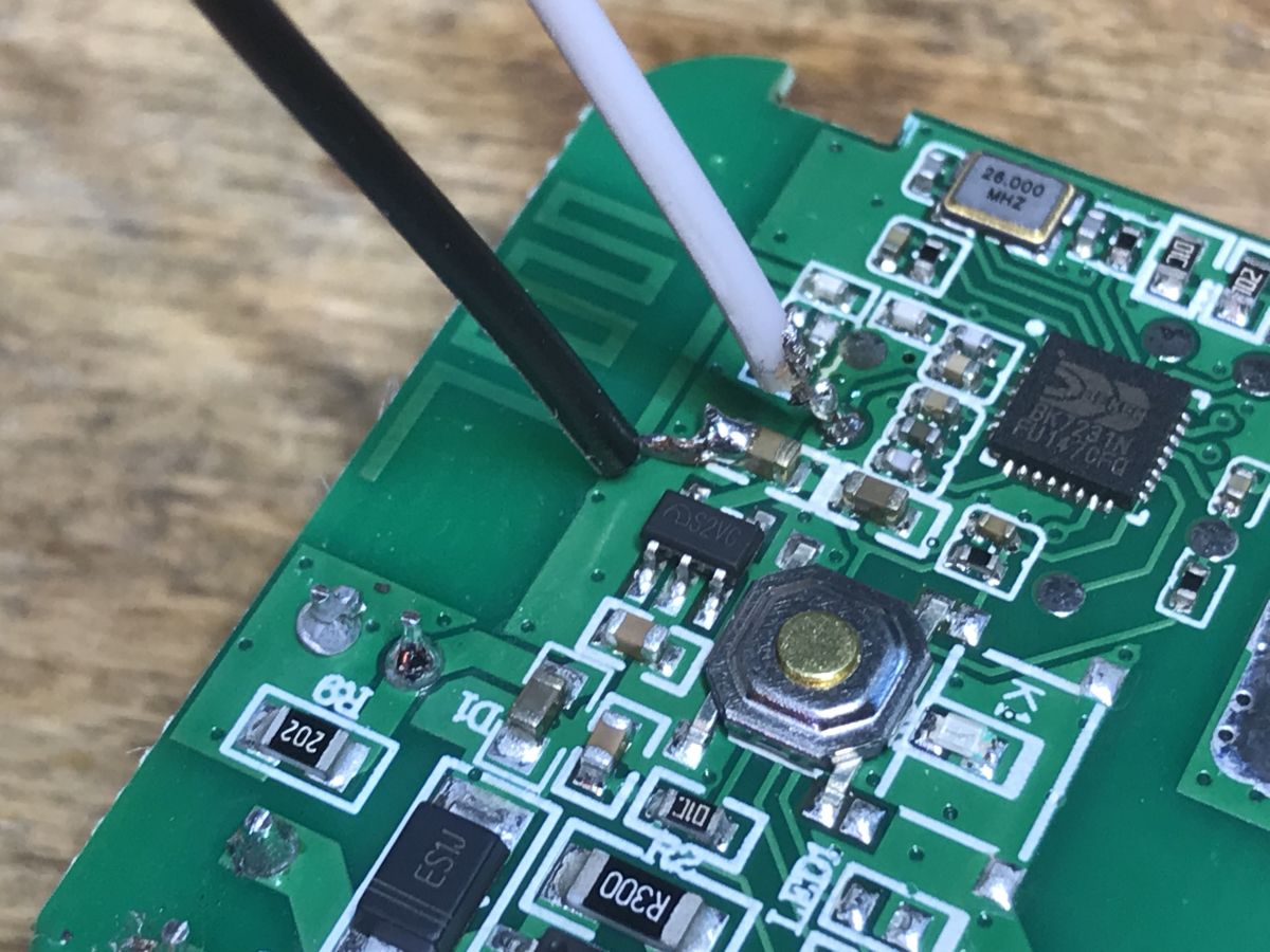

    I opened 2 new Mini Smart Switches and they seem to be this version here. Can anyone help me locate the flashing pins?

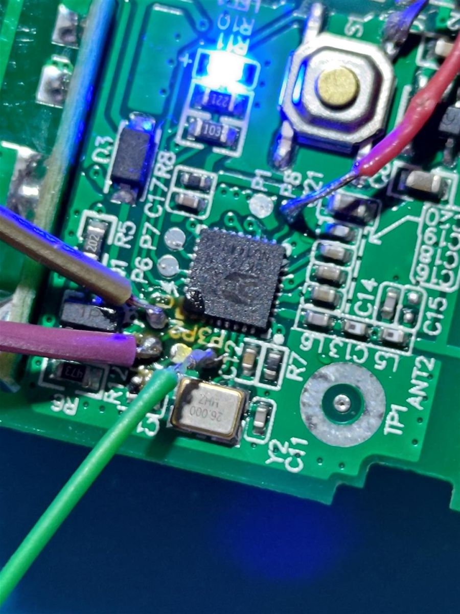

  • #6 20737346
    Posts: 14754
    Rate: 12875
    So you have the same board as me?
    Close-up of a circuit board with electronic components and 26.000 MHz text.
    Here is GND (black) and 3.3V (white):
    Close-up of a circuit board with connected GND (black) and 3.3V (white) wires.
    Here is RX and TX:
    Close-up of a circuit board with connected wires.
    It's a small world.
  • #7 20737347
    fot201113
    hahah that was blazing fast!!
    thanks a lot!!!
  • #8 20797138
    elbuit
    Posts: 10
    Rate: 7

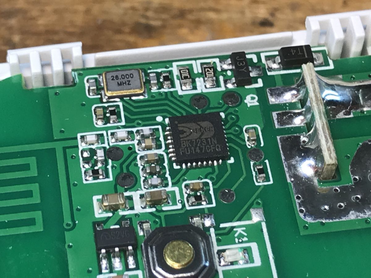

    Same device with same pins but it came with tuya V1.3.10 firmware, so I couldn't use tuya cloudcutter.
    But It worked with serial port:
    Close-up of a circuit board with pin labels: GND, 3.3V VDD, TX, RX, CEN.
    Circuit board of a device with electronics and components.

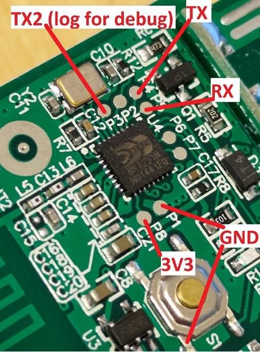

  • BK7231N flashing notes and GPIO pinout for EZB-WBZS1H16N-A

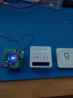

    #10 20842297
    cyrax4
    Very similar device, but different pads. Flashed with CP2102 USB UART. Ground soldering is easier at the switch however P1 pad also working (I used the switch).
    Important: CP2102 don't provide enough juice to power it up so had to solder TX2 for debugging. Anyhow it is not necessary if UART debug not needed.
    Chip: BK7231N
    Device: https://www.aliexpress.com/item/1005005021644441.html
    ROM: OpenBK7231N_QIO_1.17.308.bin (latest at the time of flashing)
    GPIO pinout:
    P6 - WifiLed_n - ch0
    P8 - Btn_Tgl_All - ch0
    P14 - TglChanOnTgl - ch1
    P15 - Rel - ch1
    JSON:
    Printed circuit board and casing of a mini smart switch on a blue workspace mat.Close-up of a circuit board with connectors and a relay on a blue background.Close-up of a circuit board with labels TX2, TX, RX, GND, and 3V3.Close-up of a circuit board with electronic components, including wires and chips.

  • CP2102 needs extra power for BK7231N flashing
    #14 20889653
    ChrizZz
    Posts: 10
    Chip: BK7231N
    Did you also find the CEN pad?
  • #15 20889669
    Posts: 14754
    Rate: 12875
    @ChrizZz to the best of my knowledge no CEN is required. I flashed hundreds of devices via wires so far and I am not using CEN for that.
  • #16 20889698

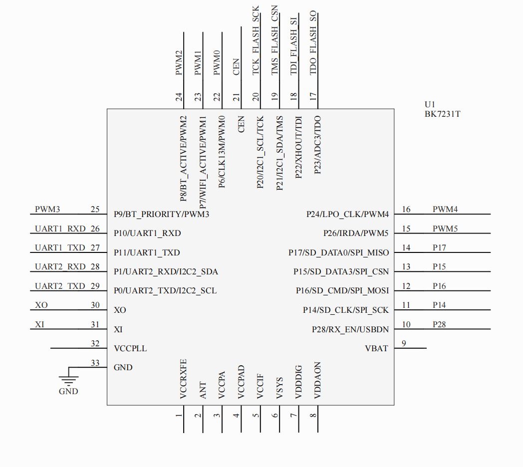

    Here are our guides:
    See this playlist:
    https://www.youtube.com/watch?v=L6d42IMGhHw&list=PLzbXEc2ebpH0CZDbczAXT94BuSGrd_GoM
    If you really need CEN, then here is BK pinout:
    Pinout diagram of the BK7231T chip.
    You can try to use it as reference to find where CEN might be on your board.

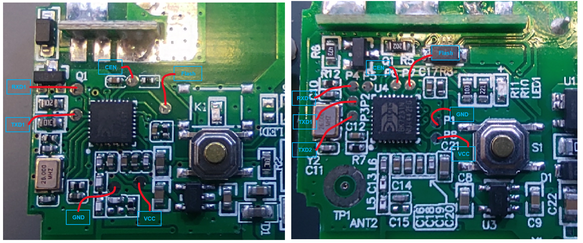

    mrAtini

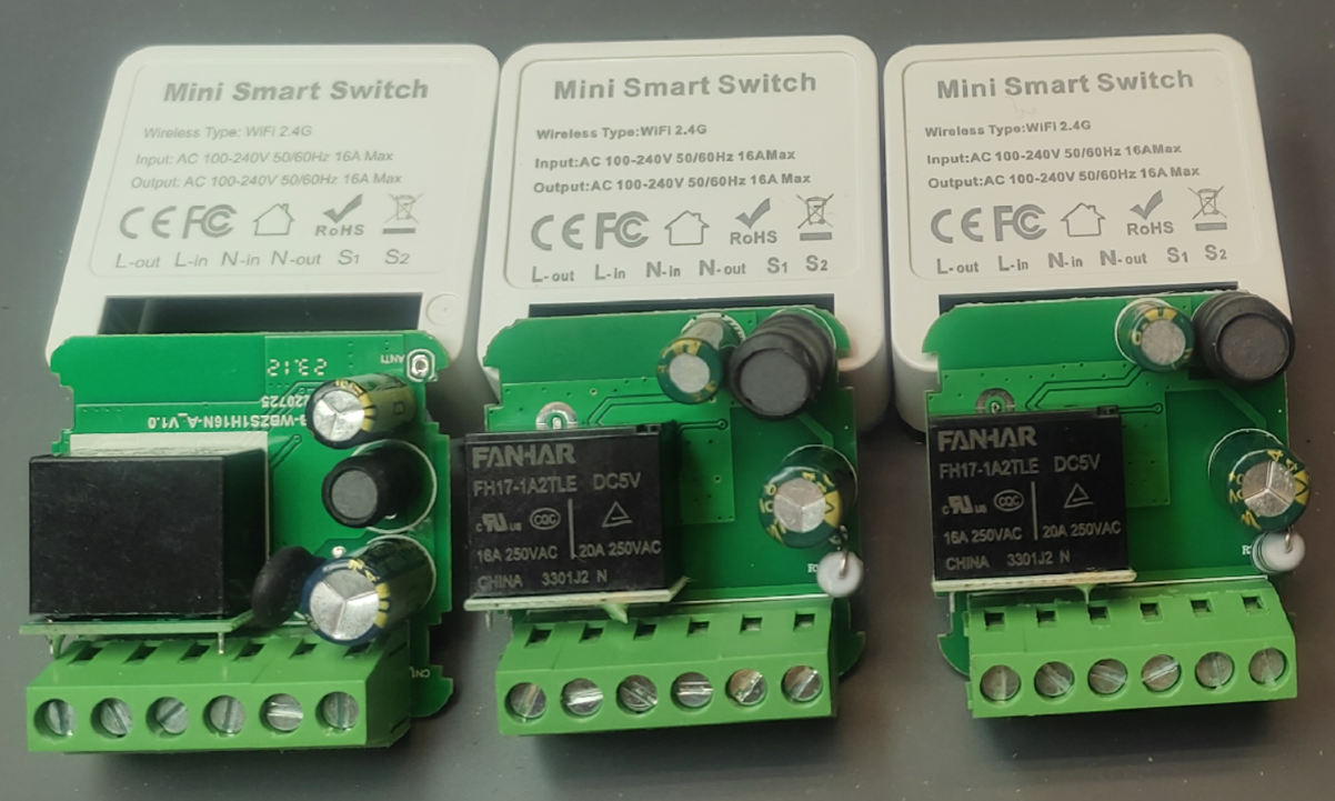

    Hi,
    I bought a few pieces of those devices on AliExpress "Choice" (less than 2€)
    I found that there is 2 different PCBs ( for the moment :-) )
    Here's the pinout i have:
    Two images showing circuit boards with labeled programming points and an integrated circuit.
  • #19 20906558
    Posts: 14754
    Rate: 12875
    Is there any way to tell which is which from the outside? I don't know, maybe one is 10A version and second 16A?
  • #20 20906629
    mrAtini
    Unfortunately no. From the outside they are exactly the same (and 16A for both)

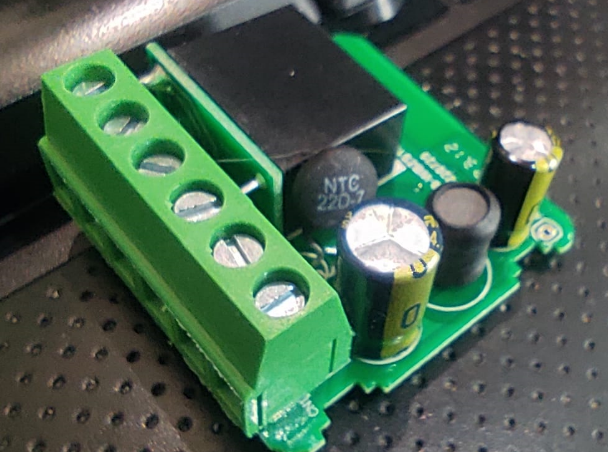

    Three mini smart switches with visible circuit boards and electrical components on a table.
  • #21 20906683
    Posts: 14754
    Rate: 12875
    Wait, the new one has a varistor but it's missing fusible resistor?
  • #22 20906820
    mrAtini
    It's a 22ohms NTC replacing the 10ohms resistor (not fusilble) .
    I do not understand yet why they chose an NTC (R goes down when t° increases)
    Close-up of a PCB with electronic components, including a 22-ohm NTC and capacitors.

    pkkrusty
    I have this type, but found that the relay is on GPIO 7, rather than GPIO 8. I bought the power meter variety, is there a template for making that work?
    I'm just getting started with OpenBeken, and was able to flash via the pads successfully, but then had trouble getting the unit to stay alive while i configured the pins. It would crash after 30 seconds. But once the pins were defined correctly, it seems more stable.
    Also the unit seems quite warm, even with no load attached. Is that normal? I have put PowerSave 1 in the startup commands.
  • #24 20992272
    Posts: 14754
    Rate: 12875
    Power metering is supported. Which metering chip is inside, BL0942 or BL0937?
    Please try to extract the config:
    https://www.youtube.com/watch?v=WunlqIMAdgw
    How did the pins affect the device, what config made it crash? It's the first time I've hear about something like that.
    How did you put PowerSave 1 in startup commands? Maybe it's not run?

    #25 20992948
    pkkrusty
    Configuration interface with startup command PowerSave 1 for a water-heater device.
    My config is as follows:
    "vendor": "Tuya",
    "bDetailed": "0",
    "model": "enter short model name here",
    "chip": "BK7231N",
    "board": "TODO",
    "flags": "0",
    "keywords": [
    "TODO",
    "TODO",
    "TODO"
    "pins": {
    "6": "TglChanOnTgl;0",
    "7": "Rel;0",
    "23": "Btn;0",
    "26": "LED;0"
    "command": "PowerSave 1",
    Power monitor chip is BL0942. I entered "startDriver BL0942" and now I can see measurements on main page. Amazing!
  • #26 21040987

    Rate: 13
    mrAtini wrote:
    Hi,
    There seems to be a "flash" pad it the second picture. Do I need it somehow to flash this device?
  • #27 21041271
    Posts: 14754
    Rate: 12875
    I don't know what this person means. You need only RX, TX and optionally CEN.
    See our BK7231 flasher:
    You can also check out BK7231N and BK7231T video guides here:
    https://www.youtube.com/playlist?list=PLzbXEc2ebpH0CZDbczAXT94BuSGrd_GoM

    Rate: 13
    I bough four of them two have BK7231N and the other two T34. I have not managed to flash a single one yet. Whatever I do.
    I'm now waiting for a new TTL adapter. My gear is quite old. I suppose I already ruind one of those T34 devices by getting a partial flash making only a corrupt boot loader.

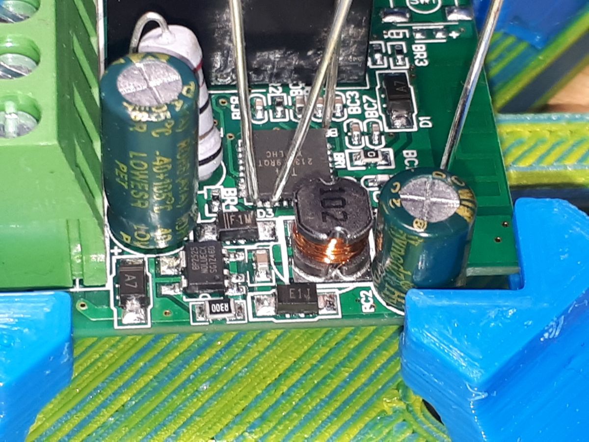

  • BK7231N mini smart switch flashed with needle probe jig
    #29 21066589
    tonyb62
    Posts: 37

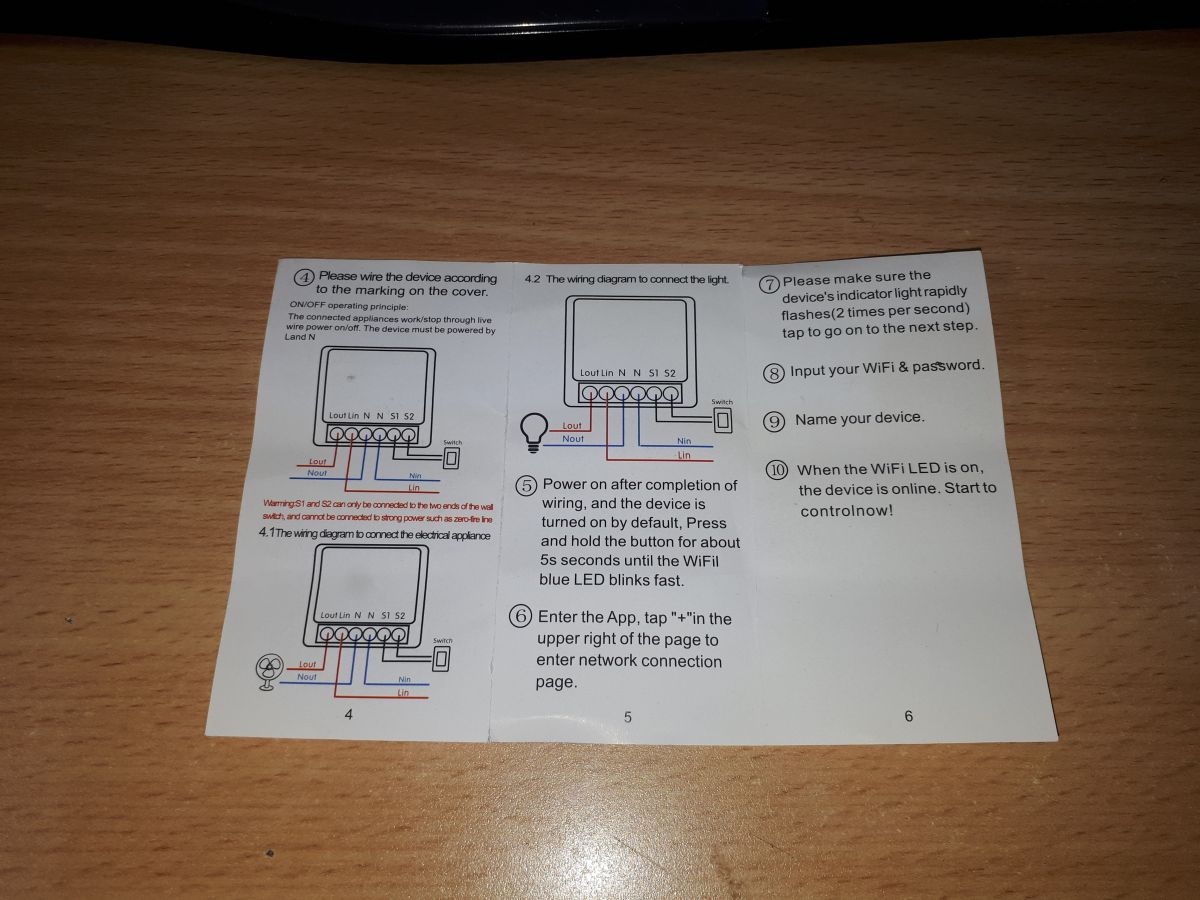

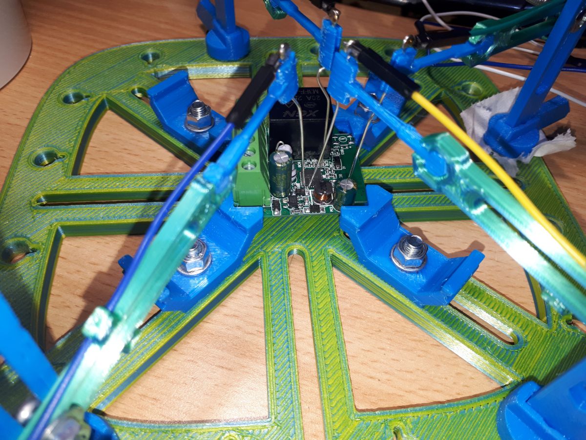

    Hi all,
    I've come across another variation of this "Mini Smart Switch" from AliExpress.
    All major components are on the top of the board, was able to flash it with my needle probe jig.
    Doesn't have power monitoring as far as i can see, T34 BK7231N chip.
    Instruction manual for Mini Smart Switch with connection diagrams. User manual for Mini Smart Switch from AliExpress. Close-up of a circuit board with visible electronic components and a needle probe. Close-up of a Mini Smart Switch circuit board with visible electronic components. Mini Smart Switch PCB with components on top, placed in a specialized holder. Home setup with an electronics board and clamps on a desk.
    Working Config
    "vendor": "Tuya",
    "bDetailed": "0",
    "name": "AP-SMT-Breaker02-CH1",
    "chip": "BK7231N",
    "board": "TODO",
    "flags": "1024",
    "keywords": [
    "TODO",
    "TODO",
    "TODO"
    "pins": {
    "6": "WifiLED_n;1",
    "14": "TglChanOnTgl;1",
    "15": "Rel;1",
    "24": "Btn;1"
    "command": "backlog PowerSave 1",
  • #30 21066615
    Tilator
    Posts: 139
    Rate: 13
    tonyb62 wrote:
    Hi all,
    I have two of those too. TX is connected to component BR4.
    You can also try Btn_Tgl_All as P14.

  • EZB-WBZS1H16N-A V1.0 used another layout: LED_n on P6, button on P8, wall toggle on P14, and relay on P15. [#20538893]
