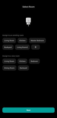

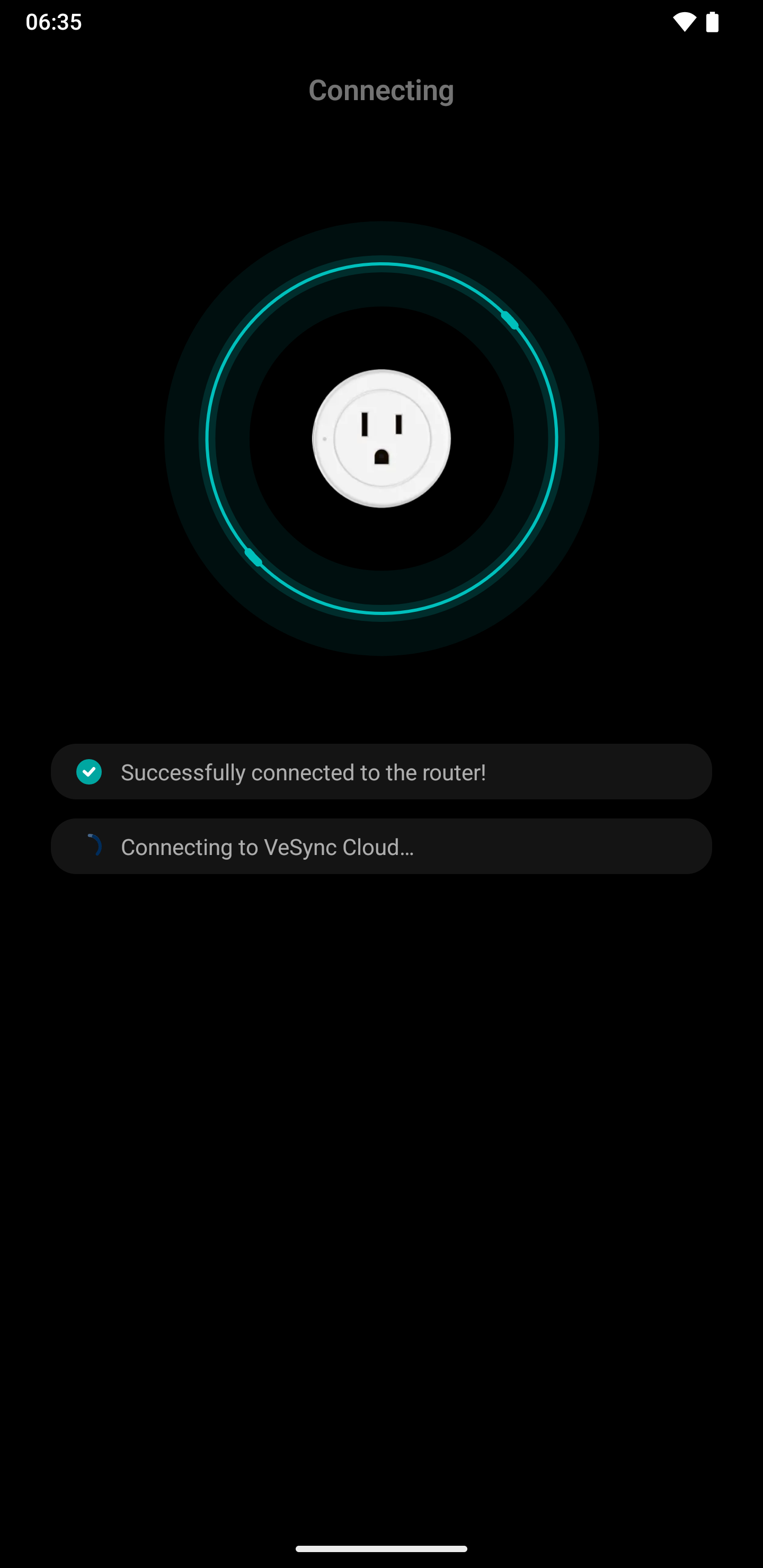

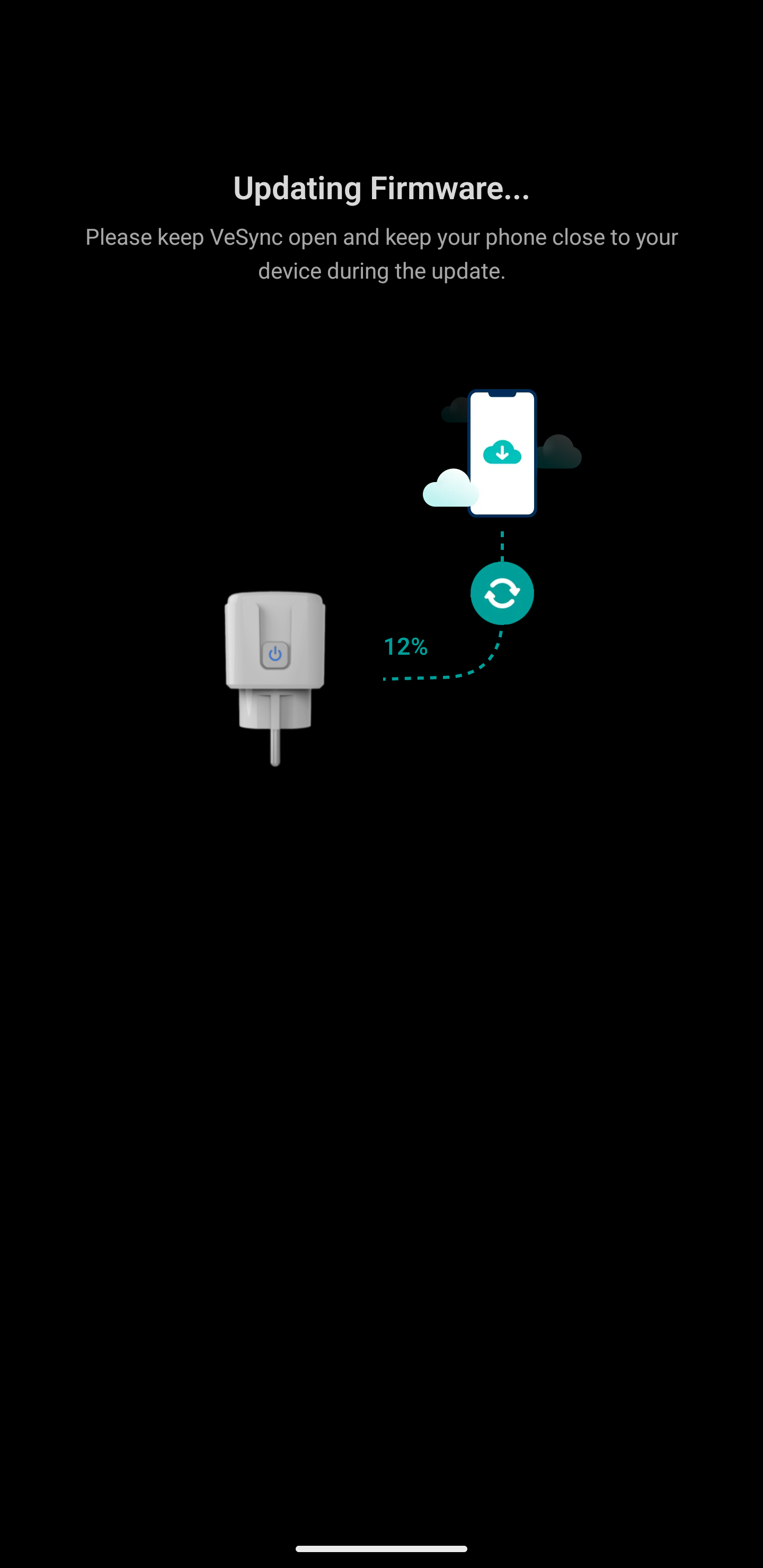

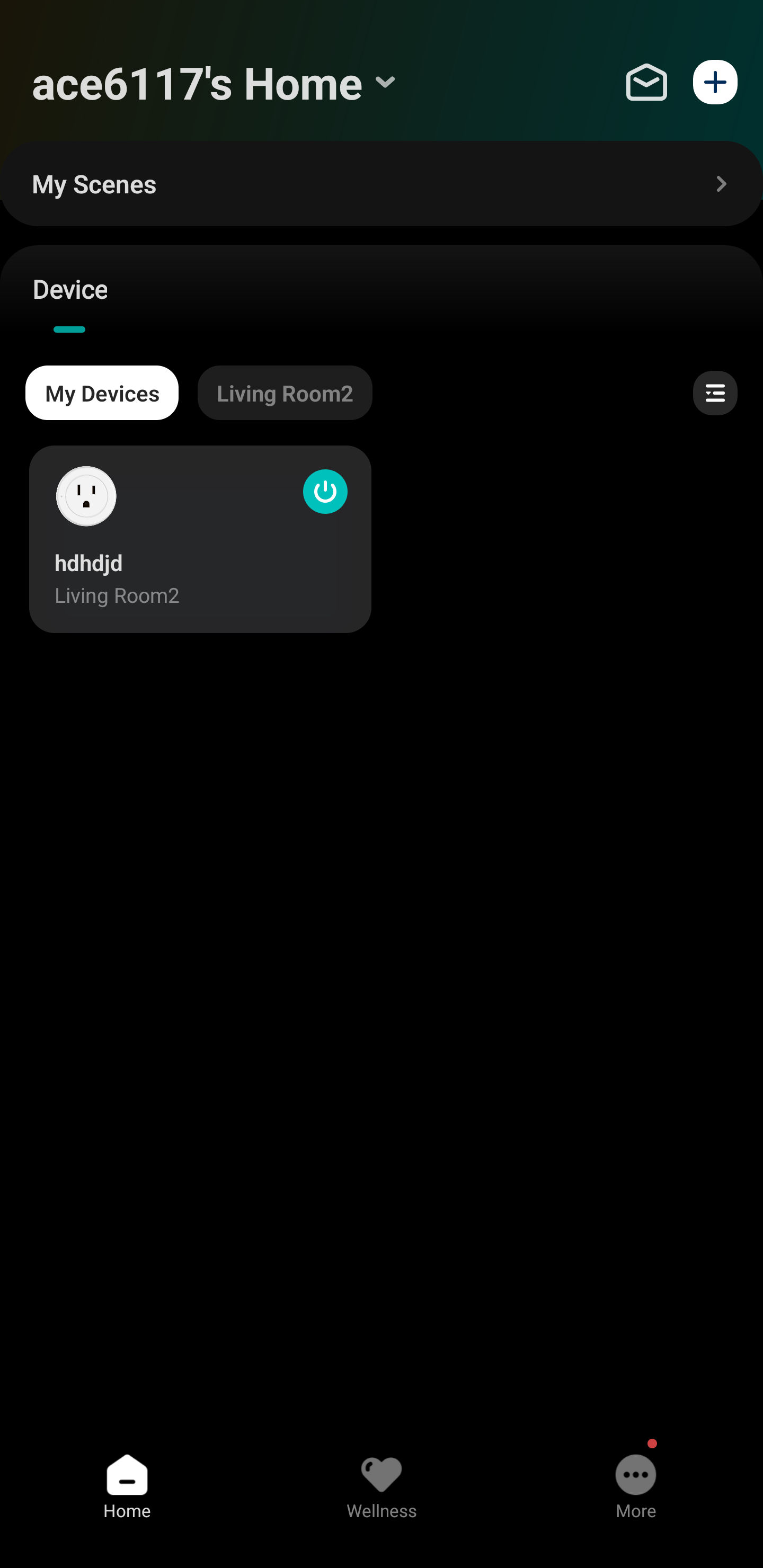

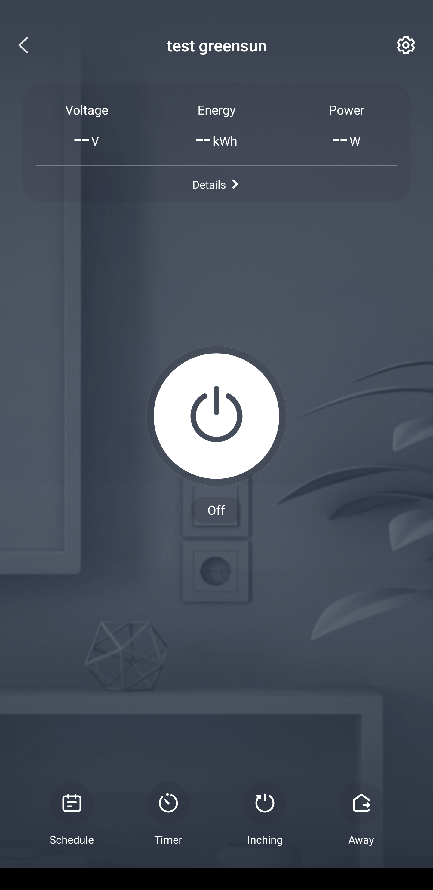

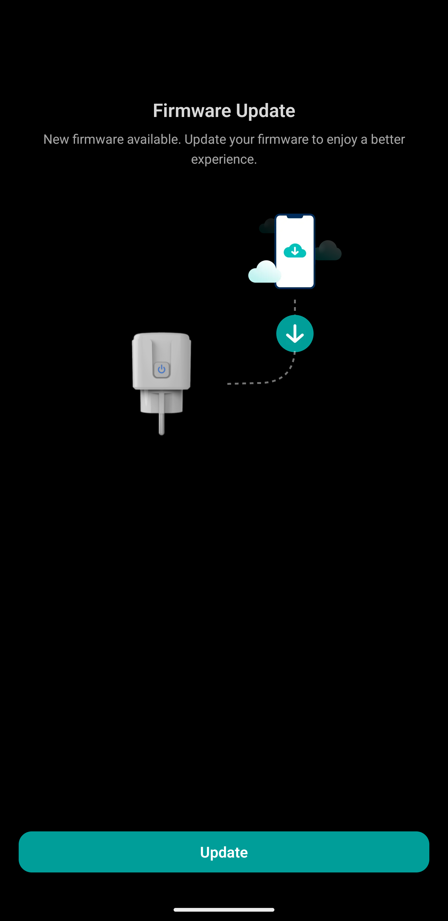

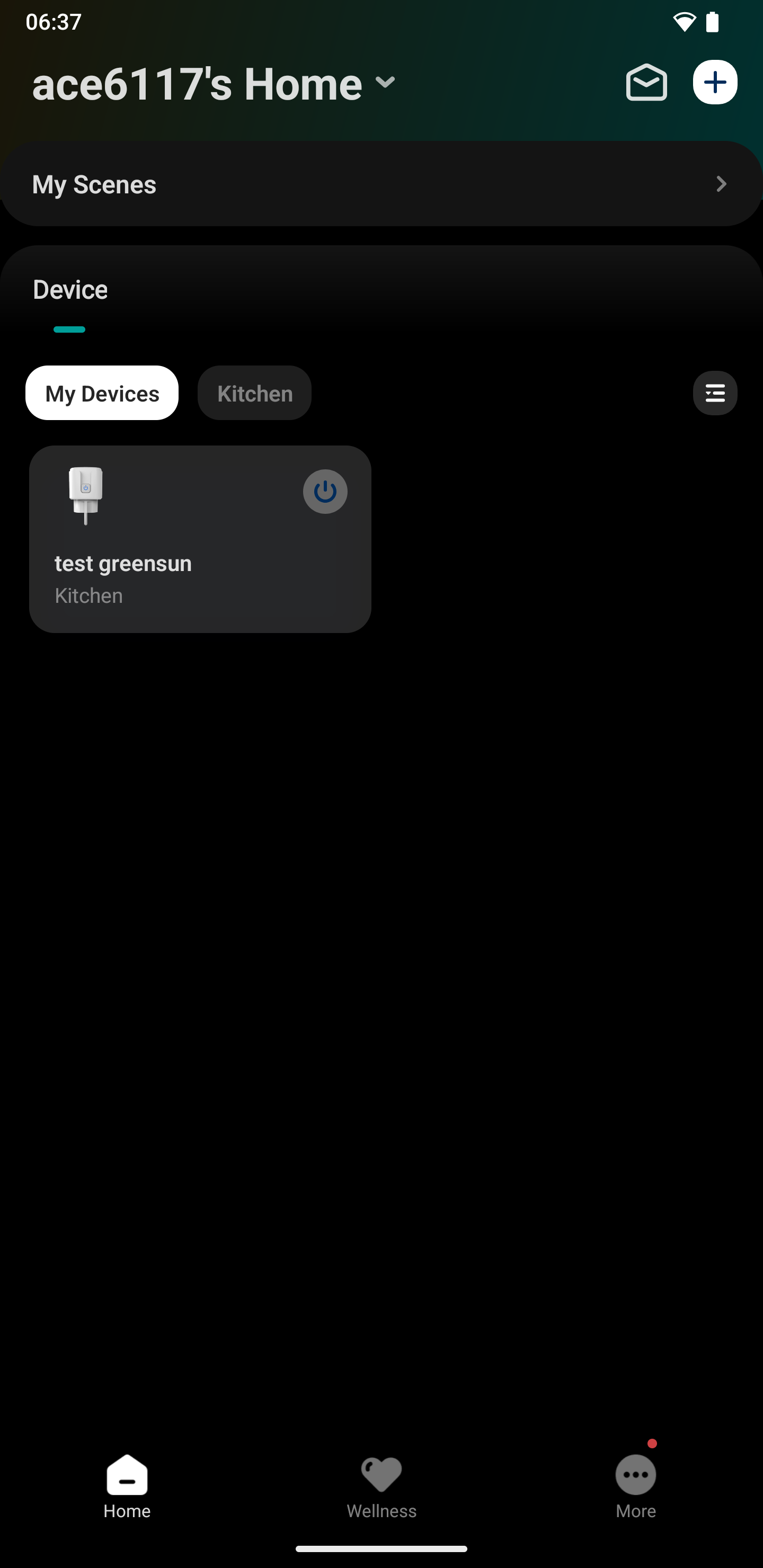

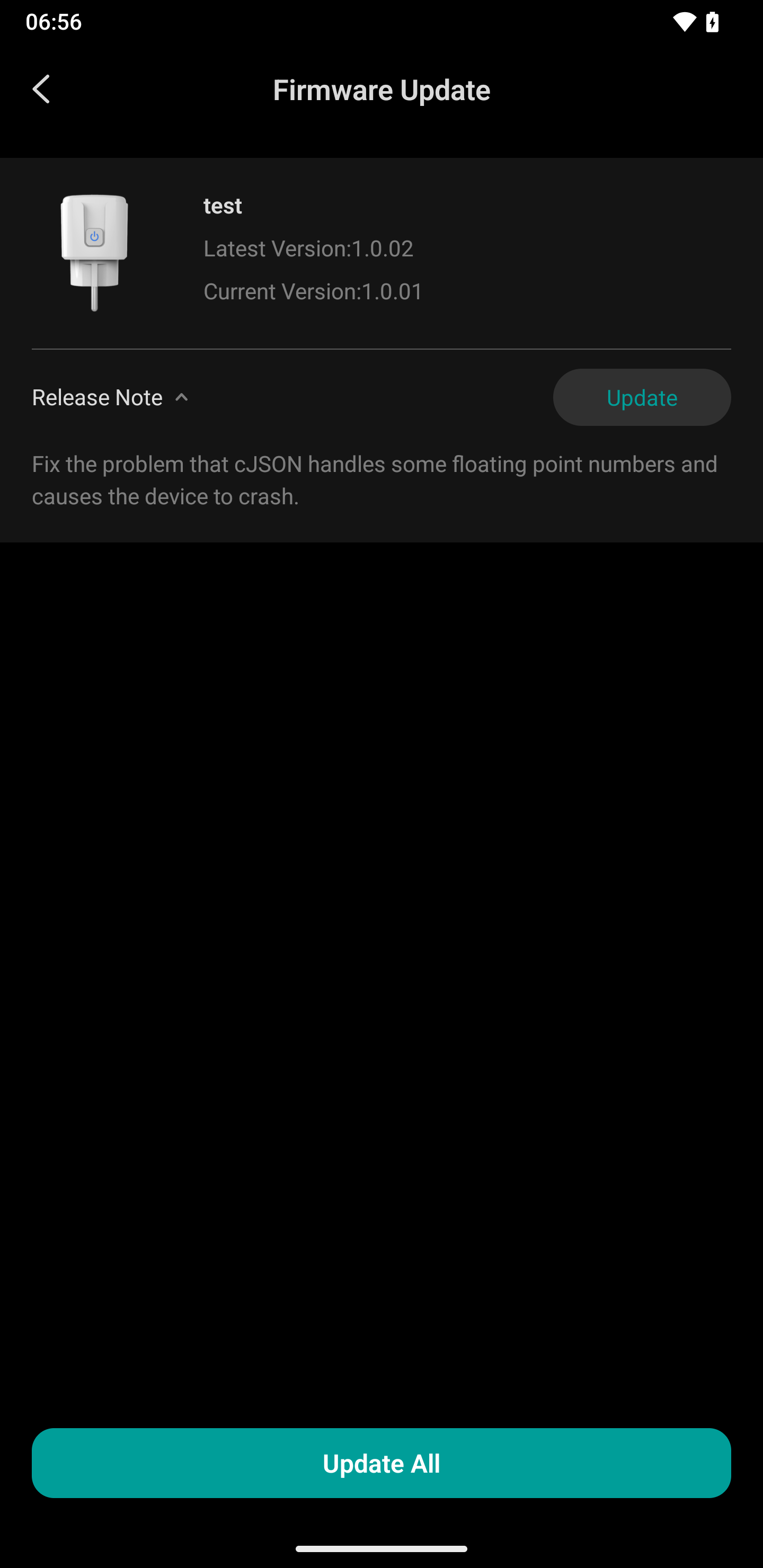

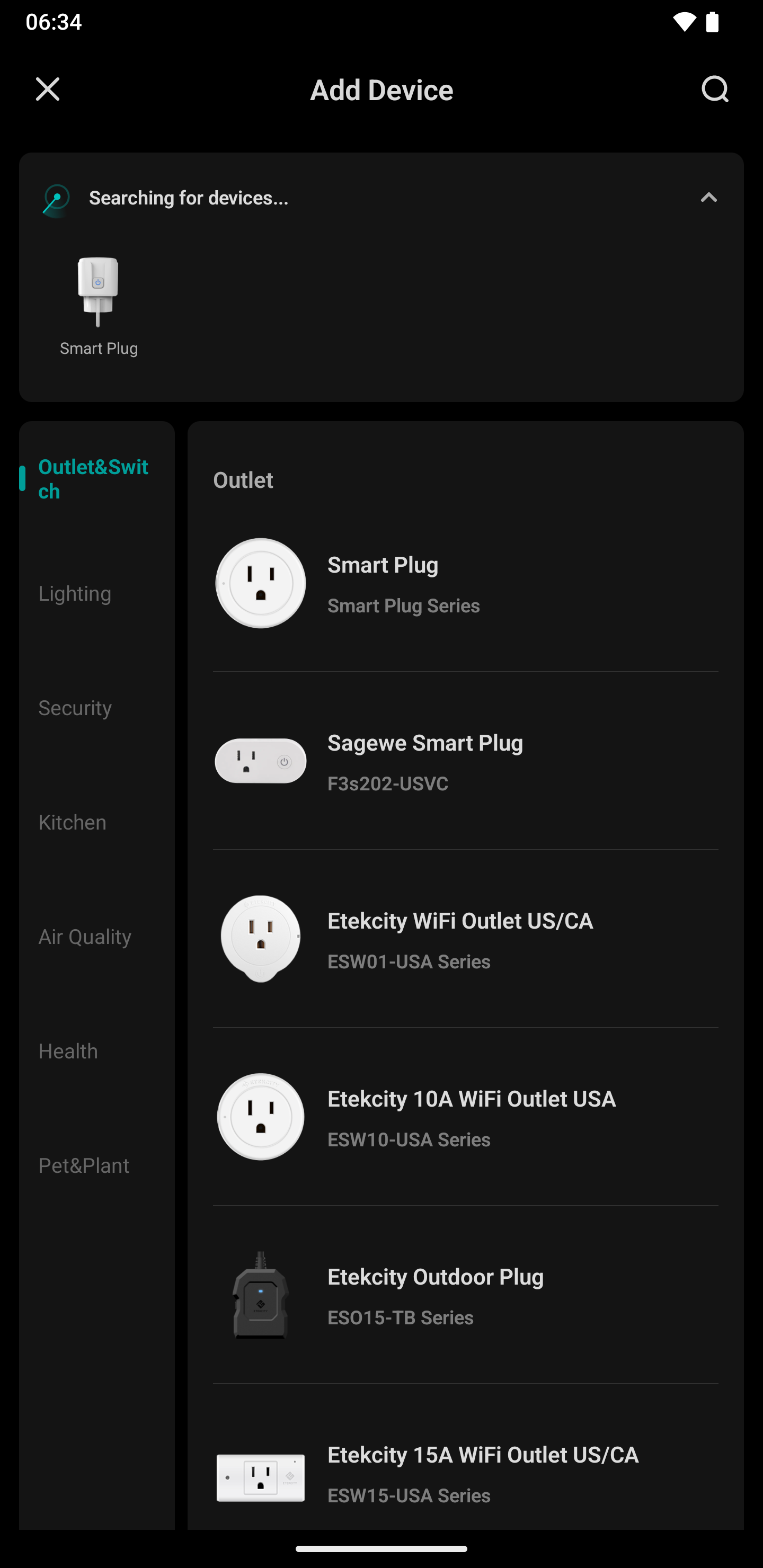

    VeSync app pairing and update screesnhots:
    App interface for adding devices with a list of smart electrical outlets. App screen with an outlet icon and connection status to the router and VeSync Cloud. User interface for selecting a room for a smart device. Firmware update screen with device visualization and Update button. Device firmware update screen with VeSync app. Home device management application interface showing a device icon in the kitchen. App interface with power button and energy management options. Device settings interface on a dark background with configuration options. Screenshot of device information, including time zone, device time, firmware version, and MAC address. Home device management app interface.

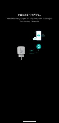

    Firmware update screen.

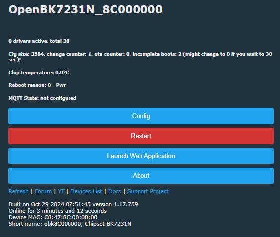

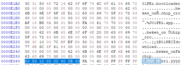

    OTA is at 0x125000 on these. Flash a BK7231N rbl to that address and it OTAs to OBK
    Screenshot of OpenBK7231N user interface showing device information and configuration options.
    0x125000 start address and 0xB0000 length (737,280 bytes) - I think!
    Hexadecimal data snippet with text labels.
    I had to ask ChatGPT for help on the length

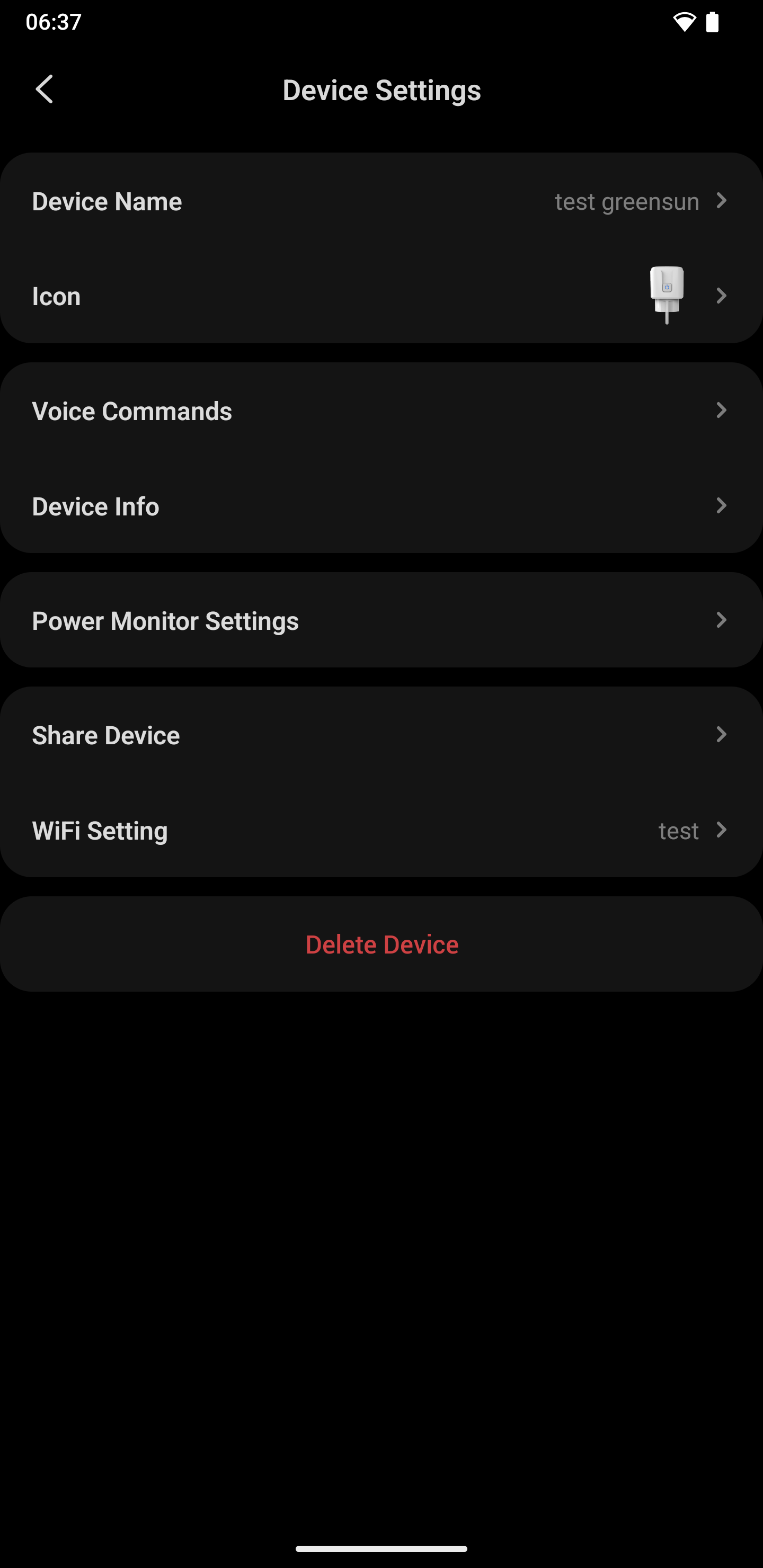

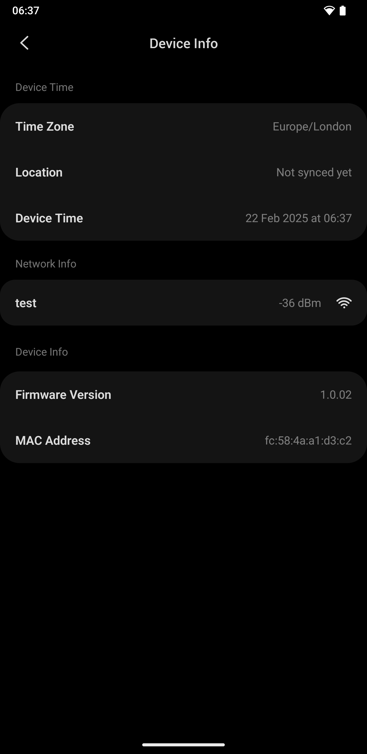

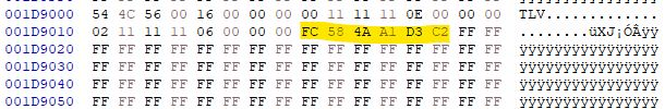

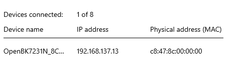

    Regarding the mac. TLV starts at 0x1D9000 where the mac we'd like to see in OpenBeken after OTA from VeSync 1.0.02-> OBK is seen - FC 58 4A A1 D3 C2
    Screenshot showing hex data.
    which correlates with what's seen in the VeSync app
    Screenshot showing mobile device information.
    current:
    List of connected devices with name, IP address, and physical MAC address.

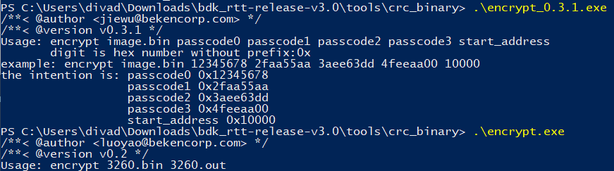

    so we could perhaps do that with something like
    if using the newer version of encrypt.exe
    Screenshot showing the usage of the encrypt.exe tool in the command line.
    https://github.com/openshwprojects/OpenBK7231...k7231n_os/beken378/build/post-build-steps.bat

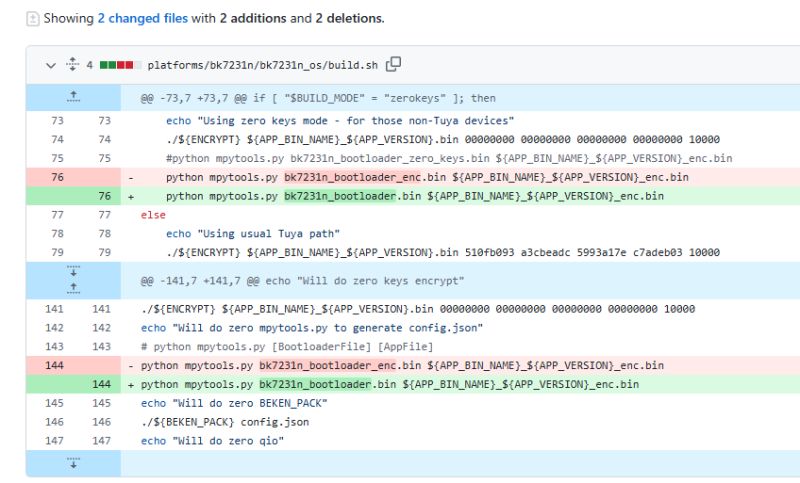

  • BK7231M_ALT boots with bk7231n bootloader bin
    #11 21725131
    Posts: 5236
    Help: 450
    Rate: 920

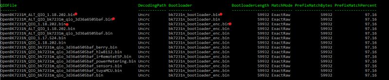

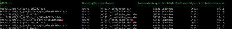

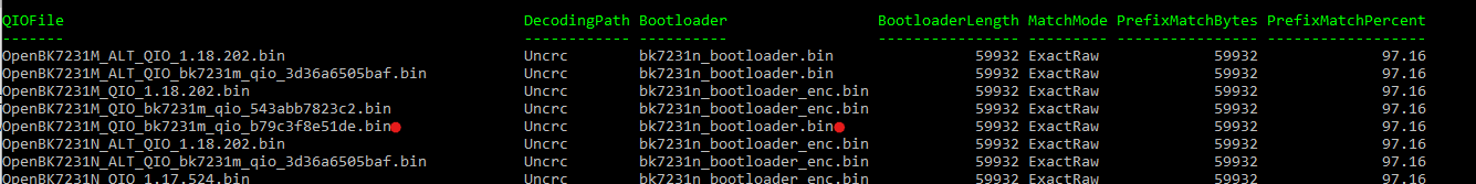

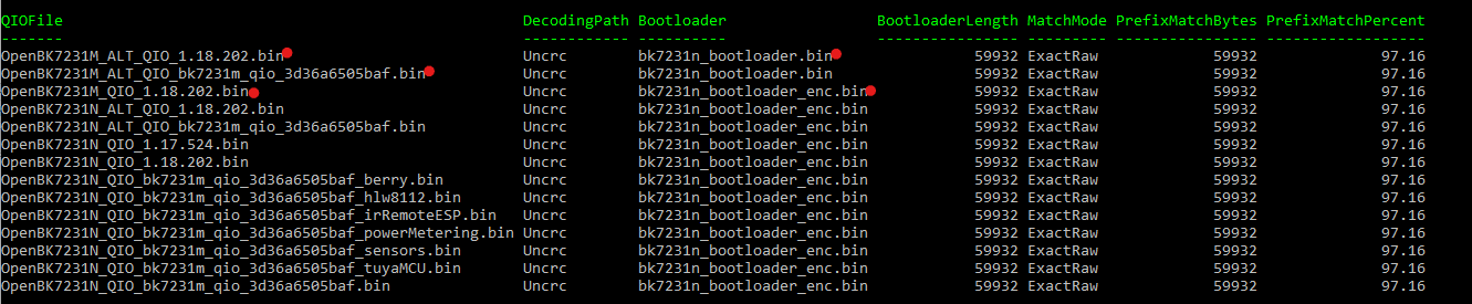

    wait. BK7231M_ALT (OpenBK7231M_ALT_QIO_1.18.202.bin) does boot already. It's being built with bk7231n_bootloader.bin, assuming comparison script is working. bk7231n_bootloader_zero_keys.bin not being used at all?
    Screenshot of a table with QIO files and corresponding bootloader matches
    uncrc and comparison script
    Code: Powershell
    Added after 2 [hours] 9 [minutes]:

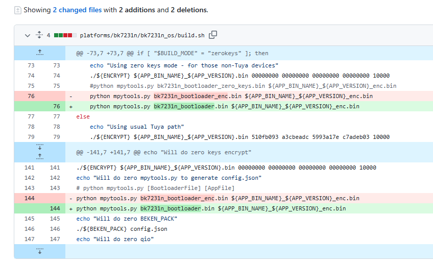

    oh https://github.com/openshwprojects/OpenBK7231...s/bk7231n/bk7231n_os/build.sh#L144C20-L144C30
    Added after 37 [minutes]:
    not sure I fully understand what's happening. If you delete bk7231n_bootloader_zero_keys.bin build does not fail. With these two changes BK7231M QIO boots and detection script says:
    Table of QIO file matches to bootloaders using Uncrc decoding and ExactRaw mode
    Screenshot of build.sh diff showing bootloader change from _enc.bin to standard .bin
  • #12 21725507

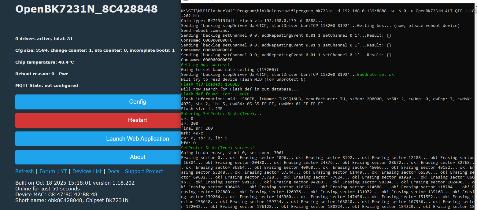

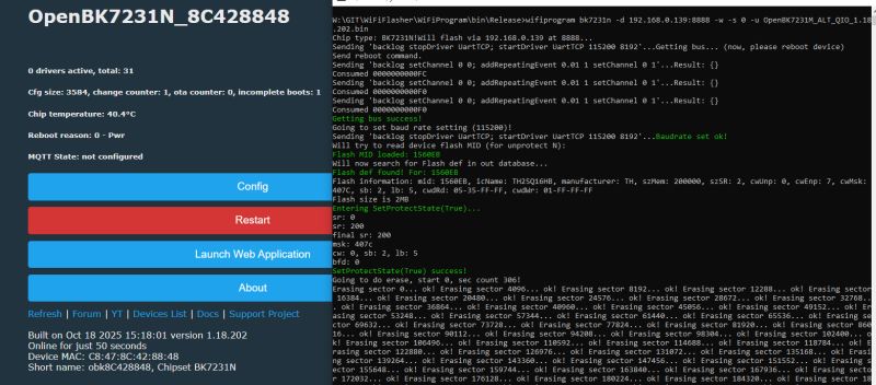

    I've checked ALT now with WiFi Flasher. It boots:
    wifiprogram bk7231n -d 192.168.0.139:8888 -w -s 0 -u OpenBK7231M_ALT_QIO_1.18.202.bin
    OpenBK7231N web UI with debug info and flash programming console log.

    Posts: 5236
    Help: 450
    Rate: 920
    ALT boots yes, but the old SDK M QIO does not
    change bk7231n_bootloader_enc.bin to bk7231n_bootloader.bin in the M code block and then it'll boot
  • #14 21725674
    Posts: 14795
    Rate: 12953
    I am not sure what happened there, but you may have a correct solution. First I tried to manually insert a bootloader with 0 keys, but then I realized that we can just use the one without _enc
  • #16 21743241
    Posts: 14795
    Rate: 12953
    merged, but now submodule of main app must be updated
  • #18 21743301
    Posts: 14795
    Rate: 12953
    Great, thank you, merged.
    I still don't know why I incorrectly put enc bootloader there... thanks for fix
  • #19 21743305
    Posts: 5236
    Help: 450
    Rate: 920
    no worries, I didn't see anyone notice. Maybe 1 person on Github but the ALT M still worked for him.
