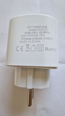

    Bought some cheap sockets from AliExpress Elivco store, with the intention to cut from the cloud.
    This one is a 20A smart socket marked RMC021, which was not previously shown here.

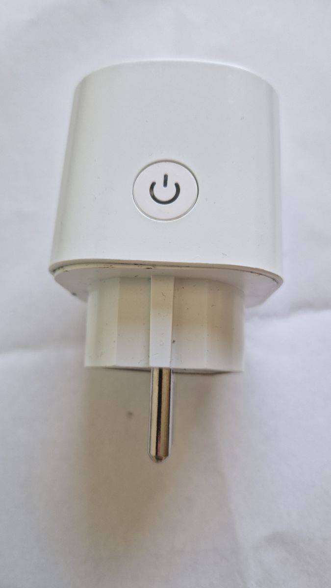

    Wi-Fi smart plug model RMC021 with technical specifications on the casing.
    White Elivco Tuya EU 20A smart plug with power button.

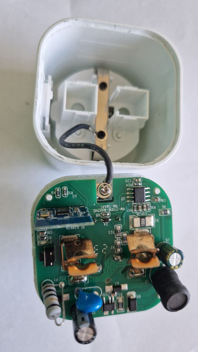

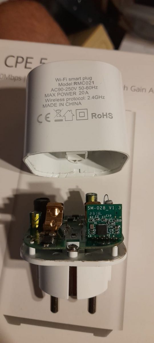

    It opens from the back quite easily, just need to work the seam loose with the spudger.
    Disassembled Elivco 20A smart plug

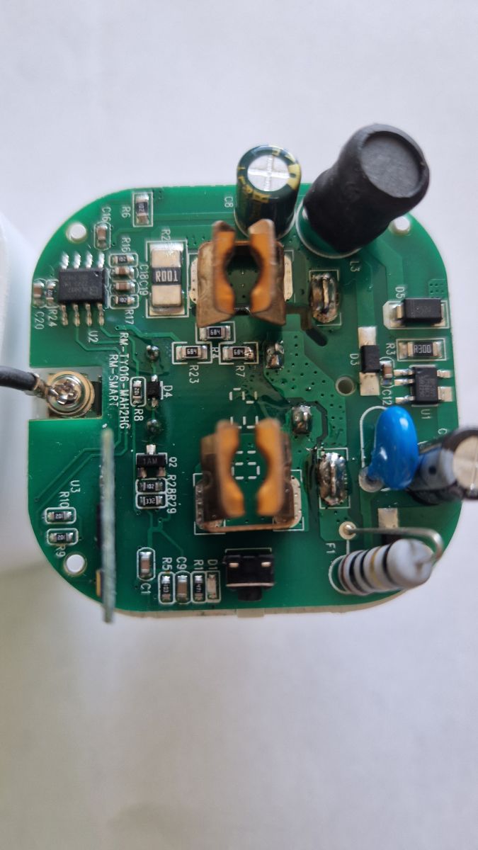

    My soldering skills are way too weak to try to desolder and see if the relay is rated for 20A, but anyway I would not recommend using it for that even if it is :).

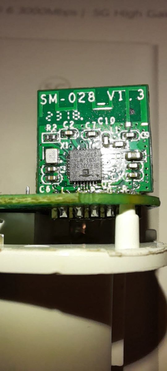

    It contains the usual BK7231N / CB2S BL0937 chips.
    The board seems to be the same as for RMC004, which has a teardown already.
    Electronic circuit board with components like capacitors and resistors.

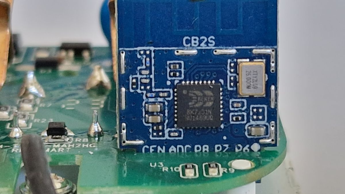

    BK7231N is hard to make a picture with my phone, that's the best I can.
    Close-up of an electronic module with BK7231N chip on a circuit board.

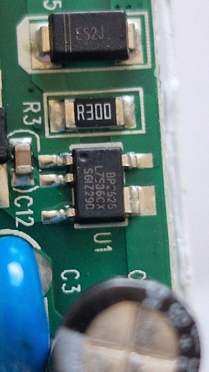

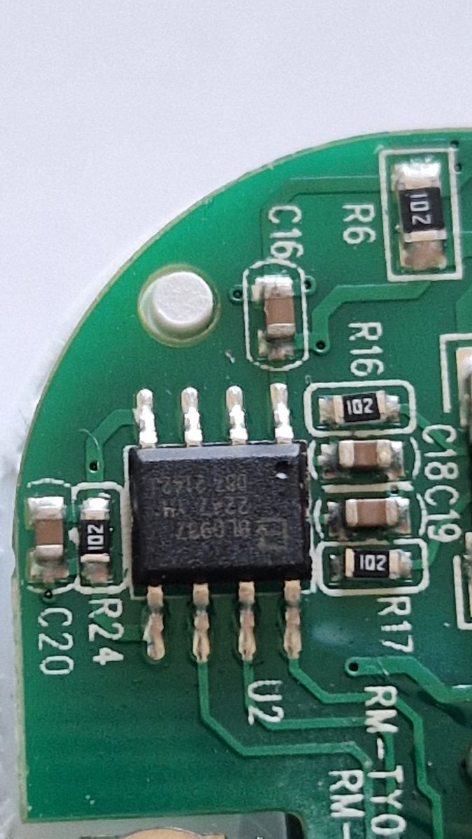

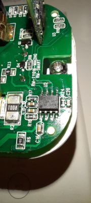

    Usual BL0937 and BP2525 chips
    Close-up of a circuit board with electronic components, including the BP2525 chip. Close-up of an electronic circuit board with various components, including a small chip.

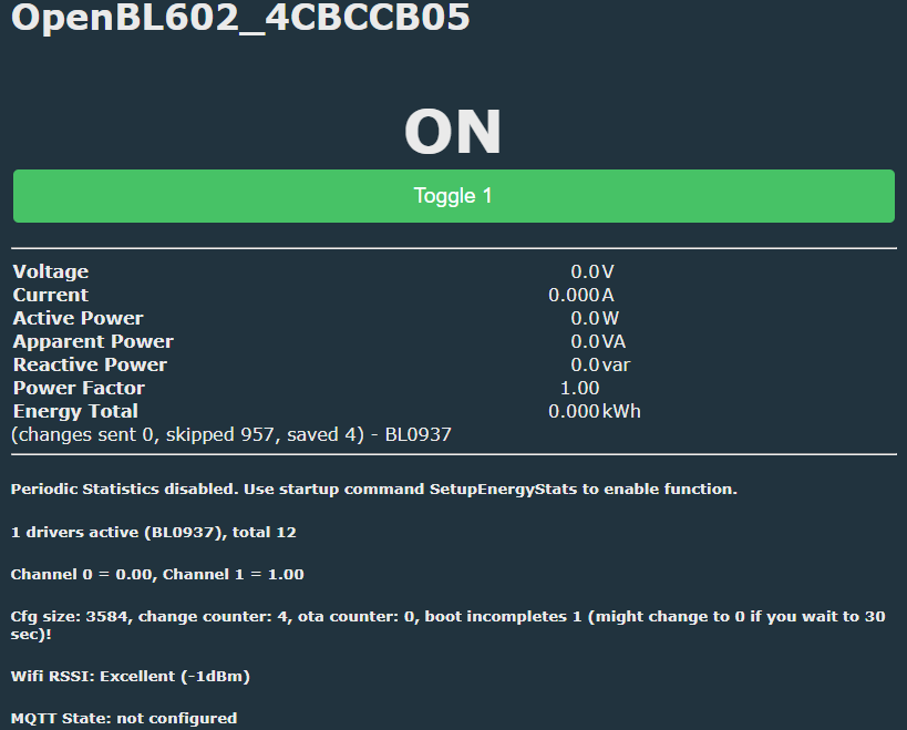

    Hmm, strange. I have the same RMC021, but it is BL602 BL0937 combo. Yes, the power monitor shows zero BL602 BL937 combo, I guess.
    Power monitor screen displaying voltage, current, and power information.
    Wi-Fi smart plug RMC021 with open casing revealing internal electronics. Close-up of a circuit board with markings and a chip. Close-up of a green circuit board with integrated circuits and other electronic components.

    BL0937 driver for BL602 must be finished first:
    https://github.com/openshwprojects/OpenBK7231T_App/pull/862
    If you know coding, you can help us. You only need to setup on change interrupt to count edges
  • BL602 needs a separate interrupt handler
