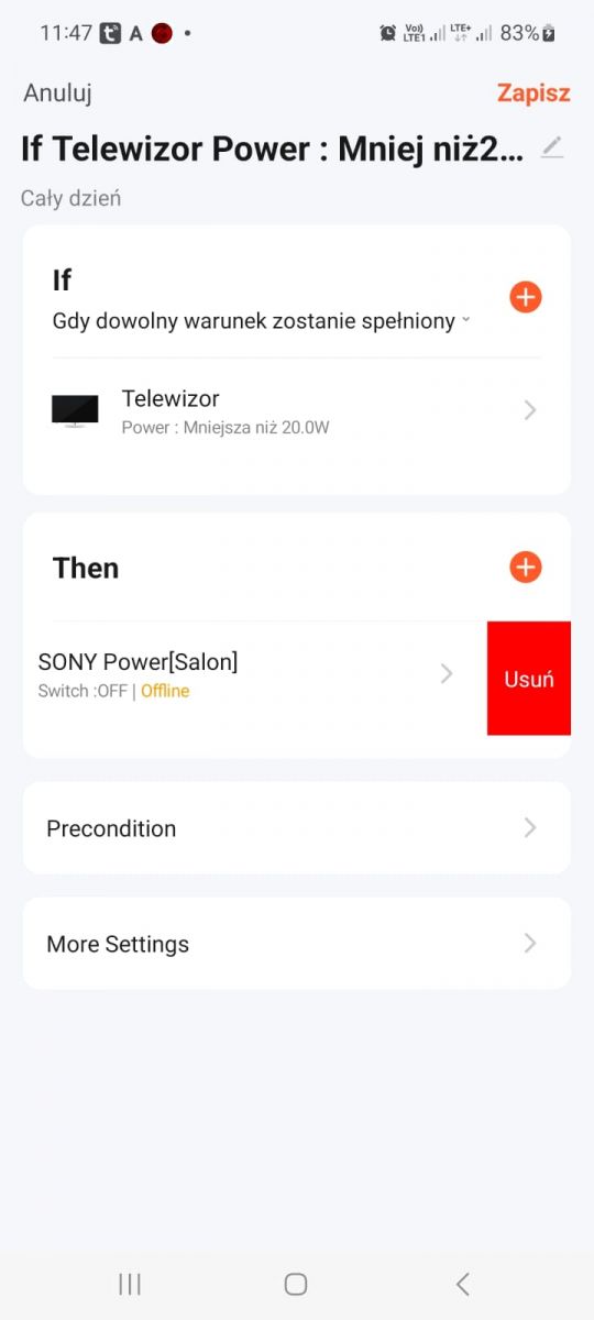

Removing a single action from a scene in the Tuya app - how to do it?

    In the Tuya app, how do I delete the action from individual scenes? So far I have to delete the whole thing if I make a mistake? I'm getting tired of this for a long time.

    Swipe the selected action to the left and click the red box that says "DELETE"

    MiPiX you don't even know how much you have helped me. For a year I'm already thinking about it!!!
