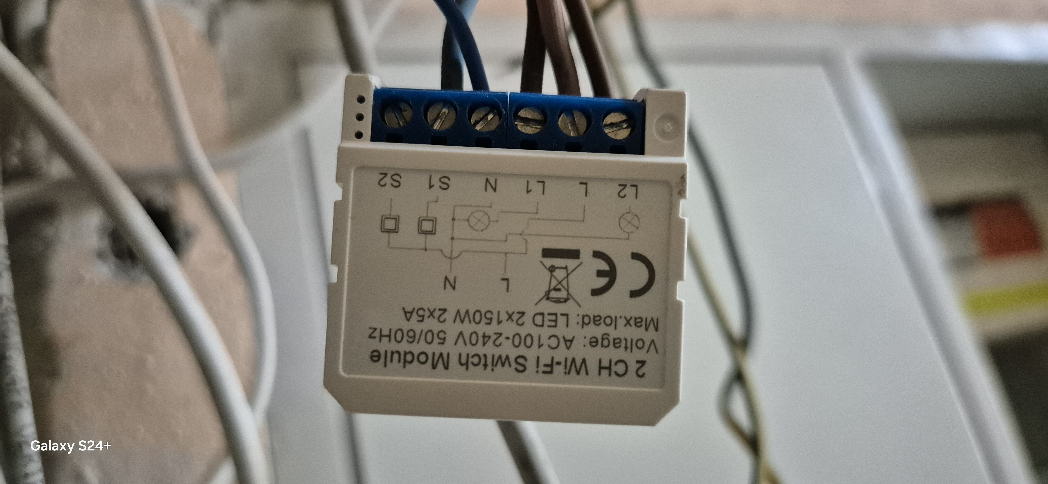

    Hi
    I have two modules installed to control the light, unfortunately every now and then the light turns on and off by itself, I have replaced these modules but I still have the same thing. I haven't set any hours, calendar etc in the application, picture of the module attached, what could be the cause, I suppose something application but how to check it, where???
    thanks in advance
    • Light with TUYA modules turns on and off by itself - how do I fix it? 20240603_130417.jpg (1.29 MB) You must be logged in to download this attachment.

    78db78
    Posts: 10535
    Help: 1792
    Rate: 3230
    Look in the catalogue data for the min wattage of the bulb, and what wattage did you put on?

    koragreg
    Posts: 129
    These are 8W led floodlights per module

    wielkiroman57
    I have the same problem. I have fitted a customer with 17 relays operating on the principle of a bistable button. The customer informs me that every now and then a lamp goes out or lights up. Maybe someone has some advice for this situation?

    reynolds99i5
    Posts: 20
    I've had the same thing for a while now, no automation, different switches on Zigbee. Massacre

    teridar
    Posts: 506
    Help: 20
    Rate: 20
    I also had this with one module around the time you wrote these posts, but after a while it went back to normal on its own and stopped switching on and off.
