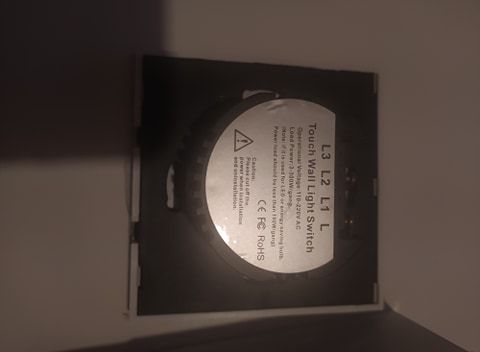

    I have touch light switches installed in my apartment (without Wi-Fi function). There was no problem for 10 months, and now the bathroom light switch turns off the light itself 10 seconds after it is turned on. We replaced the switch with a new one and after a week we have the same pattern. Once the light is on, it cannot be turned off, but it turns off by itself after 10 seconds. The bathroom has an LED ceiling lamp.
    What could be the cause of this light going out? How to fix it?
  • #2 19242132
    vieleicht
    Level 37  
    Posts: 2163
    Help: 463
    Rate: 460
    Can you reveal any details about this switch or is it a secret?
  • #3 19242145
    Emska91
    Of course it`s no secret :)
    This is a switch with 1 blue/red illuminated field.
    This can says on the back: Voltage 110-220V AC
    Load Power: 3-300W/gang
    Bought on Allegro at electro24, but came in packaging without a marked manufacturer.

    I think it may be a problem with the switch itself. The voltage range of 110-220V is written on the device and apart from the fact that the voltage in the network is now 230V (it is not without significance), this may mean that the device is old or the capacitors may have dried up. The transition from 22V to 230V took place almost 20 years ago. So maybe these switches are just too old. If they are as old as I think (even if only structurally), then no one thought about controlling LED lighting. I suggest connecting a classic light bulb with several dozen watts and seeing what happens.

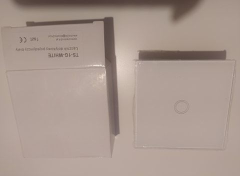

    Were there any LED adapters (resistor or capacitor) included with the switch? If so, have they been installed?
    Regards.
    PS: Post a photo of the switch and packaging if you have it.

    Touch Light Switch Shuts Off After 10 Seconds - Identical Issue with Replacement Touch Light Switch Shuts Off After 10 Seconds - Identical Issue with Replacement
    According to the electrician who installed the switches, this yellow square attached to the switch was not needed...
    To put it simply, could you tell me where it is mounted?

    Missing a capacitor may be a problem. It is mounted next to the lamp - as close to the bulb as possible (of course, without exaggeration, it can be in the box, at the connection, etc.).

    If so, install it as he mentioned @sk1977 . It certainly won`t make things worse.
    Additionally, you need to make sure that the sensor (detecting finger touch) under the glass panel does not touch it.

What resistor can I add if the capacitor alone fails?
Parallel a 47 kΩ, 2 W metal-film resistor with the lamp. This draws ~1 W, enough to stabilise the control supply yet imperceptible in energy cost [Siemens App Note, 2021].
Are 110-220 V marked switches safe on 230 V EU mains?
Most Far-East units tolerate 250 V AC, but ageing electrolytics rated 220 V fail faster at 230 V, leading to auto-shutdown after months [Elektroda, vieleicht, post #19242186]
How can I test if the switch or the lamp is faulty?
Replace the LED lamp with a 40 W incandescent. If the switch stays on, the issue is load level, not the switch [Elektroda, vieleicht, post #19242186]
What is the life expectancy of budget touch switches?
Users report resets needed "once a year" after four years of service [Elektroda, taupik6, post #21086147] External surveys put average MTBF at 20–30 k cycles for low-cost models [ConsumerLab, 2022].
Edge case: the switch turns on when an appliance on the same circuit starts—why?
Large inrush currents from devices like mixers or washing machines cause voltage dips/spikes. The switch MCU misinterprets them as touches, especially on shared neutral runs [Elektroda, hopzen, post #19989544]
Can I avoid multiple-gang interference?
Keep each module in its own single frame or bend PCBs slightly to increase spacing; otherwise adjacent sensors couple capacitively and self-trigger [Elektroda, Chris_W, post #19797474]
