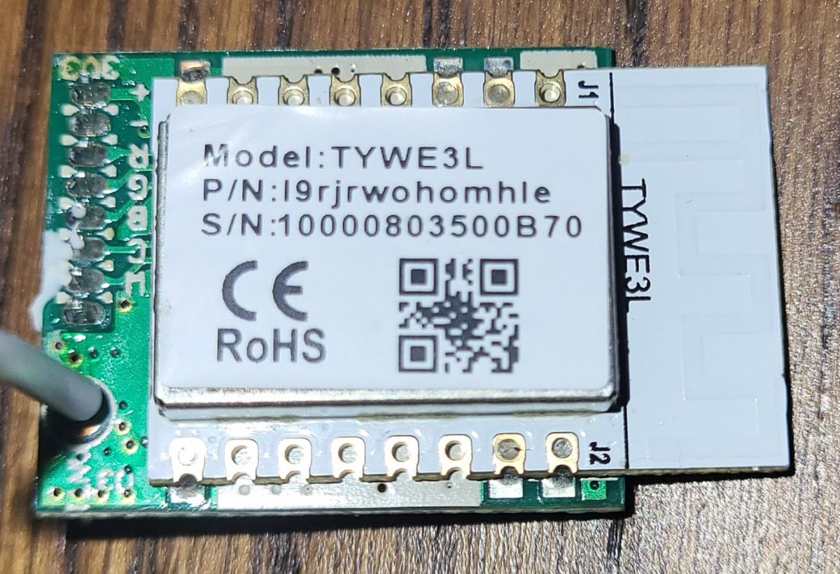

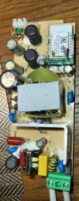

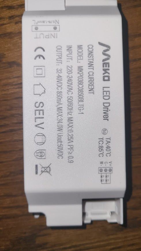

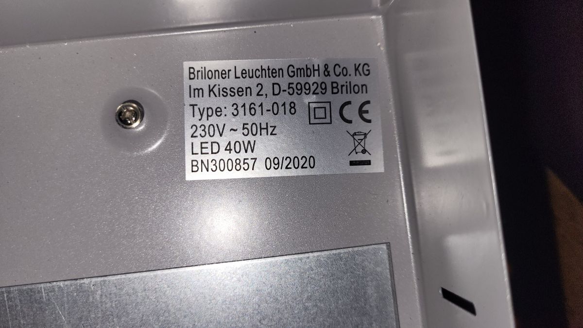

    LED lamp – with a Meko LED Driver MKP060C1450BLTG-1 module.
    The lamp has stopped responding to the remote control.
    It contains a Tuya TYWE3L module.
    LED driver module with electronic components and Tuya TYWE3L module.
    Nameplate of LED lamp with technical data.
    Meko MKP060C1450BLTG-1 LED driver module on a wooden surface.
    Tuya TYWE3L module on a green circuit board.
    Added after 43 [minutes]:
    The lamp is working. It’s lit. Since the remote control broke, it has been switching on and off in a sequence: off – on, off – on.

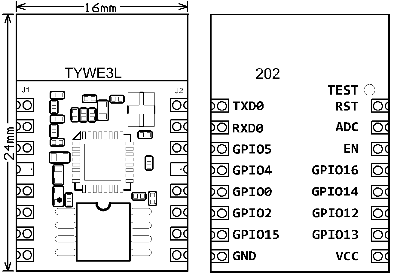

    #6 21430614
    Posts: 14771
    Rate: 12914
    The first thing I would start with is to disconnect the whole thing from the 230V mains and supply power (AFTER DISCONNECTING FROM THE NETWORK) from a good source of 3.3V to the GND and VDD pins from TYWE3L. This 3.3V must be able to provide adequate current, so do not take it e.g. the output of a USB to UART converter.
    Diagram of TYWE3L ESP8266 module with pin labels. .
    If the hardware then appears in the application, you can suspect that there is something wrong with the power supply. In the opposite situation, the WiFi module itself is to blame, maybe something software is broken.
    The TYWE3L is simply an ESP8266, so you can simply connect a USB to UART converter to it, connect GPIO0 to ground and read the flash. Make a copy of the 2MB batch and try uploading Tasmota, maybe with Tasmota this flash will work. It's hard to determine what's at fault for now. Of course Tasmota is not Tuya, but at least you will revive the hardware....

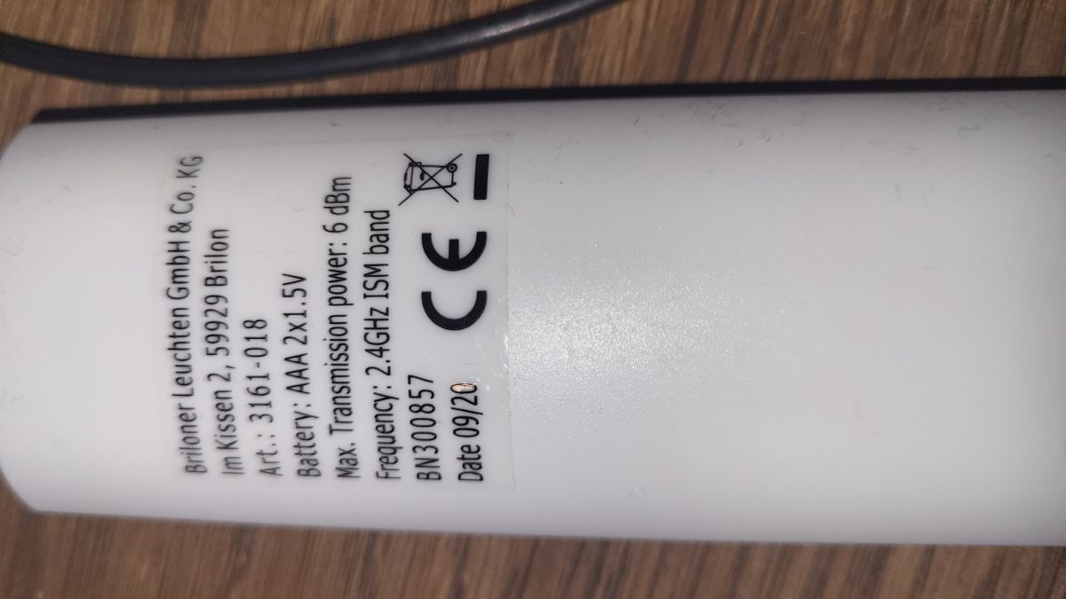

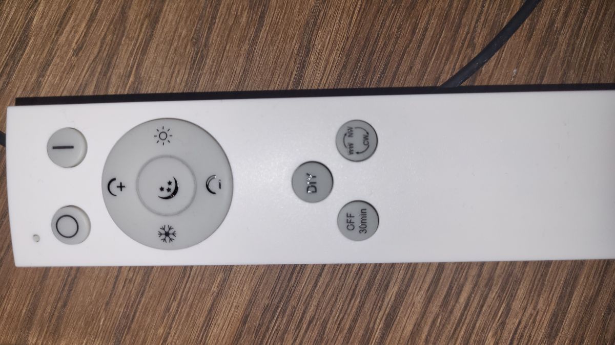

    And what kind of remote control did you have for that lamp there? I don't see an IR receiver on the board so I wonder if Tasmota will support it.
    If the WiFi module is quite damaged, you could solder a matching ESP12 in its place.
  • #9 21431011
    jakoku
    Posts: 37
    Product label on a white device with technical information. .
    Remote control with various buttons for lighting, placed on a wooden surface.

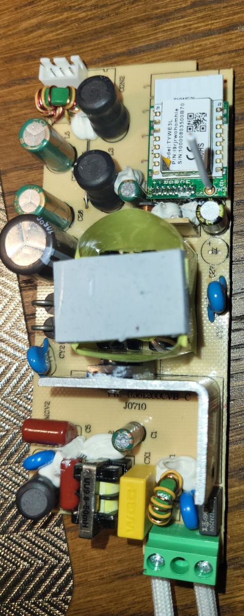

  • #11 21449057
    Posts: 14771
    Rate: 12914
    What exactly are you asking?
    Then dismantle the power supply and check the board, maybe it's something trivial, an electrolytic capacitor?
  • #12 21450487
    jakoku
    Posts: 37
    >>21449057 .
    I buy, remove the lamp, replace the power supply, fit the lamp in place :) .
    The worst thing about such failures is that the lamp has to hang and shine.... well it won't lie on the desk ;)
