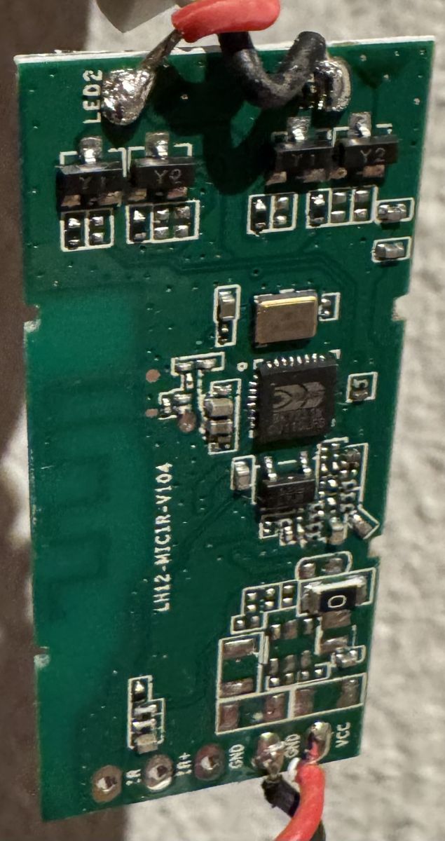

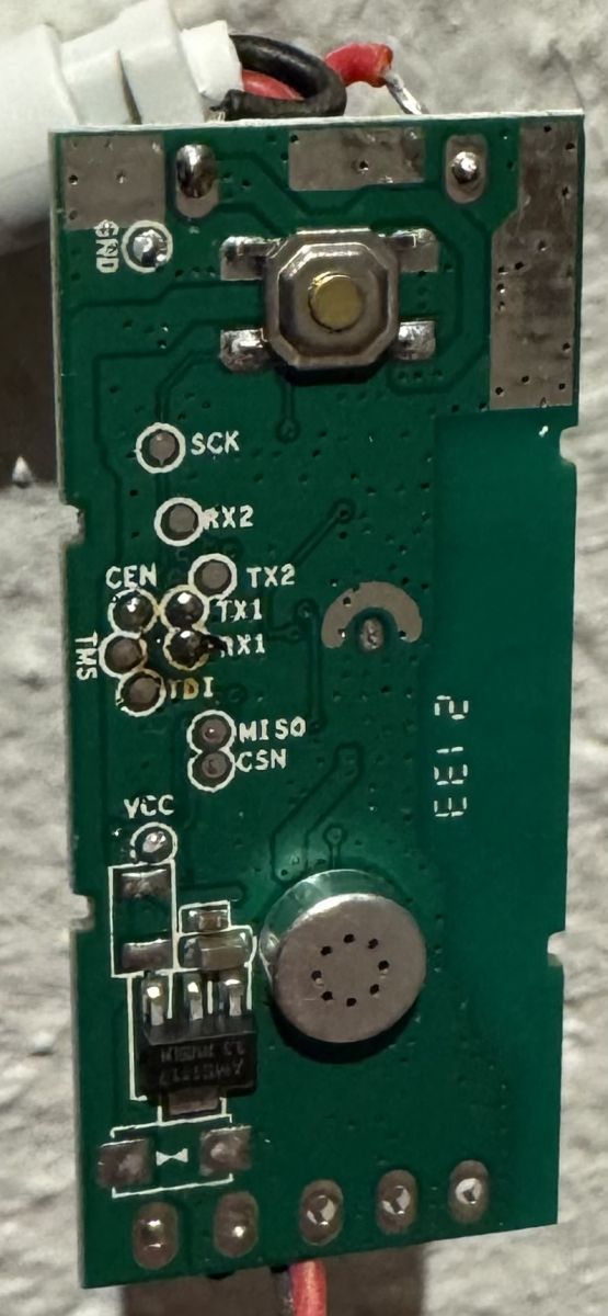

    One of my Tuya-based OpenBK-flashed light strings (Luminea ZX-5140-675) won't turn off any longer. I have two identical strings. The only difference is their respective unique device names. Both devices write to their logs "MQTT Channel has changed" and the misbehaving strip additionally writes 'Info:CFG:####### Flash Save Channel 0 as nnnn #######'. Both devices keep publishing integers to the MQTT sub-topic "0".
    Could there be a short in the wiring or can this be saved by a config change.

  • #2 21372507
    Posts: 14622
    Help: 655
    Rate: 12638
    Can you open the case and show some photos from inside? Maybe MOSFET is burnt?

    Close-up of a circuit board with various soldering points and electronic components.
    Close-up of a green printed circuit board with electronic components.
    I see nothing unusual.
