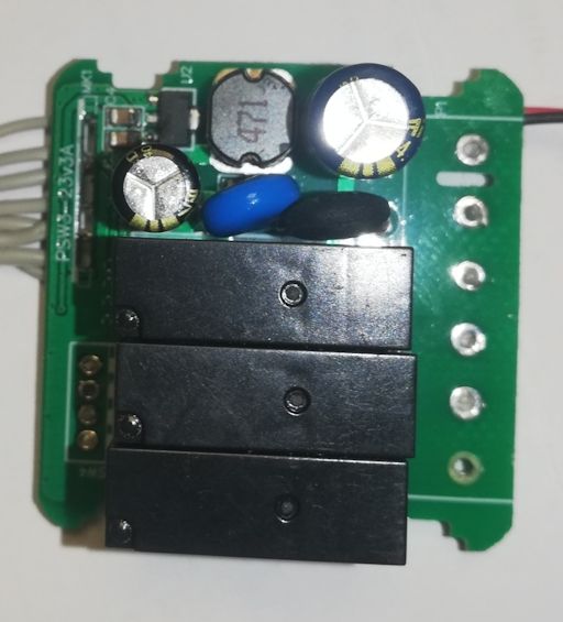

    Here the disassembly had already begun. I don't have previous photos.
    Electronic module with BK7231N integrated circuit and soldered components on a PCB. Close-up of an open circuit board with three relays and capacitors. Electric relay Manhot GK101-1AS with technical specifications
    For tests. Soldered wiring (lousy soldering).
    The Tx and Rx connections are used for the LED integrated on the board and for the K1.
    Power with 5 V in the capacitor before the 3.3 V LDO.
    Close-up of a 3-channel switch with a BK7231N chip, showing soldered wires on the board.

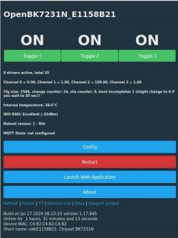

    A reset and the connection was immediate:
    OpenBK7231N user panel with control options.
    It is not configured (I have to study it as I am still a newbie). That's why only two buttons appear instead of three. The action on them seems good.

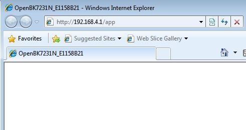

    But when launching the web application, it failed.
    Empty browser screen with the address 192.168.4.1/app visible in the address bar.
    I thought it could be through the browser or mobile phone and I connected from the laptop, without success.
    And I noticed that it only allows me one connection. Or mobile, or laptop.
    I don't know if I'm doing something wrong.

    but I still have an error when launching the web application.
    Screenshot of Internet Explorer with a blank page and IP address.
  • #2 21159183
    Posts: 14762
    Rate: 12892
    Web Application works only if you have already paired device with your WiFi.
    So, pair to your WiFi first, and then use Web App.
    This is because Web App is fetching the panel from Web (from our open source github repo).
  • #3 21159538
    jony202b
    Posts: 16
    Thank you!!
    Now it's going well.

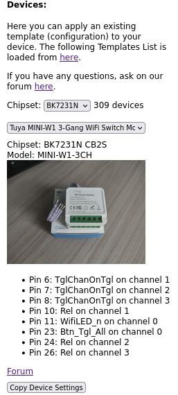

    This is getting better.
    Little by little there is a lot to study.
    OpenBK7231N device configuration screen with three toggles turned on.
    I have copied this template (web application > config > devices):
    Image of a Tuya MINI-W1 3-Gang WiFi Switch MC module on a desk with visible pins and configuration labels.
