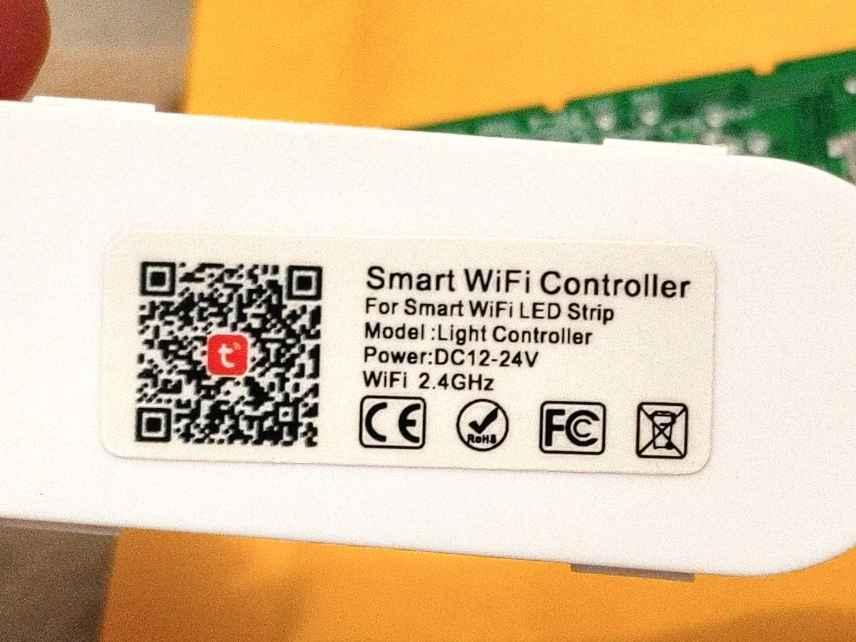

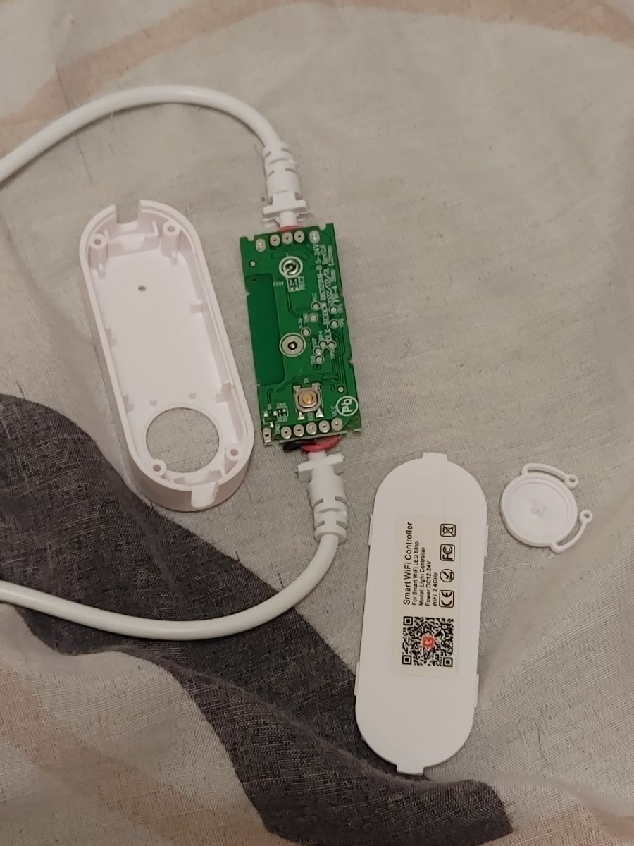

    I got this 12V barrel smart switch from AliExpress. Mine arrived in a yellow envelope without any packaging or branding.
    It's easy to open. Just need to pry using the small flathead next to the wire strain relief. It's held by 4 clips.

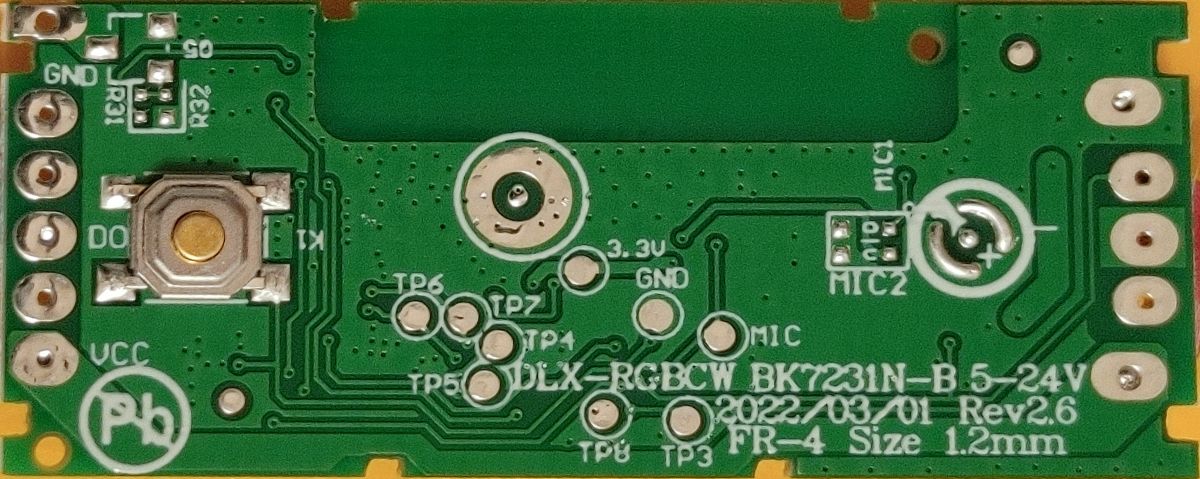

    It's a BK7231N. Use TP5 for RX and TP4 for TX. I had to use an external power supply while flashing. Ended up using a 12V plugged into the barrel connector.
    The device doesn't seem to have the button configured or OpenBeken didn't pick it up but it was connected to P14. The boards has space for 3 more light channels but I didn't check if they were actually connected because I didn't need them.
    Texts on PCB: DLX-RGBCW BK7231N-B 5-24V
    - LED Cool (Channel 4) on P8
    Device seems to be using CB3S module, which is using BK7231N.

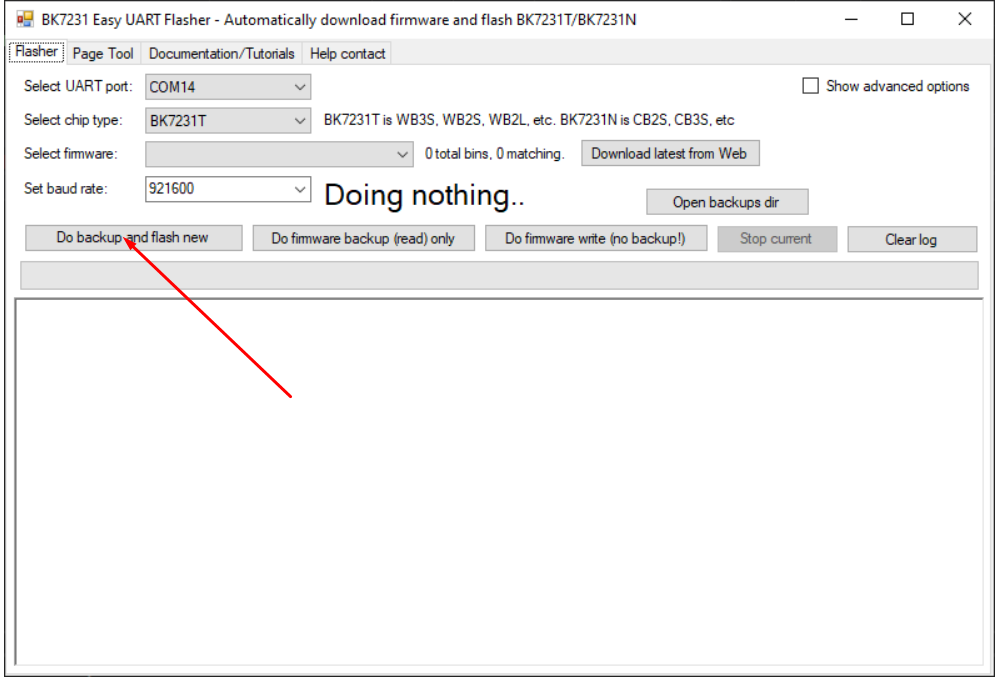

    BK7231GUIFlashTool, which is the best option for flashing this device, makes sure that you have a backup by giving an automatic "Do backup and flash new" procedure. The "no backup" option is not recommended:
    Screenshot of BK7231 Easy UART Flasher tool with Do backup and flash new option highlighted.
