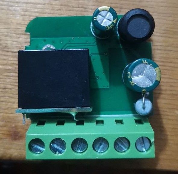

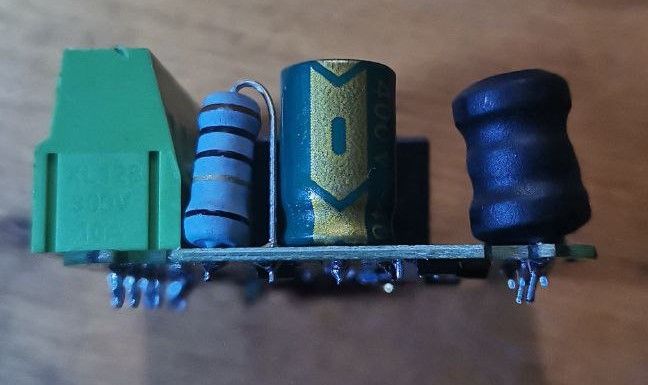

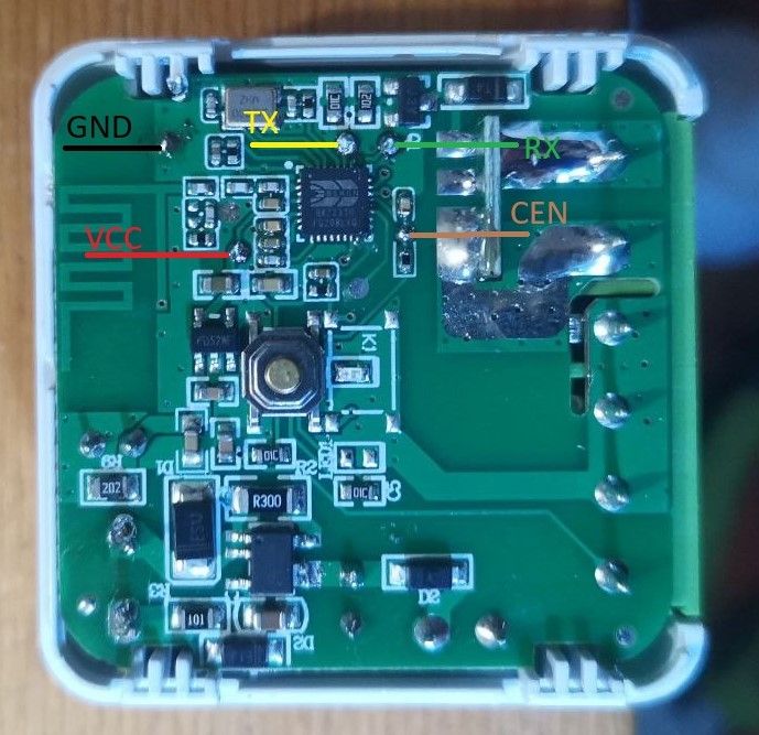

  • I came across a seemingly ordinary smart switch.
    Photo of a mini smart switch with technical specifications.

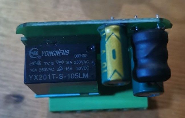

    But inside there is some kind of simplified version with a BK7231N chip.
    Side view of an electronic board with a connector, resistor, capacitor, and inductor. Close-up of the inside of a smart switch with electronics and components. Close-up of the internal part of a smart switch with a BK7231N chip.

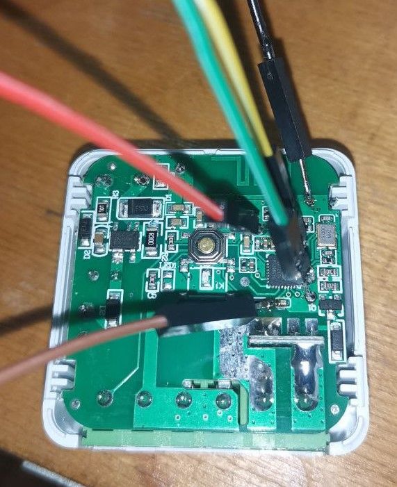

    The image shows a circuit board of a smart switch with markings for GND, VCC, TX, RX, and CEN.

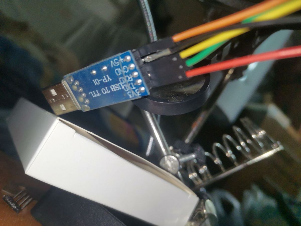

    At first I decided to flash it with Tuya-Convert, but the version of the native firmware was 1.3.10 and it did not allow flashing wirelessly.
    After calling the contacts, I decided to flash it in the usual way.
    I did not need the CEN contact for the firmware.
    Everything went well.
    Image of a circuit board with connected wires. Close-up of a USB to TTL adapter with connected wires.

    - Pair/Toggle All Button on P23
    - WiFi LED on P26
    - TglChannelToggle (channel 1) on P6
    - Relay (channel 1) on P7
    Device seems to be using CB2S module, which is using BK7231N.

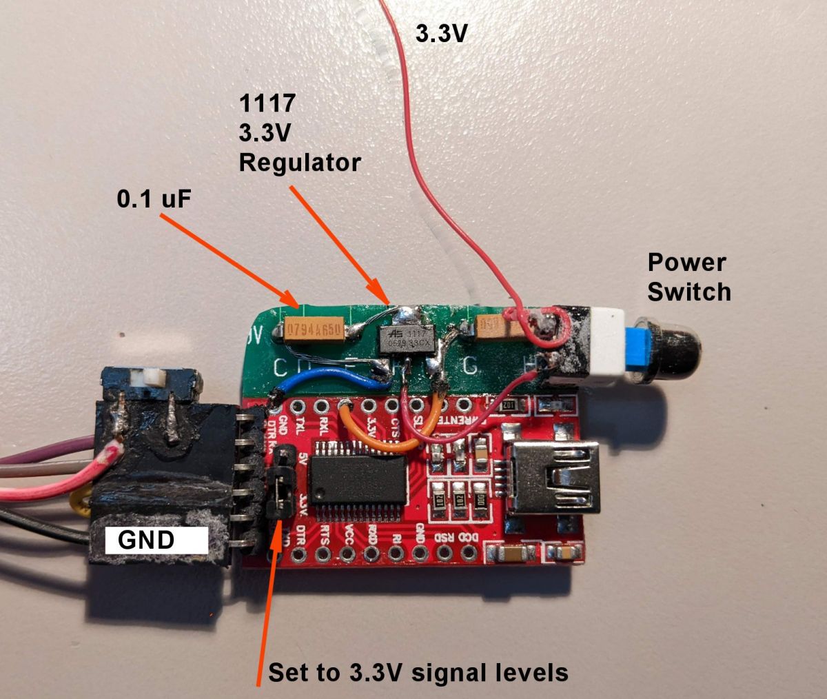

  • #4 20848543
    BH337
    Thanks - I succeeded. It was a bit more involved than Tasmota on a Sonoff, but I followed the instructions and got it done. Perhaps there was a bit too much information provided and I had to figure out what was necessary and what was not. Thanks for pointing me in the right direction.
    I modified an FTDI module to add a 3.3V regulator to supply stable power to the BEKIN chip per recommendations. I don't know if it was necessary, but it worked first time.
    Electronic circuit with labeled components: 3.3V regulator, 0.1 uF capacitor, power switch, and GND port.
