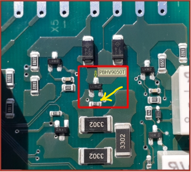

[Solved] Potrzebna wartość rezystora ze zdjęcia: spalony razem z tranzystorem

    Resistor value: 47k (473).

    stefina
    Thank you for the information. After the replacement, one more faulty transistor had to be replaced and then the washer started working.
