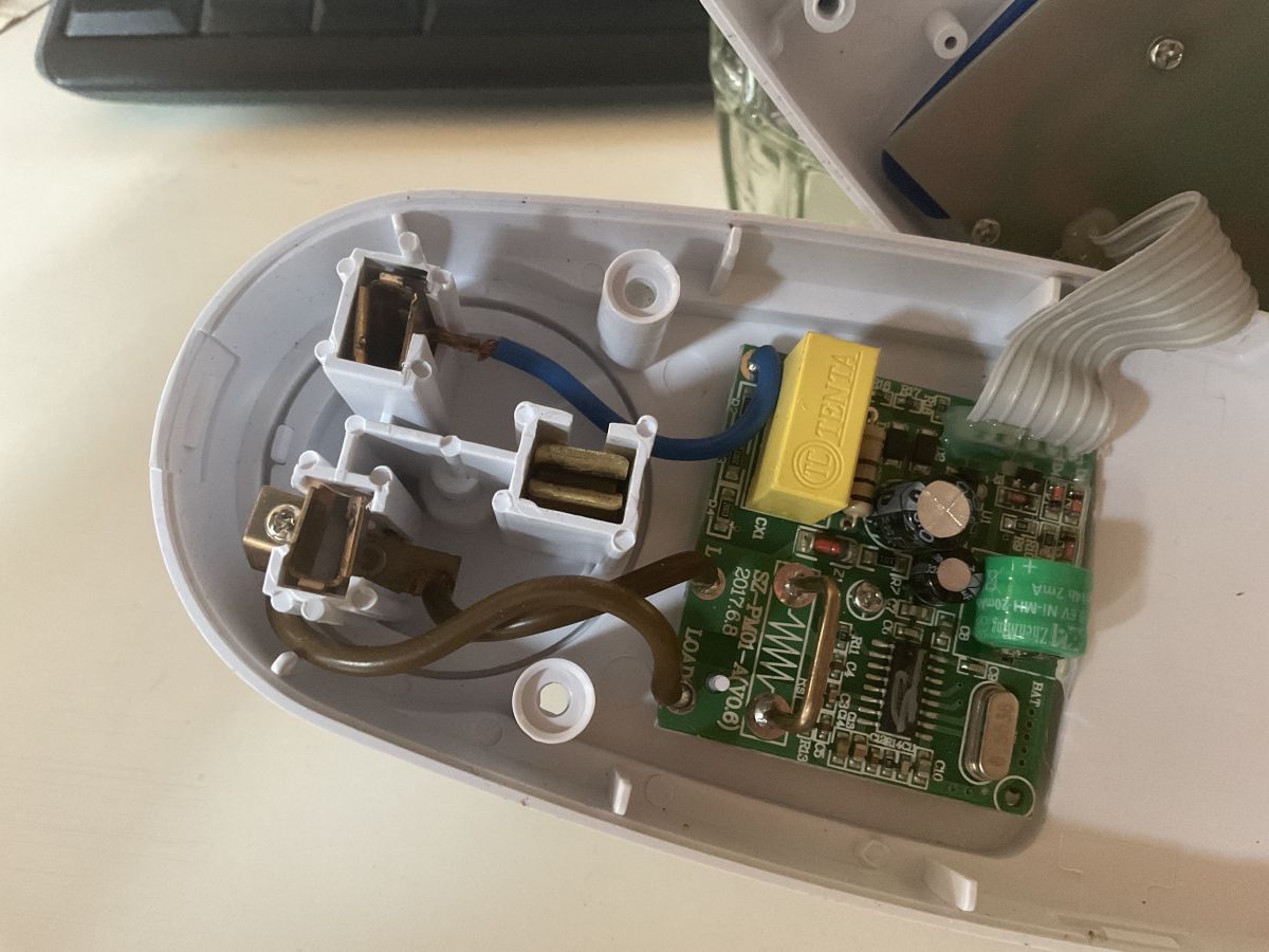

    Hi, I need some advice - I want to connect a smart socket to my washing machine (notification in the app when the washing is finished), unfortunately I have a problem, the washing machine started up with this socket, started making a strange noise (quite loud buzzing), for a moment it worked normally, but at some stage it crashed, after plugging the washing machine directly into a conventional socket, everything returned to normal, probably something is wrong with the specification of the socket, but since I am a total layman, I also prefer to ask what socket to look for so that everything is ok :) below the link to the model of the washing machine and the current socket:

  • Smart socket should be electrically invisible to the washer
    #7 21193130
    sanfran
    Posts: 9987
    Help: 963
    Rate: 3004
    balonika3 wrote:
    Power, is not everything. A kettle, that's a simple resistance heater, and in a washing machine, probably a switching power supply and other damn things.
    In the description of the socket "intelligent power measurement". As far as I'm concerned, this socket should be invisible to the receiver, similar to this wattmeter.
    Which smart socket for the Electrolux EW6S404WP washing machine? Buzzing and hanging up .
    I wonder what the interference might be bringing in. I suspect some sort of non-contact, which is why the suggestion of "warming up" with a kettle.
  • #8 21193132
    balonika3
    Posts: 11103
    Help: 1336
    Rate: 3759
    sanfran wrote:
    In the description of the socket "intelligent power measurement". As far as I'm concerned this socket should be invisible to the receiver, similar to this wattmeter.
    If it's on a shunt, it shouldn't affect anything. Not sure how the switching is implemented though. Maybe some sort of triac and something is sitting there.
