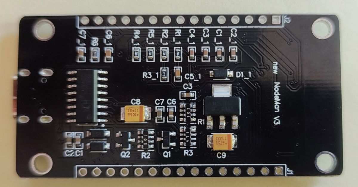

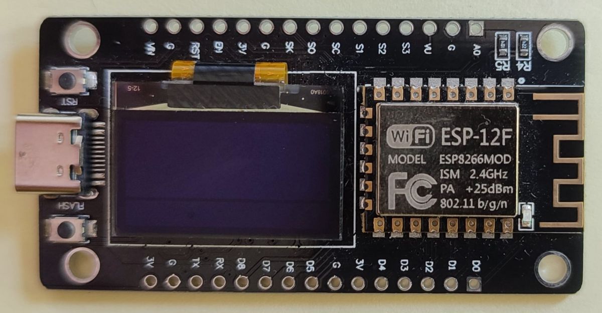

    I was given such a module as a gift, but unfortunately, I don't know on which ports the SDA and SCL are connected, supporting the display? Perhaps someone has an identical board and is able to help?

    Dear Colleagues
    The author has a module with a built-in display
    Trace display pins by following the PCB paths

    I don't know if this is the same model.
    https://draeger-it.blog/arduino-tutorial-61-nodemcu-esp8266-mit-oled-display/
    This one looks the same (dimensionally). Unfortunately without description.

    Best to trace the paths to the display.

    SSD1306Wire display(0x3c, D2, D1);
    These settings helped this display to work correctly.
    Thank you for your help.
