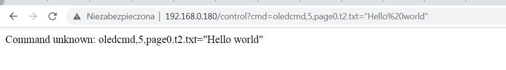

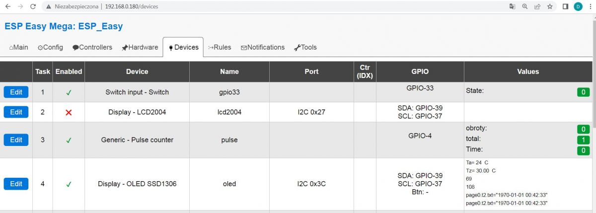

    I'm trying to display something from Domoticz on an oled display connected to an ESP32 board, but I have a problem- it doesn't want to display Hello World. I want to establish communication with my SSD1306 (SH1106) display first and then it will fly. What is wrong in my command line :
    192.168.0.180/control?cmd=oledcmd,page0.t2.txt="Hello world"
    In Esp on line 5 I typed:
    page0.t2.txt="%lcltime%"
    Browser error indicating unknown command for OLED. .
    Screenshot of the ESP Easy Mega interface with display settings. .
    Screenshot of the ESP Easy Mega interface showing a list of devices connected to ESP32. .

    Because you mixed up the two types of display SSD1306 and NEXTION.
    192.168.0.180/control?cmd=oledcmd,page0.t2.txt="Hello world" is the command for NEXTION
    For SSD it should be:
    http://10.20.30.40/control?cmd=oledcmd,wiersz,kolumna,nasz_tekst
    ie.
    http://192.168.0.180/control?cmd=oledcmd,4,1, "Hello world"
    You have to read with understanding.

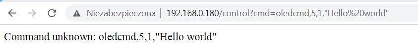

    Good morning, of course you need to read with understanding. I didn't mix anything up, my display is OLED and I'm aware of that, and I'm learning from the Nextion example. I already typed such a command and it rejected.
    http://192.168.0.180/control?cmd=oledcmd,5,1,%22Hello%20world%22
    192.168.0.180/control?cmd=oledcmd,5,1,"Hello world"
    Is this 4.1 or 5.1 the 5th line in the ESP on the OLED device?
    Web page displaying error message Command unknown: oledcmd,5,1,'Hello world'.
    Use ESPEasy OLED command syntax from official docs

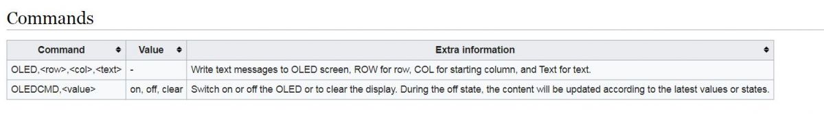

    sznickers wrote:
    of course you have to read with understanding
    The best way is to look at the official documentation for the final version of the software.
    https://www.letscontrolit.com/wiki/index.php/OLEDDisplay
    Learning from an inadequate (old) guide will give you the results w/w :) .
    SSD works on I2C and Nextion on serial - they are radically different drivers.
    From what's in the documentation the command should look like this
    http://192.168.0.180/control?cmd=OLED,4,1,Hello
    I don't have this display so I don't know if the lines are counted from 0 or 1 so I suggest you use 4.
    When trying to do this, try to avoid spaces in the text ( because space in URLs can be different).
    This looks like a good tutorial
    https://espeasy.readthedocs.io/en/latest/Plugin/P036.html
    https://github.com/letscontrolit/ESPEasy/issues/1690

    Starob thank you, it worked :) , and now I will try to make a lua script to show me any value from domoticz on the display.
    Added after 25 [minutes]: .
    As a matter of reading comprehension I did a similar operation for the LCD display and it works and is happy:) :
    Table showing commands for controlling an OLED display.
    192.168.0.161/control?cmd=LCD,1,1,czesc

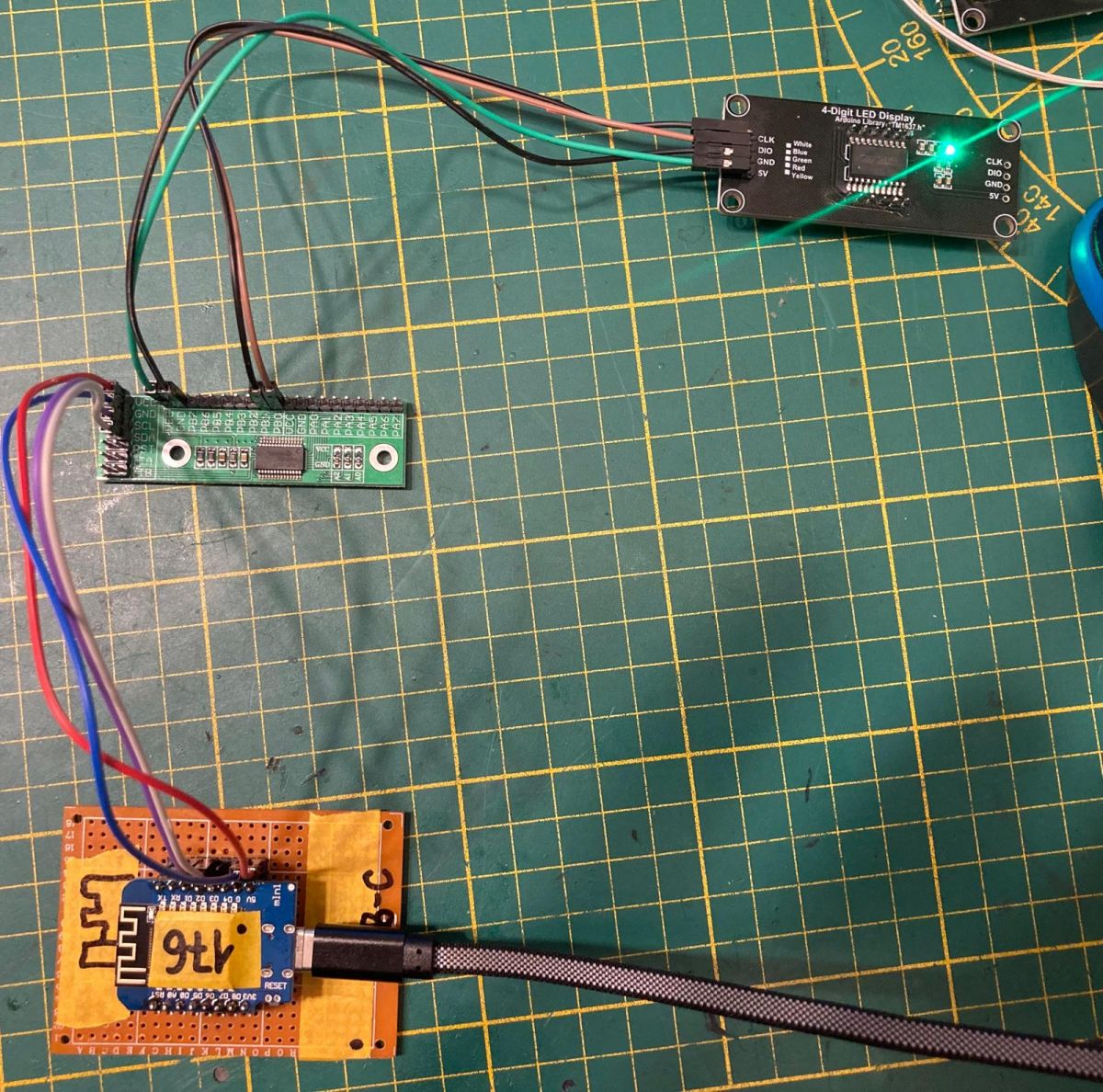

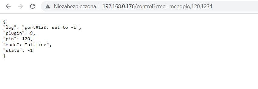

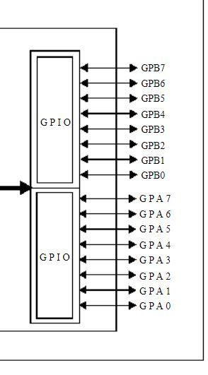

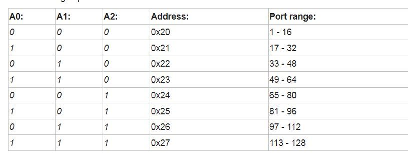

    I am connecting the TM1637 display via the MCP23017 board.
    What command should I enter to make it display me : 1234 ?
    192.168.0.176/control?cmd=MCPGPIO,GPB1,1234
    192.168.0.176/control?cmd=mcpgpio,10,1234
    Circuit with TM1637 display and MCP23017 board on a green mat. .
    Screenshot showing the result of a network query to an IP address. .
    https://espeasy.readthedocs.io/en/latest/Plugin/P009.html
    https://www.letscontrolit.com/wiki/index.php?title=MCP23017
    Table of MCP23017 addresses and port ranges. .
    GPIO pin diagram on the MCP23017 board showing labels GPB0-GPB7 and GPA0-GPA7. .

    There is no such command. Once again you are trying to combine two devices in an incomprehensible way.
    Do you even understand the principle of operation and the purpose of the two boards (mcp, tm)?
    You have only one option - to connect the display directly to the ESP

    It's a lime. I've already connected one display to the ESP board and that works for me, but I wanted to connect several TM1637 displays to one board.

    You could try cascading these displays - from the output of one to the inputs of the other and select 8 digital. This could be an interesting experiment.
    I guess you can add another display in the devices tab on other pins?

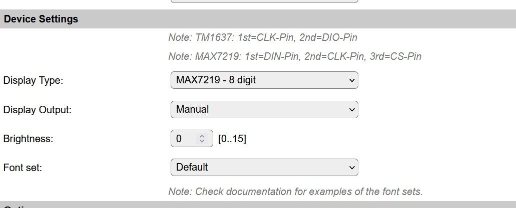

    I'm banging this in the dark. This is what it looks like in esp easy:
    Screenshot of device settings in ESP Easy showing display configuration. .
    If it doesn't work out then plan B is to do it in Arduino
