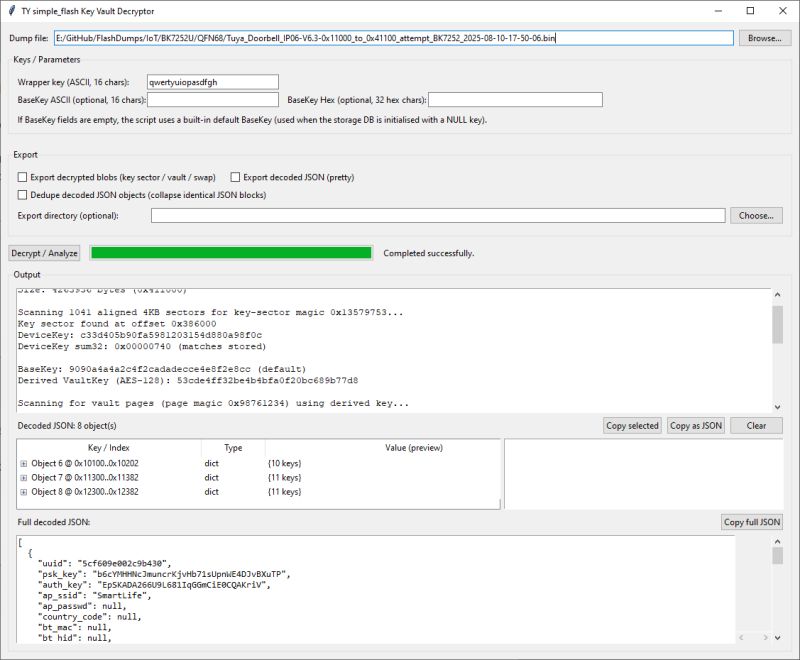

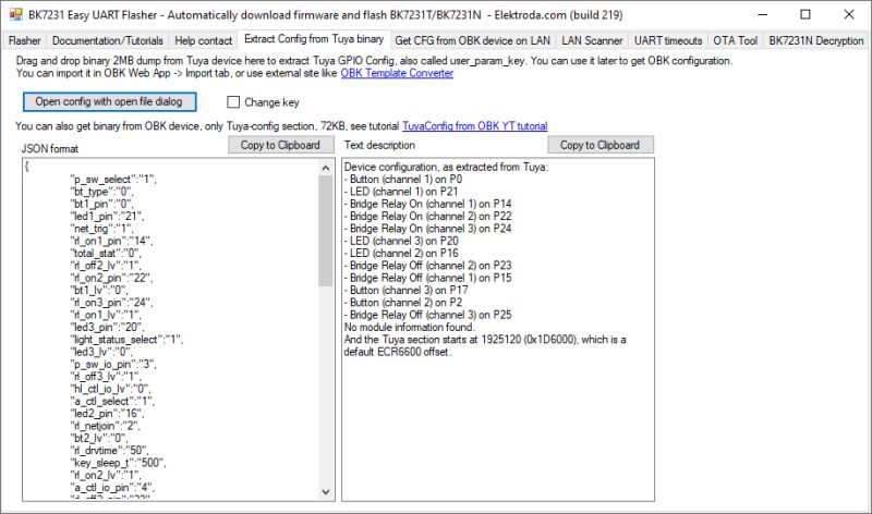

  • I've been trying to figure out why we cannot decrypt the key vault on some Tuya flash backups and why this seems to be the case for certain, typically older, platforms. BK7252U, TR6260, W800 to name a few.

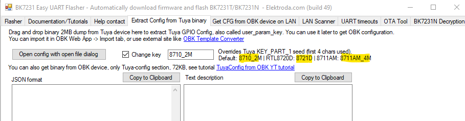

    The decryption method for BK7231N/T (and some RTLs) is known, though the Tuya 'seed' KEY_PART_1 has been known to deviate away from 8720_2M (effectively '8720') depending on the platform.
    eg

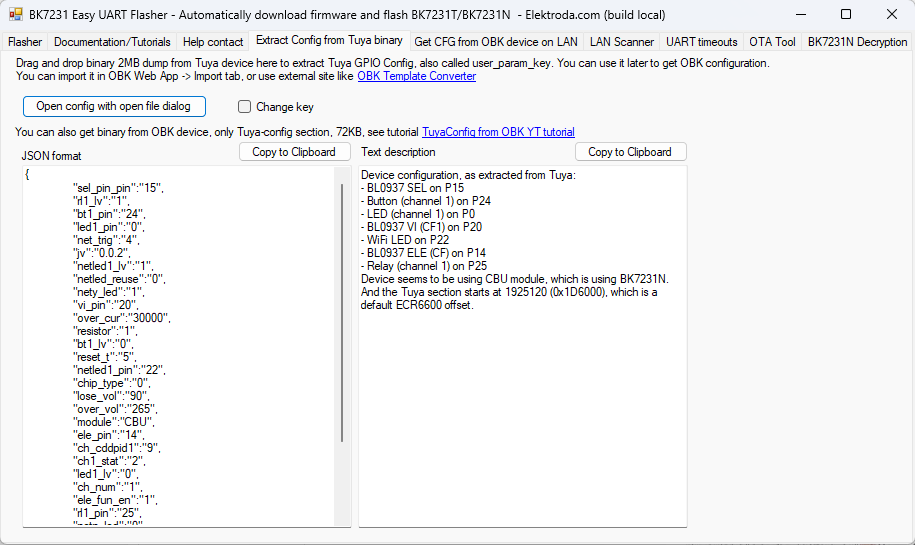

    Screenshot of BK7231 Easy UART Flasher showing Tuya config extraction tab
    In an effort to find the assumed unknown, but present, seed key I spent quite a bit of time in LLM discussions, poring over various SDKs, programmatically trying different plain-text strings from dumps, PowerShell-generated key combinations numbering into the millions, breaking down libs with various csky tools (W800 dump).
    What turned out to be different is that this “vault KV” path is not KEY_PART_1-seed driven at all.
    Instead of the BK7231N/T-style config extractor model (where a platform “seed” influences the key used to decrypt a specific config blob), this vault mechanism is device-key centred and two-stage:
    1) Key-record stage (per-device key material)
    A dedicated “key record” region in flash contains the per-device keying material (including a 16-byte DeviceKey). That key record itself is wrapped/encrypted as a unit (sector/page sized, typically 4KB) and must be decrypted first before the DeviceKey can be read. This key-record page is wrapped using a fixed mechanism (typically a constant wrapper key), and decrypting it is what reveals the DeviceKey used for the vault pages.
    2) Vault stage (derived vault key + page encryption)
    The effective vault key is derived by combining a 16-byte BaseKey with that per-device 16-byte DeviceKey using bytewise addition mod 256. BaseKey is either caller-supplied (p_key) or constructed by the SDK when p_key is NULL (see below).
    The vault payload is then stored as fixed-size encrypted pages (typically 4KB each). Each decrypted page is expected to match a known page structure: a magic value in the header (e.g. 0x98761234) plus an integrity field (checksum or CRC) used to confirm the page decryption is correct.
    Where the “default BaseKey” comes from (when not explicitly supplied)
    The “default BaseKey” is not a flash-layout assumption; it comes from the NULL-key branch in Tuya’s DB init logic inside the prebuilt library.
    Concretely, in libtuya_iot.a (object tuya_ws_db.c.o), ws_db_init checks whether p_key is NULL:
    If p_key != NULL: it copies 16 bytes from the caller-provided buffer → BaseKey = p_key
    If p_key == NULL: it constructs a 16-byte BaseKey in a 16-iteration loop by adding bytes from two embedded 16-byte constants.
    Those two constants both contain the same ASCII seed:
    HHRRQbyemofrtytf
    (16 bytes)
    So the NULL-key case is effectively:
    BaseKey(byte_index) = (seed(byte_index) + seed(byte_index)) & 0xFF
    Doubling the bytes of "HHRRQbyemofrtytf" yields:
    9090a4a4a2c4f2cadadecce4e8f2e8cc
    (which is the “Tuya default (NULL p_key)” BaseKey value).
    How the JSON is recovered
    Once the vault pages are decrypted correctly (i.e. page header/magic + checksum or CRC validates), the JSON is not separately encrypted again; it exists as plaintext within the reconstructed decrypted vault region. Extraction is therefore a straightforward carve/parse step over the decrypted bytes: locate candidate JSON starts ({ or [), bracket/quote-balance to a candidate end, then validate by parsing as JSON before emitting the object (with optional dedupe of identical objects/blocks when redundancy is present).

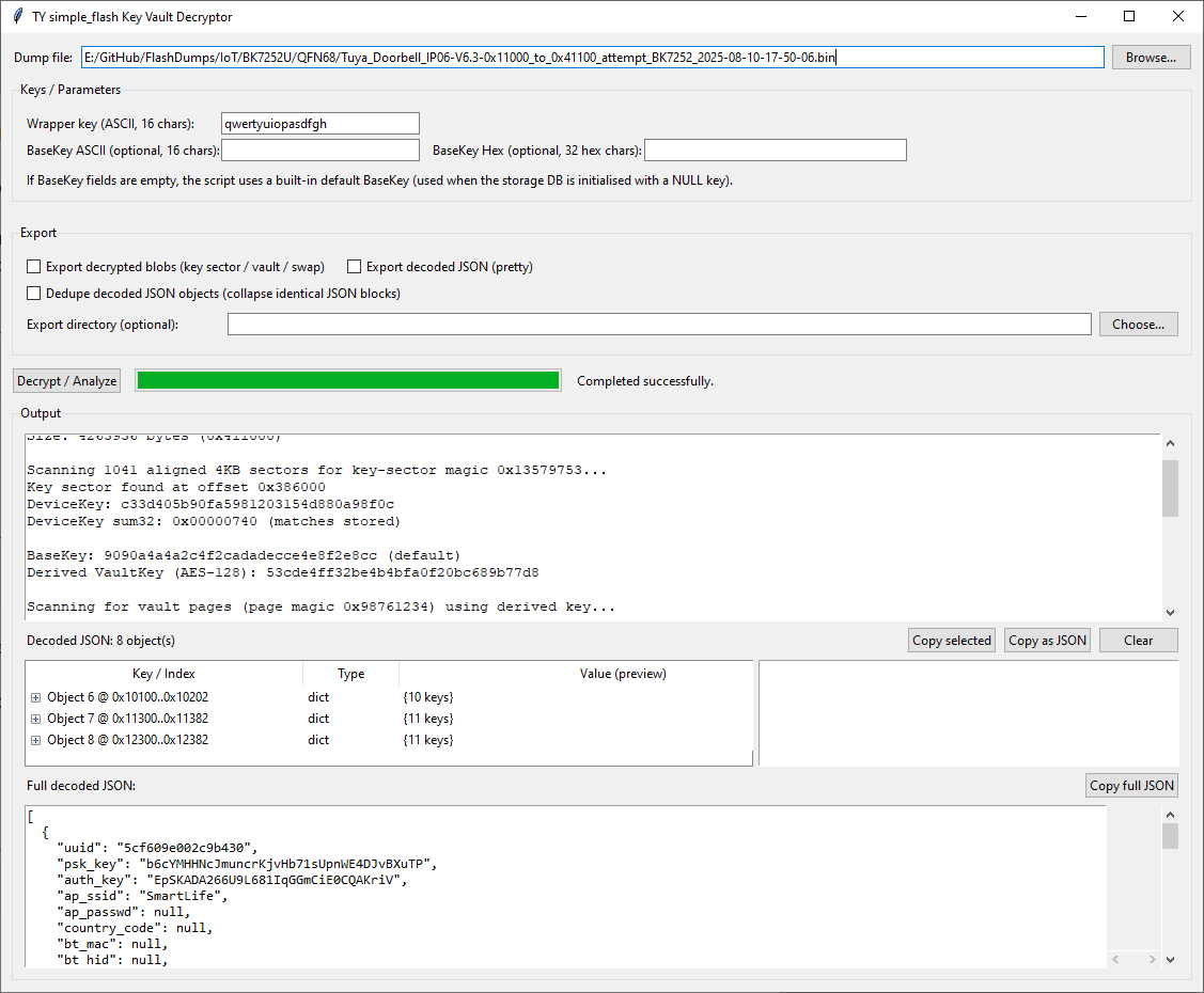

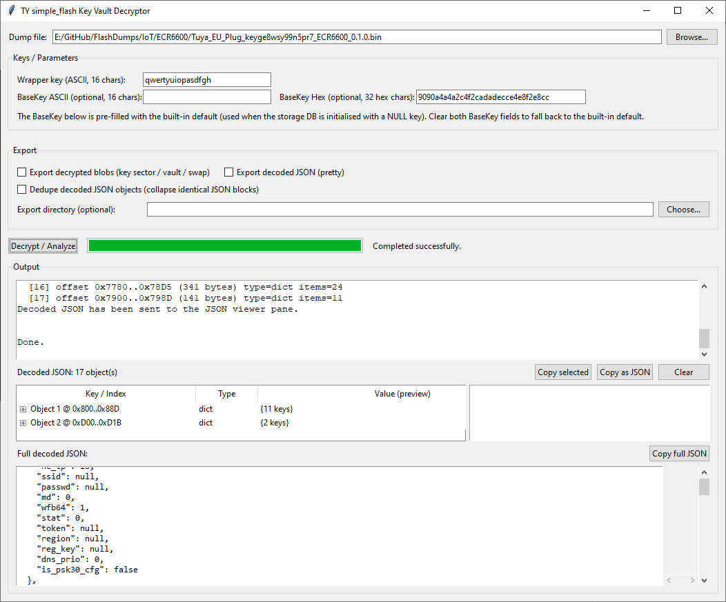

    With that knowledge this tkinter/Python program was then developed with (a lot) of help from an LLM:
    Screenshot of TY simple_flash Key Vault Decryptor with decoded JSON output

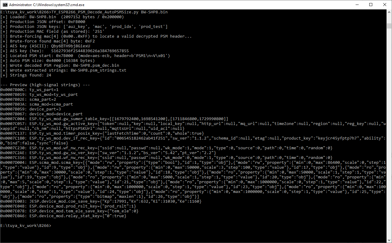

    This uses the above mechanism to decrypt vault-style KV on dumps that are structured this way. I've added options to dedupe/collapse duplicate decoded objects (the vaults appear to contain duplicates / redundancy), export decoded JSON, export decrypted blobs (“swap” relates to a secondary region present in LN8825B dumps).
    In summary, it turns out this method can successfully decrypt the KV on Tuya W800, TR6260, BK7252U, LN8825B and RTL8720CM. However, the key vaults don't appear to contain the same pin assignment information seen in successful extractions from BK7231N etc dumps.

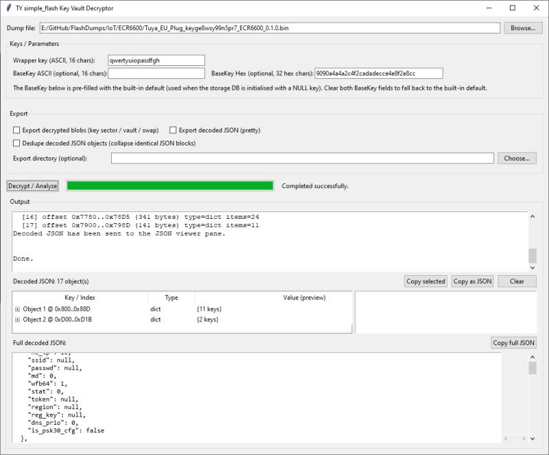

    deduped json from Tuya_EU_Plug_keyge8wsy99n5pr7_ECR6600_0.1.0.bin
    still no pins though :(
    ECR6600 uses the same two-layer scheme as those mentioned in the first post.
    ECR6600 differences for the DeviceKey + BaseKey Tuya vault method
    BaseKey used on ECR6600
    ECR6600 uses the Tuya default BaseKey that is applied when the DB layer is initialised with a null key.
    Default BaseKey hex, 16 bytes
    Derived vault key formula is unchanged
    The per-device vault key is still derived by bytewise addition modulo 256.
    DeviceKey is the 16-byte value stored in the key-record sector.
    Wrapper layer is unchanged
    The key-record sector remains AES-128 ECB wrapped with the fixed ASCII key.
    Wrapper key ASCII, 16 bytes
    Key-record magic
    Vault page header magic differs on ECR6600 and TuyaOS3 style dumps
    Tools already available to us already check for the common vault page magic.
    Common vault page magic
    On ECR6600 style dumps the decrypted vault pages start with a different magic.
    ECR6600 and TuyaOS3 vault page magic
    Same value as decimal
    There is an explicit comment in TuyaConfig.cs noting the alternate TuyaOS3 magic value 324478635, which equals 0x135726AB in hex.
    https://github.com/openshwprojects/BK7231GUIF...19f940/BK7231Flasher/Utils/TuyaConfig.cs#L284
    Screenshot of TY simple_flash Key Vault Decryptor with decoded JSON data
    • TY_KV_Decrypt_ecr6600.zip (9.8 KB) You must be logged in to download this attachment.
    Tuya KV decryption example with device localKey data

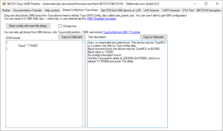

    While this can't extract pins from a backup, it's good for those with TuyaMCU devices.
    From https://www.elektroda.com/rtvforum/topic4097544.html

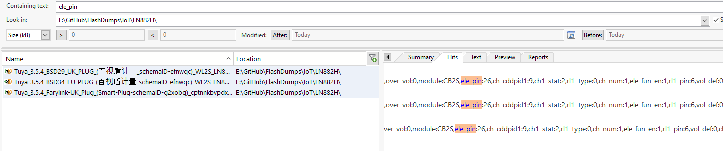

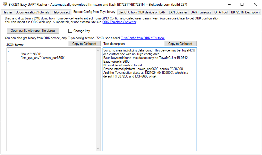

    That's because there is some kind of secondary data structure, each fragment of ASCII text is prefixed with some kind of block header, and we don't parse it, we just naively skip non-printable characters.
  • Loose KV extraction recovers Tuya pin data and baud settings
    #7 21810323
    Posts: 5216
    Help: 448
    Rate: 917
    Good news. The pin data *is* present in at least ECR6600 KV, it's just the extractor was looking for real JSON. The extra info is stored as a brace-delimited key:value block with unquoted keys (not valid JSON).
    Here's a rough, mostly untested one-shot LLM rejig of the Py prog that should accept all the platform dumps that is seen in this thread, but now includes a 'loose KV' extraction too.
    eg
    there's also the baud+more now in the LSC TuyaMCU ECR6600
    maybe LN is the same, but back to the other extraction method with the KEY_PART1.
    note that the json output includes PY-added description bits for the blocks in this version
    Screenshot of a tool decoding binary data into structured JSON format.
    • TY_KV_Decrypt_Universal.zip (12.67 KB) You must be logged in to download this attachment.
  • RTL8720CM Tuya light config data extracted

    yes, a couple of new decoding and extraction methods now required in EF. + nice complete JSON output options

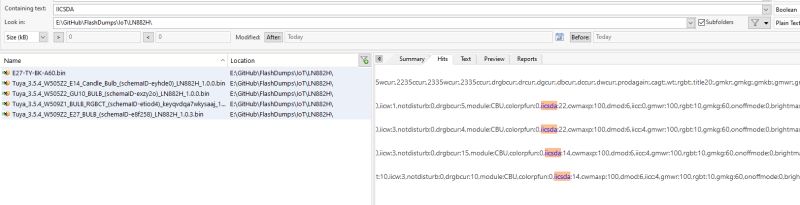

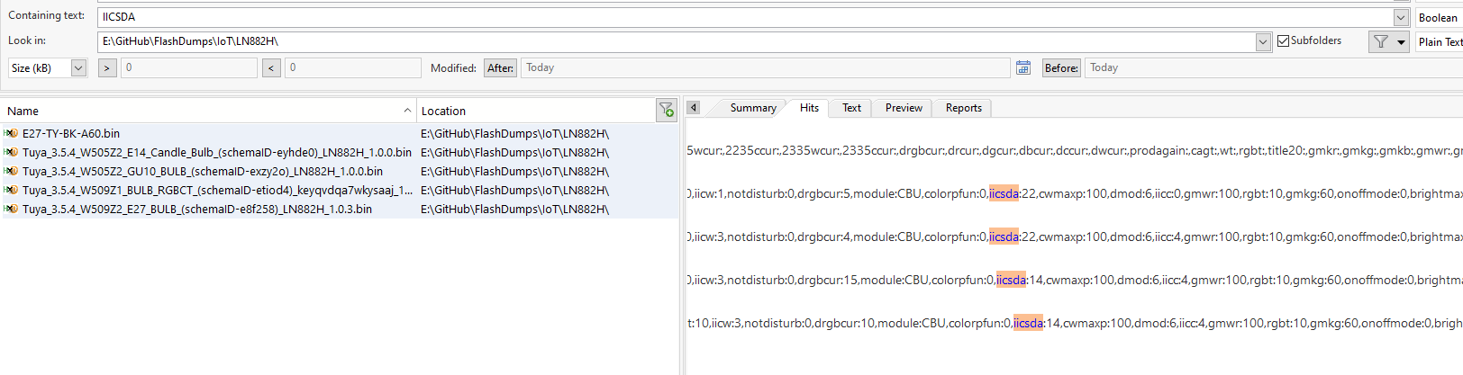

    LN plain text
    Search results for binaries containing IICSDA in the flash dump folder
    File search view showing files and contents matching “ele_pin”.

    ECR6600 Tuya_MCL-Y10-L-03W_keysceeymg7xqvk7_AXYU_1.0.15.bin
    Screenshot of BK7231 Easy UART Flasher showing Tuya GPIO config in JSON and text
    RTL8720CM Tuya_Master_Recessed_Downlight_(schemaID-000003wp7g)_key73ve9nrcgkhck_fy9psuhjzjga4tyg_CR3L_1.2.17.bin
    Screenshot of BK7231 Easy UART Flasher showing loaded JSON configuration file

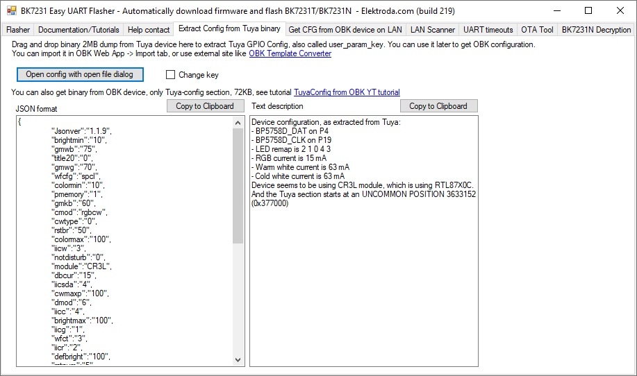

    Screenshot of BK7231 Easy UART Flasher showing Tuya config data and offset info
    Added after 5 [minutes]:
    with the XR806 offset info, shoud it read "And the Tuya section starts at 2052096 (0x1F5000), which is a default T1/BK7238, XR806 and some T34 offset."
    instead of:
    Screenshot of BK7231 Easy UART Flasher showing XR806 Tuya section offset
    (XR806 dump)
    to match this on T3:
    "And the Tuya section starts at 3997696 (0x3D0000), which is a default T3/BK7236 offset."
    and this on T5:
    "And the Tuya section starts at 8245248 (0x7DD000), which is a default T5/BK7258 offset."
    BK7238 dump:
    Screenshot of BK7231 Easy UART Flasher showing text about Tuya section offset 0x1F5000

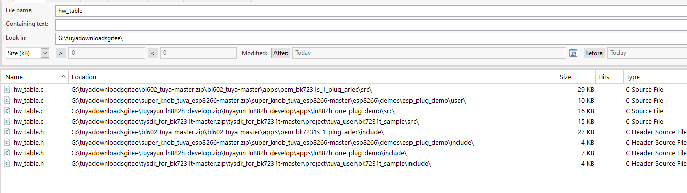

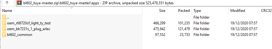

    insmod wrote:
    Is source available
    not finding simple*.c but there are some kv header files in the things im searching.
    these attached zips seem to be the most interesting I think
    one of the folders in one:
    Screenshot of ZIP archive explorer showing three folders in the apps directory
    for those that don't use kvs for pin info?
    Search results for hw_table.* files in folder G:\tuyadownloadsgite\
    • super_knob_tuya_esp8266-master.zip (63.35 MB) You must be logged in to download this attachment.
    • fr-pkgs-tuya-master.zip (14.34 MB) You must be logged in to download this attachment.
    • bl602_tuya-master.zip (164.38 MB) You must be logged in to download this attachment.

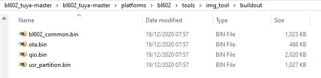

    BL602 boot log confirms unstripped firmware libs
    #23 21813500
    Posts: 5216
    Help: 448
    Rate: 917
    lots of unstripped libs
    Added after 11 [minutes]:
    BL602 built files
    Screenshot of a folder with four BIN files from the BL602 project.
    QIO
    first BL602 Tuya fw I think I've ever seen

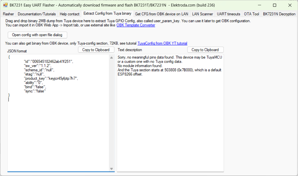

    hey here's something else but for Tuya ESP8266
    The AES key is derived as a fixed 16-byte AES-128 key, built from mostly constant ASCII plus one byte taken from the device’s Wi-Fi MAC.
    The key derivation is:
    -Take the 6-byte MAC address as raw bytes (e.g. e0:98:06:e1:28:cf)
    -Grab the 5th byte (0-based index mac[4] - in the example above that’s 0x28)
    -Build the 16-byte key as: key = b"Qby6" + bytes([mac[4]]) + b"TH9bj8GiexU"
    So it’s:
    4 bytes: "Qby6" and:
    1 byte: mac[4] and:
    11 bytes: "TH9bj8GiexU"
    If it can’t obtain a full MAC (or a direct key), the script will brute-force the single unknown byte mac[4] (0x00..0xFF). For each candidate value it derives the AES key and scans the dump for a PSM page where the first 16 decrypted bytes start with PSM1 or PSM2, and the nearby decrypted payload contains common Tuya/PSM strings (e.g. ty_ws_, ssid, passwd, local_key).
    So when run against an ESP8266 dump in FlashDumps, like ESP8285_TDQ-101-U1-V1.7-20251216.bin we get:
    BW-SHP8.bin
    good for confirming keys, schemas, firmware versions, if not for pin extraction.
    Longer/better script description in the header of the py alongside argument use and examples
    Command prompt window showing decoded Tuya ESP8266 BIN file output using Python script
    • TY_ESP8266_PSM_Decode_AutoPSMSize.zip (6.92 KB) You must be logged in to download this attachment.

    Posts: 14767
    Rate: 12909
    Hey, I remember that BW-SHP8 dump! That's one of my first IoT devices!
    https://www.elektroda.com/rtvforum/topic3687040.html
    Can you add it to Easy Flasher?
    Added after 28 [seconds]:
    How did you figure out the key derivation?
  • Tuya GPIO extraction script finds relay and button pins
    #29 21825393
    Posts: 5216
    Help: 448
    Rate: 917
    indeed. I saw your post and assumed it was the very same one. I then used your Tasmota screenshots to validate another script that seems to be OKish at extracting the GPIO from the hardcoded assignments. Not sure how good/flexible what I have is though.
    as before, scouring for suitable SDKs that contain enough info in for LLM to work it out. libs with enough still in them. Jumped through quite a few hoops to make sure we were confident with the mac[4] line of thinking. Checked reasoning with 10+ dumps.
