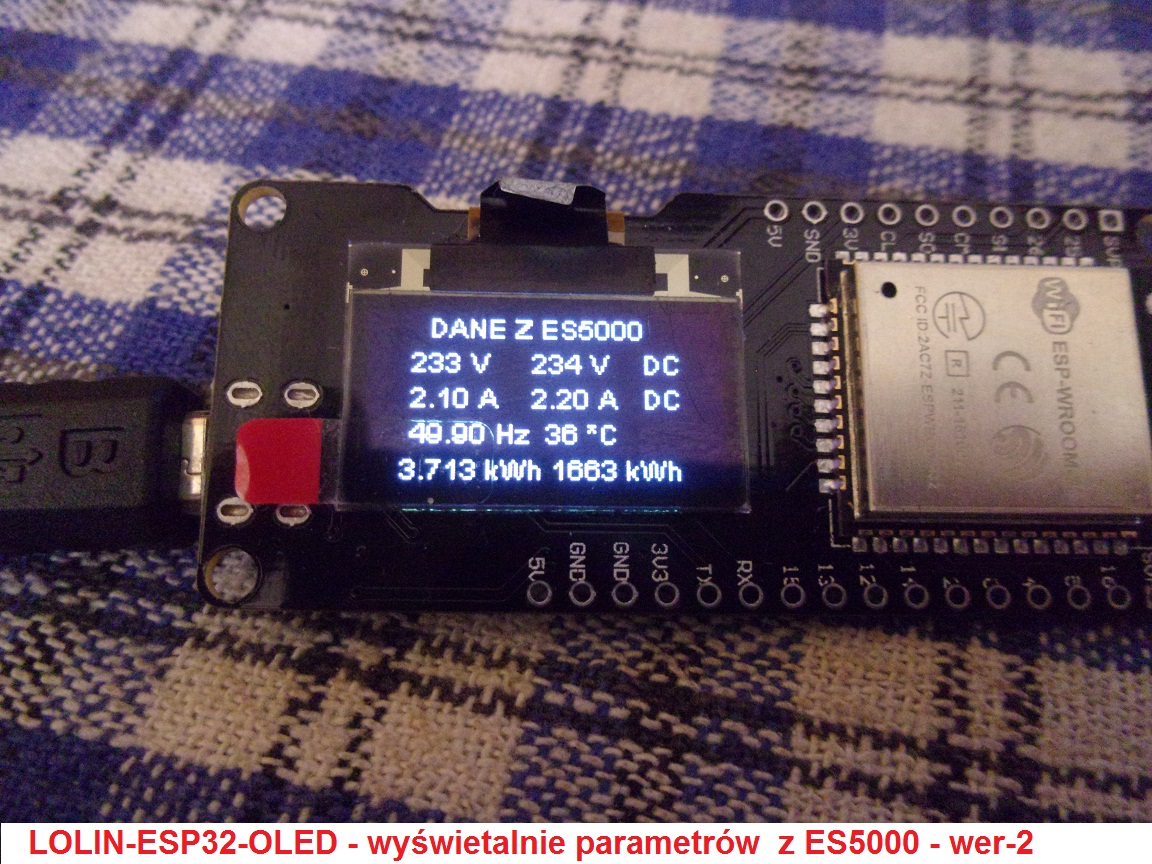

    I use the LOLIN ESP32 OLED module as MINI PV LOGER to my ES5000 inverter. Communication is via WIFI within 50 meters.
    Just a little computer.
    More details and program code on the link below.
    https://www.elektroda.pl/rtvforum/topic2734786-1530.html#17071028
    Best regards.
    Futek2

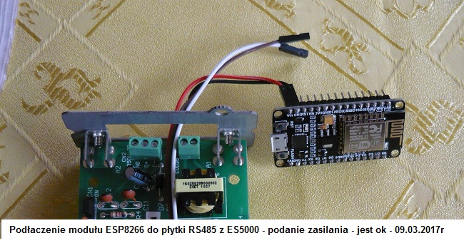

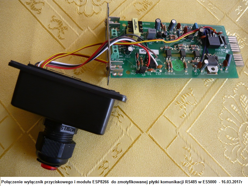

    The ESP8266 is installed in the ES5000 inverter and it has been in operation for almost a year.
    Power supplied by means of a 12VDC / 3.3VDC isolation converter.
    Photo attached.
    On ESP8266 it is written so soft that there is a web server to view the parameters from the inverter locally within a radius of about 50 meters.
    It also works on phones.
    Additionally, there is a data transfer from the inverter to the PV MONITOR server every 3 minutes.
    Photos attached.
    Soft on ESp8266 was written thanks to a lot of help from AKRAWIEC.

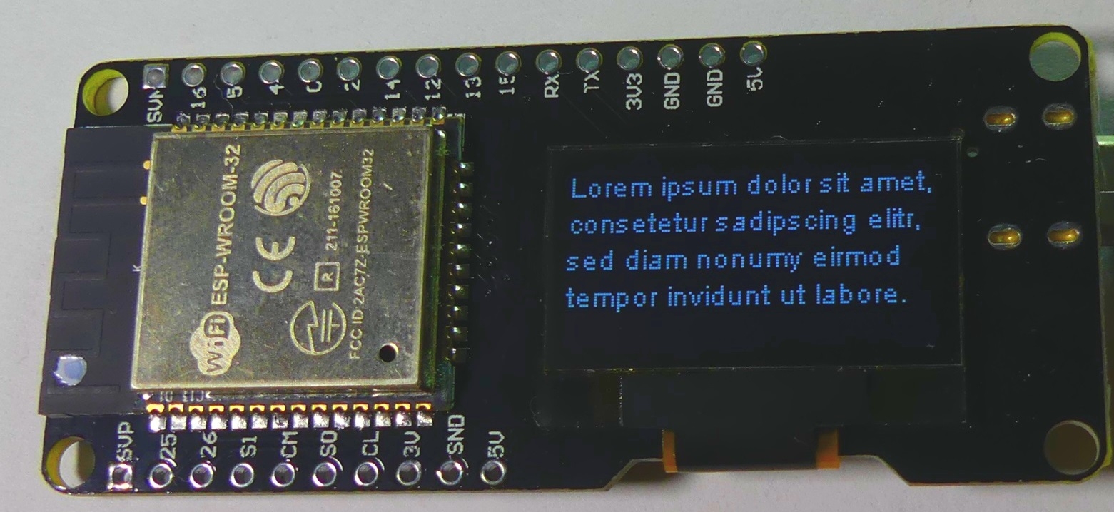

    Hello, I bought this module from gadgets and I have a question whether this OLED is colored or only white inscriptions on a black background.
  • #14 17146134
    futek2
    Level 19  
    Posts: 524
    Rate: 230
    The display in the ESP32 module with OLED is black and white, as in the earlier descriptions on the attached photos.
    https://www.elektroda.pl/rtvforum/topic3436298.html#17071588
    Colors can be inverted, but takes more mA.
    https://www.elektroda.pl/rtvforum/topic3432615.html
    You can also rotate the image to match the letters and numbers in the housing after installing the ESP32.
    Futek2

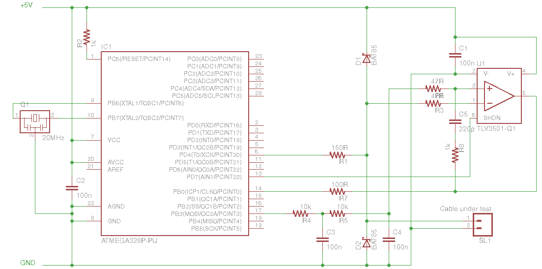

    I am familiar with it, but it does not work in practice. I want to run the TDR meter according to this concept. The electronics are complete.
    https://forum.arduino.cc/index.php?topic=183770.msg1365676#msg1365676
    And now I found such info and maybe it will solve the problem.
    https://www.instructables.com/id/625-Nanosecond-Resolution-Timer-for-Any-Microcontr/
    Because I can't deal with registers on ESP32, I have no experience and the descriptions on the web also raise this problem, but the solutions on ESP32 are not described.
    For example, there is also a description, but no answer.
    https://www.esp32.com/viewtopic.php?t=5629
    Maybe it would be possible, and if not, I will have to write the entire program code from the beginning on ESP32.
    And I decided on this description because the ESP32 has a good processor and fast because 260Mhz, so it beats the uC ATMEGA238P and the accuracy of the measurement in searching for returns in cables would be good.
    According to the preliminary calculations, it would be around 10 cm in error.
    And there was a display that the device could be standalone and small, powered by a lithium battery.
    In the code on ESP32 I have made the website service and you can read the measurement results on the phone. I did it with the idea that the program code could also be run on ESP8266, which has no display.
    Because the tests on the ARDUINO UNO are not very good, the measurement error is about 1.5 meters despite the use of the TLV3501 comparator.
    Basic diagram also attached.
    And as it already looks like, the photo is attached.
    Attached I am sending a description of the principle of operation for those interested in the details.
    In the past it was not possible without the use of an oscilloscope and today it can be done safely with even good accuracy, for example, on the WEMOS LOLIN ESP32 OLED, which was available in the ELEKTRODY shop for points.
    But you should remember to add a quick comparator to the system, e.g. TVL3501, which is not expensive and accessible.
    Best regards.
    Futek2

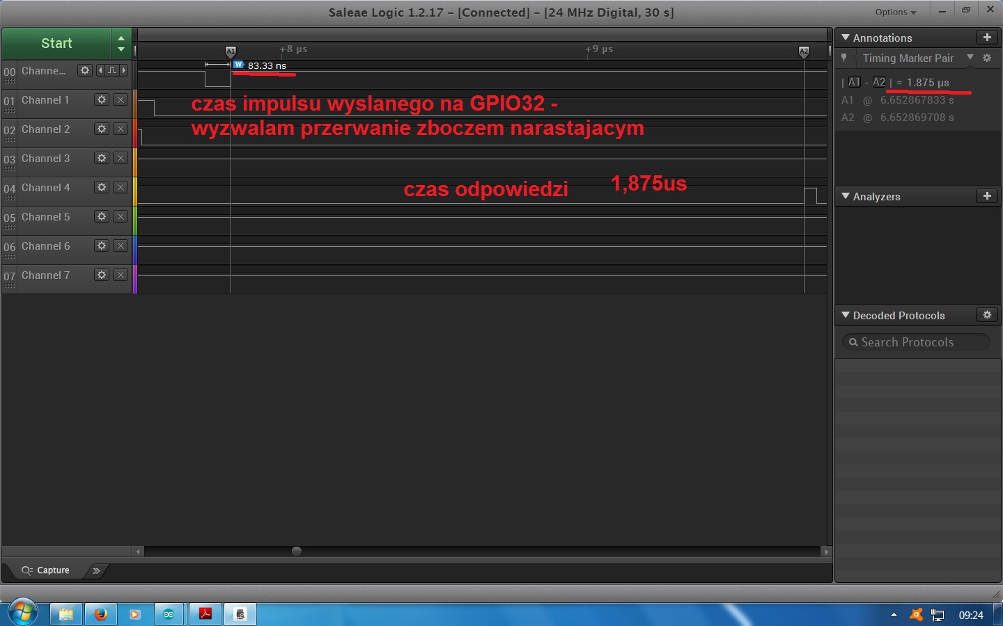

    But when I checked what impulses appear with the help of the LOGIC ANALYZER, it occurred to me that this device would also be possible to use to measure the time of the echo appearance.
    When testing the ESP32 option, I measured the pulses with a time less than 1us using the LOGIC ANALYZER - photo in the connection.
    And then divide by 2 and help by i deceleration factor of the wave propagation in the wire depending on the insulation.
    But maybe one of the readers will support the topic.
    In the LOGIC program that supports the LOGIC ANALYZER, it is possible to install your own PLUGINs in which you can define practically whatever you want to show and calculate the LOGIC ANALYZER.
    But using ESP32 gives you more possibilities because there is no need for a PC.
    I am hopeful that the topic will develop and there is some helpful information on how to use timers on ESP32 registers and you only need 2 one to generate the pulse and the other to measure the time after which state 1 will appear from the comparator when the echo signal appears.

    In recent days, after reading the ESP32 parameters, I found out that there are GPIO in a different group of registers and they are GPIO 32 - 39 and I did such tests that on ESP32 I made a simple pulse generator with a short time, i.e. 1us and sequentially changing the GPIO number that I connected with the sending GPIO I controlled these pulses with the LOGIC ANALYZER times of appearance of the control pulse as a response to the interrupt from the selected GPIO INPUT.
    My tests have shown that the fastest in response is GPIO32 responds to impulses with a duration of about 83ns, but the response appears after 1.875us. Photos with measurement results attached.
    GPIO 32 is the first in a different register group with the address 0x3FF44040 .
    Control pulse time 41ns.
    GPIO 34 - 39 are systemically only INPUT on board ESP32.
    I pass this info on because it may be useful to other people interested in using ESP32 for their construction.
    Futek2
