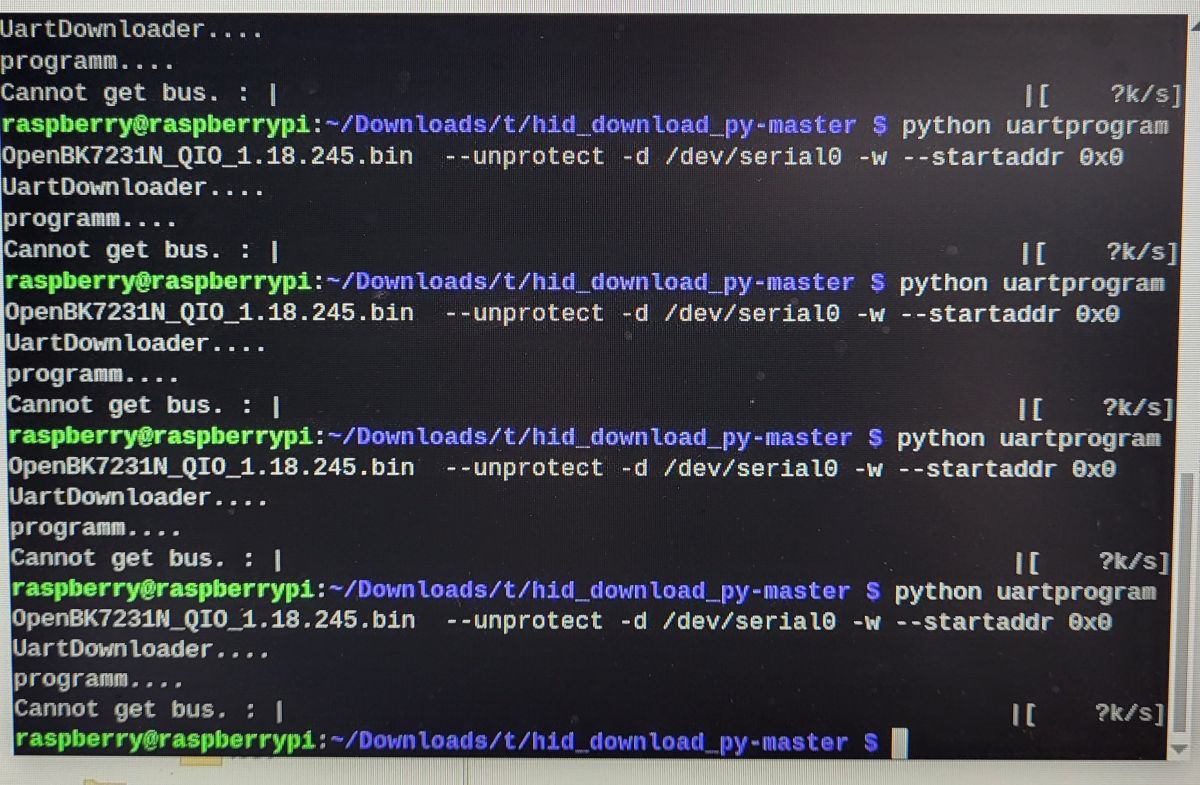

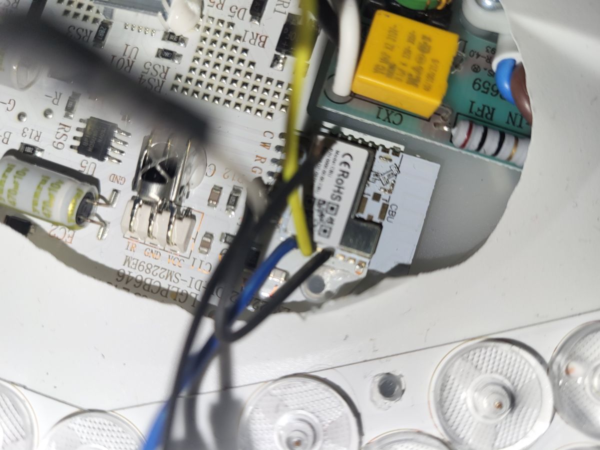

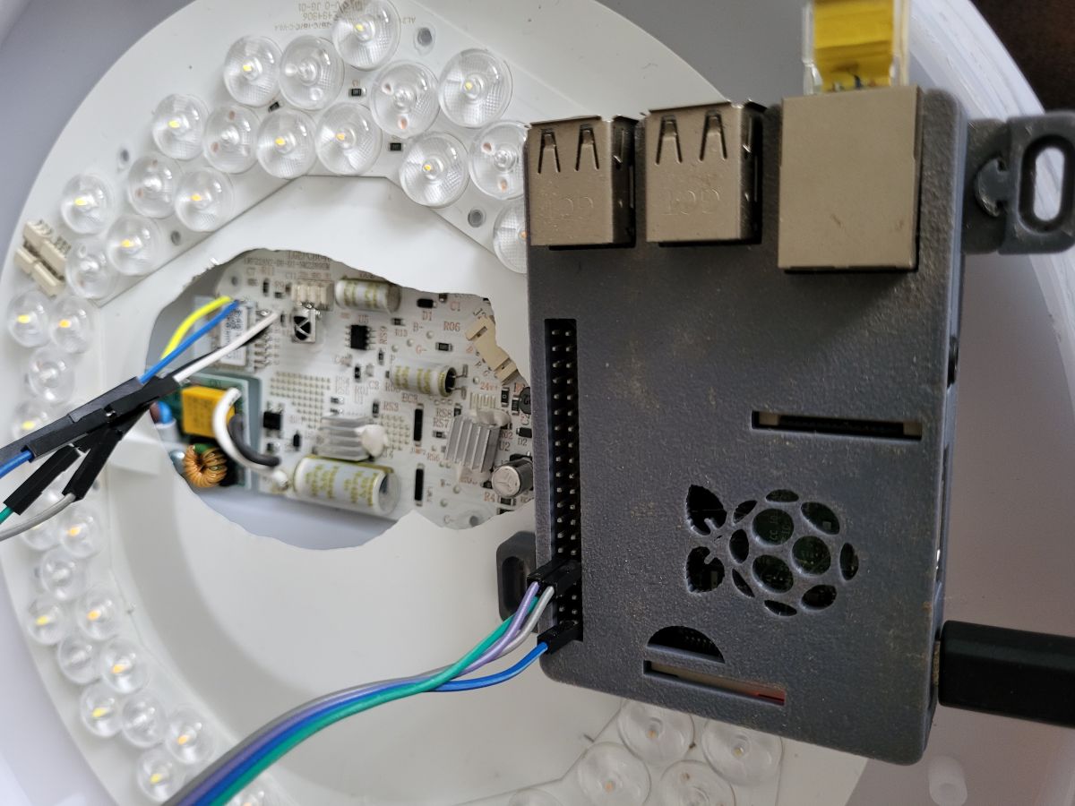

    Hey there,

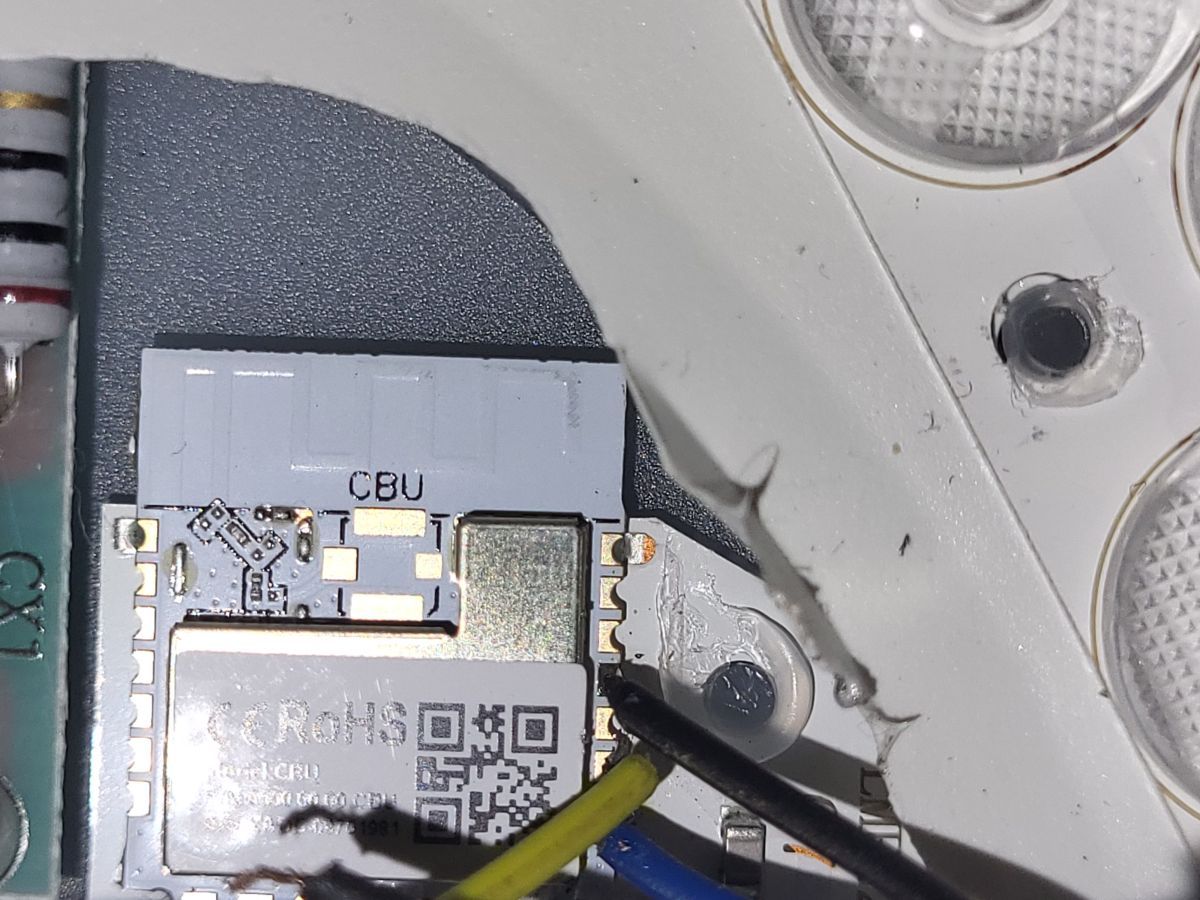

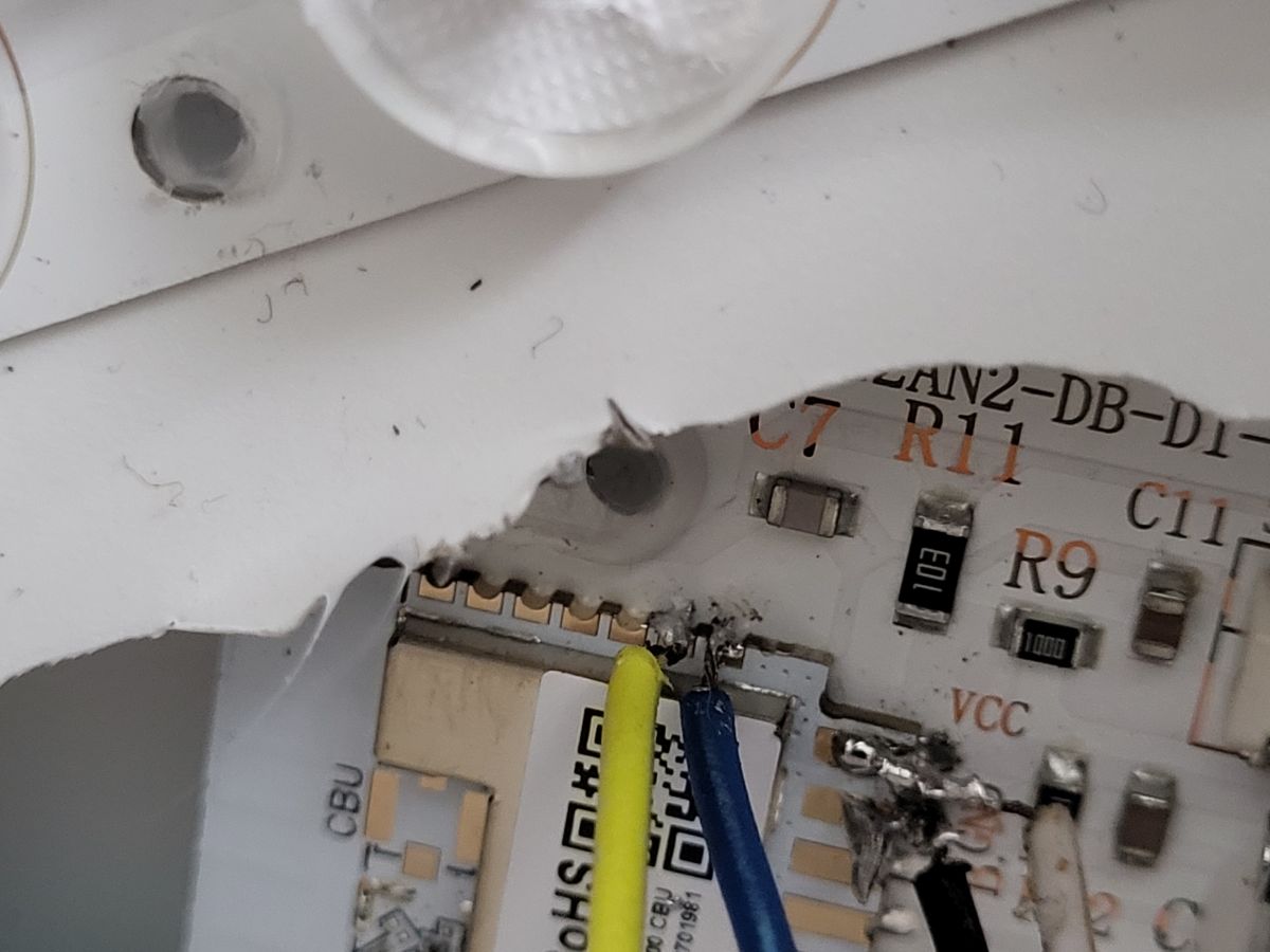

    Currently I am working on the new LSC ceiling lamps.
    When I opened the lamp, I found the CBU module which I need to flash.
    I followed the approach of the following topic: https://www.elektroda.de/rtvforum/topic4016628.html
    But it did not work for me. I don't think that my power supply (RasPi) is too weak.
    I did not use the CEN pin because the other person did it without too 😅
    Any ideas?

    Welcome to forum! We will try to help you, let's check each possible fault scenario step by step.
    How long are the wires? Wire length can cause issues.
    Maybe RX and TX is swapped? Try swapping it.
    Are you doing power off/on cycle correctly? By disconnecting 3.3V wire?
    Did you try different baud rates?
    Maybe there is something connected to TX/RX pins of CBU on your device and it interferes with connection?
    Less than 15 cm. I don't think that's the issue. I could successfully flash an LN882 chip with this setup (https://www.elektroda.com/rtvforum/topic4091325.html)
    Maybe RX and TX are swapped? Try swapping them.
    Yeah, I tried that already. No success.
    Are you doing power off/on cycle correctly? By disconnecting 3.3 V wire?
    I did not ^^. Can you give me some details on that?
    I used 115200. Still not working
    python3 uartprogram firmware_backup.bin -d /dev/serial0 -r -s 0x0 -l 0x200000 -b 115200
    --> cannot get bus
    The RX/TX pin is not soldered to the device. There is no connection between the device and the RX/TX pin.

    When device is "getting bus", you need to do short power off/on cycles, by detaching 3.3V wire. It's a standard procedure for Beken chips. You must do it exactly when the flasher is trying to "get bus", not before it, and not too late.

    >>21807876 Seems tricky to do it in a short time span ^^
    The alternative would be to short/bridge CEN to ground?
    Flashing CBU Module in New LSC Ceiling Lamp—Power Supply and CEN Pin Considerations
    I will test both strategies tomorrow. Thanks for the help

    I think you should use our flasher, it gives more time to get bus.

    in the beginning I was using my Pi with Linux. I now got a UART USB stick and could try to flash the chip with Windows and the new Windows program.
    I had some poor cable connections, but in the end I managed to flash the new LSC ceiling lamp with no effort. Thanks for the help and suggestions.
    I tried to extract information from the original firmware, but no luck. Firmware in attachments. Result is:

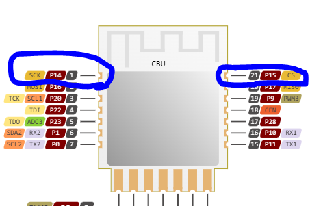

    The new LCS lamp uses a CBU chip with 5 pins (WC/RGB) which I could set up in the web app. I can control the lamp via the web app. New firmware config in attachments.
    But the CBU chip has another two pins in the top left and right.
    CBU module diagram with pins P14 (SCK) and P15 (CS) highlighted
    CBU electronic module with wires and part of an LED enclosure
    Close-up of PCB fragment with LG PCB646 marking and electronic components

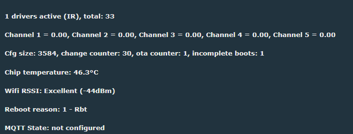

    My problem is that I cannot use the IR remote anymore.
    My assumption is that the IR sensor on the PCB communicates with the CBU chip via these two pins. But the original firmware does not show the pin layout.
    Any ideas how to set up the OpenBKN firmware so I can use IR again?
    Edit:

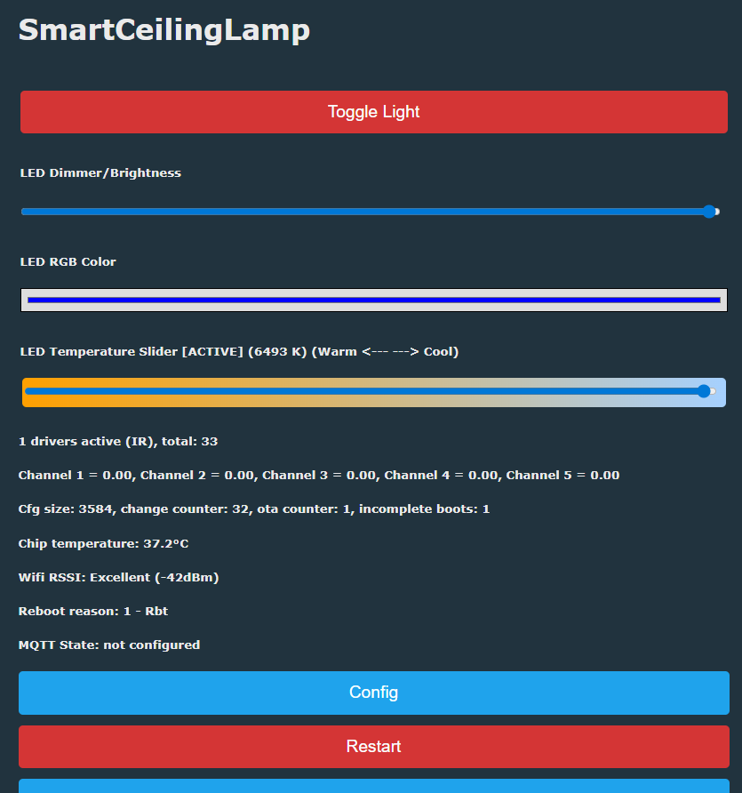

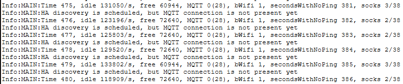

    making pin 21 to ir-receive does not work. it will start the corrosponding drivers but it does not show IR-commands in the log when i press the remote.
    OpenBKN logs showing idle time and no MQTT connection established
    Dropdown with selected IRRecv and an input field set to 0
    Screenshot of system diagnostics showing 1 active IR driver and chip status data
    Maybe it does get IR-Data but does not do anything with it because the lamp is not connected to homeassistant? does it need a mqtt connection to be able to receive IR-data?

    Is IR driver running? Is IR pin role set? Disable PowerSave 1 if it's running.
    You need to reboot after setting IRRecv role.
    No MQTT is needed to receive IR data.
    This topic can show you how to setup IR:
    https://www.elektroda.com/rtvforum/topic4133695.html
    It's using different BK but the procedure is 100% the same.
  • Pin 14 SCK may be required for IR receiver communication
    1. IR is running.
    2. I set up pin 21 as IRRecv.
    3. It is not running
    I did
    Thanks for the info
    This topic can show you how to set up IR:
    It's using a different BK, but the procedure is 100% the same.
    I followed the tutorial. Still no luck.

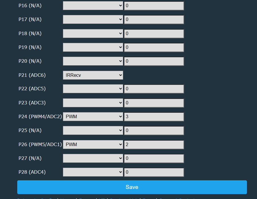

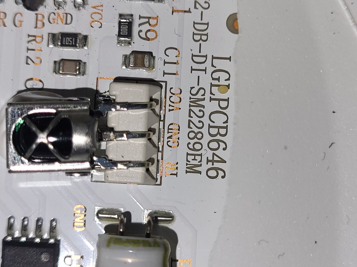

    I can confirm that pin 21 is the correct pin. I can see the trace going from the IR to the CBU chip. I have set up OpenBeken, but the web app shows no response in the log after pressing the IR remote.
    (I guess it is because of Pin 14 SCK. It is connected to the CBU chip [last picture you can see it] but was not referenced in the OpenBeken setup. i guess it it used to communicate to the IR-receiver.)
    CBU module pin diagram with pins P14 and P21 highlighted in blue
    Screenshot of configuration interface with dropdowns for pins P16–P28SmartCeilingLamp control panel with sliders and system status information visibleElectronic module with CE and RoHS labels on LED circuit boardClose-up of electronic module labeled CBU with connected wires on a circuit board.

    Is there a voltage between GND and VCC of IR Receiver? Check with multimeter.
    Maybe you need to set one of the pins to AlwaysHigh, so it enables power of IR receiver? I am just guessing.
    Disconnect device from power, and check with multimeter - is VCC of IR Receiver connected to VCC of CBU module?
  • Wrong pin assignment fixed module configuration
    #12 21815403
    derKeks
    Posts: 14
    Added after 8 [hours]:
    It is working now! Thanks you a lot!!!! As a gift i will make a good template for the database. with a good picture of the box and all information.
    The error: in the module configuration i used PIN21 instead of PIN 15.... ^^
