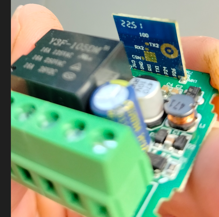

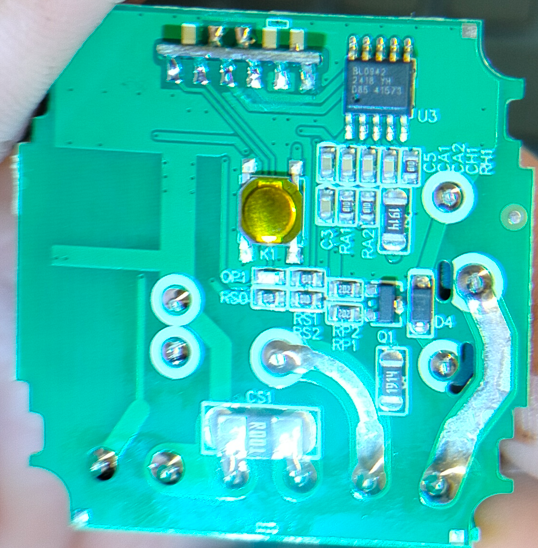

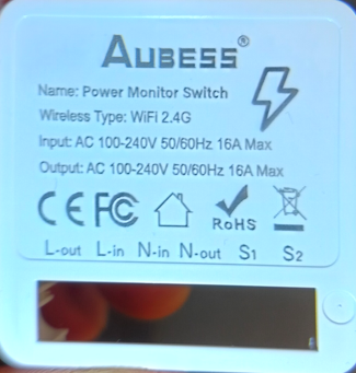

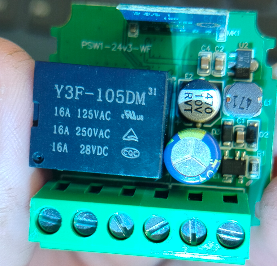

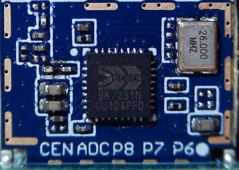

    I bought this AUBESS "Power Monitor Switch"
    I umounted it, founding a BK7231N
    Connected 3.3V, GND, TX, RX under the small board
    Backed up using BK7231Flasher , and then flashed latest openBK
    Following the found json

    Device seems to be using CB2S module, which is using BK7231N.
    How can i find and setup the channel for the power measurement?
    Attached some photos, do you need other infos?
    Thanks

    BL0942 is always using UART1 for communication. You need to enter:
    startDriver BL0942
    in your either autoexec.bat or short startup command. Then reboot. Then you need to calibrate, like you'd do in Tasmota. VoltageSet/CurrentSet/PowerSet commands.
    For this kind of device, you also might need to enable PowerSave 1 so the device capacitors can last longer.

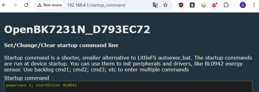

    I flashed another identical device, and I have many questions:
    1. S1-S2 switch gives me problems. P24 is TglChnOnTgl but when left unconnected it randomly double toggles (like 1 time every 3 seconds). Switch usually off but relay turns on and off very fast because of that false signal. If I short circuit S1 S2 the relay remains stable, but if I open S1 S2 it starts ticking again. I found a stable 3.3V between S1 and S2
    2. I wrote on startup_command "powersave 1; startDriver BL0942" but idk where I can read the power consumption. I tried to calibrate the device having this message
    Last command: VoltageSet 226
    Last status: ERROR: Unknown command (undefined)
    If I go to the console and I write "startDriver BL0942" then I start having "Last status: OK (200)!"
    PS: when I enable the driver I also can read the measure, so why it doesn't start on boot?
    Thanks

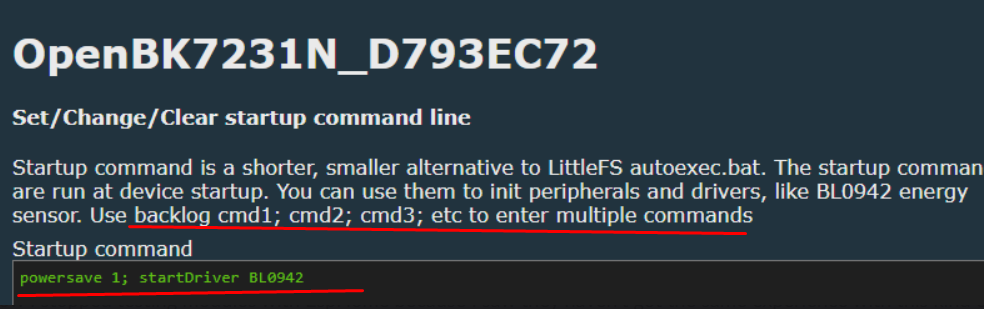

    Let's do one issue at time. Where do you enter startDriver command? Startup command is run after reboot. VoltageSet command is available once driver is started. There is information about running drivers in the main page.
    I don't know much about Esphome. Last time I checked it had just powersave copied from OBK by one of our user. OBK, on the other hand, is calibrated to utilize OBK powersave - as far as I remember it was done few years ago by @ btsimonh, who adjusted timers to allow longer dynamic sleep. Just keep in mind that device won't sleep if you keep web app log open.
    By "this kind of devices" I mean like smart plugs or smart switches. Or... or just enable PowerSave 1 on any OBK device. It should be okay since we adjusted PowerSave to take BL0937 into the account.
    From here:
    [BK7231N] AUBESS Power Monitor Switch - Setting Up Power Measurement Channel
    For now I stopped testing modules with EspHome because I saw they haven't got the same experience with this kind of cpus and I want to minimize surprises.
    For example I don't have time to test real module consumption with different firmware to check that consumption are comparable.
  • #7 21584469
    Posts: 14795
    Rate: 12952
    If you want to run multiple commands in line, you need to use backlog - like in Tasmota.
    So now, you need to either:
    - add backlog at the start of line
    OR
    - put each command in separate line
    In current state, second command is not run.

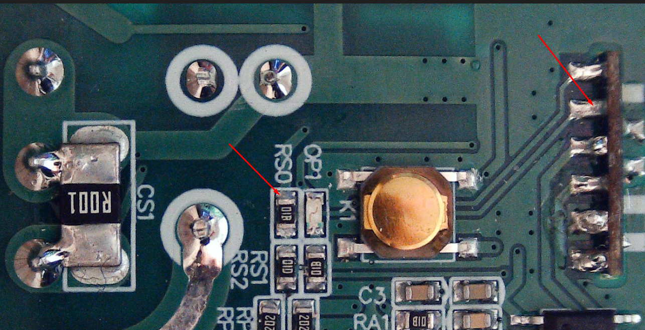

    #8 21584534
    brazoayeye
    Level 4  
    Posts: 20
    Thanks! I had missed that backlog was a keyword. I suggest to write something like: write one command in each line or use the keyword backlog to group them (ex "backlog cmd1; cmd2; cmd3)
    Do you have ideas regarding the S1 S2 problem?
    S1 is connected with N-OUT
    N-OUT have a 0.001 ohm to N-IN
    cpu GND is connected to N-out or N-in (idk which)
    S2 goes to RS0 (1k) and then directly to P24 (arrows)
    Do you know if there is a capacitor between S1 and S2 that I should check?
    Thanks

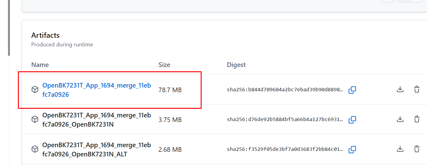

    Posts: 14795
    Rate: 12952
    Sorry for the delay, next time please just ping me earlier, okay? I might have missed that post.
    ThlChannelOnToggle works on my devices, but devices come in different versions. Tgl tries to be more responsive than dinput, but maybe our algorithm is too eager, here's other version to check:
    https://github.com/openshwprojects/OpenBK7231T_App/pull/1694
    Please download artifacts with OTA file from Github there and try it on your device, and let me know if it works?

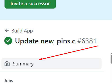

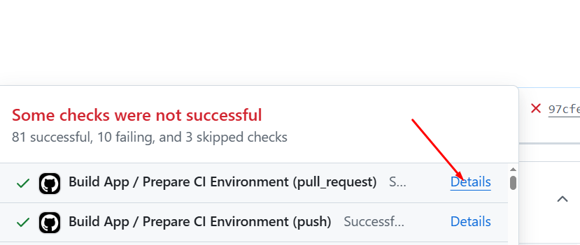

    Rate: 12952
    This is how you can find zip with RBL for BK7231N
  • #13 21590997
    brazoayeye
    Level 4  
    Posts: 20
    Perfect, using OpenBK7231N_1694_merge_11ebfc7a0926.rbl the signal is stable also with tglChnOnTgl
    Will it be merged to the next release?
    Thanks

How can I verify the driver really started at boot?
Check the main page for running drivers. If values only appear after manual startDriver BL0942, your startup line didn’t run both commands. Use backlog or separate lines to ensure execution. [Elektroda, p.kaczmarek2, post #21583963]
