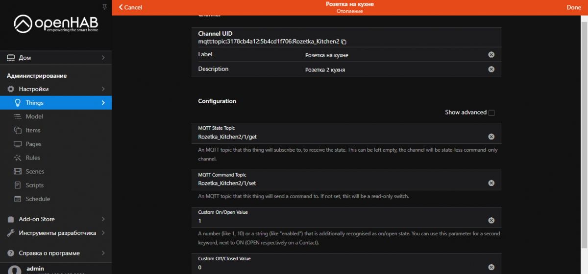

    Hi all! It might be useful to someone. mqtt OPENHAB settings. Power socket.
    example
    MQTT settings interface in OpenHAB for a kitchen power outlet.

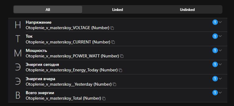

    Hello! There are 6 main indicators (voltage, current, power, Today, Yesterday, Total)
    Screenshot of energy indicator settings.
    Could not get indicators for (Apparent Power, Reactive & Power Factor) They're not very important.

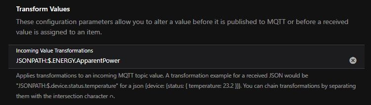

    The line comes in the form Error:CMD:cmd SENSOR NOT found (args {"Time":"2023-12-13T14:34:59","ENERGY":{"Power": 0.000000,"ApparentPower":4.548851,"ReactivePower":4.548851,"Factor":0.000000,"Voltage":238.935379,"Current":0.019037,"ConsumptionTotal":23922.955078,"ConsumptionLastHour":0.000000}})
    On tasmota data through transformation JSON

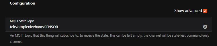

    MQT: tele/otoplenievbane/SENSOR = {"Time":"2023-12-13T14:39:48","ENERGY":{"TotalStartTime":"2020-07-25T12:32:30","Total":227.963,"Yesterday":1.039,"Today":0.514,"Period":1,"Power":50,"ApparentPower":512,"ReactivePower":510,"Factor":0.10,"Voltage":237,"Current":2.162}}
    Screenshot of MQTT State Topic configuration for a device.
    Screenshot of value transformation settings for MQTT.

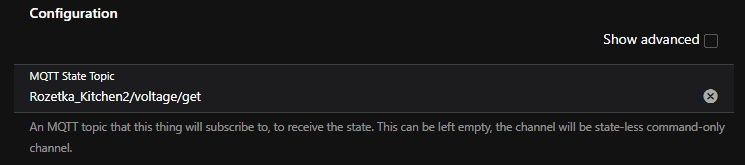

    Setting example. Data collection in OH.
    Screenshot of MQTT topic configuration in OpenHAB.
    Setup is very simple.
    Other data indicators are similar.
    yordevice/energycounter/get
    yordevice/energycounter_yesterday/get and etc.
