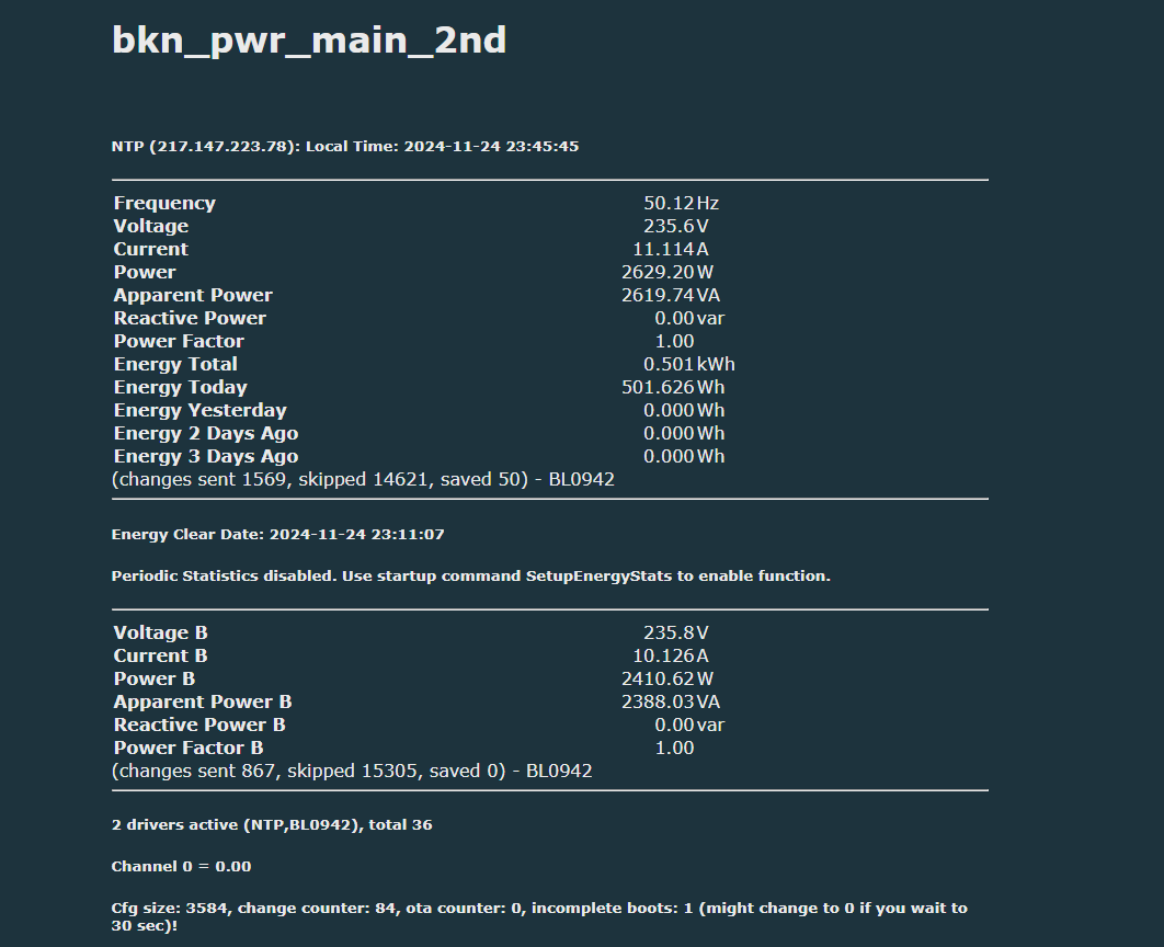

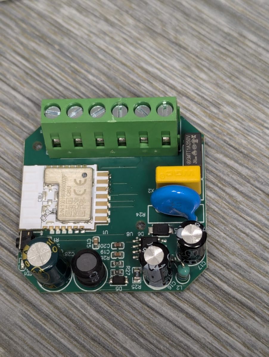

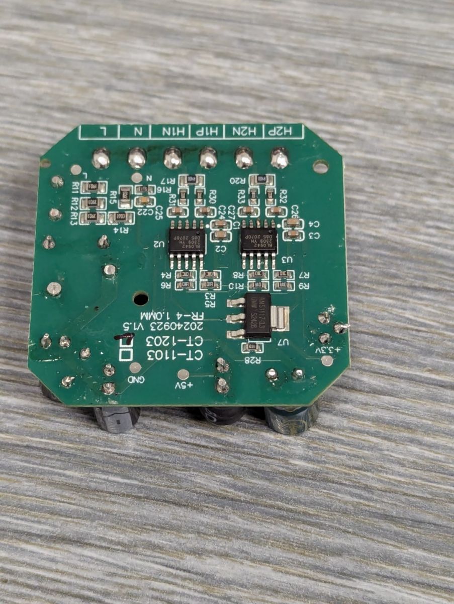

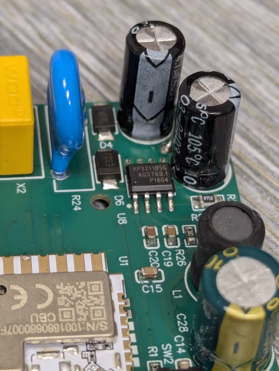

    I have new device energy power meter with 2 BL0942 chips - one over UART 1 and the other over UART 2.
    There is no Tuya Chip.
    BL0942 on UART1 working good.
    But, I only get zeros on the second uart {with flag 26 set to 1}
    Has anyone working BL0942 on UART2 ?
    The module is a CBU (BKT7231N)
    LED on P9
    Button on P24
    Flashing is done without desoldering (GND, 3V3, RX1, TX1), no need for CEN, just simple turning on the device for flashing routine.
    Close-up of an electronic circuit board with various components, including capacitors and a module labeled CBU. Close-up of an electronic module with installed capacitors, resistors, and a chip. Top view of an electronic board with various components, including a CBU module. Circuit board of an energy measurement module with electrical components. Printed circuit board with two visible BL0942 integrated circuits and electronic components.
    I found another user with a similar device: https://www.elektroda.com/rtvforum/topic3946128-90.html#21050660.

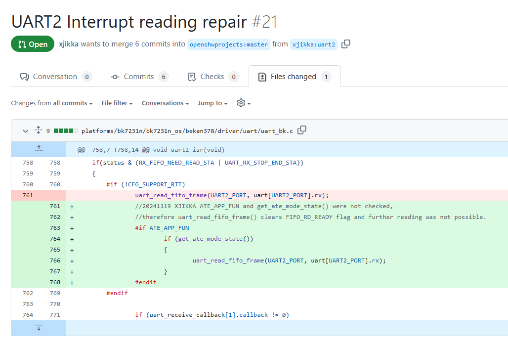

  • UART2 not used for BL0942 reading
    #18 21310895
    Posts: 14756
    Rate: 12881
    Screenshot showing a code change related to UART2 interrupt reading repair in an open-source project.
    Nice finding, what exactly is get_ate_mode_state()?
    I don't remember using UART2 for reading in any way on Beken. We're using UART1 for TuyaMCU, for BL0942 and for commandline, but not UART2. Still, you can just check the source code to be sure.
    But anyway, now that you've found the problem in the SDK, the workaround is no longer needed...
  • CFG_ENABLE_ATE_FEATURE disables the SDK test mode

    Rate: 39
    Well, I don't know for sure, probably something for testing.
    However, the main one is the test ATE_APP_FUN which is CFG_ENABLE_ATE_FEATURE
    And that is in platforms/bk7231n/bk7231n_os/beken378/app/config/sys_config.h set to 0
    #define CFG_ENABLE_ATE_FEATURE 0
    Same test is on UART1

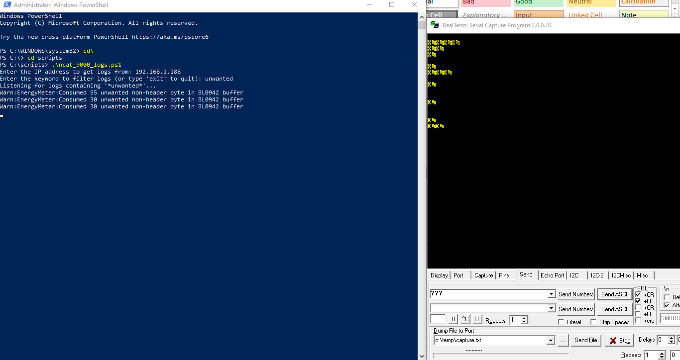

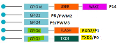

  • Flag 26 needed for BL0942 UART1 output
    #25 21315831
    Posts: 5213
    Help: 446
    Rate: 914
    so I have a WB3S in an ESP universal adaptor, which means GPIO0 and GPIO2 labels translate to TX2/RX2 on Beken.
    Diagram showing pin configuration with GPIO labels and function assignments.
    with https://github.com/openshwprojects/OpenBK7231T_App/pull/1436 build OpenBK7231T_App_1436_merge_0f77912a3305 and flag 26 set I'm afraid I'm not getting the expected output in the logs. Logs are set to full verbosity. Realterm at 4800bps and I'm sending some random stuff. Same with flag 26 unset.
    With flag 26 NOT set on UART1 I do get the BL0942 buffer return
    Screenshot showing PowerShell and RealTerm used for UART data analysis.
    maybe it's something I've not got right?
  • UART2 SDK patch needed for BK7231T testing
    OpenBK7231T_App_1436_merge_0f77912a3305 is what?
    Added after 7 [minutes]:
    The test on BKT must be done with the same changes on platform SDK BK7231T as is done for BKN here: https://github.com/openshwprojects/OpenBK7231N/pull/21
    This patch is not needed for testing this UART2 fix on SDK:
    https://github.com/openshwprojects/OpenBK7231T_App/pull/1436 is not necessary to use
    >>21315831
    I'll prepare BKT SDK PR for testing, just a moment - too much opened pending projects... :)
    Added after 9 [minutes]:
    XJ_ wrote:
    I'll prepare BKT SDK PR for test,
    Here BK7231T SDK with UART2 patch [untested]
    https://github.com/openshwprojects/OpenBK7231T/pull/20
    Added after 26 [minutes]:
    Just to clarify:
    The SDK uart2 patch solves reading from the UART2 port globally via an interrupt on Beken.
    - BK7231N - I tried that one (tested, working)
    - BK7231T - I don't have that one and this is that, what should be tested (using main release of OpenBK7231T_App)
    Then there's the OpenBK7231T_App ring buffer fix (which is not directly related to the SDK fix):

    Twin BL0942 mod - (beta) - for anyone who wants to check it out, here it is (I'm currently testing it in practice, it looks great so far.)
    There are "huge for some" changes in bl_share.c, but necessary. (All changes are designed to maintain backward compatibility.)
    https://github.com/xjikka/OpenBK7231T_App/tree/twinbl0942mod
    Note: This mod will not work on standard SDK, SDK mod uart2 is required https://github.com/openshwprojects/OpenBK7231N/pull/21
    UI output:
    Screenshot of the Twin BL0942 module user interface showing energy parameters.
    autoexec.bat:
    logtype none
    MovingAvgSet 20
    startDriver NTP
    ntp_timeZoneOfs  01:00
    BL0942opts 3
    startDriver BL0942
    ConsumptionThreshold 200
