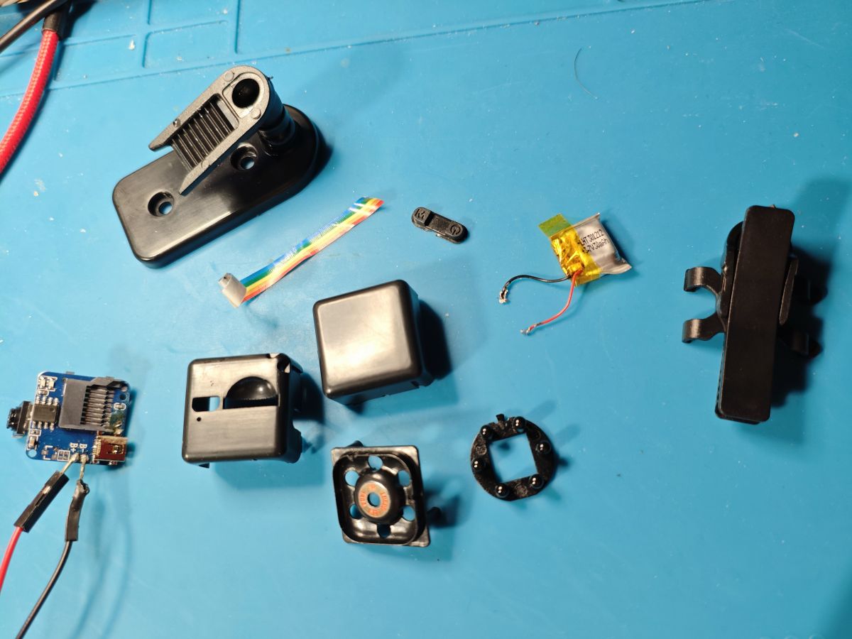

    A while ago I bought one of those cheap almost-certain-to-be-rubbish cube-like Instagram cameras off Ali Express. Almost certainly a clone of something better.
    Mini SQ11 camera with motion detection, night vision, and up to 100 minutes work time.
    The SQ11 Mini DV is sold alongside claims of "1080p", "HD", "night-vision". "infra-red". These were taken with a large pinch of salt.
    I took it apart quite a few months ago, so didn't document that, but there are many videos and pictures elsewhere online of how to open it. My most recent interest is because I was looking around for devices I already had with an 8 pin SOIC flash memory chip on which I could try my new CH341A "black" SPI programmer and clamp.

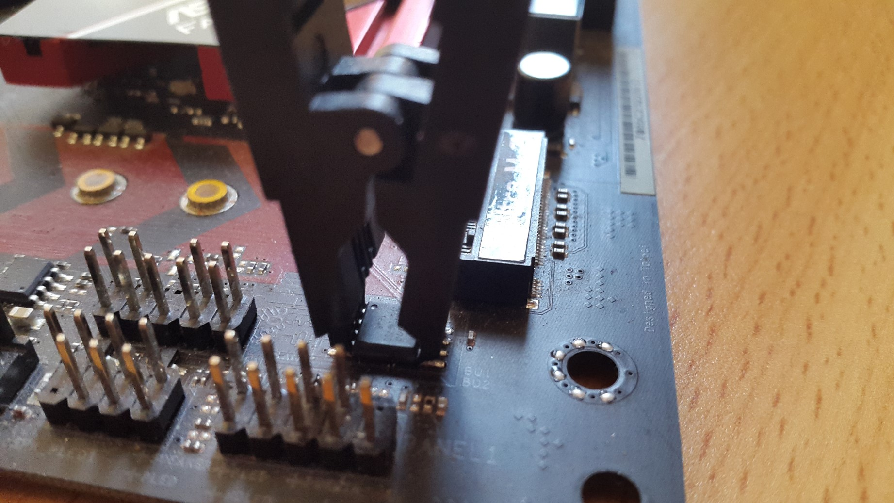

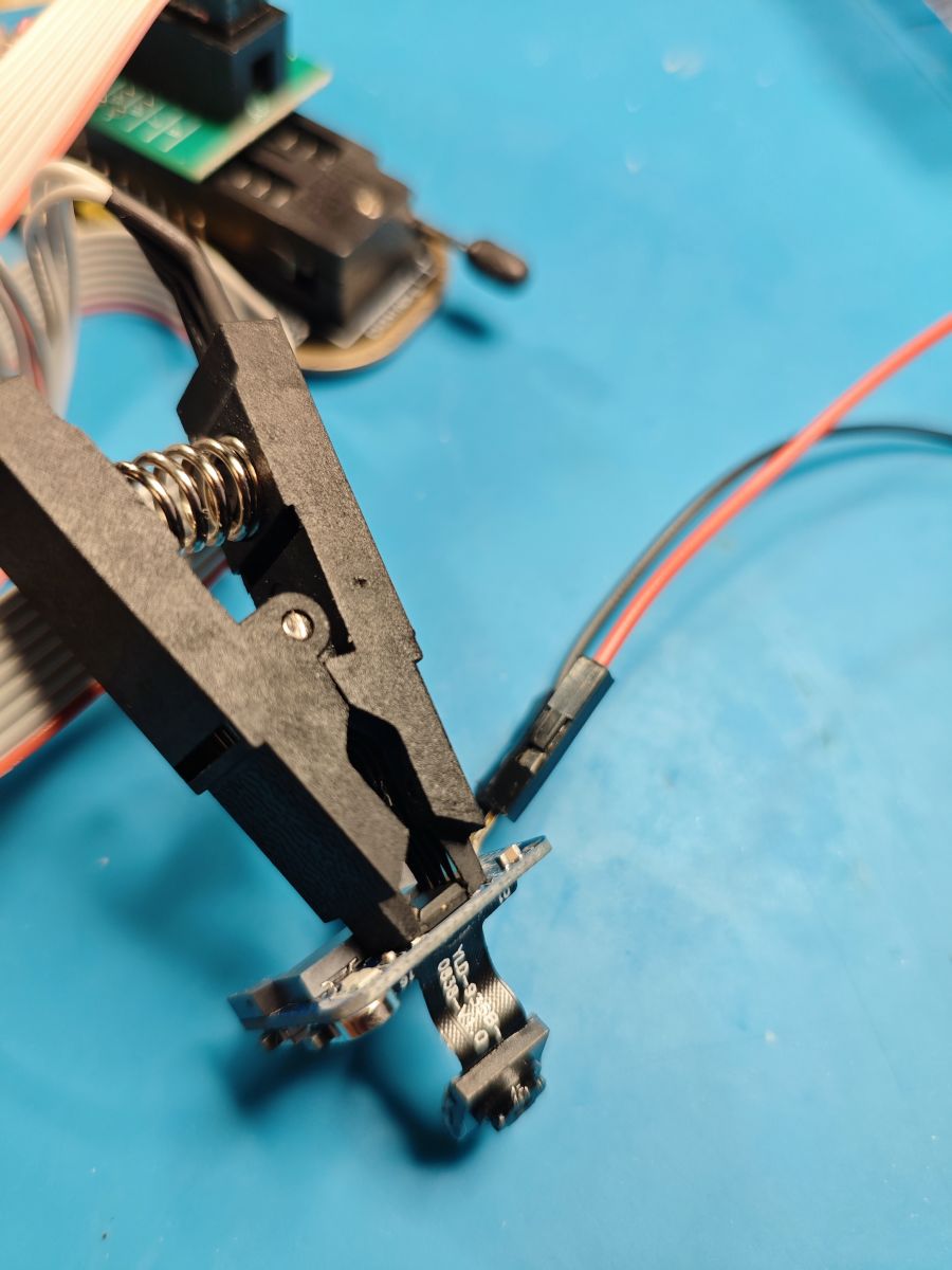

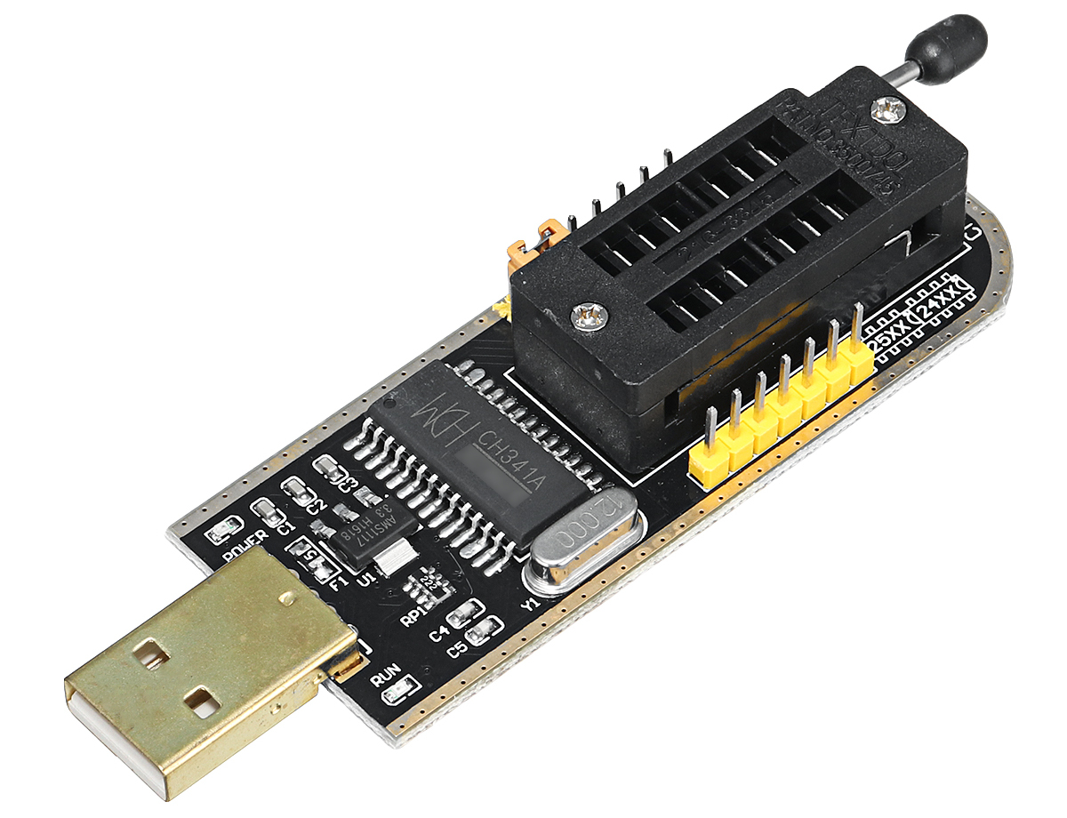

    CH341A SPI programmer with 8-pin microcontroller clamp
    Mine came with a clamp for use on 8-pin chips left in-situ. Eg (from https://winraid.level1techs.com/t/guide-how-t...-spi-programmer-flasher-with-pictures/33041):
    Device with a clip connected to a chip on a circuit board.

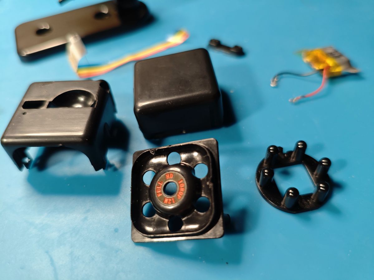

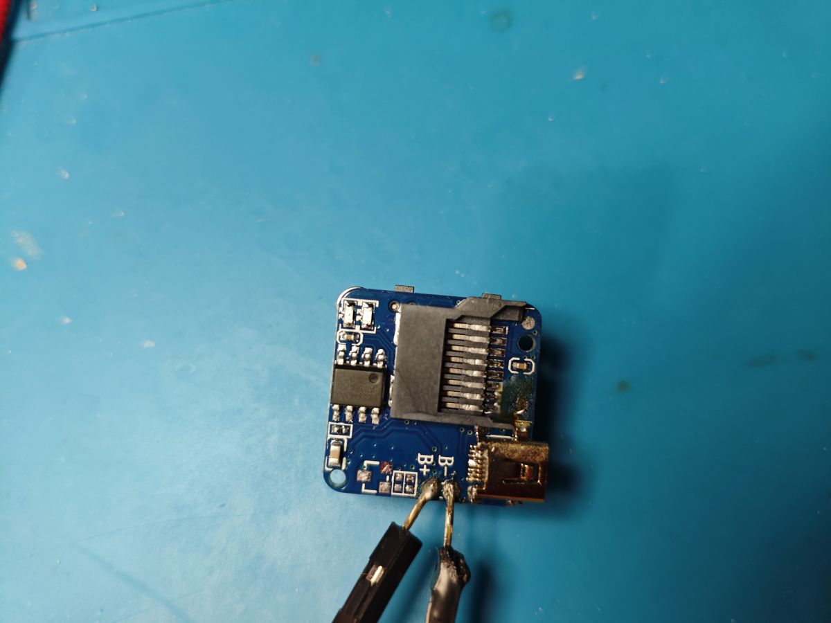

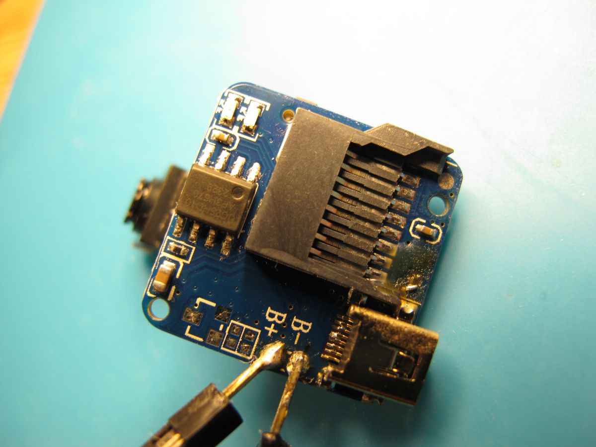

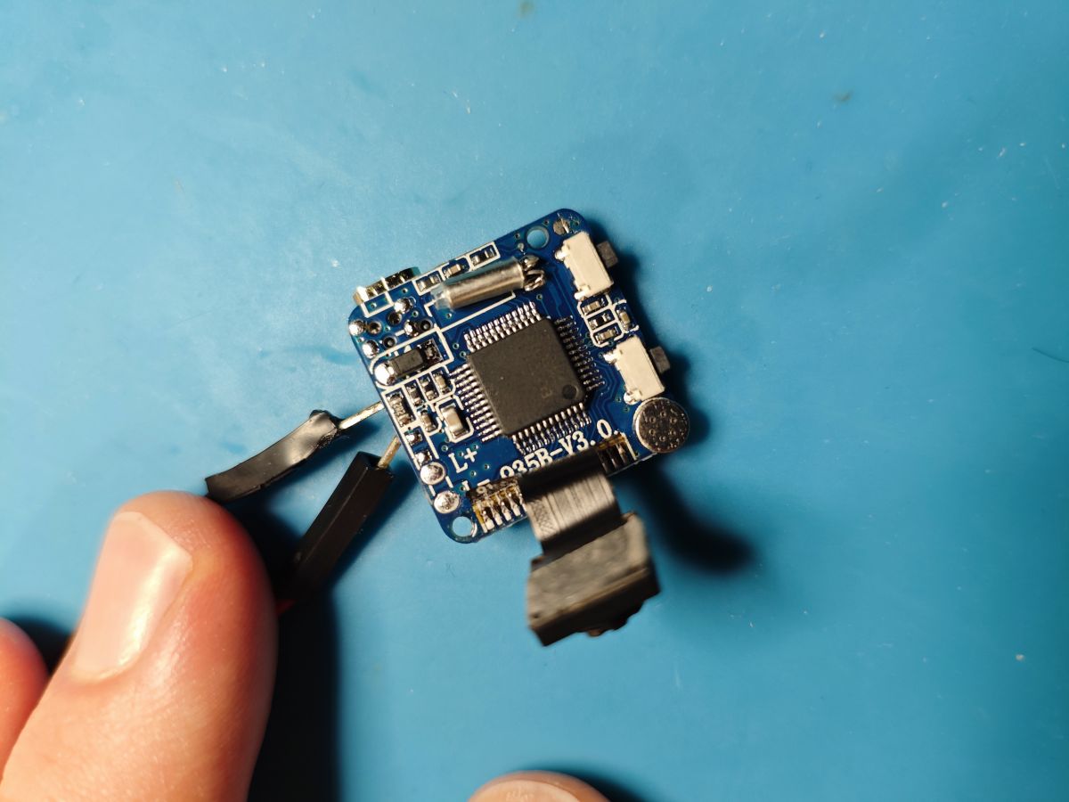

    Before I continue here are some pictures of the dismantled chassis and the PCB inside. Predictably there are no LED lamps, just black plastic that vaguely resembles a ring of LEDs.
    Disassembled parts of the SQ11 Mini DV camera on a blue background. Disassembled SQ11 Mini DV camera on a blue background Operating manual for SQ11 Full HD 1080P mini camera. Dismantled SQ11 Mini DV camera with wires connected to the electronic circuit. PCB with a microchip labeled 935B-V3.0 held between fingers. Close-up of a circuit board from a disassembled device with visible flash memory chip and microSD slot. Dismantled circuit board of the SQ11 Mini DV camera with connected power wires. Dismantled mini camera with visible circuit board and components. Circuit board of disassembled camera with visible chip and battery Damaged battery with two wires on a blue background Close-up of a circuit board with a microSD slot and flash memory chip. Image of a circuit board from an SQ11 Mini DV camera with a visible microSD slot. Circuit board of SQ11 Mini DV camera showing the MCU and microSD slot.

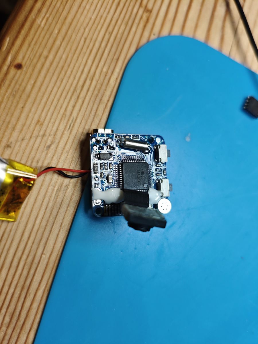

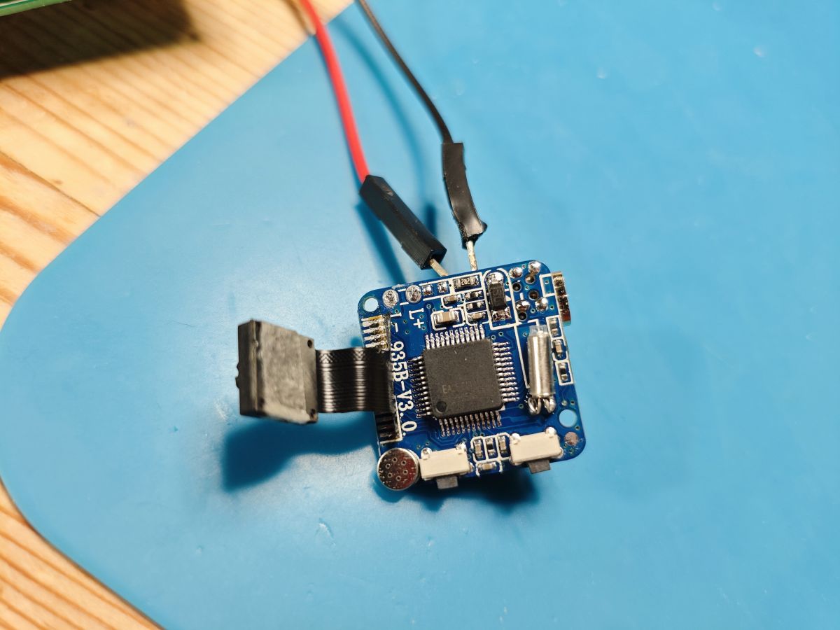

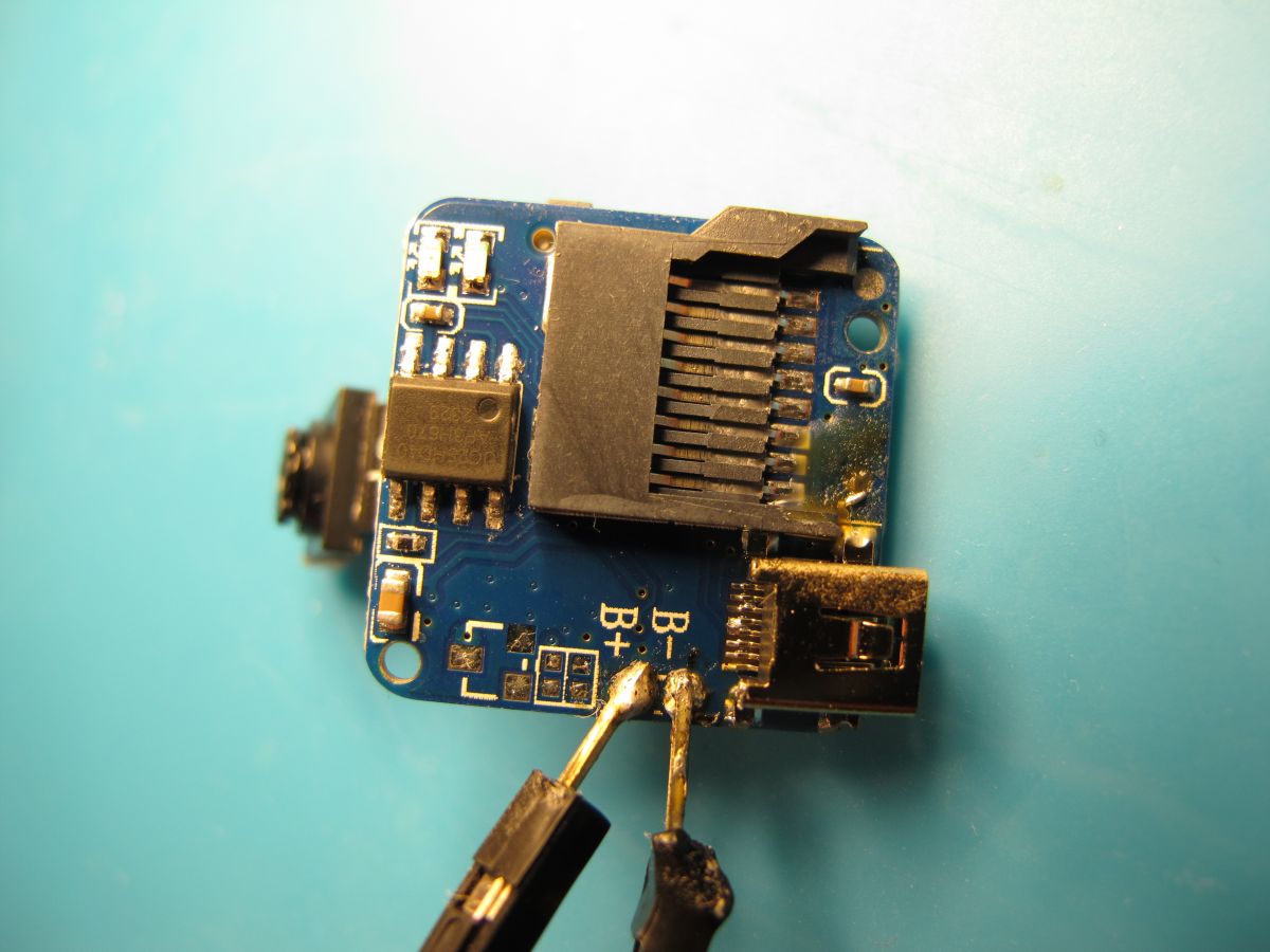

    You can see the 8-pin flash memory chip - a UC25WQ40 - just at the base of the microSD connector.

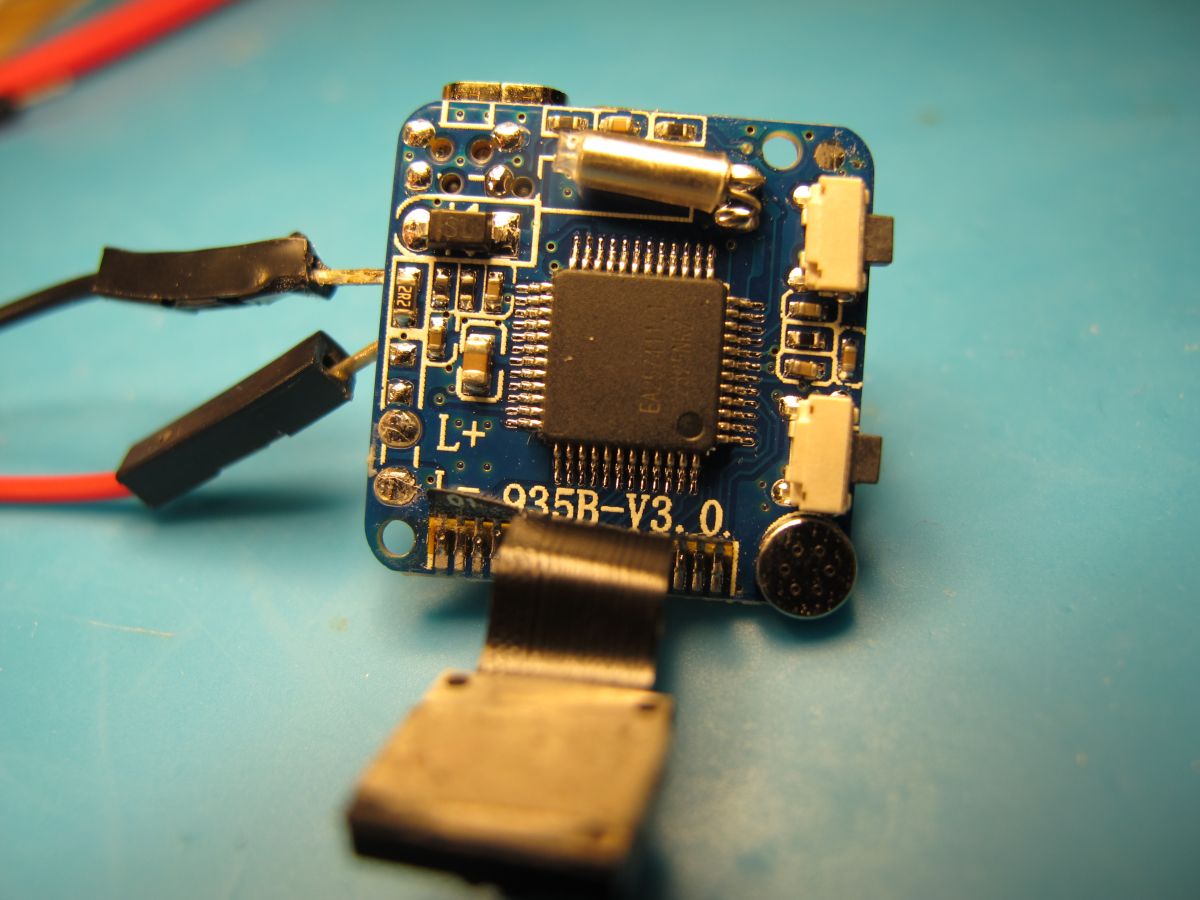

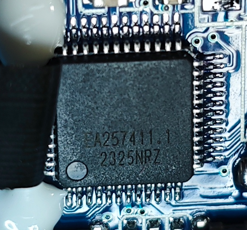

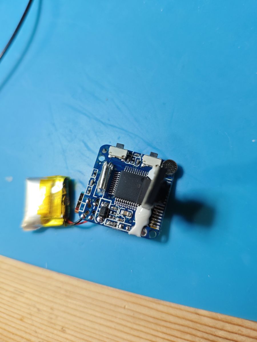

    The QFN48 MCU is a bit of mystery. At a good angle you can make out that it's labelled EA257411.1 2325NRZ.
    Close-up of a microprocessor labeled EA257411.1 2325NRZ on a circuit board of a camera.
    A Google for that and the PCB silkscreen 935B-V3.0 has not proven fruitful.

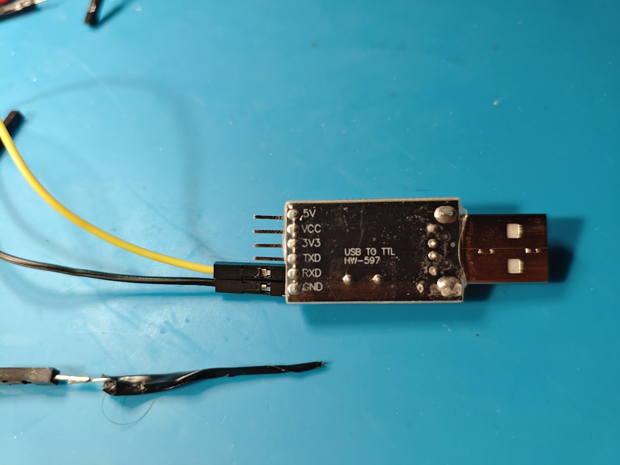

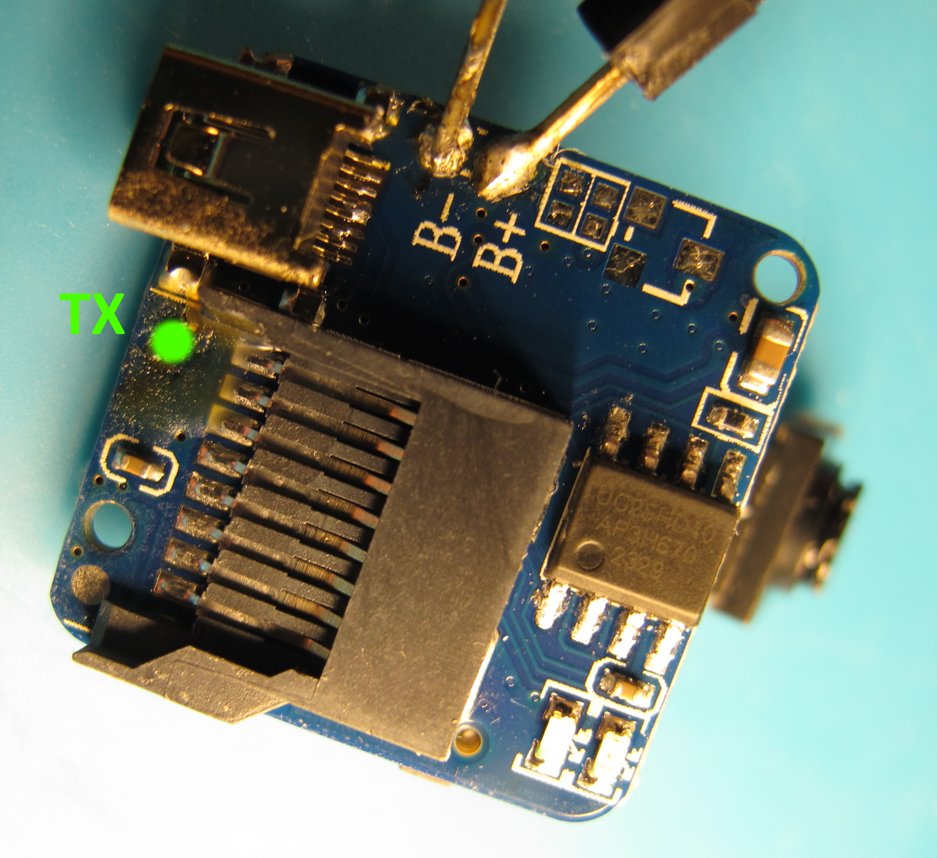

    But surely one or two of the MCU legs must be a UART log out? Maybe even one of the silver pads on the PCB? I cautiously probed around with the RX leg of a USB-TTL adaptor connected to a jumper cable with a sewing needle soldered at one end, powering the camera off and on again from an external 3.3v PSU after desoldering the useless battery. USB-TTL and the external PSU sharing a ground.
    USB to TTL converter with attached cables on a blue background.

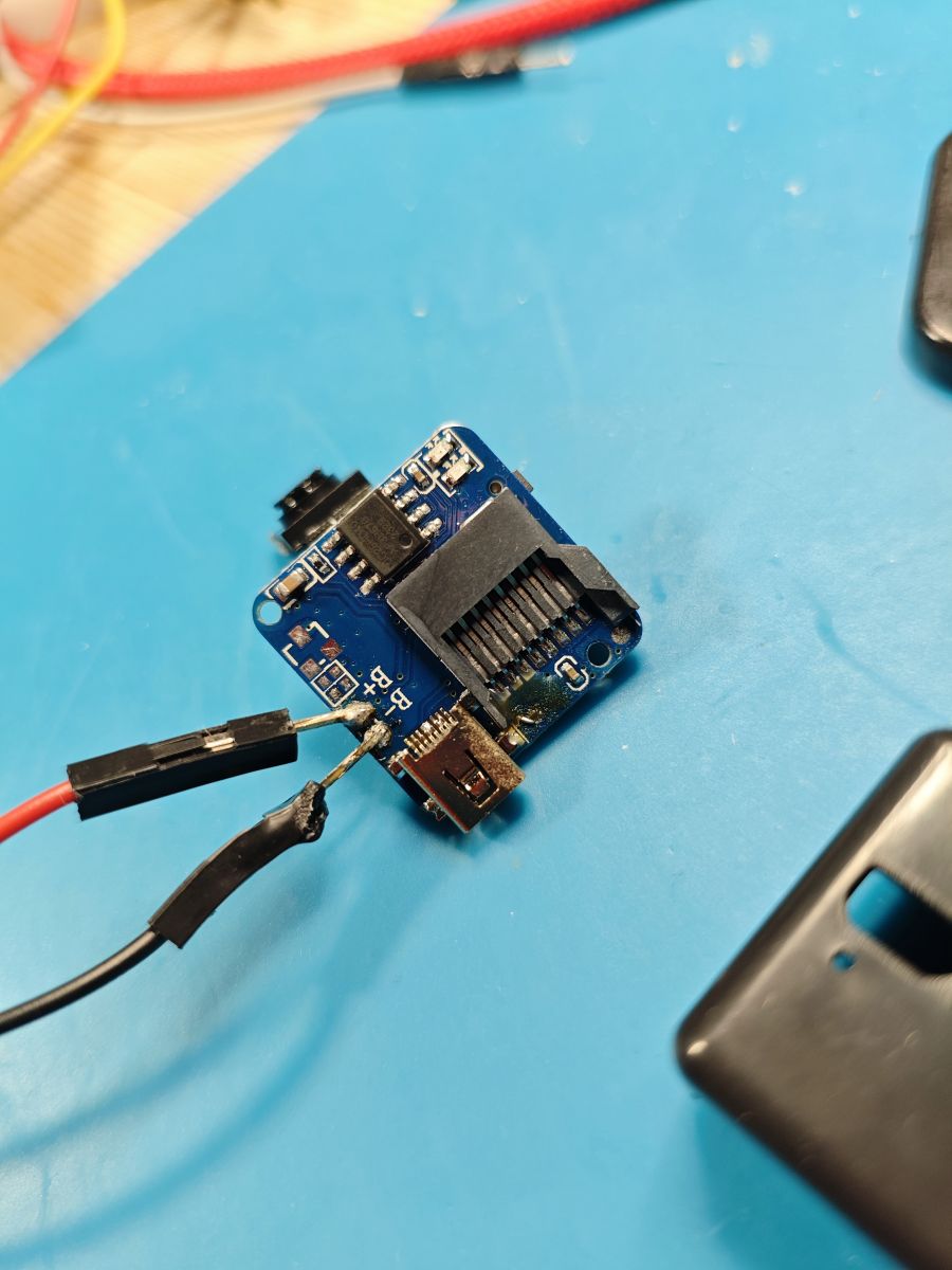

    at 115200 baud this pad here gives an output
    View of the disassembled circuit board with a microchip and marked TX point.
    but not a very helpful one

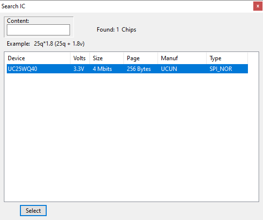

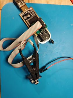

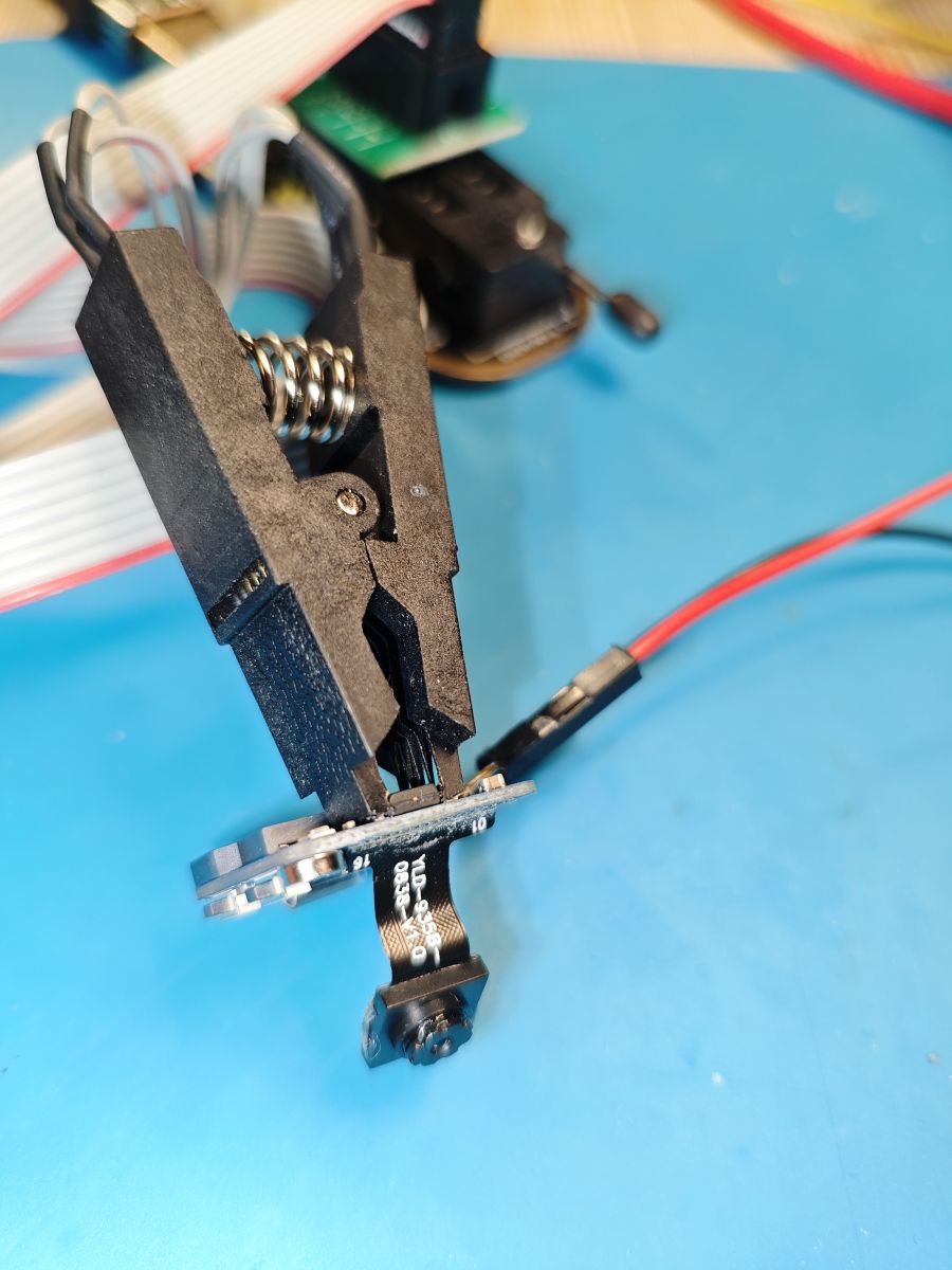

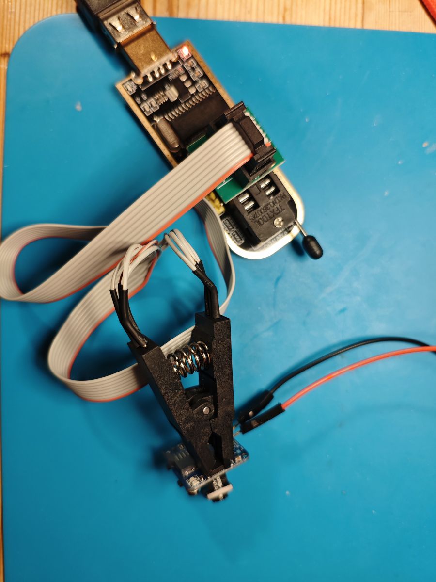

    Time to try the CH341A. After carefully lining up pin 1 of the SOIC with the red pin1 of the clamp
    Close-up of disassembled mini DV camera with a clip connected to a microchip. Close-up of a circuit board with a chip reading clip attached. View of an SPI programming set with a connected clip and micro camera.

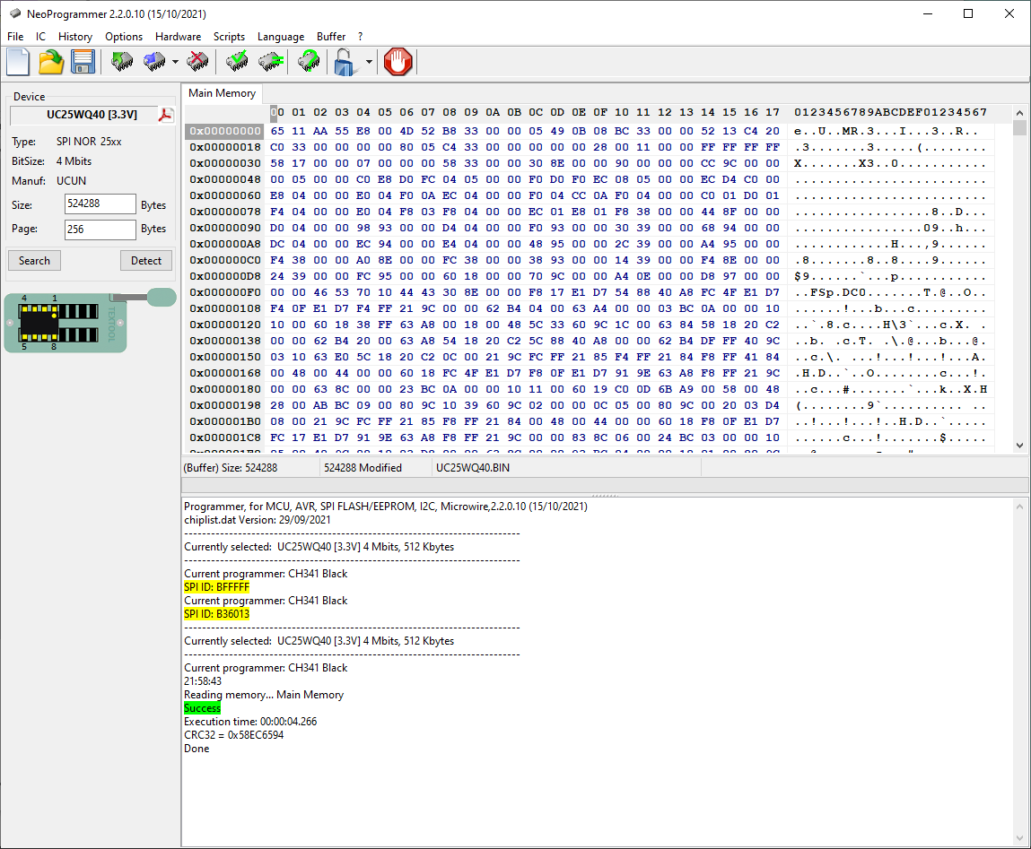

    NeoProgrammer detects the IC - UC25WQ40 [3.3V] 4 Mbits, 512 Kbytes
    NeoProgrammer window detecting UC25WQ40 chip.
    NP read the entire chip and I attach the dump to this thread for reference.
    Screenshot of NeoProgrammer software showing memory data from UC25WQ40 microchip.
    It doesn't seem like there's an awful lot of code in there. Does the MCU also have onboard flash?
    Strings found are minimal

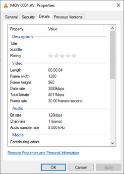

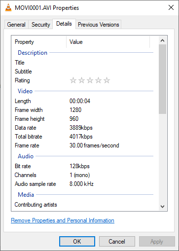

    meh. not much more to say about this little thing. It does not respond to AT commands. The most I can get out of it is some SD card kind of messages when hitting buttons.
    video and audio quality is low.

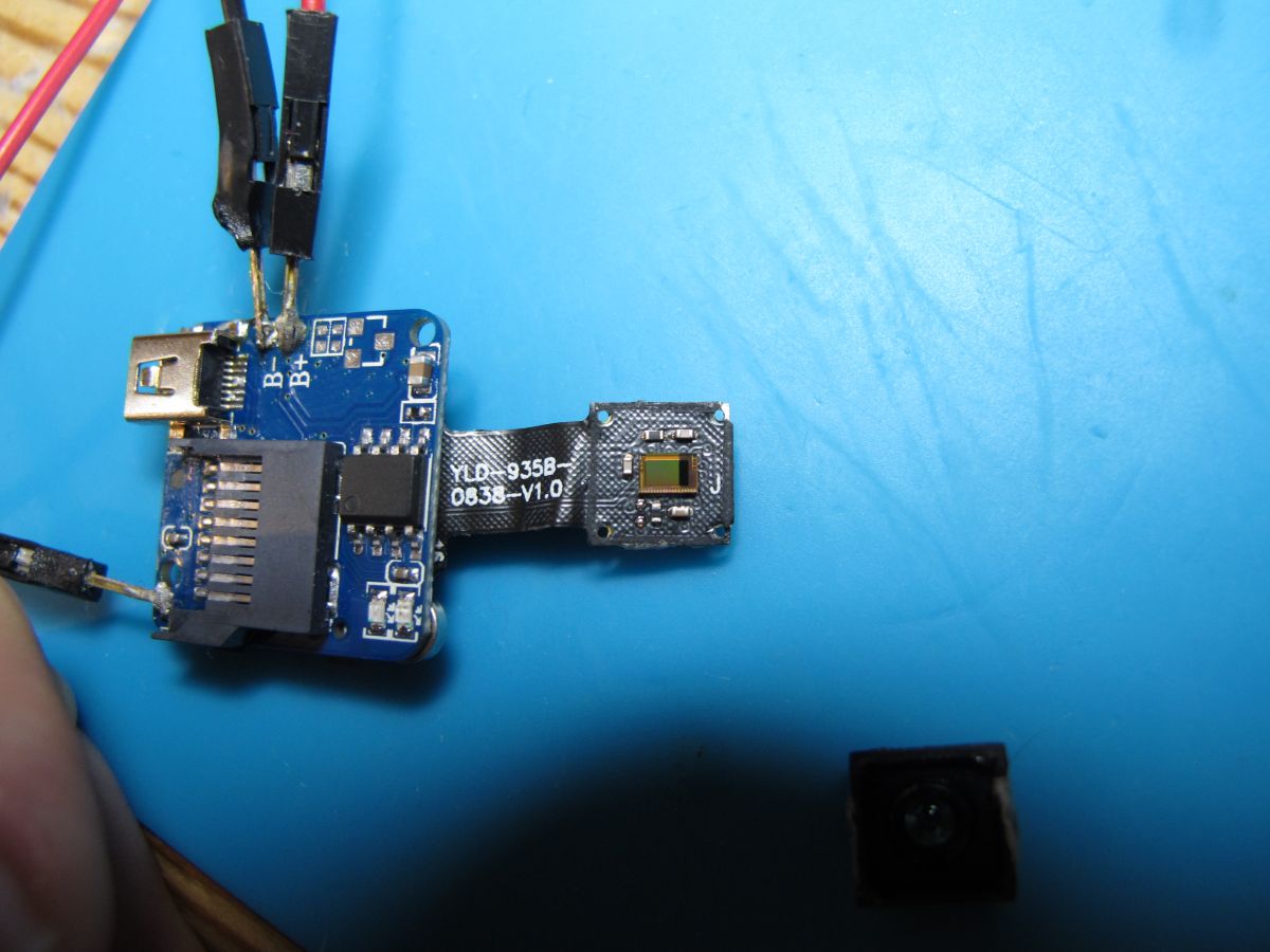

    Added after 11 [minutes]:
    tore off the lens hoping for a make/model. no

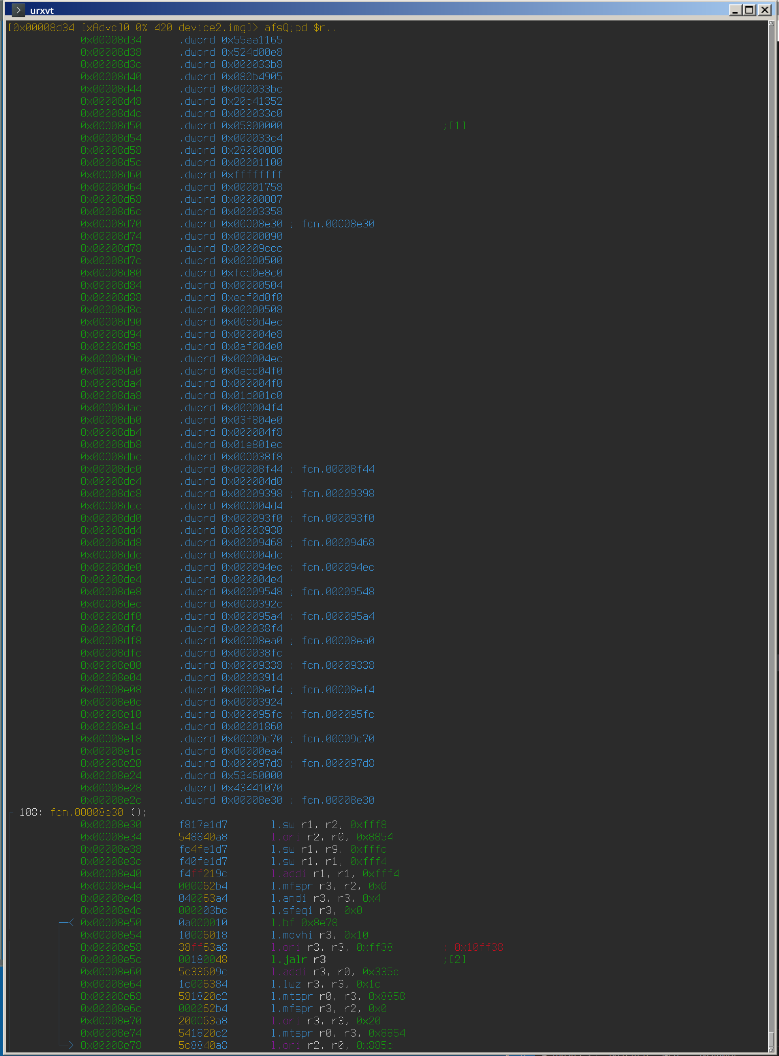

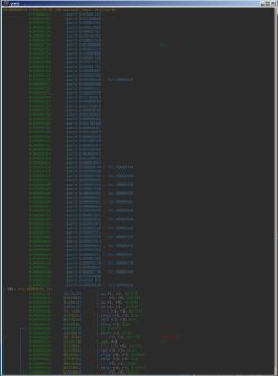

  • Load address and ROM map identified for SQ11 dump
    #15 21852089
    bewilderbeest
    I figured out the load address and where the printstring routine is (0x00100d8c), so assuming there isn't some kind of checksum to prevent tampering, then reprogramming it to dump the card (a big assumption), then dumping the internal ROM should be easy-ish. From the addresses, I think the first 64 kB is RAM, and the internal ROM is from 0x100000 up. It'd be nice if Ghidra supported this, but it doesn't, so I'm trying to use radare2. I've already found one OpenRISC bug...
    Screenshot of an urxvt terminal showing memory addresses and assembly instructions
    Next step for me is to figure out how to reprogram the flash without desoldering it. My existing ROM burner refuses to, claiming problems with overbudget protection. It's interesting that a CH341-based ROM burner works fine; will need to investigate.

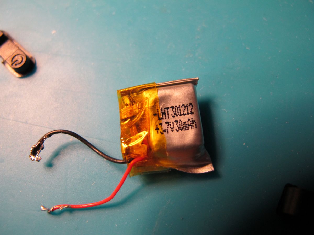

    I have also gotten 3 of those SQ11 clone cameras. I have found out that the lithium battery protection circuit is nonexistent; it is just a diode, so the lithium battery gets destroyed after the first charge to > 4.5 V. The empty space on the PCB is probably for a 4.2 V regulator. At around < 3.4 V, the camera stops recording. Interesting to see the new information about the CPU.
  • #22 21863322
    bewilderbeest
    >>21863286 The battery on mine is now living in its new home at the bottom of a jar of salty water, but from the pictures it does seem to have its own on-board battery protection circuit. I'll need to dissect it to find out if it's real.
