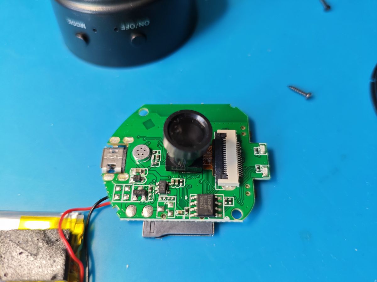

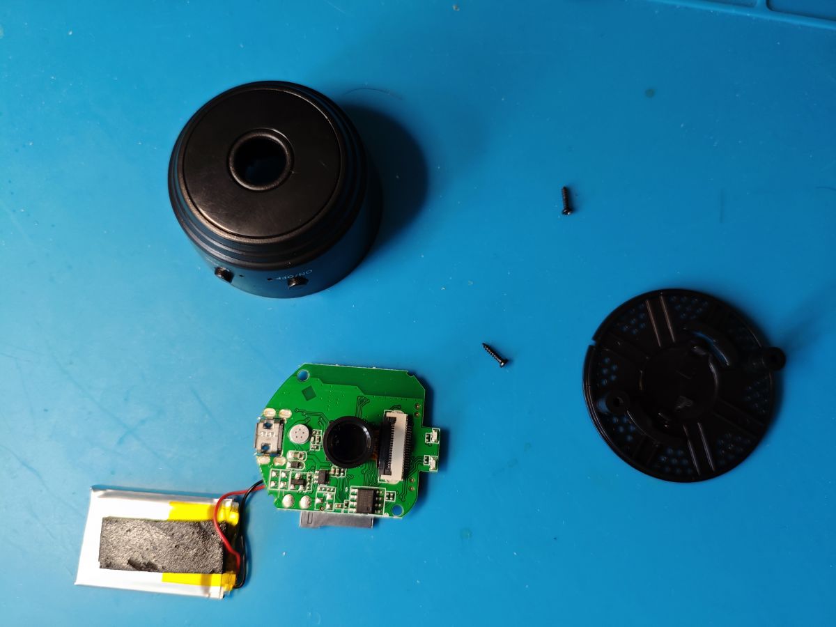

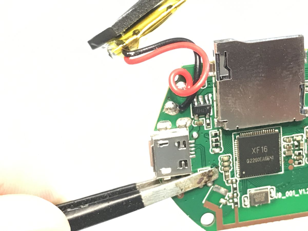

    Another A9 minicam variation. Will just use this post to dump some bits rather than add to https://www.elektroda.com/rtvforum/topic4033757.html#21035231 which has been about the Beken BK7252 and Taixin TXW817 based A9s.
    The MCU in this labelled as XF16 PB380EA6341 which has a mention in that long HA thread about the A9s here https://community.home-assistant.io/t/popular...mini-wi-fi-camera-the-ha-challenge/230108/247
    Close-up of a microchip on a PCB.
    this one has an 8mbit flash chip though, labelled T25S80
    Close-up of a circuit board with a clearly visible T25S80 chip.
    which might be this from ChipSourceTek http://www.chipsourcetek.com/DataSheet/T25S80.pdf

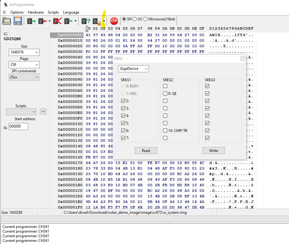

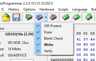

    Flashrom, NeoProgrammer and ASProgrammer couldn't identify the SPI ID C74014. It did detect as "1313", probably the cable wasn't seated quite right, which detected as n 8mbit ST M25P80. Right or wrong, Neo dumped the firmware. Flashrom did too. both attached.
    Screenshot of NeoProgrammer software showing the memory read of M25P80 flash.

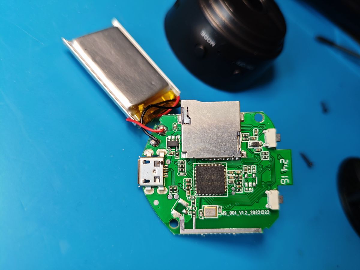

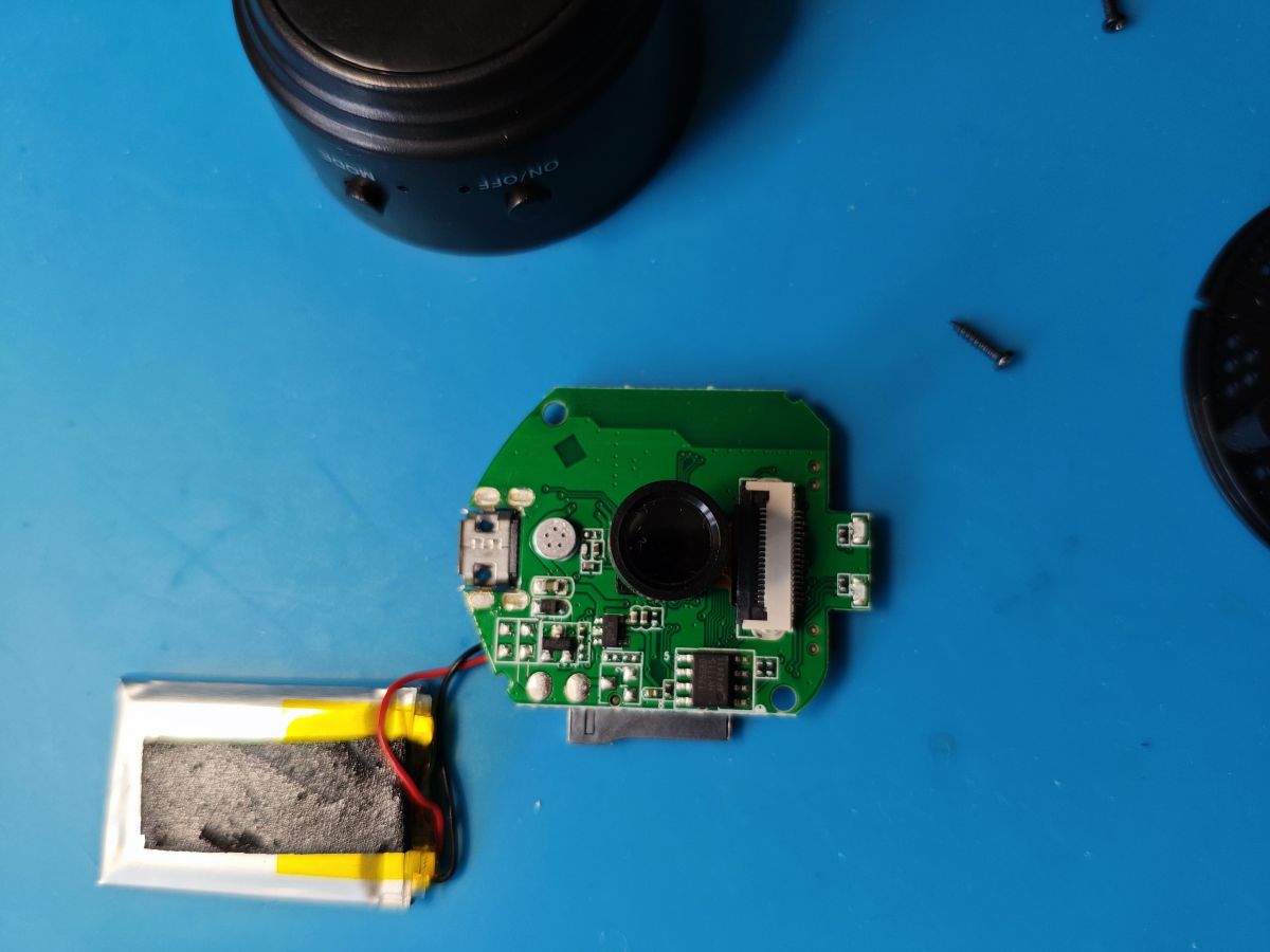

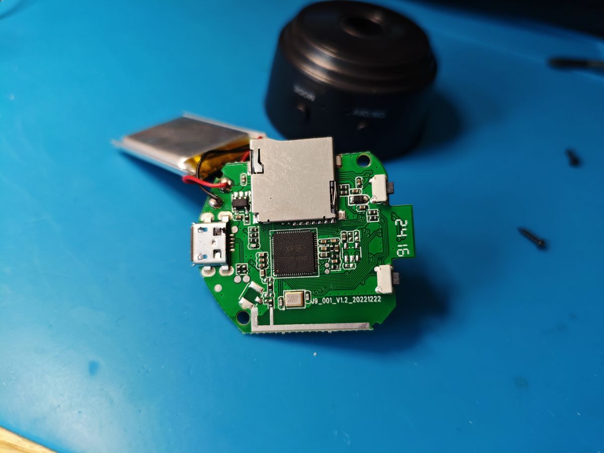

    pics of PCB
    Apparent PCB of A9 mini camera with a connected battery and USB port. Close-up view of the A9 camera's printed circuit board (PCB) with visible electronic components and a battery. PCB of A9 mini camera with visible lens and battery. PCB of A9 mini camera with various electronic components. Disassembled A9 mini camera with visible PCB and battery. Close-up of the A9 camera PCB with visible components and connected battery.

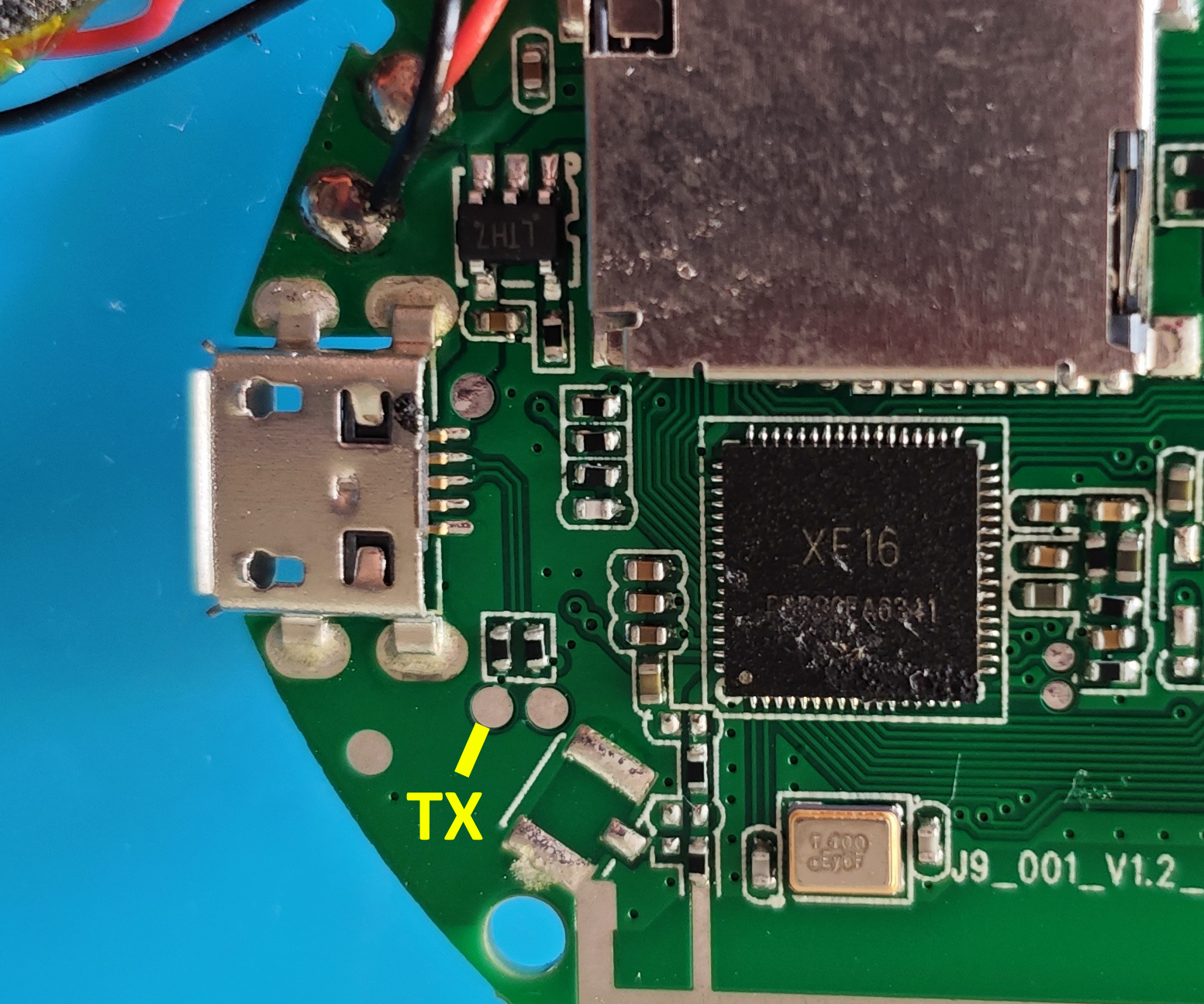

    It didn't take long to find the UART TX pad, which is this:
    Close-up of a PCB with an XF16 microprocessor.

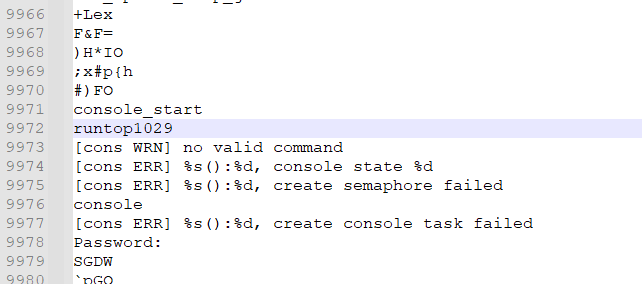

    Perhaps most interesting so far is the content of the log:

    Code snippet with console error messages and a password field.
    feel free to post all your findings!

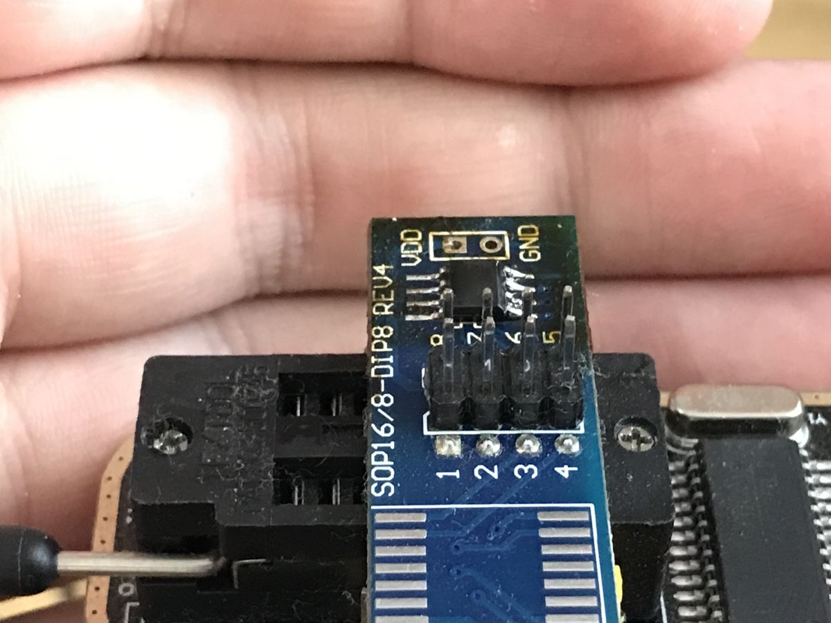

    As it's only an 8 pin SOIC my next step would have been to desolder and then clamp up to read flash.

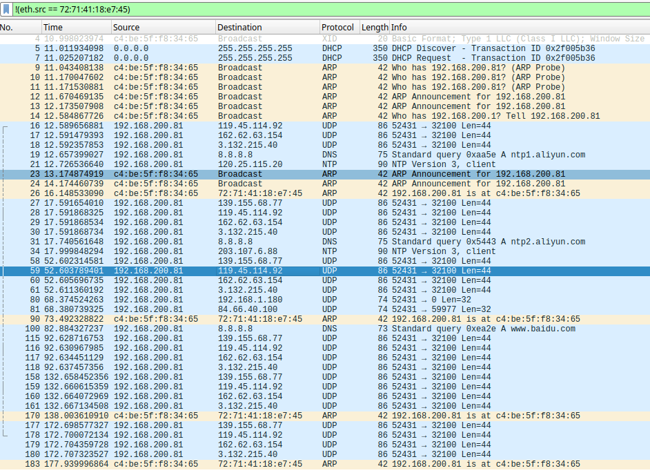

    My PTZ camera, just like the A9, uses the iLnkP2P protocol, which has been pretty well documented.
    If you watch the Defcon video, he explains how to extract the video stream from the packets:. https://hacked.camera/
    The original A9 Home Assistant postings explain & link to methods to communicate UDP packets to the camera: https://github.com/DavidVentura/cam-reverse
    I think the Defcon talk shows an example of a CGI request too. You can see which CGI scripts are on the cam by searching for ".cgi" files in the Strings output. The manual for these CGI are here: https://github.com/DavidVentura/cam-reverse/blob/master/data/cgi_ip_cam.pdf

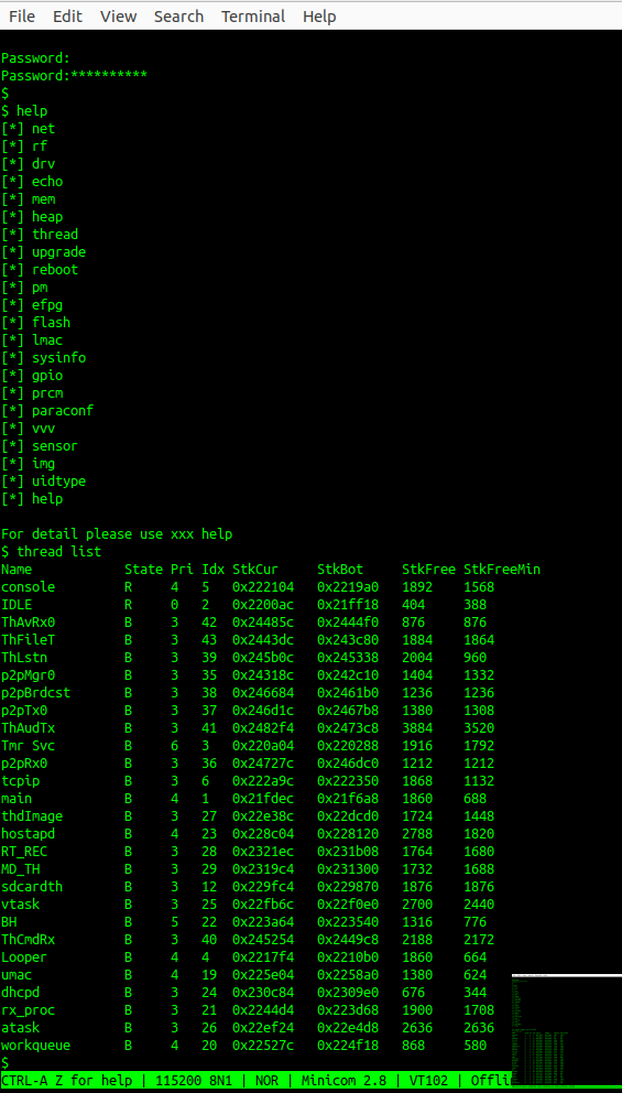

    I attached a screenshot of the serial console menu from my PTZ. The command line help isn't very helpful, so I've had to read the source code for these commands to learn their syntax. Most of the commands' source is in the xradioSDK projects/common/cmd directory
    I think if you wanted to get total control over this cam, you would have to write a script to communicate UDP packets in iLnkP2P protocol, and interact with the CGI scripts. If you get access to serial console, there are commands to edit the memory. You could change the IP address of the Chinese P2P relay servers, or change the device UID so it doesn't authenticate with the servers.
    Temu is flooded with these cams, that's where I got mine for $10. I thought it would make a good device for a hardware hacking class. I was hoping it was running embedded linux. Some of the linux versions have the iLnkP2P libraries in the filesystem, and you can RE the library to get the device ID algorithm, as explained in the Defcon talk
    Screenshot showing a serial console menu with a list of commands and threads.

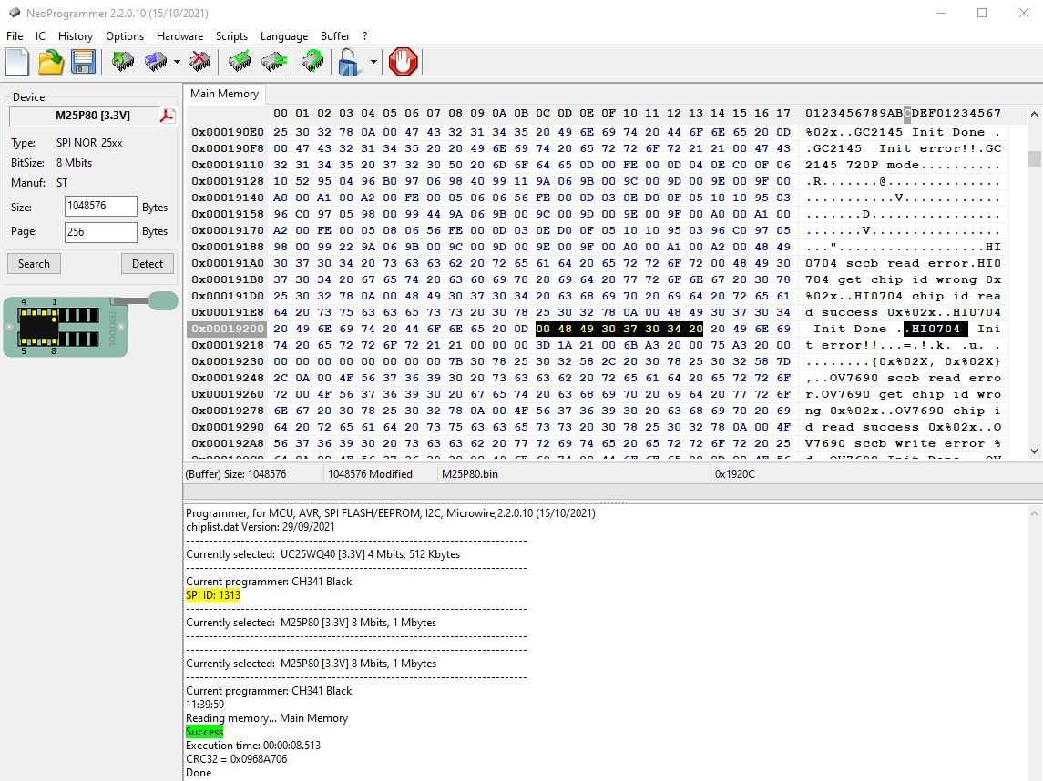

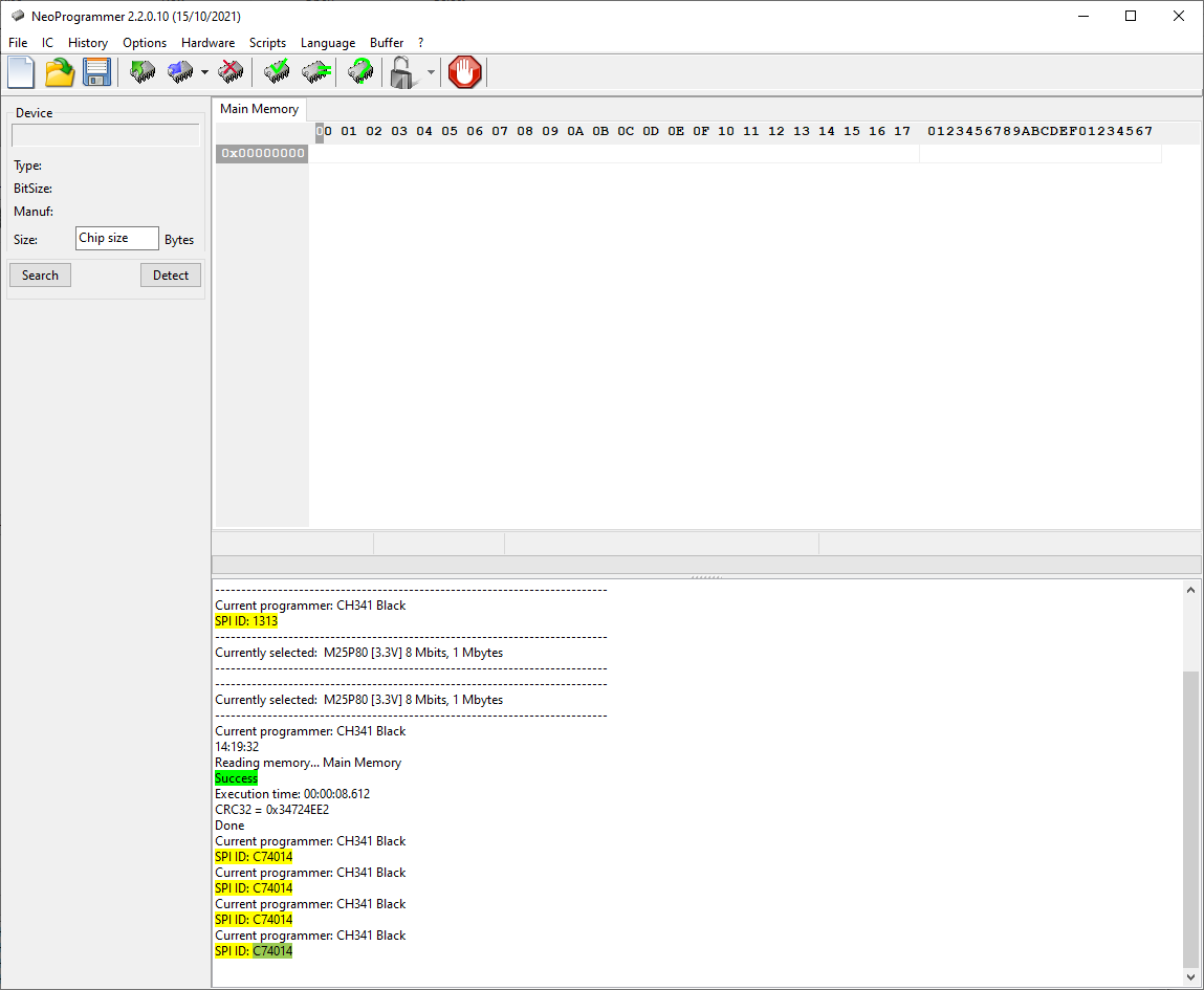

    In-circuit SPI flash reads return inconsistent IDs

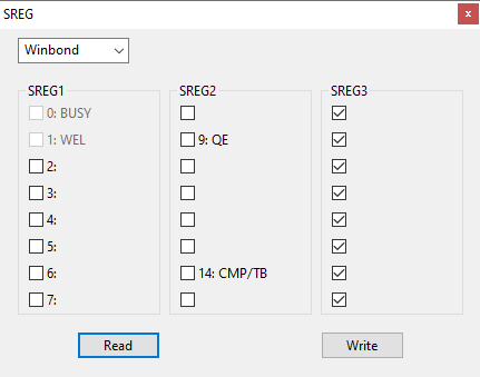

    #19 21522142
    Posts: 14763
    Rate: 12894

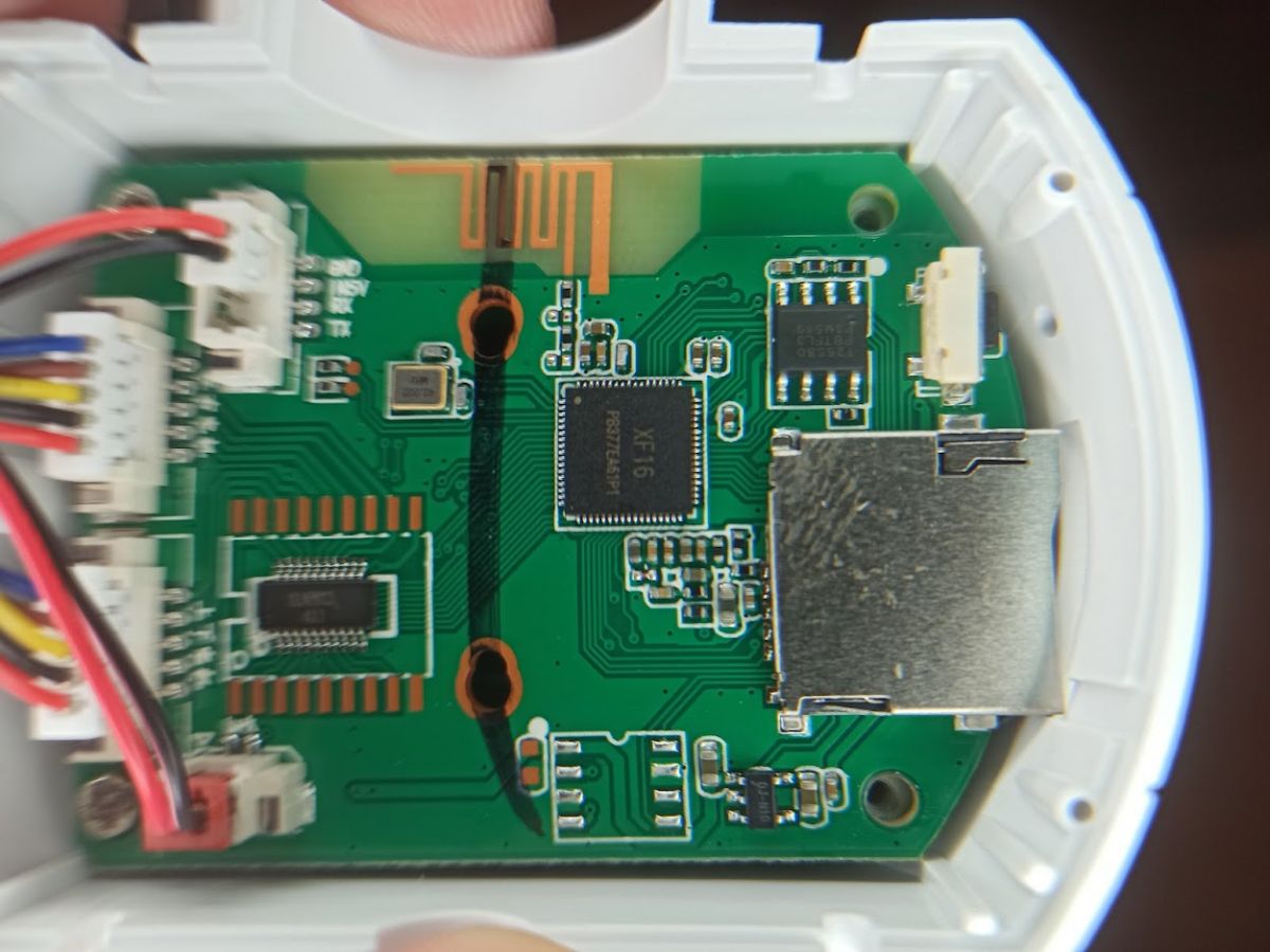

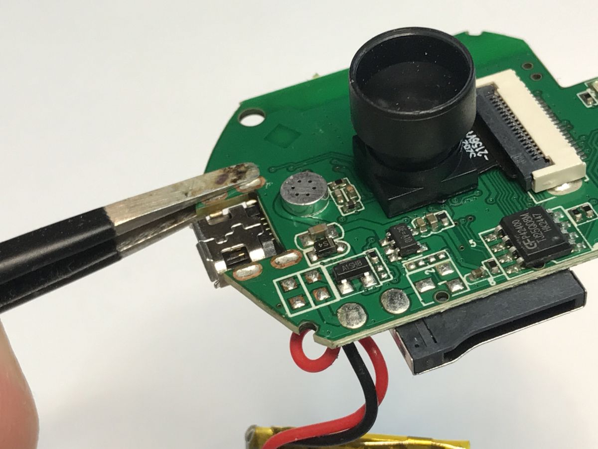

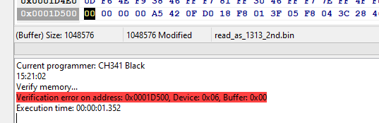

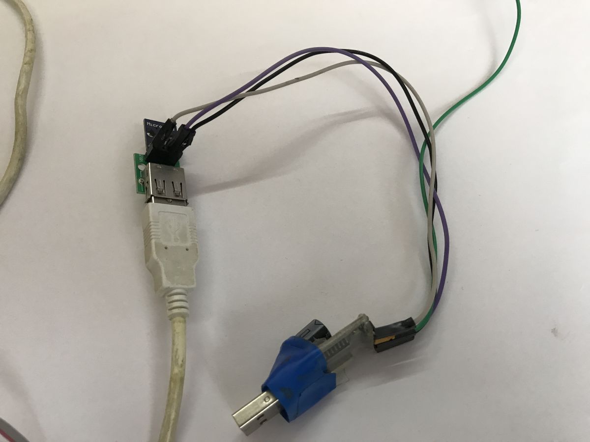

    I got one:
    Close-up of a circuit board with a micro USB port, memory card slot, and XF16 chip.
    Close-up of a circuit board with a camera lens, an electronic microphone, and tweezers holding a micro USB port.

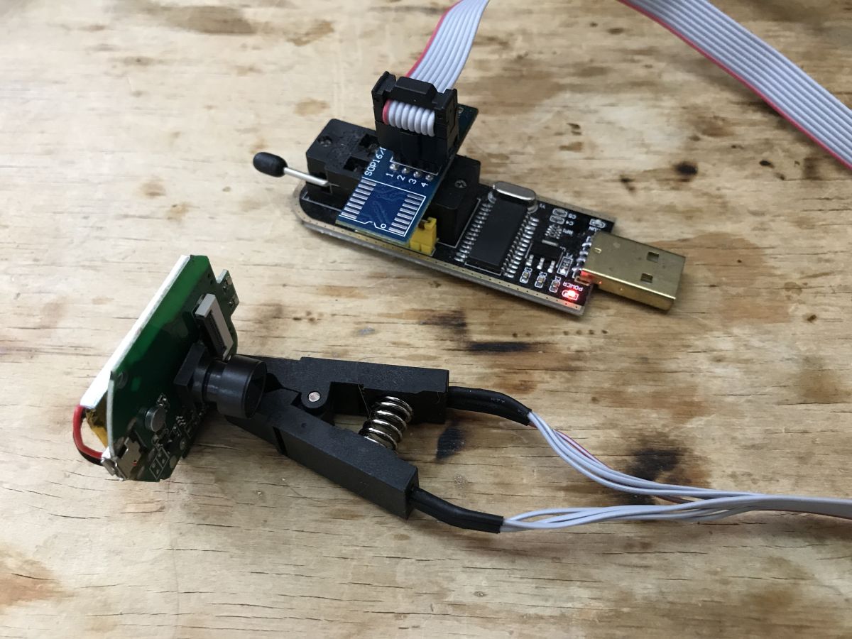

    USB programmer with a clip for chip programming connected to a small PCB.
    Trying to read flash in circuit gives me strange IDs:
    Current programmer: CH341 Black
    SPI ID: 8E8029
    SPI ID: 1313
    but later:
    SPI ID: C74014
    SPI ID: C74014
    SPI ID: C74014
    SPI ID: C74014
    SPI ID: C74014

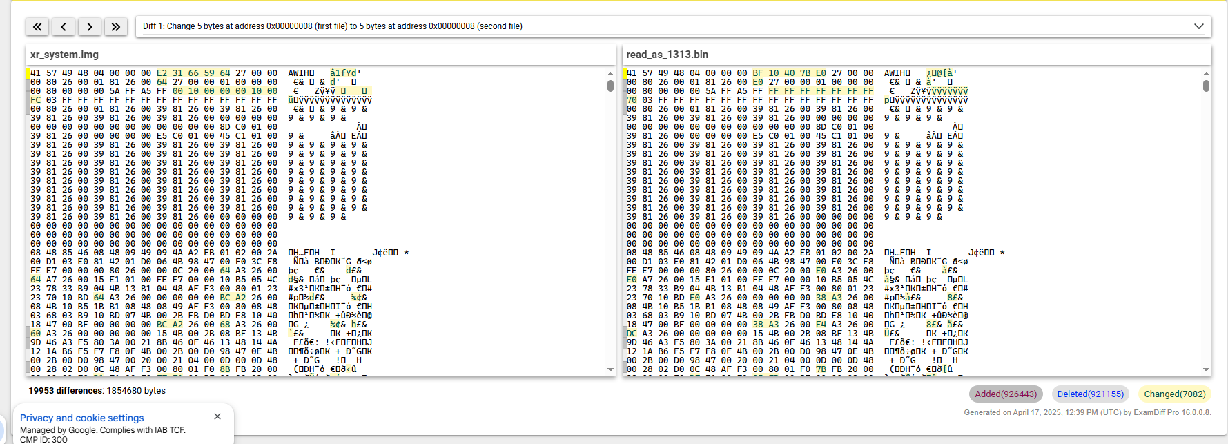

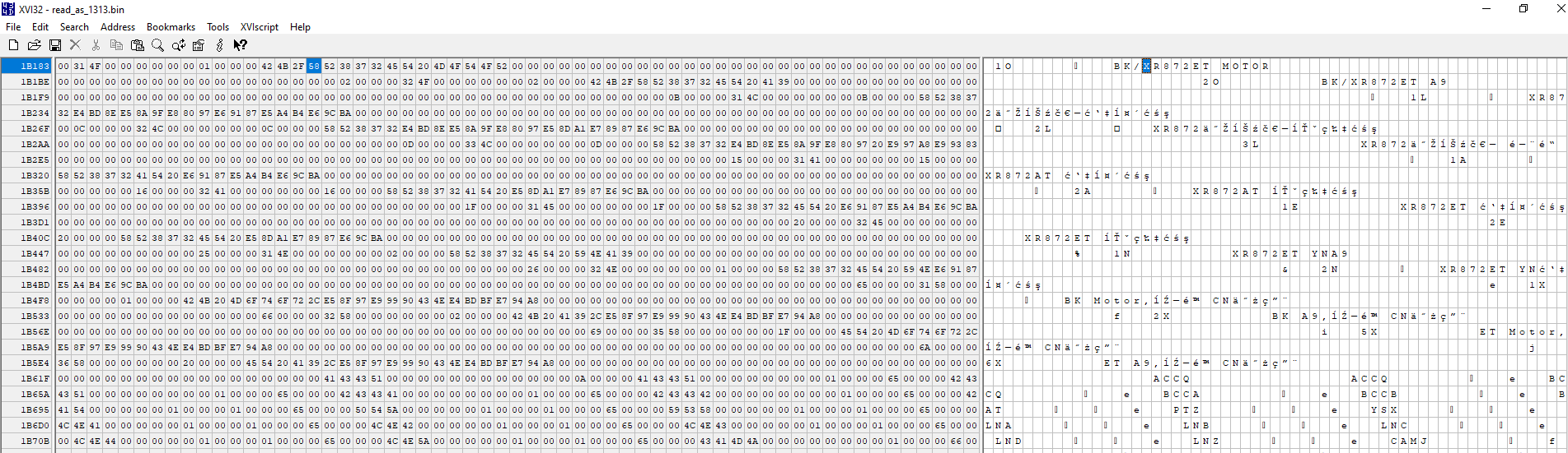

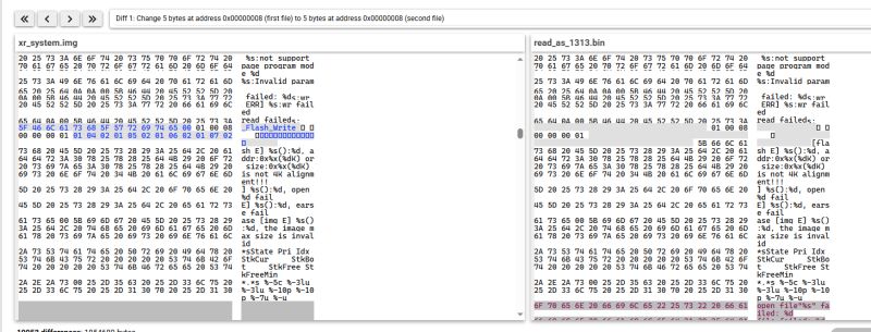

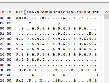

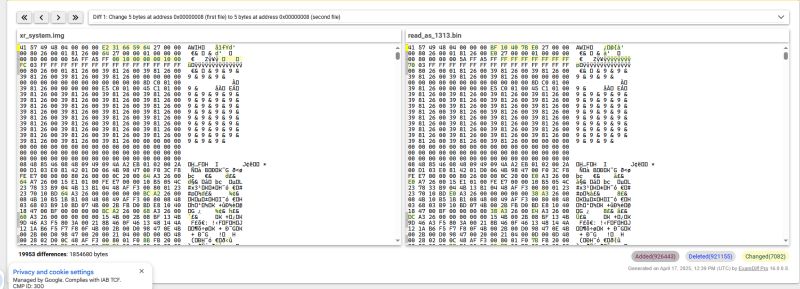

    AWIH header like in other XR devices
    Hex editor view with binary data and ASCII representation.
    • read_as_1313.bin (1 MB) You must be logged in to download this attachment.

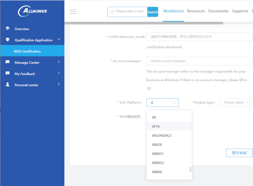

    The only official reference to XF16 I've seen in relation to Allwinner is an entry in a drop-down or two in their developer portal
    User dashboard on Allwinner website with open SoC platform selection dropdown.

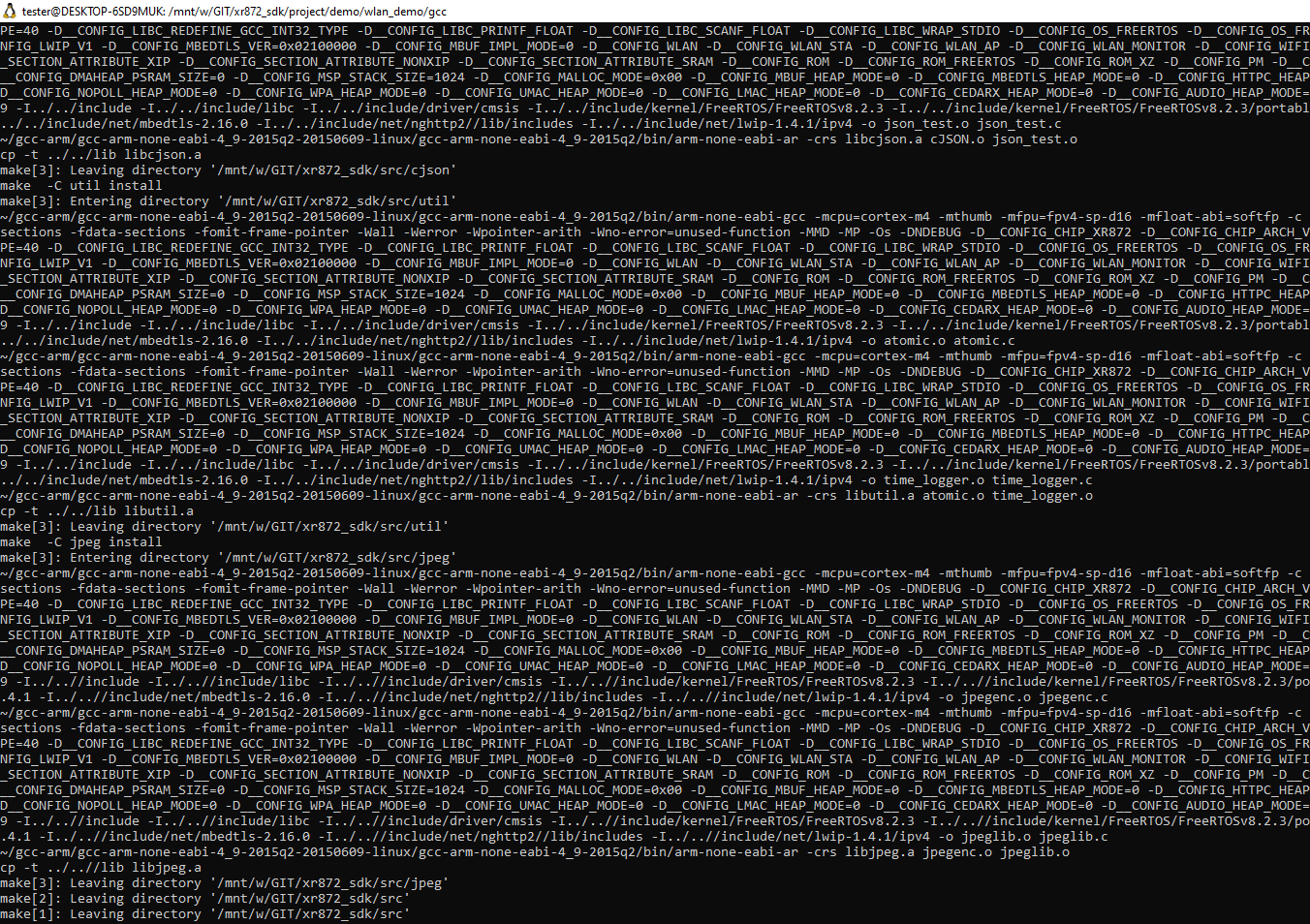

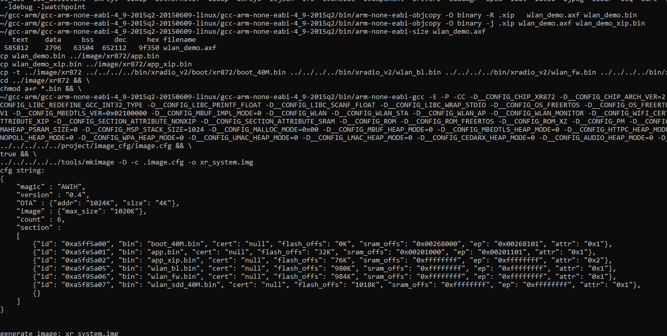

    WSL build notes for xr872_sdk hello world
    #21 21522159
    Posts: 14763
    Rate: 12894
    divadiow wrote:
    cloned here for safe keeping https://github.com/divadiow/xr872_sdk
    So has anyone tried to build a hello world image of that? Maybe then we could find the flash offset in that 1MB chip where we could flash this hello world...
    Added after 1 [hours] 37 [minutes]:
    Compiling under WSL experience so far:
    1. I got SDK from here:
    https://launchpad.net/gcc-arm-embedded/4.9/4.9-2015-q2-update
    2. At first, it acted like path is wrong
    tester@DESKTOP-6SD9MUK:/mnt/w/GIT/xr872_sdk/project/demo/hello_demo/gcc$ make lib
    make  -C ../../../../src install
    make[1]: Entering directory '/mnt/w/GIT/xr872_sdk/src'
    make _install TARGET=install
    make[2]: Entering directory '/mnt/w/GIT/xr872_sdk/src'
    make  -C driver/chip install
    make[3]: Entering directory '/mnt/w/GIT/xr872_sdk/src/driver/chip'
    ~/gcc-arm/bin/arm-none-eabi-gcc -mcpu=cortex-m4 -mthumb -mfpu=fpv4-sp-d16 -mfloat-abi=softfp -c -gdwarf-2 -fno-common -fmessage-length=0 -fno-exceptions -ffunction-sections -fdata-sections -fomit-frame-pointer -Wall -Werror -Wpointer-arith -Wno-error=unused-function -MMD -MP -Os -DNDEBUG -D__CONFIG_CHIP_XR872 -D__CONFIG_CHIP_ARCH_VER=2 -D__CONFIG_ARCH_APP_CORE -D__CONFIG_CPU_CM4F -D__CONFIG_HOSC_TYPE=40 -D__CONFIG_LIBC_REDEFINE_GCC_INT32_TYPE -D__CONFIG_LIBC_PRINTF_FLOAT -D__CONFIG_LIBC_SCANF_FLOAT -D__CONFIG_LIBC_WRAP_STDIO -D__CONFIG_OS_FREERTOS -D__CONFIG_OS_FREERTOS_VER=80203 -D__CONFIG_LWIP_V1 -D__CONFIG_LWIP_VER_1_4_1 -D__CONFIG_LWIP_V1 -D__CONFIG_MBEDTLS_VER=0x02100000 -D__CONFIG_MBUF_IMPL_MODE=0 -D__CONFIG_WLAN -D__CONFIG_WLAN_STA -D__CONFIG_WLAN_AP -D__CONFIG_WLAN_MONITOR -D__CONFIG_WIFI_CERTIFIED -D__CONFIG_DEFAULT_FLASH_FLASHC -D__CONFIG_XIP -D__CONFIG_SECTION_ATTRIBUTE_XIP -D__CONFIG_SECTION_ATTRIBUTE_NONXIP -D__CONFIG_SECTION_ATTRIBUTE_SRAM -D__CONFIG_ROM -D__CONFIG_ROM_FREERTOS -D__CONFIG_ROM_XZ -D__CONFIG_PM -D__CONFIG_OTA -D__CONFIG_OTA_POLICY=0x00 -D__CONFIG_CACHE_POLICY=0x02 -D__CONFIG_DMAHEAP_PSRAM_SIZE=0 -D__CONFIG_MSP_STACK_SIZE=1024 -D__CONFIG_MALLOC_MODE=0x00 -D__CONFIG_MBUF_HEAP_MODE=0 -D__CONFIG_MBEDTLS_HEAP_MODE=0 -D__CONFIG_HTTPC_HEAP_MODE=0 -D__CONFIG_NGHTTP2_HEAP_MODE=0 -D__CONFIG_MQTT_HEAP_MODE=0 -D__CONFIG_NOPOLL_HEAP_MODE=0 -D__CONFIG_WPA_HEAP_MODE=0 -D__CONFIG_UMAC_HEAP_MODE=0 -D__CONFIG_LMAC_HEAP_MODE=0 -D__CONFIG_CEDARX_HEAP_MODE=0 -D__CONFIG_AUDIO_HEAP_MODE=0 -D__CONFIG_CODEC_HEAP_MODE=0 -D__CONFIG_ZBAR_HEAP_MODE=0 -std=gnu99 -I../../../include -I../../../include/libc -I../../../include/driver/cmsis -I../../../include/kernel/FreeRTOS/FreeRTOSv8.2.3 -I../../../include/kernel/FreeRTOS/FreeRTOSv8.2.3/portable/GCC/ARM_CM4F -I../../../include/net -I../../../include/net/lwip-1.4.1 -I../../../include/net/mbedtls-2.16.0 -I../../../include/net/nghttp2//lib/includes -I../../../include/net/lwip-1.4.1/ipv4 -o codec/ac101.o codec/ac101.c
    /bin/sh: 1: /home/tester/gcc-arm/bin/arm-none-eabi-gcc: not found
    make[3]: *** [../../../gcc.mk:212: codec/ac101.o] Error 127
    make[3]: Leaving directory '/mnt/w/GIT/xr872_sdk/src/driver/chip'
    make[2]: *** [Makefile:105: driver/chip] Error 2
    make[2]: Leaving directory '/mnt/w/GIT/xr872_sdk/src'
    make[1]: *** [Makefile:96: install] Error 2
    make[1]: Leaving directory '/mnt/w/GIT/xr872_sdk/src'
    make: *** [../../../../project/project.mk:353: lib] Error 2
    3. but path is ok. File exists, but it can't be executed, it's something else, I checked it with readelf:
    tester@DESKTOP-6SD9MUK:/mnt/w/GIT/xr872_sdk/project/demo/wlan_demo/gcc$ readelf -l ~/gcc-arm/gcc-arm-none-eabi-4_9-2015q2-20150609-linux/gcc-arm-none-eabi-4_9-2015q2/bin/arm-none-eabi-gcc | grep interpreter
          [Requesting program interpreter: /lib/ld-linux.so.2]
    4. Then I checked for ld-linux.so:
    tester@DESKTOP-6SD9MUK:/mnt/w/GIT/xr872_sdk/project/demo/wlan_demo/gcc$ ls /lib/ld-linux.so.3
    ls: cannot access '/lib/ld-linux.so.3': No such file or directory
    5. ld-linux.so is missing, so I did update:
    sudo apt update
    sudo apt install libc6-i386 lib32z1 lib32stdc++6
    6. now it seems to compile fine?
    Terminal window showing gcc compiler output for an SDK project on ARM platform, with many lines of make output.
    More info soon
    Added after 4 [minutes]:
    Screenshot of a console with XR872 firmware build commands and system image configuration.
    Added after 3 [minutes]:
    attached firmware

    Rate: 12894
    Do you have time to try my binaries?
    Comparison (build vs read):
    Comparison of two binary files in a hex editor, with differences highlighted.
    Added after 39 [seconds]:
    String refs similar:
    Screenshot of a hex comparison tool displaying differences between two binary files.
    XR872 in original flash of A9 camera:
    Screenshot of a hex editor showing the contents of a binary file in hexadecimal and text (ASCII) form.

    Why verify fails at random offets, omg?
    Screenshot showing a memory verification error in the CH341 Black programmer.
    Added after 1 [seconds]:
    Added after 20 [seconds]:
    Verify flash fails for randomly.
    Added after 11 [minutes]:
    UART access via USB;
    Prototype electronic circuit with wires and USB and PS/2 connectors on a white background.
    Desoldering flash:
    Close-up of a SOP16/8-DIP8 REV4 electronic adapter held in a hand.
    Trying flasher outside circuit:
    SPI ID: C74014
    Outside circuit, Verify is OK:
    15:31:59
    Verify memory...
    Success
    Execution time: 00:00:09.503
    read_outsi...ircuit.bin (1 MB)You must be logged in to download this attachment.

    SREG read before programming. detected as 1313 first time and now C74014, as it did originally.
    A program window for reading and writing status registers (SREG) of Winbond memory, with all SREG3 checkboxes selected.
    Screenshot from NeoProgrammer showing flash chip CH341 Black detection with various SPI IDs.
    flashed with Neo but nothing from TX. trying flashrom and other things
  • Verify fails at address 0x00000008 on CH341
    #27 21522301
    Posts: 14763
    Rate: 12894
    I seemingly can flash outside circuit:
    15:39:48
    Programming memory... Main Memory
    Success
    Execution time: 00:00:18.015
    but then verify always fail:
    15:40:38
    Verify memory...
    Verification error on address: 0x00000008, Device: 0xA2, Buffer: 0xE2
    Execution time: 00:00:00.086
    Probably it does not flash in reality.

    Just make sure that you erase first:
    Screenshot of NeoProgrammer software with an open memory write options menu.
    but it does not help for me:
    16:23:42
    Erasing memory...
    Success
    Execution time: 00:00:03.954
    16:23:46
    Erasure control...
    Success
    Execution time: 00:00:22.254
    16:24:08
    Programming memory(verifying)... Main Memory
    Verification error on address: 0x00000384, Device: 0xFF, Buffer: 0x29
    Execution time: 00:00:00.268

    frustrating. not getting anywhere with any erase/sreg bits /programs tried.
    Added after 28 [minutes]:
    in As what do your SREG bits read out as?
    AsProgrammer window with GD25Q80 chip selected, hex editor visible, and SREG settings popup for GigaDevice memory.
    and does the selection change if you click read again and again?
