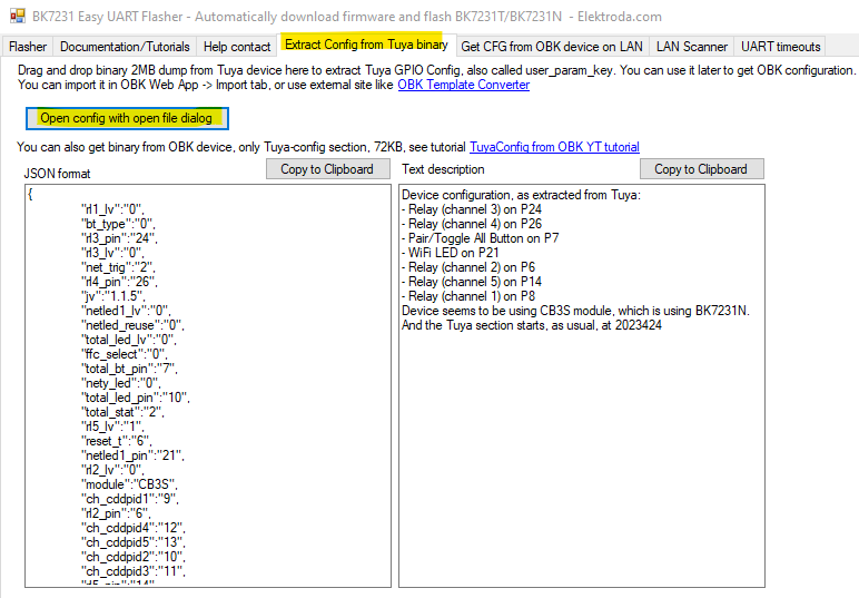

  • Easy Flasher can extract factory pin assignments
    #32 21244364
    Posts: 5208
    Help: 446
    Rate: 914
    The pin assignments are extractable from the factory fw using Easy Flasher

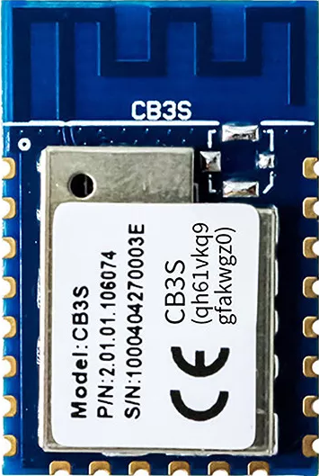

    Regarding RF - how is the physical state of the CB3S? Are there any scratches across the aerial at the top of the module that may mean most of it is severed?
    CB3S module with visible label and markings.
    Are there any minute solder whiskers between any of the contacts around the module? Have you inspected the module with a macro lens or magnifying glass for signs of damage?
    You could start the process again with one of your other new CB3S power strips...

    This is so awesome @divadiow, thanks for pointing it out! May I ask did this particular pin assignment layout you reproduce here come from the fw binary I sent you? Since I don't have Easy Flasher (unless I swallow hard and set this up on Window$ somehow, or install mono on my various linux boxen and try to run it etc), do you happen to know how this could be manually extracted from the fw binary? I guess I could start with a hex editor, if it's obvious and laid out contiguously in the binary, by searching for it. Or I guess I could just look at the code for EF and just replicate that. But super cool to know it can be found in the binary, thank you!
    Screenshot of Easy Flasher software for extracting configuration from Tuya devices.
    Regarding the antenna, I took a magnifying glass to it and didn't see anything obvious, although you can only see it on the front side of the CB3S PCB on this device, like in your picture, not from the back/underside, so it's hard to tell. It's possible that I damaged part of it from my solder of the top left CEN pin that's right at the base of it, but I didn't see anything obvious there too, except a bit of the excess metal from the solder joint kind of arcs over it a little. I wonder if the metal interference from the solder could cause it. I looked at Tuya's data sheet for the CB3S and discovered some potentially interesting info to people who know more about this than I (which isn't a high bar).  Like for example, that the "CB3S uses the PCB antenna with a gain of 1.3 dBi." And that they recommend keeping it clear of any metal parts within 15mm of it -- which is definitely violated by the upper pins on the chip itself -- and that no metal parts should be under an imaginary dome of circular arc of diameter 3cm etc.. As for that dome area being clear, as they say here in NYC, fuhgeddaboudit!
    So I think for now, unless you know some way I can verify and/or configure whether this chip's antenna is running with a gain of 1.3dBi or otherwise meeting its self-declared "Wi-Fi receiving performance" specs, I think I'll turn to the other strips I have to see if I can compare/duplicate/eliminate this phenomenon.

  • CB3S pin map extracted from firmware config
    #34 21245595
    Posts: 5208
    Help: 446
    Rate: 914
    yes, it did.
    I guess it's all possible, but not sure how this could be tackled immediately. The code that does it would be buried in here somewhere I guess; https://github.com/search?q=repo%3Aopenshwprojects%2FBK7231GUIFlashTool+extract&type=code

    except the excess metal from the solder joint kind of arcs over it a little
    goes near or actually arcs, making contact with the RF shield?
    can't say I've noticed module clearance issues to have this effect on a conversion to OpenBeken, and presumably it *should* work.
    I guess the ultimate thing would be to remove the CB3S and play with it out of the device, see if the symptoms are the same.
    config for eventual import into working device:
  • OpenBeken config can be imported via web interface

    The code that does it would be buried in here somewhere I guess; https://github.com/search?q=repo:openshwprojects/BK7231GUIFlashTool extract&type=code
    it kind of 'arcs near'. The solder kind of wicked up when it was hot I guess and kind of bends up from the pin such that the wire bends forward over a little in the direction of the PCB antenna
    yes, but that would be overly ambitious for my skill level -- I looked at some postings where people remove the CB3S chip and swap in an ESP chip. I have enough trouble making a solder joint on a single pin not messy, never mind 22 pins simultaneously set in a PCB... but good idea for my aspirations someday lol

    ah thank you! I saw something in Elektroda posts on how you load/import/export configs like this, into OpenBeken, though I wasn't sure if you do this through Easy Flasher, or rather, I assume, through the OpenBeken web interface on the CB3S chip. On the web interface do you just upload this JSON file straight? Thanks again for the pro tips!
