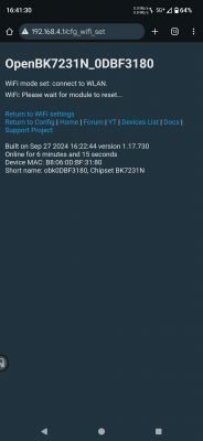

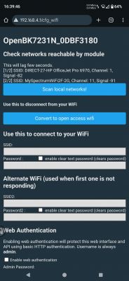

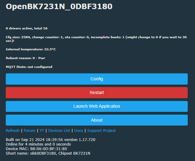

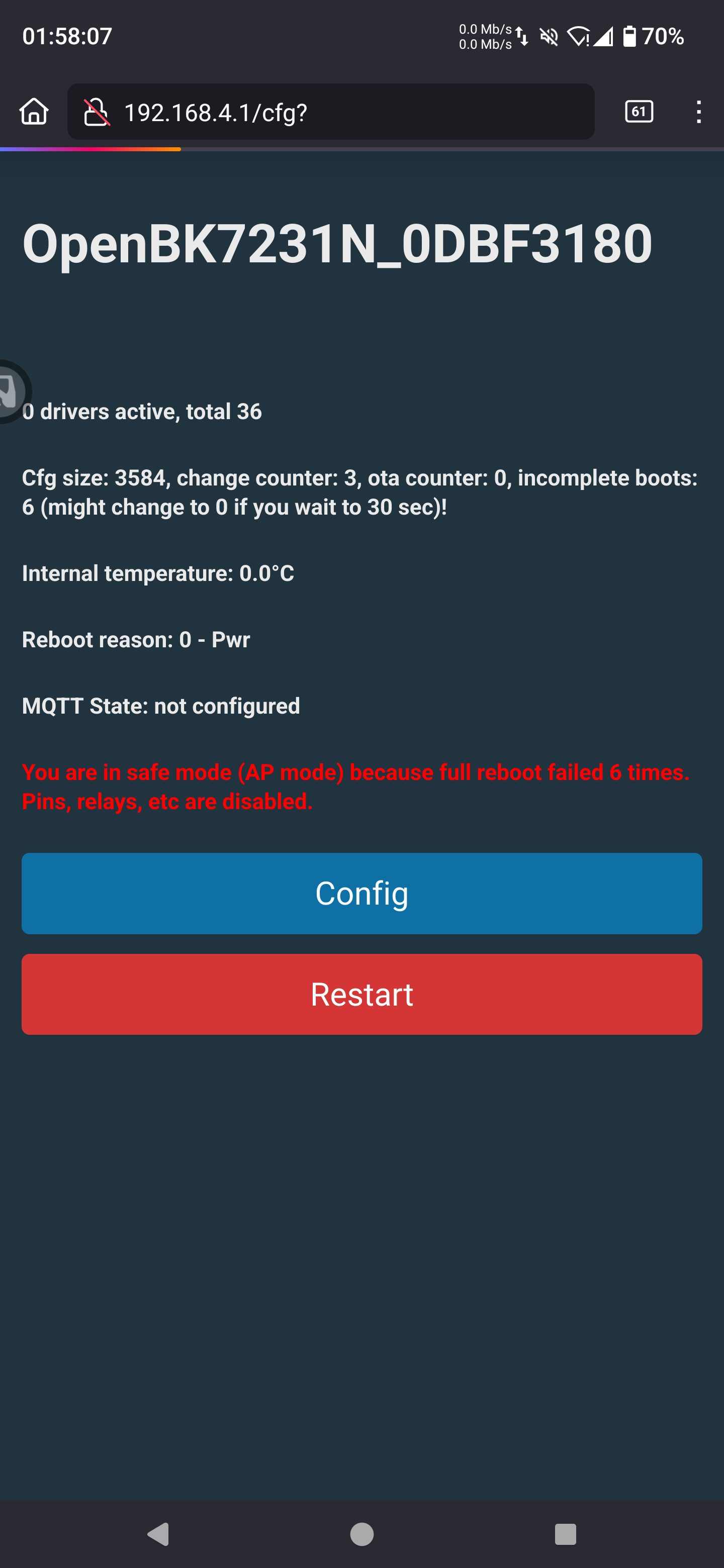

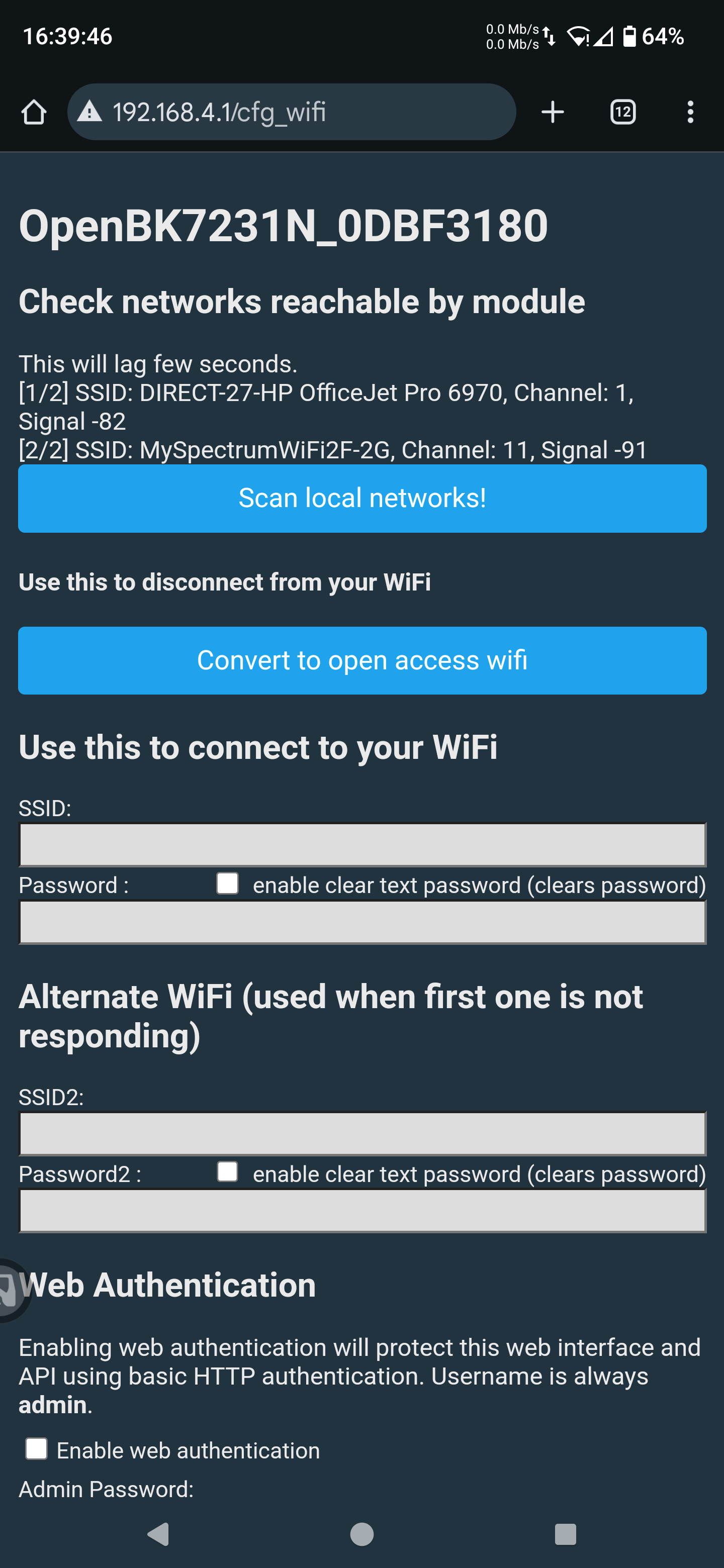

    Hi,
    I'm trying to flash OpenBeken on to an SM-SO301-U power strip, which has a CB3S (BK7231N) chip, https://www.amazon.com/dp/B09V56DSTT (I also have Jinvoo branded ones). After several tries the flash appeared to be successful in that the AP showed up. I connected to the AP and got the OpenBeken web interface menu on 192.168.4.1. I then entered my LAN wifi 2.4 GHz AP and password and submitted it. I later also submitted info on the MQTT page, and it seemed to stick/persist through several flashings.
    No matter how many times I repeated submitting my wifi info, however, the device never showed up on my local LAN network. Also, every time I went to the OpenBeken web interface, I received a red message saying "You are in safe mode (AP mode) because full reboot failed (6 times [then more]). Pins, relays, etc are disabled." Sometimes my info persisted, but no matter how I configured it (DHCP vs. giving it a known available static IP, etc). It never showed up on my network (I run OpenWrt on the router and can see everything it's doing).
    Then, in addition to never joining my network, it also soon stopped putting up an AP, after flashing, at all. That's the problem now: no AP is stood up, no matter how I flash it.
    I tried re-flashing it, several times, repeating the same procedure. Many times, the BK7231N AP never came back/up. So I tried (1) several power off/on cycling of the chip via the 3.3v pin, (2) resetting CEN->GND to reset the chip, I guess, and (3) flashing and reflashing with different BK7231N release binaries versions (679-728) as well as (4) different type binaries (I assumed the 'UART Flash' was the correct one to use, but after it failed I tried 'CCtr Flash' interspersed as well; I stayed with UART version).
    I would occasionally be able to bring up the BK7231N web page, from both versions of binaries. But at some point the AP never reappeared. Now I cannot get the AP up, in order to configure it, no matter what I do.
    I don't believe I've bricked the device, because I re-flashed the original Tuya factory firmware that it came with (that I copied with a 'ltchiptool flash read' command before I started flashing). After re-flashing the factory firmware and plugging the device in, it came up, I seemed to be able to get into 'fast-flash' AP mode, all the LEDs were lit up, etc. I didn't try linking it through Smart Life because from Tuya Convert days I thought that might permanently burn-in the cloud firmware. But the device seems to work. So I then tried flashing again various versions of OpenBK7231N_QIO_1.17.728.bin.
    I have never been able to bring up the OpenBeken BK7231N AP, however, still.
    Any ideas?
    Btw I'm flashing from a Linux laptop using the "ltchiptool" tool on the command line, e.g. "ltchiptool flash write OpenBK7231N_QIO_1.17.728.bin".
    OpenBK7231N user interface in safe mode with red error message.
    Many thanks,
    TL

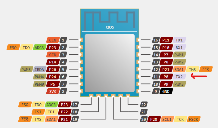

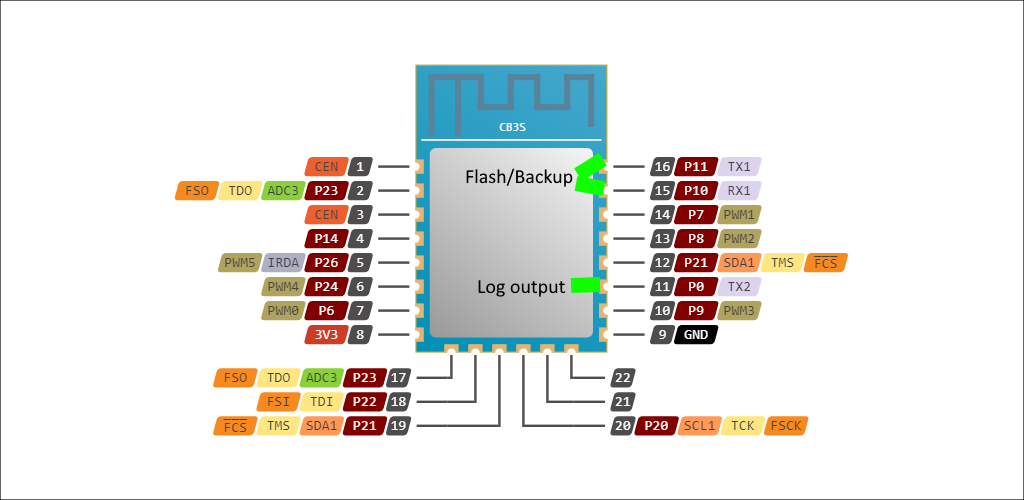

    Capture CB3S boot logs on TX2 at 115200
    #6 21239793
    Posts: 5208
    Help: 446
    Rate: 914
    OK. sure. I do not have any experience with their command-line tool but the GUI defaults are to write from 0x11000, skip offset 0x11000 and with a write length of 0x121000 if the file is QIO. No matter, perhaps we should just focus on the logs. OpenBeken is clearly to the point where it's booting and broadcasting.
    On a CB3S module the logs can be captured by connecting RX on USB-TTL adaptor to the CB3S TX2 contact. Open COM port at 115200 baud with your terminal of choice.
    CB3S module pinout diagram.
    Also, at the stage where it's going into safe mode, is your CB3S powered by 3.3v only or is this happening when it's powered by the mains? Basically, how are you powering the CB3S?

    #8 21240924
    tlpelektroda
    Posts: 18

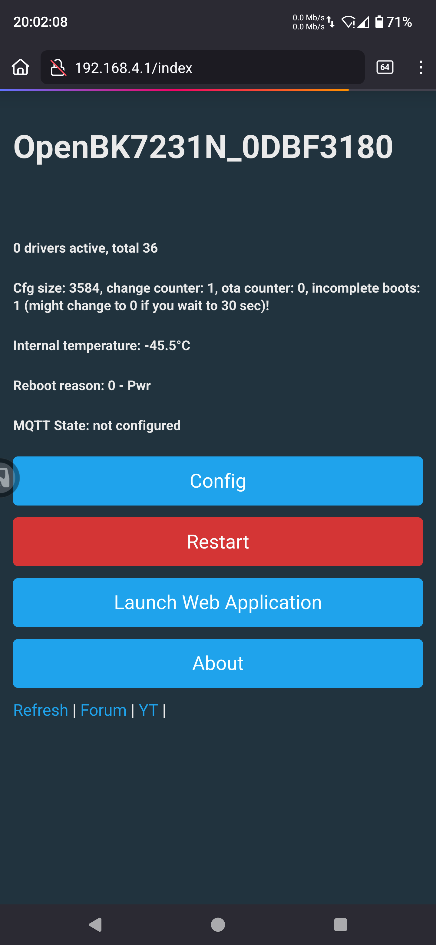

    Awesome @divadiow thank you for this!
    Ok I'm definitely going to try to monitor the UART logs, thanks for instructions how. More responses and dumb questions:
    So, just checking/confirming, I should do this monitoring with the mains UNplugged right? I.e. poll the UART logs while the chip is running off the USB-TTL's 3.3v alone — after flashing is completed (presumably I can leave the RX/TX contacts between the CB3S and my USB-TTL and my computer as they were during the flashing?), but *before* trying to power up the 120v power strip itself, right? In fact, related dumb question — we *never* need to power up the strip, in order to flash OpenBeken, bring up its AP, and have the device join the network, etc... right? I believe that's right but can't remember how I did it with the previous Tasmota-flashed power strips I did this on, whether I had the mains power on at any phase during setup, or not.
    See previous response, but short answer is: yes, my CB3S is powered by the USB-TTL-supplied 3.3v only, during these tests (including the semi-successful ones, where the AP and web interface did come up but then never joined my network). Except maybe once or twice if/when I tried the whole test sequencing with the mains on.

    #9 21240989
    Posts: 5208
    Help: 446
    Rate: 914

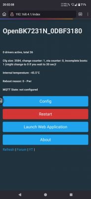

    100% UNplugged from the mains for anything flashing/logging. But wait, if you're powering the CB3S from USB-TTL alone then maybe it's not stable because of brownouts - the USB-TTL cannot provide enough current - this is usually the case. The general experience is that the 3.3v from a USB-TTL adaptor is often not good enough and an external 3.3v PSU should be used to be sure. Have you tried making the device safe again and then trying it on the mains alone or introducing an external 3.3v power source instead of relying on the USB-TTL?
    Indeed, never use the mains for flashing or anything relating to the USB-TTL adaptor.
    Screenshot of interface showing internal temperature 0.0°C, reboot reason (0 - Pwr), and MQTT state: not configured.

    #10 21241010
    tlpelektroda
    Posts: 18
    Interesting, wow thanks @divadiow, I'll definitely try that. My only pondering about this is, I think I've pretty much 'always' only used the 3.3v from a USB-TTL adaptor, I think, and never had this problem before. But if this fixes it, who am I to ponder?! I guess the first thing I have to figure out is how to get a powerful 'enough' 3.3v supply (I guess its 'amp rating' or something would be the measure?). Would the 3.7v LiPo batteries I have around do it? And if so, is it safe to connect 3.7v to a 3.3v supply pin on the CB3S chip? If not, my next try would be a 5 volt line from a typical USB charger plug/adapter, plugged into the wall, and then step it down to 3.3 with some kind of circuit board I think I also have lying around somewhere. Failing all that, would a 3.3v output pin from a Raspberry Pi work/do the trick, or even an Arduino board, do you think? That would be the easiest I think. I have a couple Pi's, the 'biggest' one is a Pi 4 Model B I think. Last question what did you mean "making the device safe again and then trying it on the mains alone" -- what's the making safe part, and then, on the mains alone, that means just plug it in, and when flashing I only connect the TX and RX lines from the USB-TTL to the chip? (and I guess then ground the CEN to the GND pin).
    Thanks so much again and sorry for the flurry of follow up dumb questions.

  • TX2 logs at 115200 baud and full-flash restore advice
    #20 21242916
    Posts: 5208
    Help: 446
    Rate: 914
    tlpelektroda wrote:
    The monitor only seemed to spit out garbage characters
    Please confirm you're trying to get the UART logs from TX2, not TX1. 115200 baud is correct.
    Pin diagram of CB35 module with functional labels.
    tlpelektroda wrote:
    Does this offset indicate anything bad that might be causing the AP to not come up?
    No. The offset means it is just skipping the bootloader, which is included in QIO firmware.
    start address = where on your chip it'll start programming from
    skip offset (input file) = how much from the beginning of the file you're burning it'll not program - eg the bootloader, if offset is 0x11000 and it's a QIO file
    If you want to be sure your RF isn't broken and you want to get back to factory 100%, assuming you have a working backup, you can program your backup starting from 0x0, so:

  • TX2 UART logs and QIO offset clarification
    #21 21242941
    tlpelektroda
    Posts: 18
    Ah, thanks so much for all this educational info.
    So, first, on the UART logs, I totally missed that subtlety, that it should be from TX2. I was definitely doing it off TX1. So I'll try that for sure.
    As for the offset, thanks for explaining. It prompts me to wonder though, I wonder if I broke something when, out of desperation, I occasionally tried flashing the CCtr/UG binaries, e.g. "OpenBK7231N_UG_1.17.720.bin". Since, I gather, the CCtr/UG versions *don't* have a bootloader with them, perhaps I overwrote or broke something by doing that, such that the subsequent QIO firmware would thenceforth never again be flashed properly?
    Related, if I try to flash it back to factory to confirm whether the RF works or not, like you suggest, (1) might this be helpful to 'reset' the UG vs. QIO/offset situation I potentially created, and (2) the only way I can tell if the full networking RF works, with the factory firmware, is by fully provisioning it through the Smart Life app (I think that's the only way it gets assigned an IP and 'shows up' on my network). If so, will fully provisioning the factory firmware prevent me from flashing OBK forever after? (like I believe it did in the old Tuya-Convert days).
    divadiow wrote:
    start address - 0x0
    skip offset - 0x0
    writing length - clear any values (all data written)
    then use Easy Flasher GUI to flash OBK as normal

  • Intermittent AP appears after CEN resets and then disappears
    #27 21243152
    tlpelektroda
    Posts: 18
    OK, this is interesting and a bit bizarre. I reflashed as suggested the factory firmware at 0x0, then OpenBK with LT defaults, which were offset 0x11000 etc.. And nothing happened, it failed, no AP came up. So I was just about to report back that it didn't work, and in the meantime was simultaneously kind of fiddling with different combinations -- I brought it up on the mains, brought it up on USB-TTL power only, pressed the power button, shorted out the CEN->GND a couple of times, etc. And then suddenly, can't pinpoint exactly when, I glanced at my phone and saw the AP came up! So I quickly scrambled to punch in 192.168.4.1, and it started to bring up the web interface/page. And then the browser stalled/hung, didn't complete, and so I looked back at the current wifi network, and the AP was gone (which is why the browser page never finished loading). So I fiddled again, maybe shorted out the CEN->GND again, or something .... nothing worked .... and then, at some point, lo and behold, it was back. So once again I rushed to load the same page, this time it fully loaded, and I quickly punched through to the wifi config page, and retyped in my local LAN AP and password, and hit 'Submit' button. Right then, the browser said "Connection reset" or something. I thought, fine, it's now connecting to my network. But it didn't, and everything was gone again. No AP, no presence on the local LAN, nothing from the router that showed any presence of it, not even a trace of the MAC address again, at all. So I tried to reproduce the whole sequence again, restarting on the mains, restarting on USB-TTL power alone, shorting out CEN->GND on both, etc.. Nothing worked. It appears to be gone again.
    I have to go away and do something else for the next couple of hours, but what do you think of all this? (I can't try UART logs at the moment because I'm going to have to solder on another wire to TX2, which will take some set-up etc.).
    Here fwiw is the relevant output from the initial flashing of first the factory firmware and then OpenBeken, and then a snapshot I managed to get of web page before it was gone the first time I think:
    Factory:
    "I: Connecting to 'Beken 7231N' on /dev/ttyUSB0 @ 115200
    I: |-- Success! Chip info: BK7231N
    I: Writing 'read-result-file-1.bin'
    I: |-- Start offset: 0x0
    I: |-- Write length: 2 MiB (auto-detected)
    I: |-- Skipped data: 0 B"
    Then, directly/immediately, OpenBeken:
    "I: Detected file type: Beken QIO Firmware
    I: Connecting to 'Beken 72xx' on /dev/ttyUSB0 @ 115200
    I: Writing 'OpenBK7231N_QIO_1.17.730.bin'
    I: |-- Start offset: 0x11000 (auto-detected)
    I: |-- Write length: 1.1 MiB (auto-detected)
    I: |-- Skipped data: 68 KiB (auto-detected)"
    Notice how this time, on the web page, there is no error about safe mode or anything, at least( :-D !). But does indicate "1" "incomplete boots", as well as an "Internal temperature" that I believe has never been reached in this part of the country at least, not sure what that's about lol, but anyway:
    OpenBK7231N interface screen with system information.

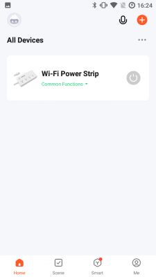

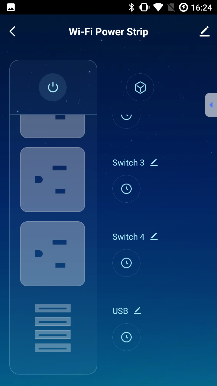

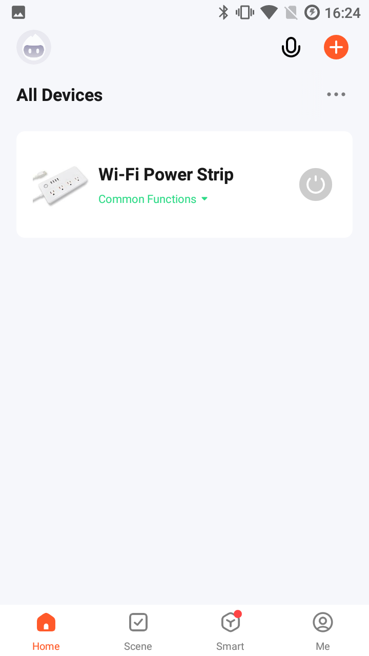

  • CB3S backup boots and pairs in Tuya app
    #28 21243184
    Posts: 5208
    Help: 446
    Rate: 914
    not too sure what to suggest next really. I'd hope there would be some clue in the TX2 logs.
    There's always trying factory fw with Tuya app I guess to be sure it works when in that state.
    Also, you could flash a factory firmware from any other BK7231N device (there are loads posted around) and then do OBK again. That would rule out a dodgy backup, but the file you posted does seem OK on initial dissection. I can flash it to dev board later today to just see if it boots and will let me convert it to OBK.
    Added after 9 [hours] 34 [minutes]:
    well I flashed I flashed a CB3S to your backup and it booted and was pairable in the Tuya app
    User interface of an app managing a Wi-Fi power strip showing outlets and switches. Mobile app with All Devices section featuring a Wi-Fi power strip.
    and then to OBK
    Screenshot of the OpenBK7231N interface showing device information.
    factory boot log
  • OpenBeken settings never take and Tuya pairing fails
    #29 21244297
    tlpelektroda
    Posts: 18
    Hi, interesting, so may I ask, when it shows up as 'pairable' in the Tuya app, are you able to *actually pair* and provision it, i.e. go all the way through so it's fully set up on the Tuya app?
    Reason I ask is because now I've been able to flash OpenBk and bring up the AP/web interface deterministically. So I go through the motions, configure an IP (tried both static and DHCP), configure the wifi AP and password, and then hit submit, after which the transitional page says "WIFI: Please wait for module to reset..." (screenshot below). And then, once again, nothing happens after that. The OpenBK AP disappears, which is expected, but then the newly configured system never shows up on my LAN, no authentication attempts, no MAC broadcasts, nothing. The only slight subtlety maybe is that somewhere on the OpenBK web interface it says you have to 'reboot' the chip, or something, for settings to take effect. When I've submitted configurations, the 'uptime' clock keeps ticking, and it shows something like '6 minutes' uptime, i.e. it never rebooted. So one time I tried manually restarting it, in the hopes that would make the settings 'take', but it didn't make any difference. Is there anything there I should look at? (to confirm that the wifi/IP settings really 'take').
    OpenBK interface with a message about connecting to WLAN and a request for module reset.

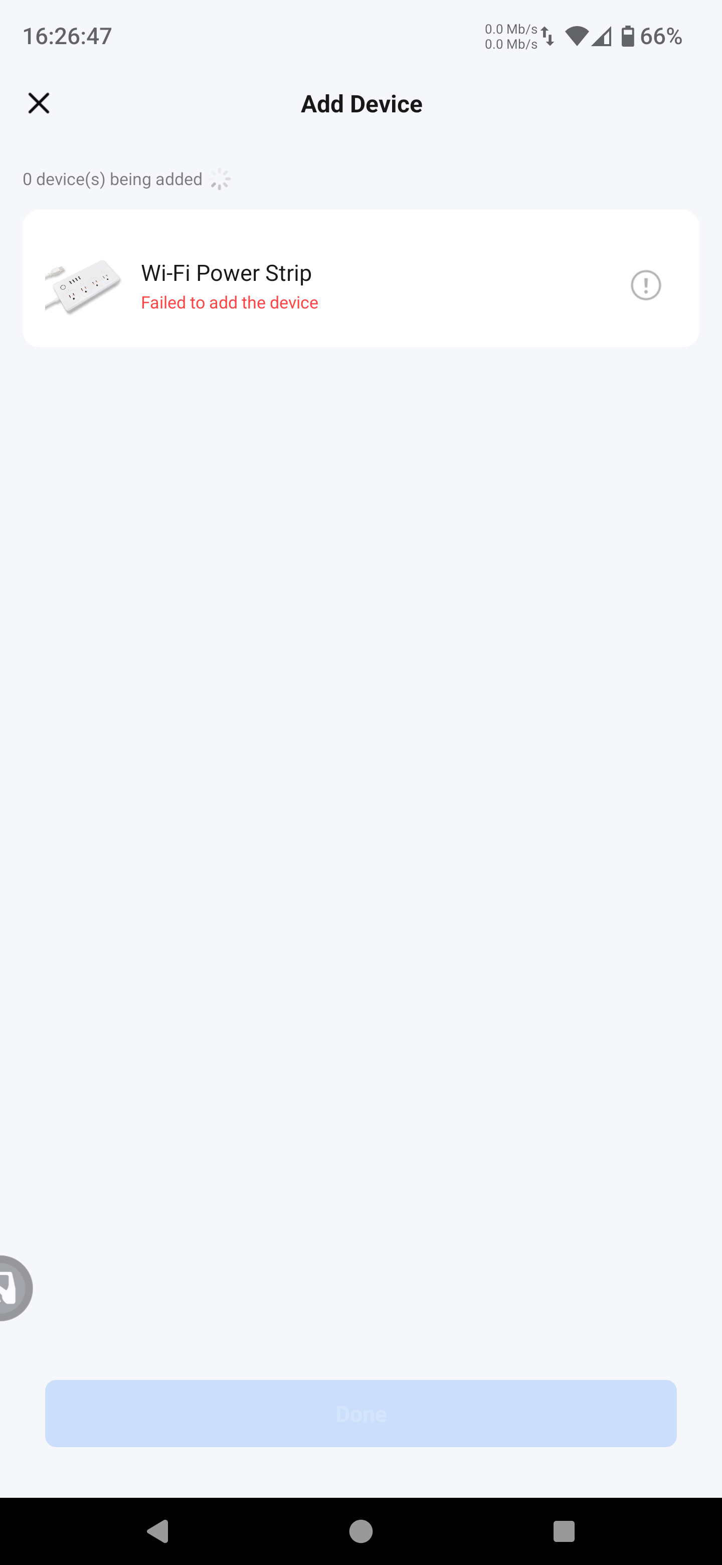

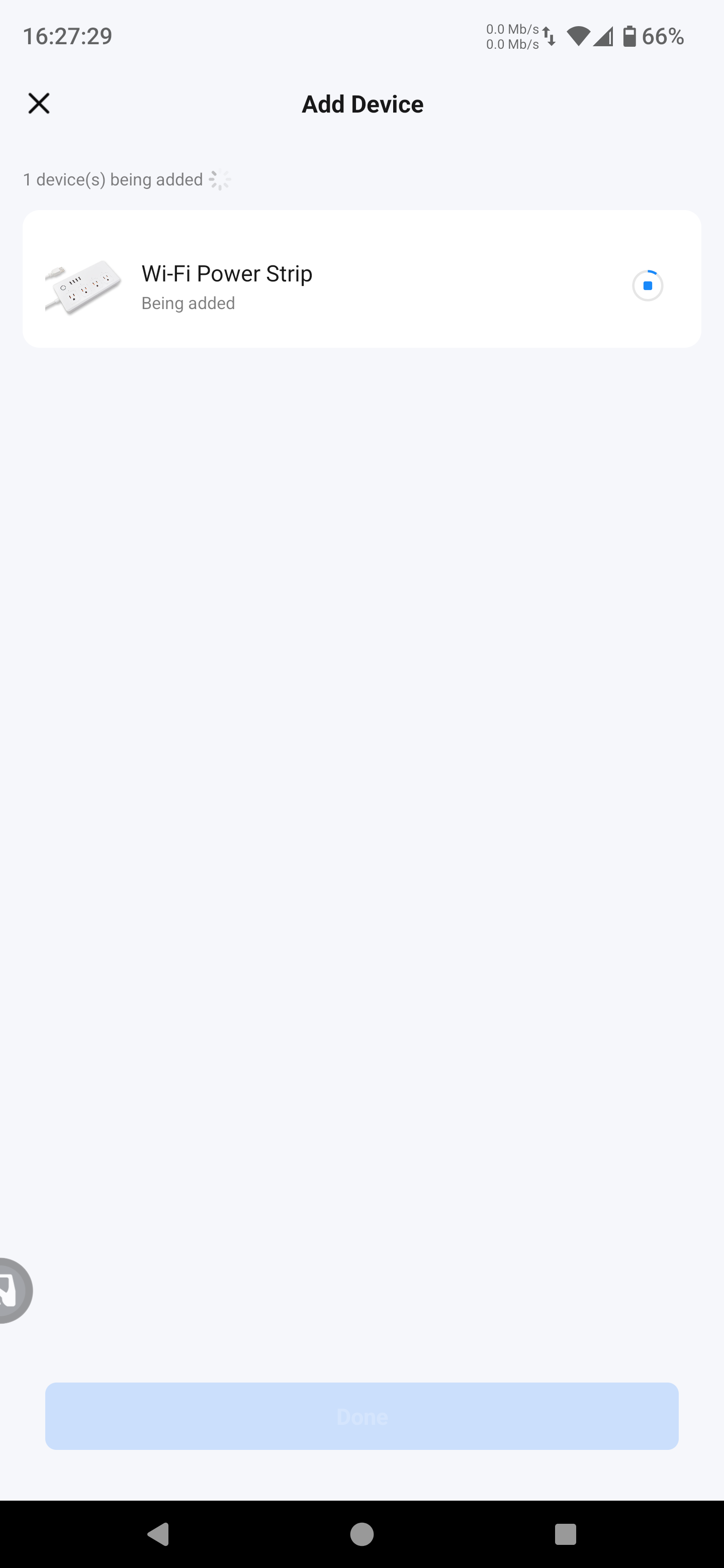

    So, I started over by reflashing the factory firmware back on, repowering it up, and then apparently all good -- I go into the Tuya app to add the wifi power strip manually etc. That's when, it turns out, it never works at all. After a several tries, I'm never able to successfully add it as a device. During the 'fast-blink' add, it finds the device, starts to add it, but then fails with the attached screenshot(s) below. One time, when I rebooted the strip and tried to add it again, the 'slow-blink' came up instead, but it never added the Tuya AP. So I reboot (although the strip sometimes reboots itself, not in a good looking way, during the add process) to bring up fast-blink again, try to add again etc. It never works. Often times, the fast-flashing blue LED just stops flashing midway through the add process. I believe that might be normal. But regardless of whether it stops blinking or continues blinking all the way through the end of the add process, it never succeeds and always fails. (The Tuya app 'add device clock' counts down from something like 3 minutes, and it always gets to the end, with failure).
    Tuya app screen while adding a Wi-Fi Power Strip device.
    Screenshot of an app showing a failed attempt to add a Wi-Fi device.
    So all of this seems to point to the fact that there may be something wrong with the hardware on my particular device, would you agree? It seems that would be confirmed if you're able to bring up the same factory firmware of mine on a different hardware or virtual test harness environment, and add it the Tuya app successfully.
    If it is hardware, not sure if it's worth trying to get the UART logs and figure out why, unless there's something that can be changed in the hardware or on the chip?
    One last hail-mary shot/guess, one small thing I noticed is that when I had the OpenBK web page 'Scan for local networks!,' instead of manually adding my local LAN wifi network AP, it only shows *2* 2.4Ghz networks, 2 out of 2, neither of which are the right ones, screenshot below. Plus, a wifi scan from any other device I have shows something like 20-30 networks available, near me and the device, not just the 2 (only) that the OpenBK shows. Could that be significant, in that the CB3S chip is somehow not 'receiving' well enough to be able to see my network/router (which is only about 10 feet away and visible to every other device)?  So perhaps an antenna problem, or something?
    Screenshot of the WiFi configuration interface for OpenBK7231N device.
    Added after 2 [hours] 17 [minutes]:
    tlpelektroda wrote:
    One last hail-mary shot .... So perhaps an antenna problem, or something?
    Eureka! so it turns out that was it. I repeated the whole sequence, but this time bringing it up with it sitting right next to my router. This time 'Scan local networks' showed my LAN AP right away. Connected, all good now. ... Or so it *seemed*...
    One thing I noticed right away is that, when I scanned for networks, this time right next to my router, once again, the OpenBK web page showed only *2* networks, one of which was mine and correct, but not any of the other 20-30 networks that are available to any other devices that do a wifi scan for APs.
    As soon as I moved the now-OBK-configured and provisioned power strip away from the router, it disappears. The power strip can't connect to my wifi network, even when it's only as far as 5 feet away from the router.
    So it would seem there's something wrong with the CB3S antenna?
    Or could it be something else? I see from CB3S diagrams that the antenna is baked into the PCB at the top of the chip. And it looks fine on the chip in this power strip AFAICT.
    Any idea whether there's any circuitry or section of the software/firmware on the chip, that would affect the receptivity, other than the characteristics of the physical antenna itself?
    Or perhaps that there's something wrong in OpenBeken, such that it only looks for and can connect to the 'top 2' highest-signal-strength networks it sees, and ignores all the others?
    Because otherwise this device is useless as-is. Of course I can now turn to the other new identical power strips I ordered, flash them and see if they suffer from the same poor receptivity, though.
    One last question in the meantime, if you or anyone might know -- is there a *template* around to configure the SM-SO301U pin/GPIO layout in OpenBeken?
    If there isn't, could I just use the same template that Tasmota, and I, used to configure the previous version of these strips, that had the TYWE3S chip? (considering that I think I read that they're pin-compatible?).
