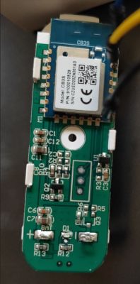

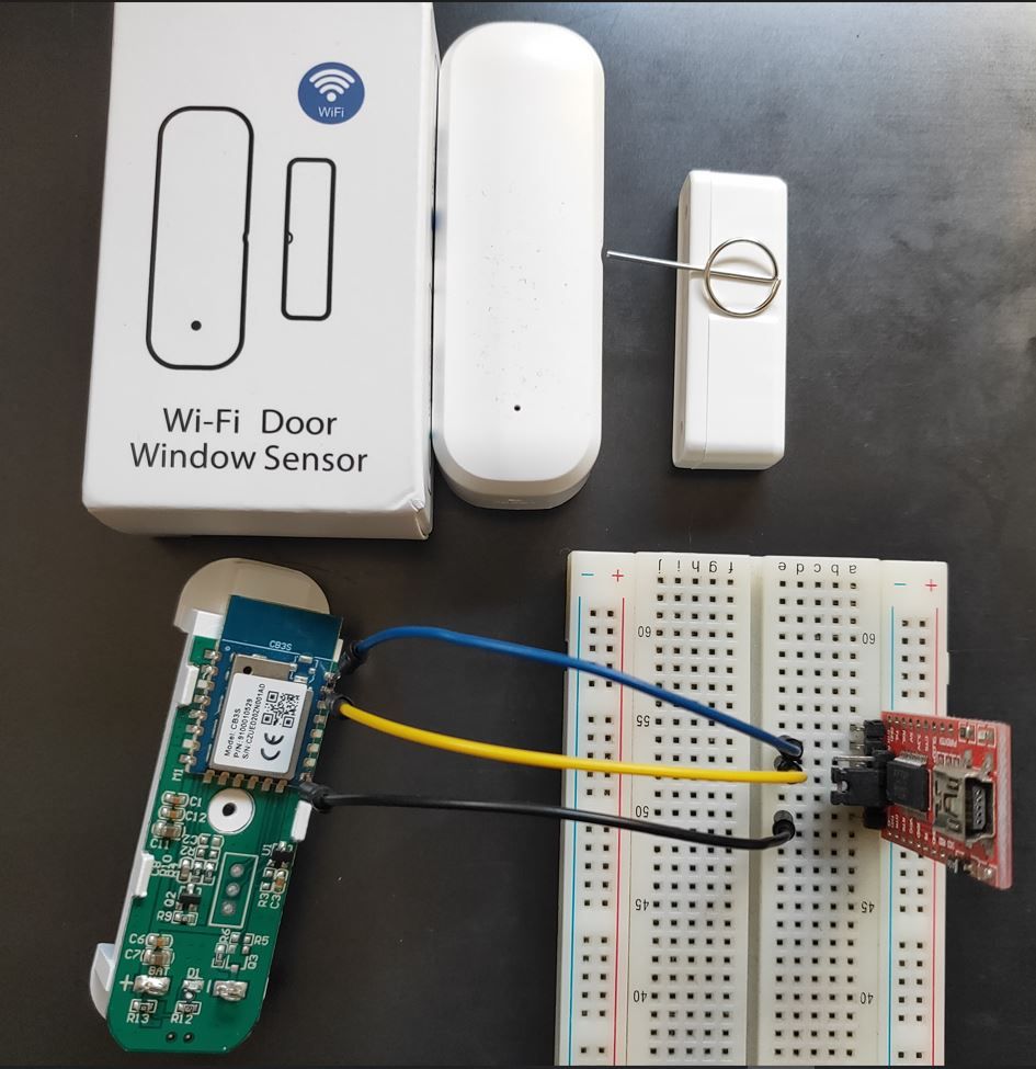

    Hi all,
    First of all, this is my first post on this forum, so apologies if it's not in the correct forum/topic.
    I recently purchased a generic (Tuya OEM?) WiFi door sensor which has a CB3S chip (runs on 2xAAA) as shown in the attached photos from Aliexpress.

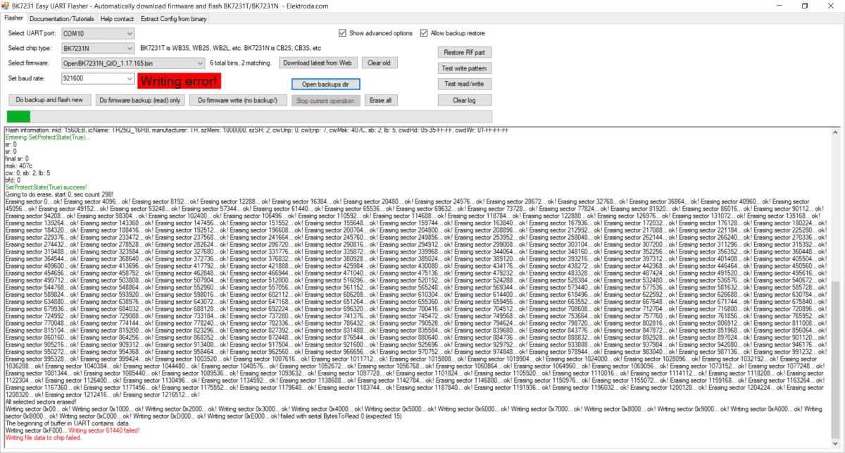

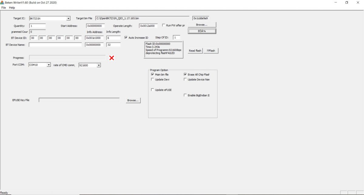

    I tried flashing it with the BK7231 GUI Flash Tool and with bk_writer1.60 as well, but both are giving errors.
    I also tried flashing OpenBK7231N_QIO_1.17.165.bin with "BK7231Flasher," but it gives an error as shown in the screenshot.
    While bk_writer1.60 throws an error with "unprotecting failed" as shown in the screenshot.
    BK7231 flasher, while taking backup, provided the following configuration it thought exists:
    I'm not sure what I'm missing. Can someone help?

    Hello, can you try the hid_download_py method from this video?
    https: //github.com/OpenBekenIOT/hid_download_py
    Please also provide us a firmware backup if you have it.
    Keep in mind that after flashing you will have to configure door sensor with deep sleep in order to avoid draining the battery too quickly.

    >>20638561
    Got the hid_download_py installed, however still not able to flash. Error below:
    python3 uartprogram OpenBK7231N_QIO_1.17.165.bin --unprotect -d COM10 -w --startaddr 0x0
    UartDownloader....
    program....
    WriteSector 1 Failed: |##3 |[ 2.42k/s]
    Added after 17 [minutes]:
    Failed with reduced baud as well:
    python3 uartprogram OpenBK7231N_QIO_1.17.165.bin --unprotect -d COM10 -b 115200 -w -s 0x0
    UartDownloader....
    program....
    WriteSector 1 Failed: |##3 |[ 1.43k/s]
    Is the internal flash write protected purposefully to inhibit others from flashing it with open source firmware?

    Some questions:
    - are the batteries present? (if not you can use the power from the USB to UART adapter - just be sure you are using 3.3V not 5V!!!)
    - try lowering your port speed to 115200 does that work?
    - can you provide the link to the product (link form AliExpress store)?
  • Ground CEN briefly to trigger module reset

    sandyk wrote:
    @DeDaMrAz
    Hi
    Yes, the AAA batteries are present. Using FTDI with common ground & RX/TX pins (not using power from the FTDI).
    Here is the Aliexpress link for the product:
    https://www.aliexpress.com/item/1005005021005....order_list.order_list_main.17.282f1802iGFLTZ
    Tried with lower baud but that is not fixing it.
    Thanks
    Start the GUIflasher and then ground for the short time CEN pin on the module as the module will not self reset if powered previously.
    Also try 115200 for the port speed.

    Maybe the device goes asleep before you try to flash? Try pressing onboard pair button several times before and during flashing.
    Maybe try another USB dongle?
  • #9 20640435
    sandyk
    @p.kaczmarek2 Changing the FTDI adapter seemed to have helped. I am able to flash the device, and it is now configured to connect to my WiFi.
