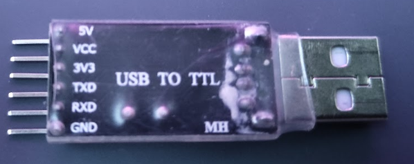

    ## Requirements:
    * USB to TTL or UART reader
    Flashing Guide for WB2S Tuya Action SmartPlug Power monitoring with BK7231Tusb_ttl_ua...t_back.png (167.21 kB)You must be logged in to download this attachment.

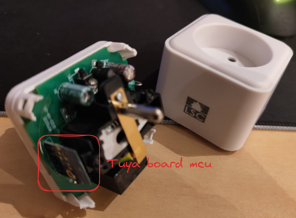

    # Step One

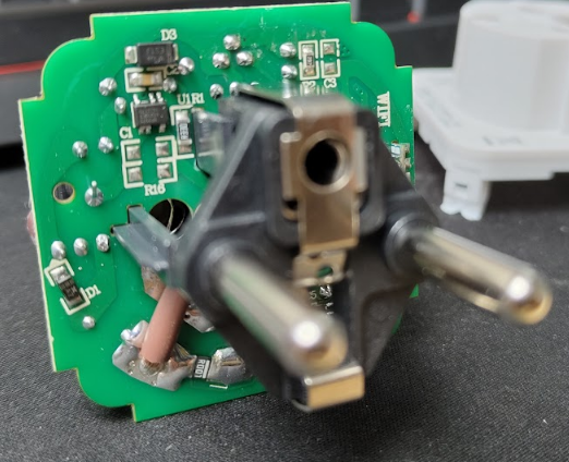

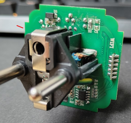

    Begin by opening the smart plug case with a flat screwdriver.
    Flashing Guide for WB2S Tuya Action SmartPlug Power monitoring with BK7231Toppened_..g.png (591.67 kB)You must be logged in to download this attachment.
    After opening, you should have access to the board.

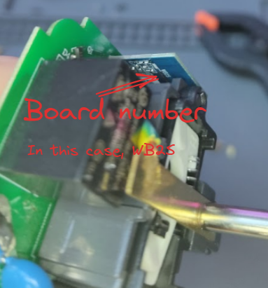

    # Step Two

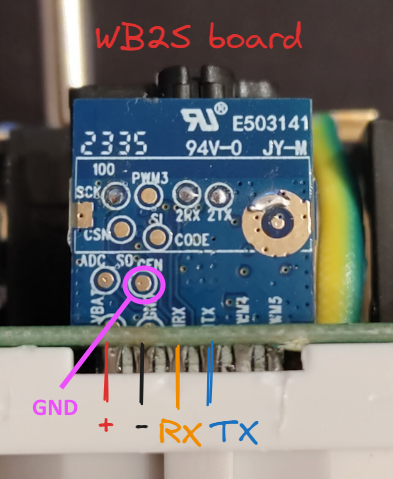

    Locate the Tuya board number on the back of the blue board:
    Flashing Guide for WB2S Tuya Action SmartPlug Power monitoring with BK7231Tboard_nu..r.png (183.54 kB)You must be logged in to download this attachment.
    Google the board name, find Tuya documentation, and confirm the MCU (in this case, the board is a WB2S with [BK7231T MCU](https://developer.tuya.com/en/docs/iot/wb2s-module-datasheet?id=K9ghecl7kc479)). The manufacturer provides all the required data for flashing:

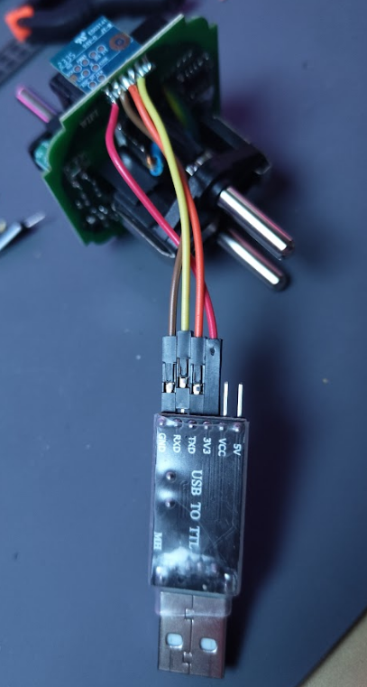

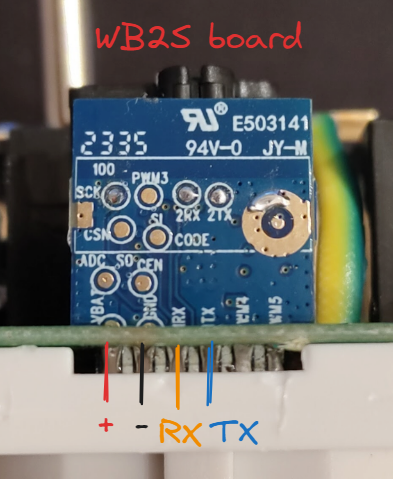

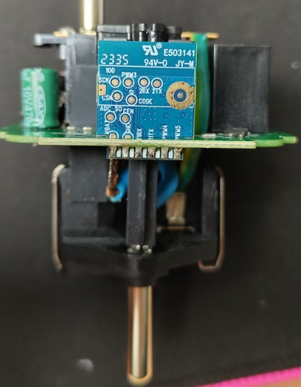

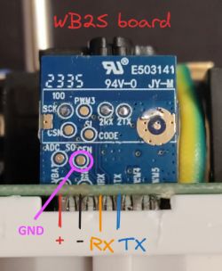

    # Step Three
    Solder wires on the GROUND, VBAT, RX, and TX pins. Highlighted pinout:
    Flashing Guide for WB2S Tuya Action SmartPlug Power monitoring with BK7231Tboard_w...png (243.42 kB)You must be logged in to download this attachment.
    Flashing Guide for WB2S Tuya Action SmartPlug Power monitoring with BK7231Tsoldered_..re.png (326.01 kB)You must be logged in to download this attachment.

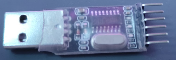

    Connect pinout wires to the USB to UART adapter (ensure the MCU supports only 3.3V), and check Tuya RX is on the TTL board's TX and vice versa.
    Flashing Guide for WB2S Tuya Action SmartPlug Power monitoring with BK7231Tusb_ttl_co...nected.png (297.42 kB)You must be logged in to download this attachment.
    # Step Four

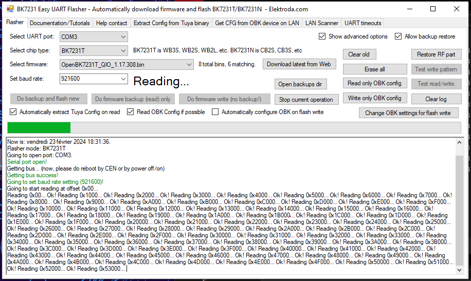

    Plug the UART reader into your computer and launch [OpenBeken flasher software](https://openbekeniot.github.io/webapp/devicesList.html).
    Flashing Guide for WB2S Tuya Action SmartPlug Power monitoring with BK7231Teasy_uart_...lasher.png (41.85 kB)You must be logged in to download this attachment.
    Start by making a firmware dump (backup) by clicking **Do firmware backup (read) only**.
    Flashing Guide for WB2S Tuya Action SmartPlug Power monitoring with BK7231Tfirmware_B..kup.png (74.96 kB)You must be logged in to download this attachment.

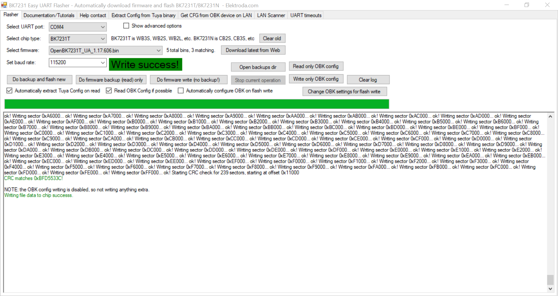

    Locate the corresponding firmware and select the right one for your MCU, using the **_UA.bin** file, and click flash.

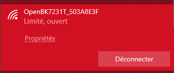

    Unsolder all wires, put the board back in its enclosure, and plug it into an outlet. You should be able to see a WiFi hotspot:
    Flashing Guide for WB2S Tuya Action SmartPlug Power monitoring with BK7231Twifi_hot..t.png (28.38 kB)You must be logged in to download this attachment.
    Go to the WiFi properties, enter the gateway IP in a web browser:
    Flashing Guide for WB2S Tuya Action SmartPlug Power monitoring with BK7231Twifi_gat..y.png (28.56 kB)You must be logged in to download this attachment.

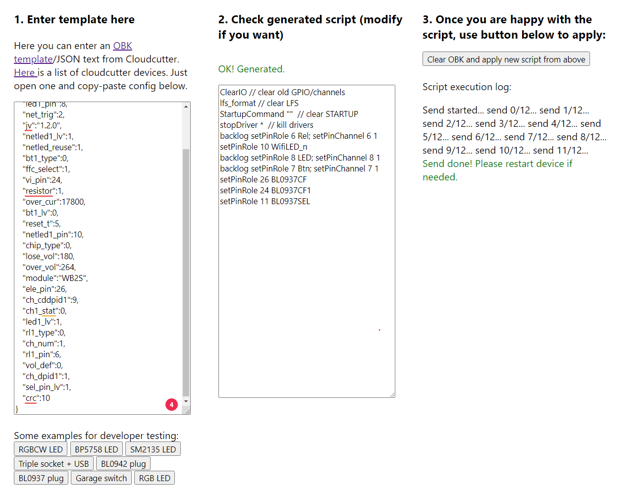

    # Step Six
    Configure the power plug by inserting the JSON obtained in Step Four. Go to **launch web app** and into **import**, paste the JSON, and click **clear OBK and apply new script**.
    Flashing Guide for WB2S Tuya Action SmartPlug Power monitoring with BK7231TCapture d’...184658.png (170.19 kB)You must be logged in to download this attachment.
    here my json obtained by reading the dump firmware :
    Action_LSC...toring.rar (457 bytes)You must be logged in to download this attachment.

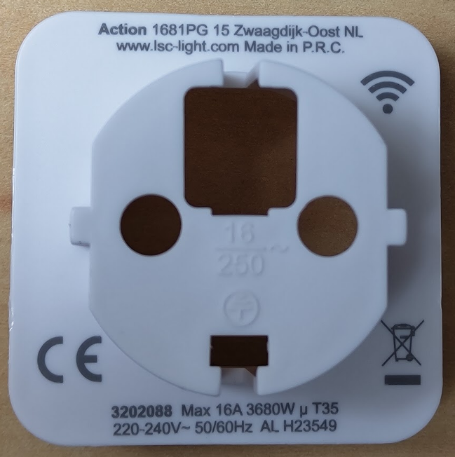

    Thanks for sharing, I always use the same USB to UART converter as you. By the way, can you also share the model number of that Action plug? Futhermore, I also need OBK JSON format template for our devices list: https://openbekeniot.github.io/webapp/devicesList.html You can copy it from Web App main panel. Also fill the "wiki" and "image" URLs
    Corrected smart plug model to 3202088
    #3 20976420
    Eltaistos
    Posts: 7

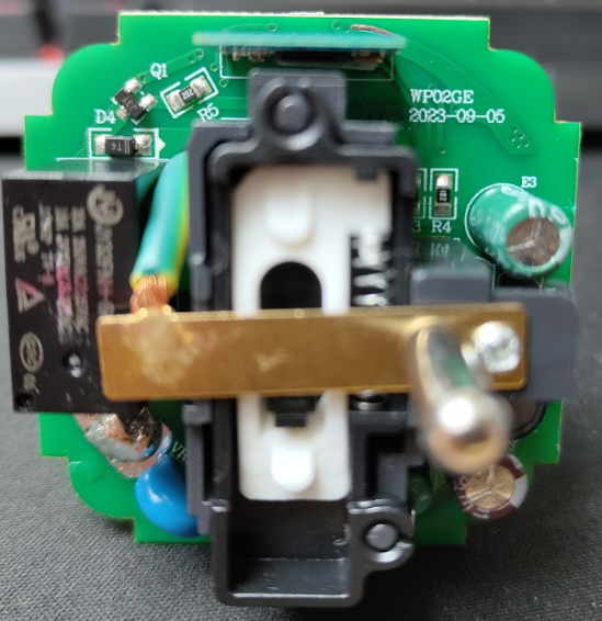

    Thanks for replying. The model is 3202087, the smart plug board number is WP02GE from 2023-09-05. I think this in a new version because they have changed the MCU from the last one.
    For the OBK JSON, I have provided the JSON in the .rar archive, and I have referenced the picture and wiki link from this post.
    Moderated By p.kaczmarek2:
    This is actually 3202088 , as can be seen on the photo. Please do not confuse model numbers
    Here the json in the archive :
      "vendor": "Tuya",
      "bDetailed": "0",
      "name": "Action LSC SmartPlug with power monitoring",
      "model": "LSC SmartPlug with power monitoring",
      "chip": "BK7231T",
      "board": "WB2S",
      "flags": "1024",
      "keywords": [
        "TODO",
        "TODO",
        "TODO"
      "pins": {
        "6": "Rel;1",
        "7": "Btn;1",
        "8": "LED;1",
        "10": "WifiLED_n;0",
        "11": "BL0937SEL;0",
        "24": "BL0937CF1;0",
        "26": "BL0937CF;0"
      "command": "",
      "image": "https://static.elektroda.pl/attach/lsc_smart_plug_1266846.png",
      "wiki": "https://www.elektroda.com/rtvforum/topic4038087.html"
    Here is the picture that I used to retrieve the given information.
    Flashing Guide for WB2S Tuya Action SmartPlug Power monitoring with BK7231Tboard_ref_..._back1.png (300.67 kB)You must be logged in to download this attachment. Flashing Guide for WB2S Tuya Action SmartPlug Power monitoring with BK7231Tboard_ref_..._front.png (434.31 kB)You must be logged in to download this attachment. Flashing Guide for WB2S Tuya Action SmartPlug Power monitoring with BK7231Tboard_ref_..._back2.png (330.41 kB)You must be logged in to download this attachment. Flashing Guide for WB2S Tuya Action SmartPlug Power monitoring with BK7231Tbox_in..png (448.96 kB)You must be logged in to download this attachment. Flashing Guide for WB2S Tuya Action SmartPlug Power monitoring with BK7231Ttuya_board..for.png (231.88 kB)You must be logged in to download this attachment. Flashing Guide for WB2S Tuya Action SmartPlug Power monitoring with BK7231TPlug_case..fo.png (347.87 kB)You must be logged in to download this attachment.
  • #4 21027114
    fletr
    Hello, the model is 3202088 as seen on the pictures, not 3202087.
    I was just about to submit a new device teardown, not necessary as correct device model will now appear on the search.

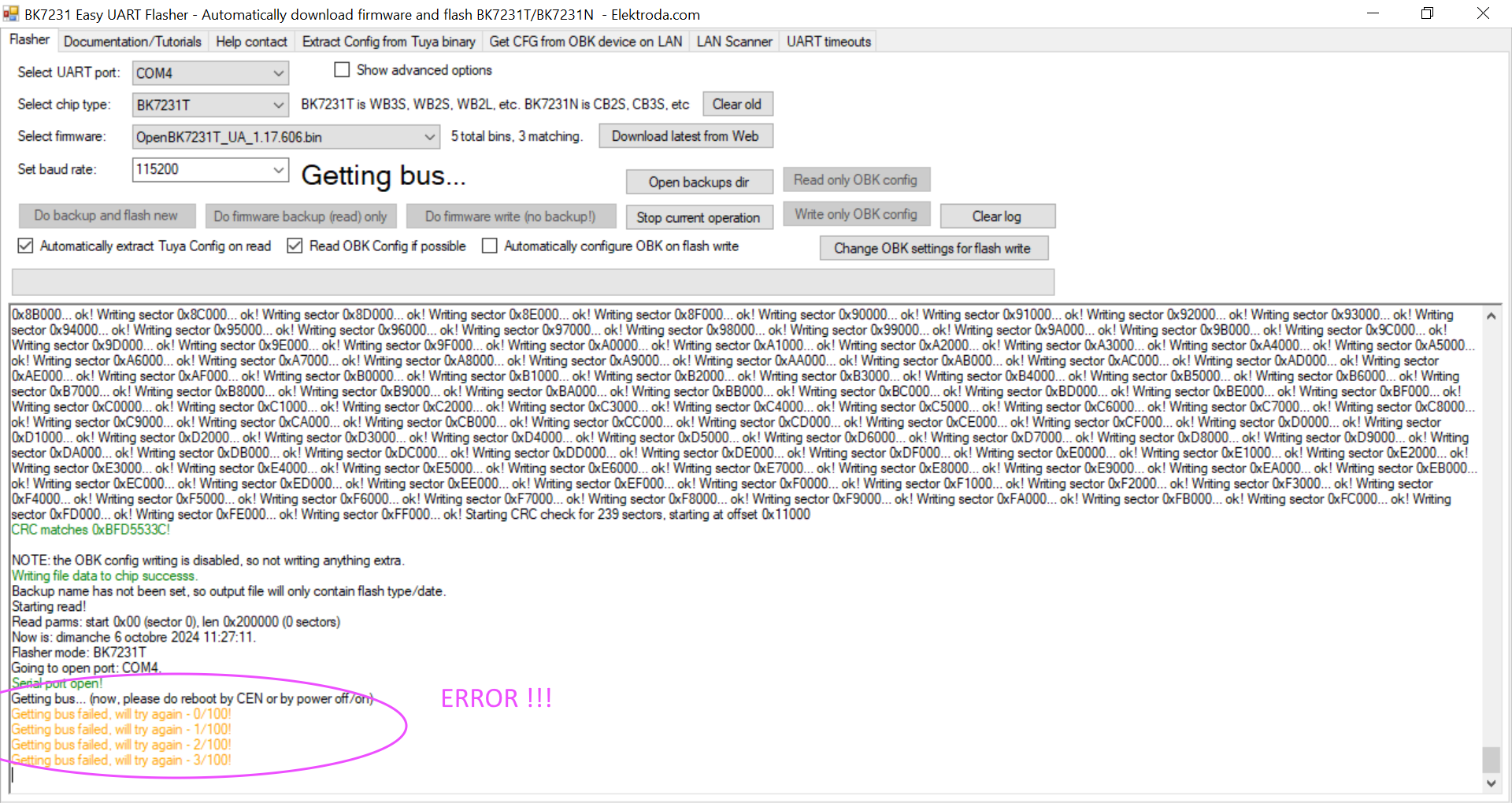

    Systematic error from the backup.
    Getting bus failed, will try again - 1/100!
    I checked my 4 solders, reversed TX and RX
    However, the LED lights up as soon as the backup is started.
    My model is the same of this tuto, 3202088
    Thank you for this tutorial.

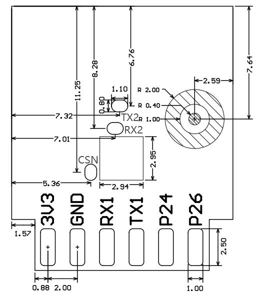

  • Wrong silkscreen markings on CB2S/WB2S modules
    #17 21086520
    Posts: 14755
    Rate: 12878
    It's not ESP8266, it just waits for reboot to flash.
    I have another idea what could have been wrong.
    There are CB2S/WB2S modules with wrong silkscreen marking.
    You need to follow silkscreen from documentation:
    Diagram of a module with pin designations and dimensions.
    The one on image is correct. The physical module may have swapped (incorrect) markings.
    Futhermore, check out our whole flashing guides list:
    https://www.youtube.com/watch?v=L6d42IMGhHw&list=PLzbXEc2ebpH0CZDbczAXT94BuSGrd_GoM&pp=iAQB
    We have flashed quite a lot of BK7231 so far...

    #22 21252494
    nicleroux35
    >>21086513
    Hello!
    I noticed that several people encountered the same issue as me: "Error Getting bus failed, will try again - 1/100!" when trying to perform a firmware backup.
    Screenshot of the BK7231 Easy UART Flasher application showing an error message.
    To solve the issue on model 3202088:
    "Getting bus failed, will try again - 1/100!"
    You need to solder a second wire to the "GND" pin of your USB to UART adapter. And with this new wire connected to your GND pin, simply touch the CEN pin when performing the backup and also the flashing.
    WB2S module board with labeled pins and description.
    Plug in your USB, set the correct COM port in the application.
    Click on "Do Firmware backup (read only)" to back up the original firmware.
    As soon as the message "Serial port open! Getting bus... (now, please do reboot by CEN or by power off/on)" appears, touch the GND wire to the "CEN" pin, and the backup will proceed.
    Repeat the same process when writing the new firmware.
    Screenshot of BK7231 Easy UART Flasher software with successful write.

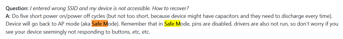

    Rate: 12878
  • #25 21452541
    geoffreymoga
    Merci, ça fonctionne.

    I'm new here. I have some powerplugs from LSC, Hombi and Tuya and also some Chinese mini smart switches.
    I want to control them without using the Tuya cloud.
    My first test is with a mini smart switch, which has a CB2S controller.
    After taking out the CB2S and connecting it to the USB-TTL converter I could do everything until the first part or step 4.
    The last part of step 4 I don't understand. How to start JSON? Where to find the bin file I need?
    Many thanks for your support
  • #30 21625232
    Posts: 14755
    Rate: 12878
    Do a 2MB flash read, if you are lucky, the pinout will be extracted and shown on screen. Does it work for you?
    The bin file for flashing (OBK binary) can be downloaded automatically from Easy Flasher
    What your flasher shows now, do you have 2mb backup?

  • The Wi-Fi module is WB2S with a BK7231T MCU, and the flashing connection uses VBAT, GND, RX, and TX at 3.3 V only. [#20975600]
  • The corrected plug model is 3202088, not 3202087, and the board identifier shared in the thread is WP02GE dated 2023-09-05. [#20976420]
  • The shared OpenBeken pin map assigns 6=Relay, 7=Button, 8=LED, 10=WiFi LED, 11=BL0937SEL, 24=BL0937CF1, and 26=BL0937CF. [#20976420]
  • The extracted configuration includes power-monitoring thresholds of 180 V low-voltage cutoff, 264 V over-voltage cutoff, and a 5 s reset time. [#20975600]

Where can I find the correct pinout and MCU details for the WB2S board before flashing an Action SmartPlug?
You find them on the back of the blue Tuya module and then confirm them in the Tuya datasheet for that board. The guide says to read the module name first, which here is WB2S, then verify that the MCU is BK7231T. The thread also lists the relevant module pins, including VBAT on pin 1, GND on pin 3, UART RX on pin 5, and UART TX on pin 7, which are the key flashing connections. [#20975600]

What is the CEN pin on a WB2S module, and how is it used during backup or flashing?
"CEN is a reset input that reboots the BK7231T/WB2S module when pulled low, letting Easy Flasher catch the bootloader during backup or flashing." In this thread, users use CEN as a manual reset point during UART operations. The WB2S pin table identifies CEN as pin 10, describes it as low-level reset, and notes that it is internally pulled high, so touching it to GND briefly triggers reboot. [#20975600]
How do I trigger reboot on a BK7231T/WB2S module by touching GND to CEN during firmware backup or flashing?
You trigger reboot by briefly shorting CEN to GND exactly when the flasher asks for a reboot. 1. Connect a second wire to the USB-UART adapter’s GND. 2. Start Do Firmware backup (read only) or flashing and wait for the message about getting the bus. 3. Touch that GND wire to the module’s CEN pin momentarily. In the thread, this is the specific workaround that solved repeated “Getting bus failed” errors on model 3202088. [#21252494]
What is an OBK JSON template, and where do I paste or import it after flashing OpenBeken?
An OBK JSON template is the device configuration that maps pins and features so OpenBeken knows which GPIO drives the relay, button, LEDs, and power metering. After flashing, connect to the plug’s temporary Wi-Fi AP, open its web interface, then go to Launch Web App → Import and paste the JSON. The guide says to finish with “clear OBK and apply new script,” which loads the saved configuration onto the flashed plug. [#20975600]
How do I get the JSON pin configuration from a 2MB firmware backup in Easy Flasher or OpenBeken flasher?
You get it by reading the original firmware first, because the flasher can extract the pinout from that dump. A later reply states that a 2 MB flash read may automatically show the pin configuration on screen. The original guide uses the same flow: run backup (read only), save the extracted JSON, then reuse it after flashing. If the extraction succeeds, you do not need to build the pin map manually. [#21625232]

What’s the difference between model 3202087 and 3202088 for the Action LSC SmartPlug, and why does the correct model number matter?
The thread corrects the device to 3202088, not 3202087, and that matters because device listings, search results, and template matching depend on the exact model. A moderator note says the photos show 3202088, and another reply confirms that 3202087 refers to a different topic. The OpenBeken device entry was then updated so the correct plug appears in the searchable devices list under the right name. [#21030307]

How do I recover access to an OpenBeken-flashed smart plug after entering the wrong IP settings and losing the web interface?
You can recover it through the built-in OpenBeken recovery method rather than reflashing from scratch. In the thread, a user lost access after entering the wrong IP settings, could still see the plug on the router, and then restored access using the recovery guidance linked from the OpenBK7231T App FAQ. The follow-up reply confirms the fix worked, so the documented recovery path is the correct first step for misconfigured network settings. [#21451892]

Where is the CEN pin on the WiFi PCB of the Action LSC SmartPlug 3202088, and what baud rate should I use for flashing?
The thread identifies CEN from the WB2S documentation, not from a final annotated photo of the 3202088 PCB, and it does not state any baud rate. The WB2S pin table in the guide says CEN is pin 10 and labels it as the reset pin. For the 3202088 board, the practical advice is to locate CEN by matching the module to the official WB2S pinout, especially because some modules may have misleading silkscreen markings. [#21835018]
