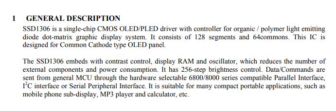

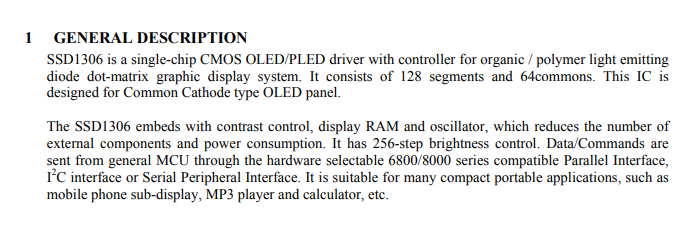

    From the introduction, I guess what surprised me the most is that according to the manufacturer, this display fits an additional mobile phone display.... this must be from many years ago, anyone seen such a phone?
    OLED display module 0.91 SSD1306 128x32 I2C - how to run with Arduino? How to connect?

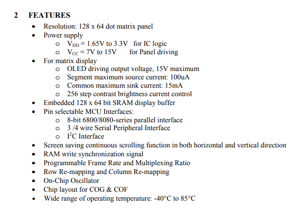

    The SSD1306 has an embedded 128 x 64 bit SRAM, used for pixel storage. Here we only control the pixel's light state, on or off. In addition, we can control the brightness level of the entire display. The SSD1306 has three interfaces, which we select on its pins: 8-bit 6800/8080, 3/4-line SPI and I2C. In addition, it offers a programmable horizontal and vertical scrolling effect and allows row and column remapping.

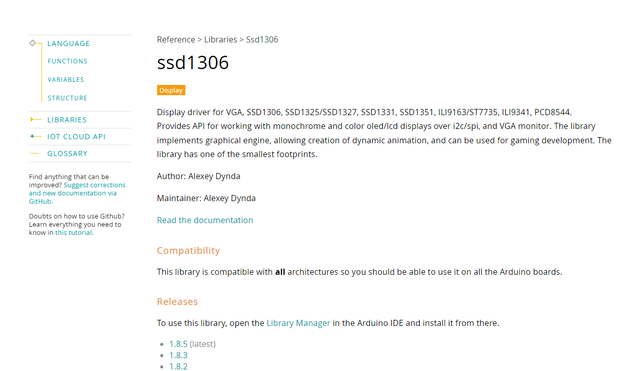

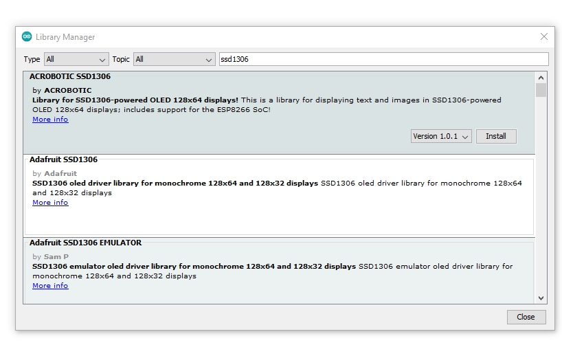

    Fortunately, we do not have to implement communication with the SSD1306 from scratch. We start the adventure by selecting a library:

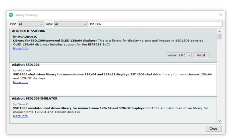

    I chose the library from lexus2k.
    In the Arduino IDE it is available to install in Libraries:

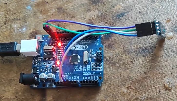

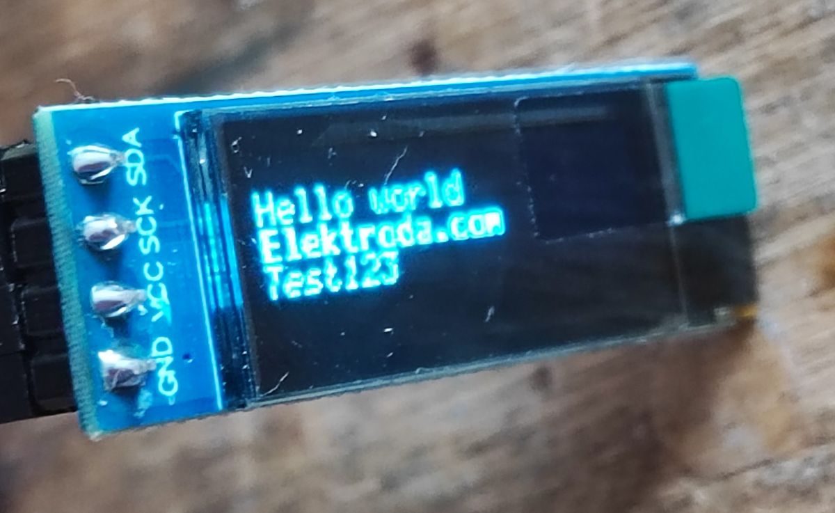

    I connected the whole thing to the I2C lines from the Arduino, and of course ground and power too. I didn't need to give pull-up resistors to make it work, as they are already on the PCB.
    Result:
    It works, but the demo is quite substantial, so we'll try to break it down into parts and discuss.

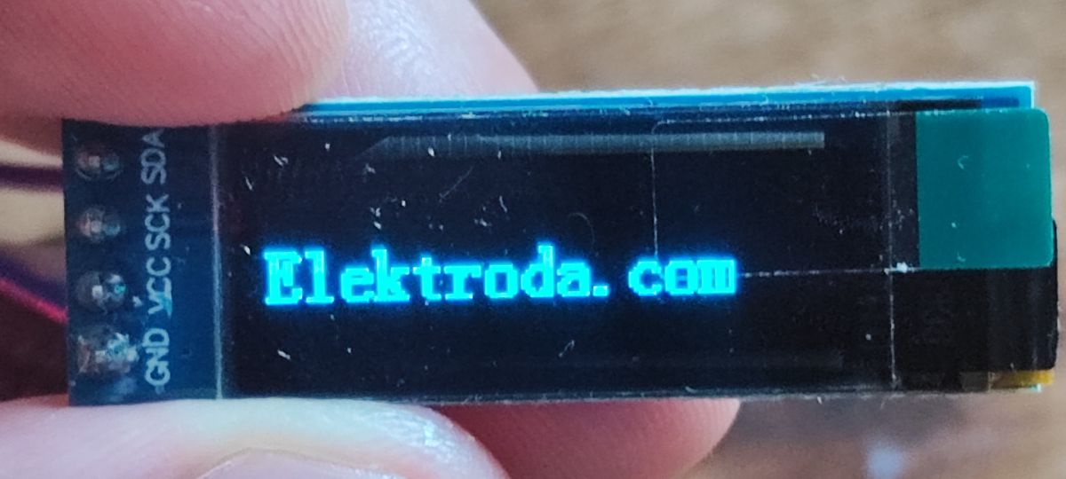

    First - attach the header and initialise the display. You can also set the font:
    Code: C / C++
    Then, in a loop, you can, for example, draw text with different font styles on the position we have chosen:
    Code: C / C++

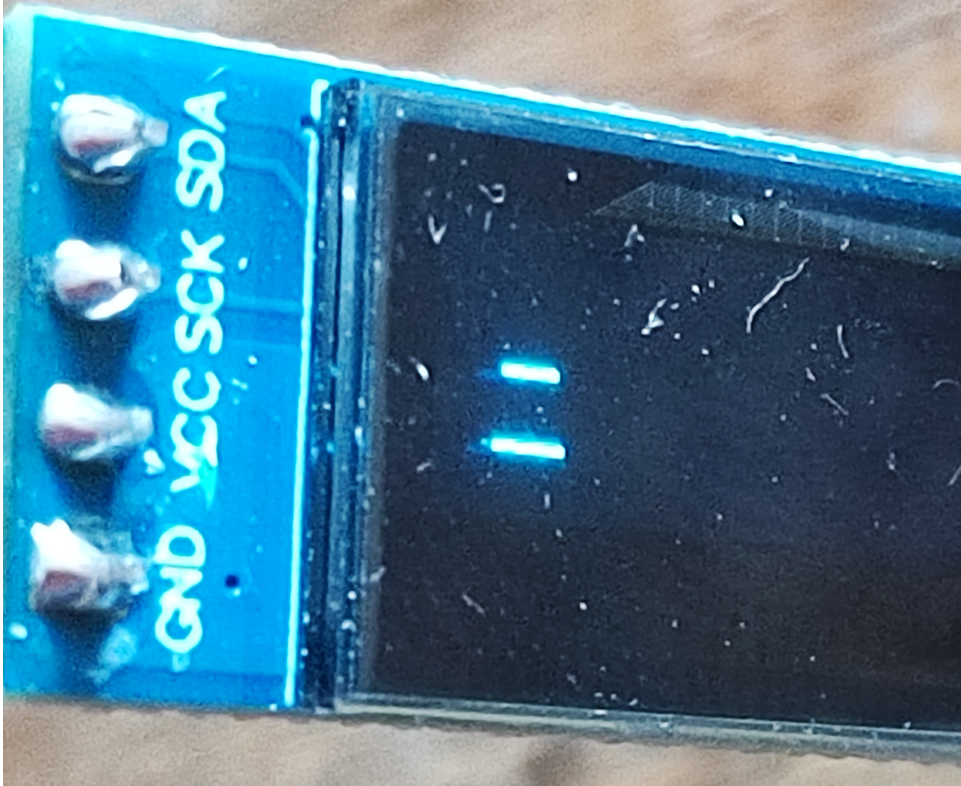

    Similarly, you can draw lines between two points defined as X and Y positions:
    Code: C / C++
    Results:

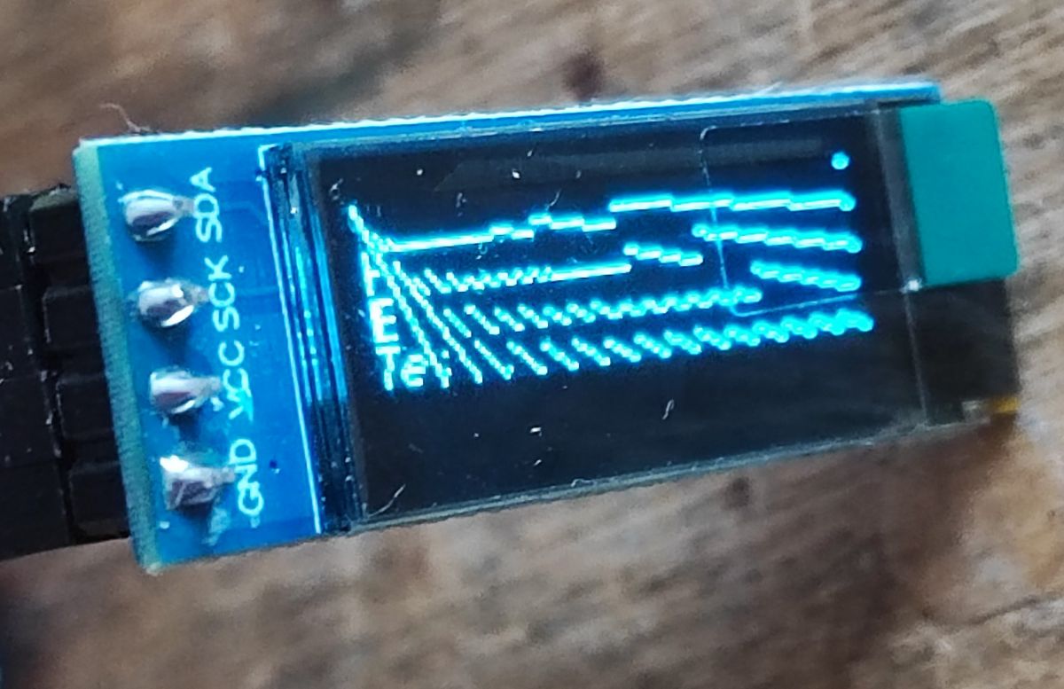

    I don't clean the screen, so lines form on the text:

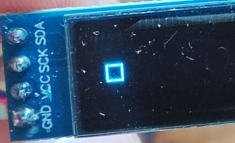

    It's now the shapes. Let's try to make a square to start with. We have a function that draws a rectangle, its first two arguments are the coordinates of one corner and the next two are the coordinates of the opposite corner.
    Code: C / C++
    Result:
    NOTE: The coordinates of the second corner must be larger than the first corner. For example, if you enter the first Y larger than the second Y, the corresponding sides will not show:

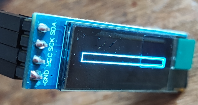

    It's now a rectangle:
    Code: C / C++
    Now we can extend the idea and make a loading bar. Every fixed period of time we draw inside the first rectangle another increasing rectangle. We do not clear the whole screen. The first rectangle (frame) is on the screen all the time.

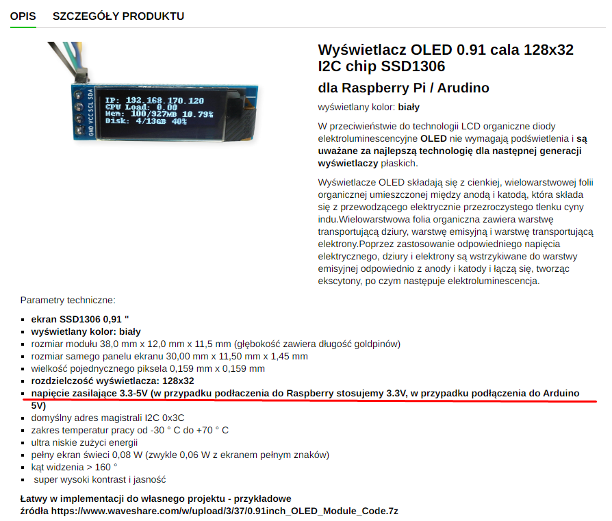

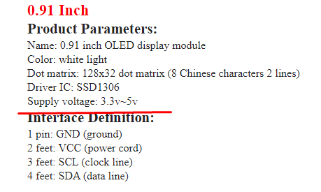

    On the other side of the board (pictures on ali) is a 3.3V stabiliser for the matrix logic. The power supply for the matrix (according to DS) is from 7V and it works with a 5V supply (arduino). I wonder how to supply 3.3V (short out the stabiliser).
  • #3 21244565
    Posts: 14439
    Help: 650
    Rate: 12406
    Information from vendors suggests that this will run normally on 3.3V:

    information from vendors suggests that this will run normally on 3.3V:
    The problem is the lack of conversion on the control lines. 5V can whip them up.
