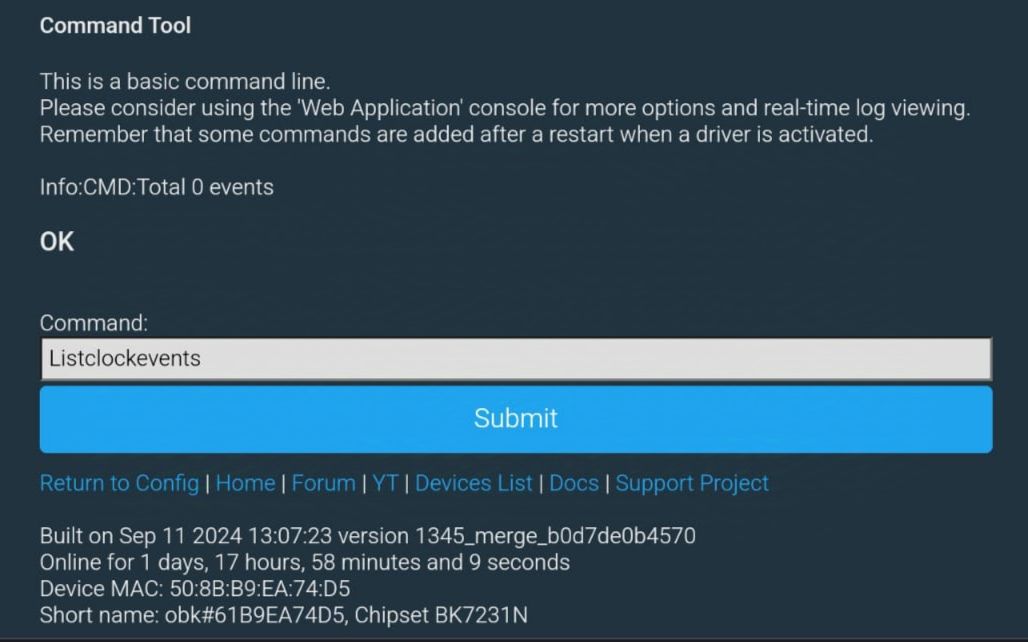

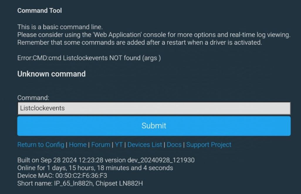

    Hi all,
    With activated chart driver I get this msg after call listclockevents:
    Error:CMD:cmd Listclockevents NOT found (args )

  • #2 21246669
    Posts: 14797
    Rate: 12954
    Excuse me, but does it work without activated charts driver?
    Listclockevents seems to be present in drv_ntp_events.c which may not be enabled by default on some platforms. You may need to modify obk_config.h yourself and get custom online build in order to use that: https://www.elektroda.com/rtvforum/topic4033833.html

    It seems not a general problem.
    In my pictures you can see two different situations,
    that are two different versions and two different microcontrollers.
    Screenshot of a command line tool displaying the command Listclockevents with a Submit button. Screenshot of a command tool with error Listclockevents NOT found.
