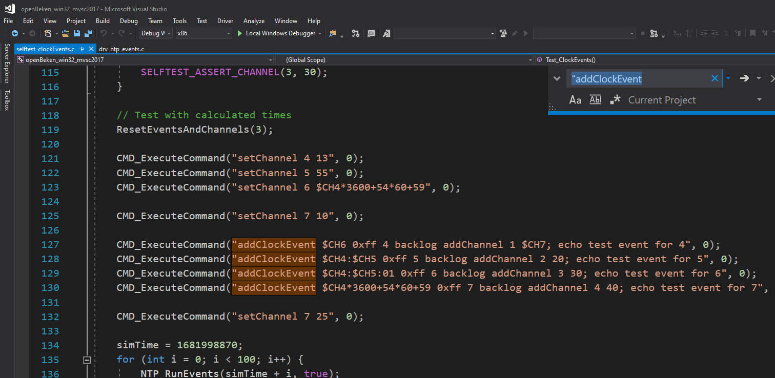

    I have another "reboot" scenario with OpenBK scripting, this time trying to give an off pulse of a few seconds at a configurable time.
    I'm attempting to use a clock event to turn off the relay like this:
    addClockEvent $CH5:$CH7 0xFF 567 turn_off_relay
    with the CH5 and CH7 being configurable from the GUI, but I'm guessing from its behavior that the $CH5 and $CH7 are not being expanded. If I put in a readable time like 18:23 it works just fine.
    I can of course just change the code to set a new time, but I'd like the client to be able to adjust this themselves.
    Could someone confirm whether this expansion is possible somehow with the existing codebase? I haven't yet dug into the parser and interpreter enough to see how it's done.
    Thanks!

    I think it's disabled, but I can look into it.
    Alternatively, maybe a custom simple C code can help? Have you seen:
    https://www.elektroda.com/rtvforum/topic4056286.html
  • #3 21151728

    I checked the automatic self-test code and apparently addClockEvent already expands vars at the start:
    C code in the Visual Studio editor with functions related to addClockEvent.
    So your issue must be somewhere else...

    Thanks for checking! I hadn’t thought to look at the test code 🤦‍♂️
    I’ll double-check the firmware version. Maybe I’m out of date. The calls to addClockEvent didn’t seem to be showing up in the log, even at Debug level, but the version with the explicit time did.
    If it turns out that there are code changes I’ll repost the script, but I hope it’s just firmware. Either way, I’ll let you know what I find.
    Thanks again, as always!
