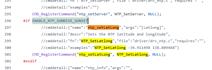

    Screenshot of source code in C language, featuring a conditional command for ENABLE_NTP_SUNRISE_SUNSET.
    ENABLE_NTP_SUNRISE_SUNSET seems to be enabled on Beken, are you really sure?

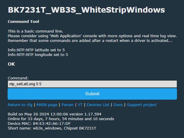

    Does the ntp_setLatLong command work if you use it at runtime from console?
    EDIT: I have this command on my build..
    Screenshot showing the Command Tool interface for the BK7231T device.

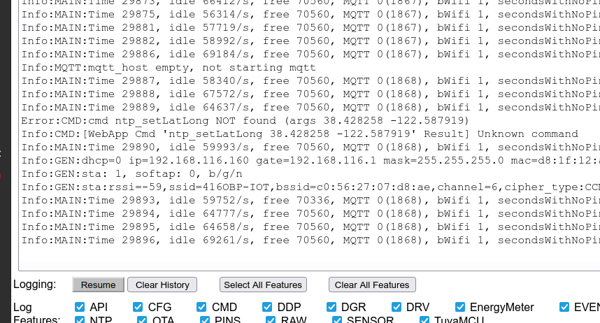

  • #5 21294934
    agarg
    Posts: 9
    No, it fails on command line on my build.
    I am using :
    OTA
    Chipset: BK7231N
    Build: Build on Aug 29 2023 06:16:18 version 1.17.230
    Screenshot of an interface displaying system logs with various network status and configuration information.
    Added after 56 [minutes]:
    >>21294810
    I upgraded to a newer build and now it is working. I suspect, the build on my switch did not have it.
    Sorry for the confusion.
