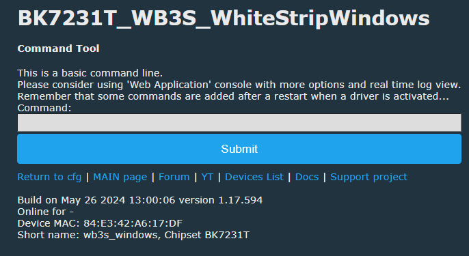

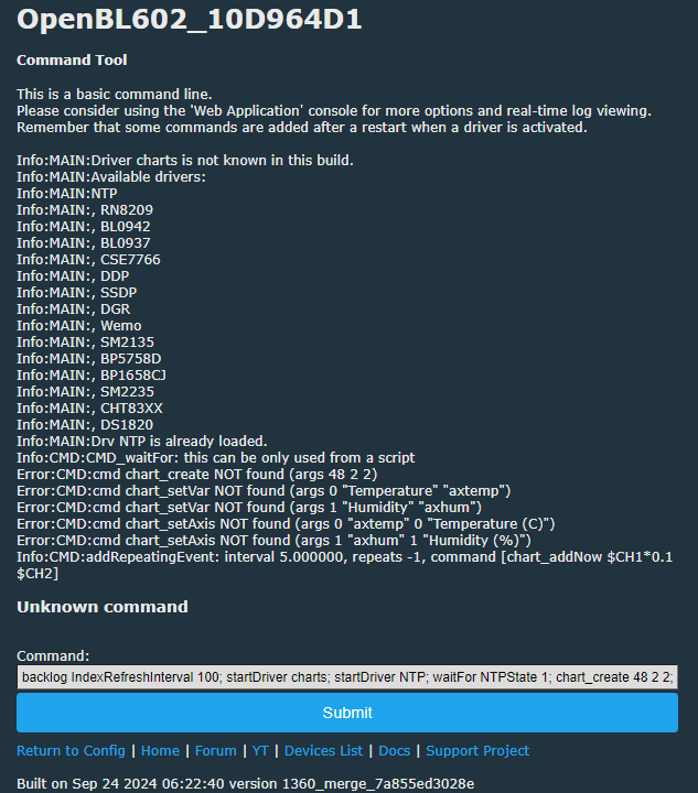

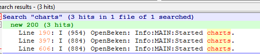

    Let's start with checking if your build has "charts" driver:
    Screenshot of the BK7231T_WB3S command tool indicating missing charts driver.
    If it's not present, set the ENABLE_DRIVER_CHARTS to 1 in obk_config.h for the platform of your choice by following paragraphs "Per-Pull Request Builds" and "Customizing your own build" in this guide to get your custom build made online (no toolchain required):
    https://www.elektroda.com/rtvforum/topic4033833.html#20946719
    Ok, now I assume that you have "charts" driver in your build.

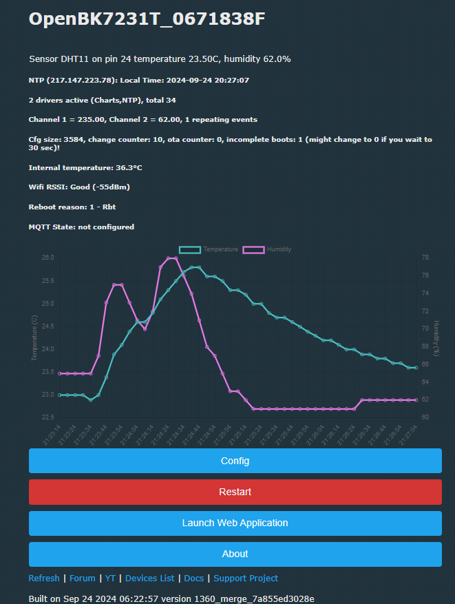

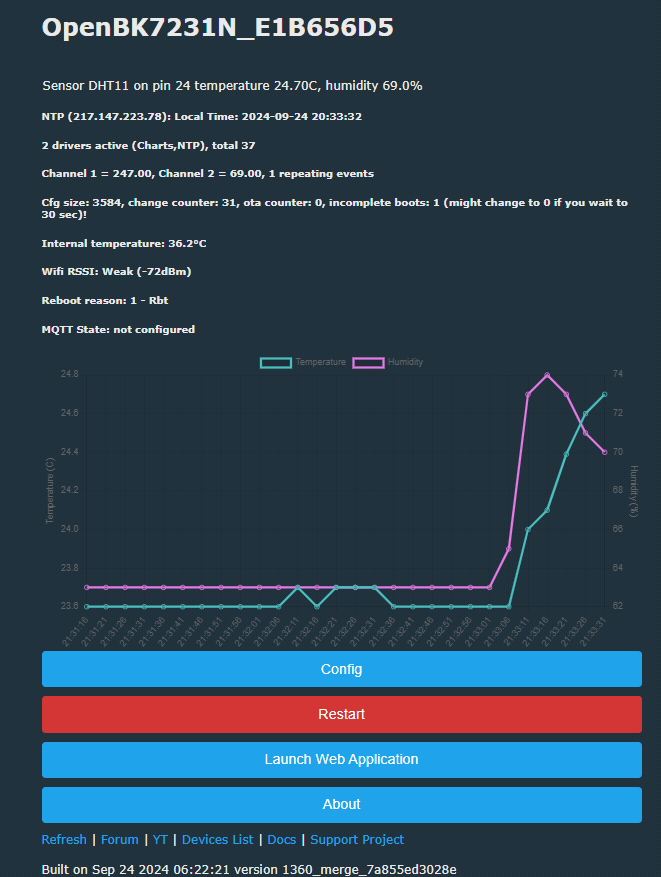

    And then we can build upon that. Here is a full code for DHT11 demo:
    // DHT11 setup
    IndexRefreshInterval 100000
    startDriver charts
    startDriver NTP
    waitFor NTPState 1
    chart_create 48 2 2
    // set variables along with their axes
    chart_setVar 0 "Temperature" "axtemp"
    chart_setVar 1 "Humidity" "axhum"
    // setup axes
    // axis_index, name, flags, label
    chart_setAxis 0 "axtemp" 0 "Temperature (C)"
    // flags 1 means this axis is on the right
    chart_setAxis 1 "axhum" 1 "Humidity (%)"
    // every 60 seconds, -1 means infinite repeats
    // assumes that $CH1 is temperature div10 and $CH2 is humidity
    addRepeatingEvent 60 -1 chart_addNow $CH1*0.1 $CH2
    And here is sample output (from @divadiow , thank you for testing):
    Temperature and humidity chart from DHT11 sensor
    As you can see, our charts driver can work well with DHT11.
    Remember that you can hover mouse over datapoint
    If you are not sure what is the value of given datapoint, you can always hover mouse about it to get more details:

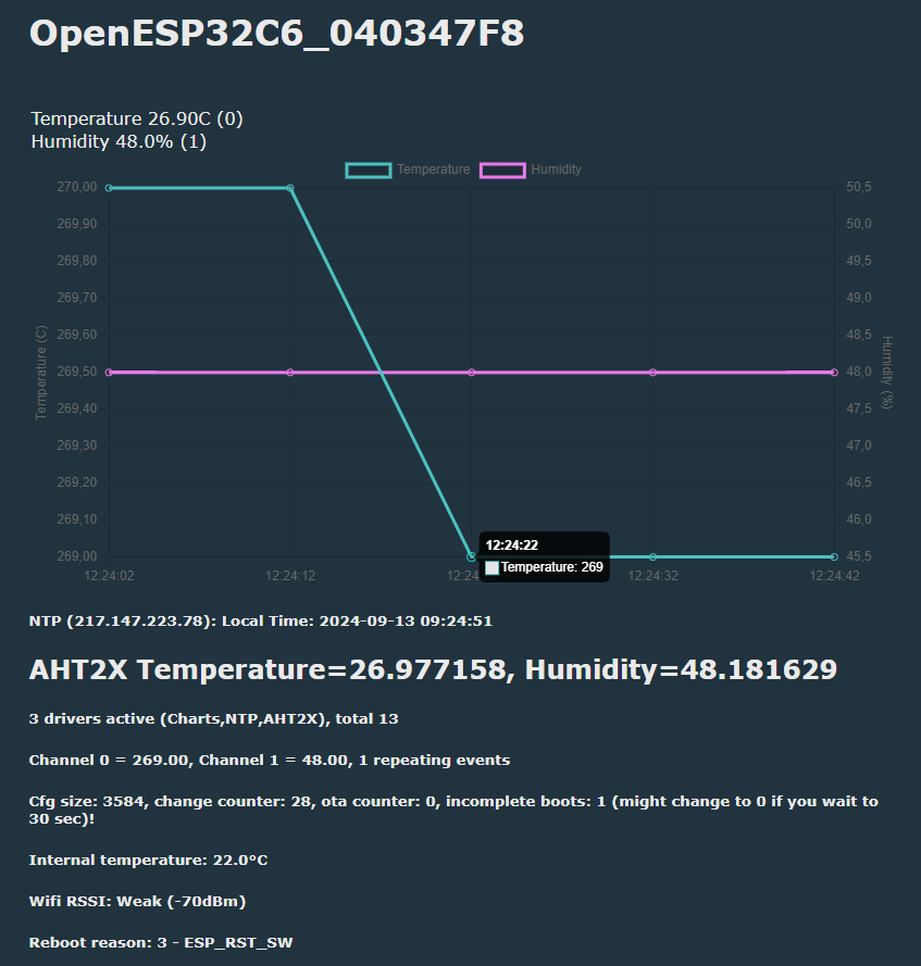

  • #3 21224054
    Posts: 14663
    Help: 656
    Rate: 12679

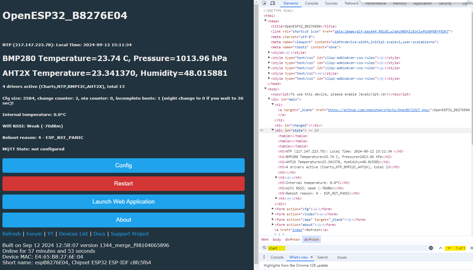

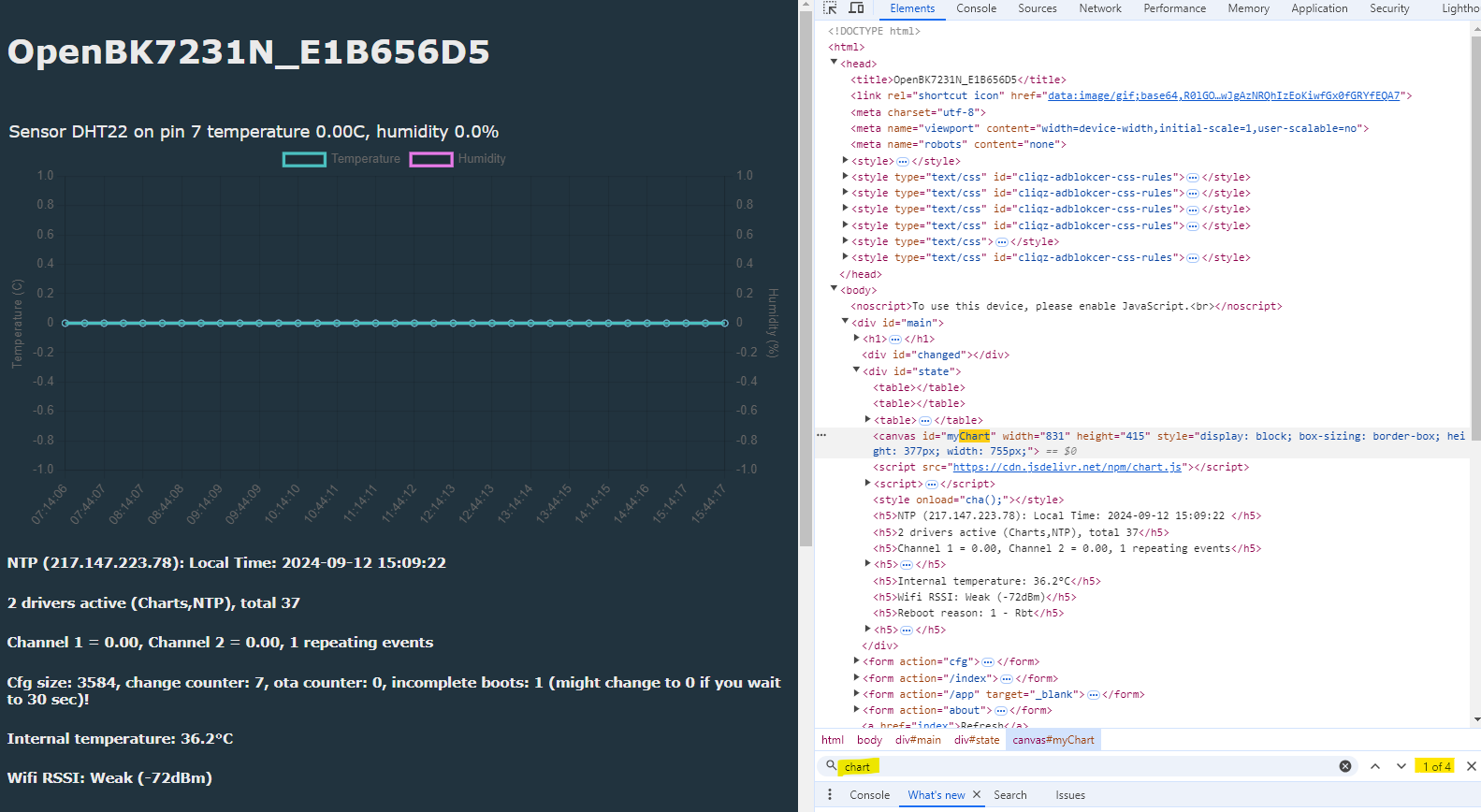

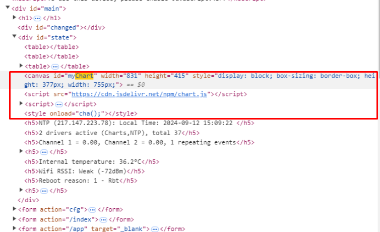

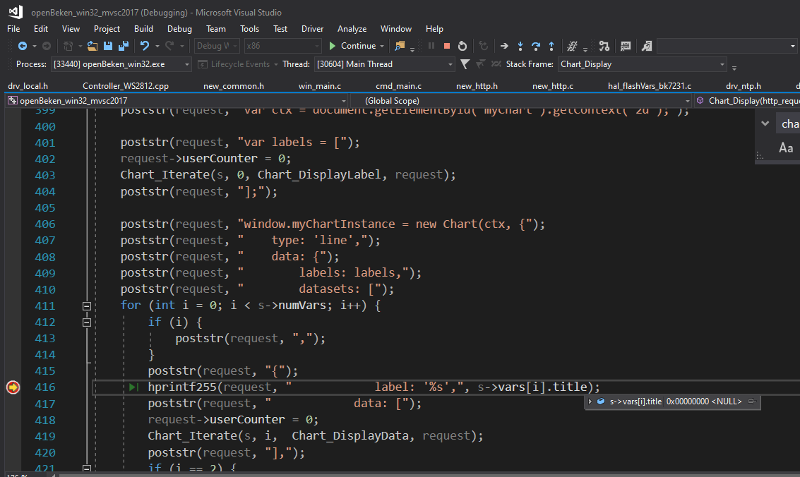

    The div called "state" should contain canvas and script elements which I marked on your Beken device screenshot:
    Screenshot showing an HTML element with a chart canvas and script.
    The following elements are generated DRV_Charts_AddToHtmlPage in drv_charts.c:
    https://github.com/openshwprojects/OpenBK7231T_App/blob/main/src/driver/drv_charts.c
    Those elements are generated if two conditions are met:
    - charts driver must be running, so DRV_Charts_AddToHtmlPage is called
    - a chart (g_chart global variable) must be present
    So, either DRV_Charts_AddToHtmlPage is not called in ESP32 fork or g_chart is not created.
    I can also see on your screenshot that the DRV_AppendInformationToHTTPIndexPage is most likely called for drivers, because I can see driver-specific fields in state div.
    So maybe somehow chart_create was not called for you? Maybe autoexec.bat is not run or suffers whitespace issues?
    Try calling :
    chart_create 48 2 2
    directly in OBK command line, and not in the autoexec.bat, does anything changes?
    Screenshot of the Command Tool interface for BK7231T_WB3S_WhiteStripWindows.

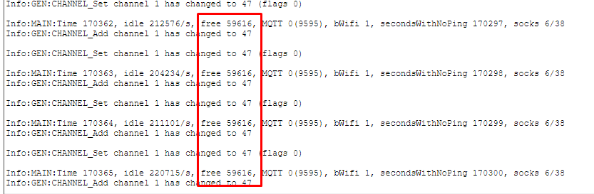

    If not, then maybe malloc fails? What does the periodic log says in the web app, how much memory is left free? For me, on my test BK7231, there is abut 60kB free at the moment.
    Screenshot of an application log showing free memory and channel changes.
  • #4 21224291

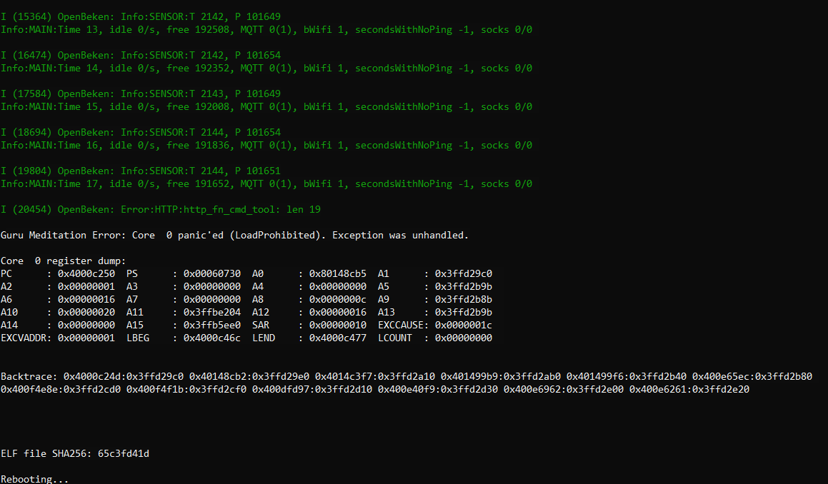

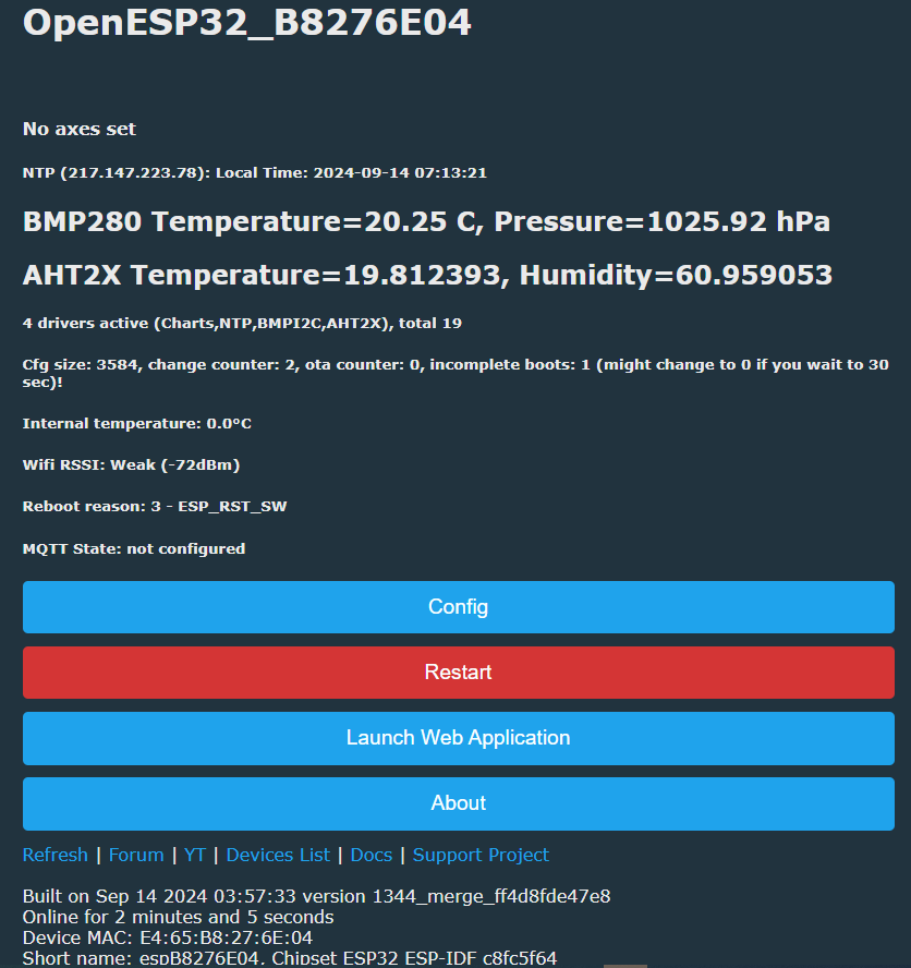

    free space seems OK. If you run that command on its own on command line you get a panic and reboot
    Screen showing OpenBeken system error messages, including core 0 panic and register dump details.
    Added after 7 [minutes]:
    if you scale the autoexec back a bit to
    chart_create 48 2 2 still creates a panic
    Added after 6 [minutes]:

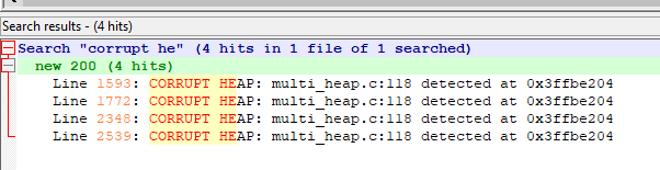

    this in logs at crash time
    Screenshot showing a search for corrupt he with results indicating heap memory errors.
    Added after 11 [minutes]:
    I dont think this is the issue. I've sanitized text and can see drivers starting
    Screenshot showing search results for the term charts in a text editor.

    >>21224291 chart_create 48 2 2 still panics, but you shouldn't use chart_setVar and chart_setAxis before chart_create. They don't have a null check, and so when they try to write, it will crash.
    It can be seen at EXCVADDR on the screenshot.
    The address which has been written/read is found in the EXCVADDR register in the register dump. If this address is zero, it usually means that the application has attempted to dereference a NULL pointer. If this address is close to zero, it usually means that the application has attempted to access a member of a structure, but the pointer to the structure is NULL.

    >>21224687 Done a little testing, using charts_create 10 1 1
    If called a second time, without setvar/setaxis, it tries to free a null pointer
    I (174333) OpenBeken: s is not null
    I (174333) OpenBeken: s->axes is not null
    I (174333) OpenBeken: freeing s->axes[0].label
    CORRUPT HEAP: multi_heap.c:61 detected at 0x40828a64

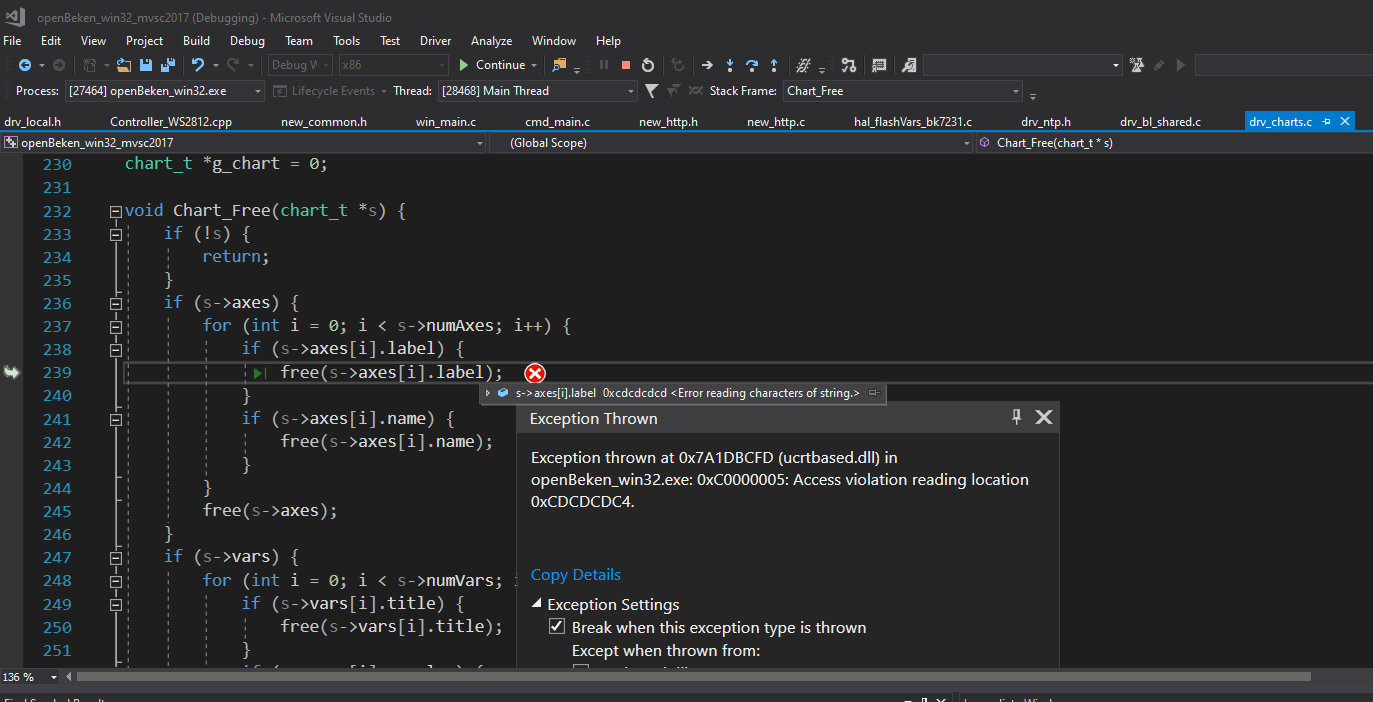

    I see, my testing didn't cover this specific situation, but now I can reproduce it:
    Screenshot of Microsoft Visual Studio with C code marked with an error related to reading characters from a pointer variable.
    Let me check...
    0xcdcdcdcd indicates that I forgot to ZeroMemory the allocated block and in release it would contain random garbage.
    To be 100% precise, not a NULL pointer, because that was checked, but an unitialized pointer with random value.
    Added after 5 [minutes]:
    Ok, pushed a fix.

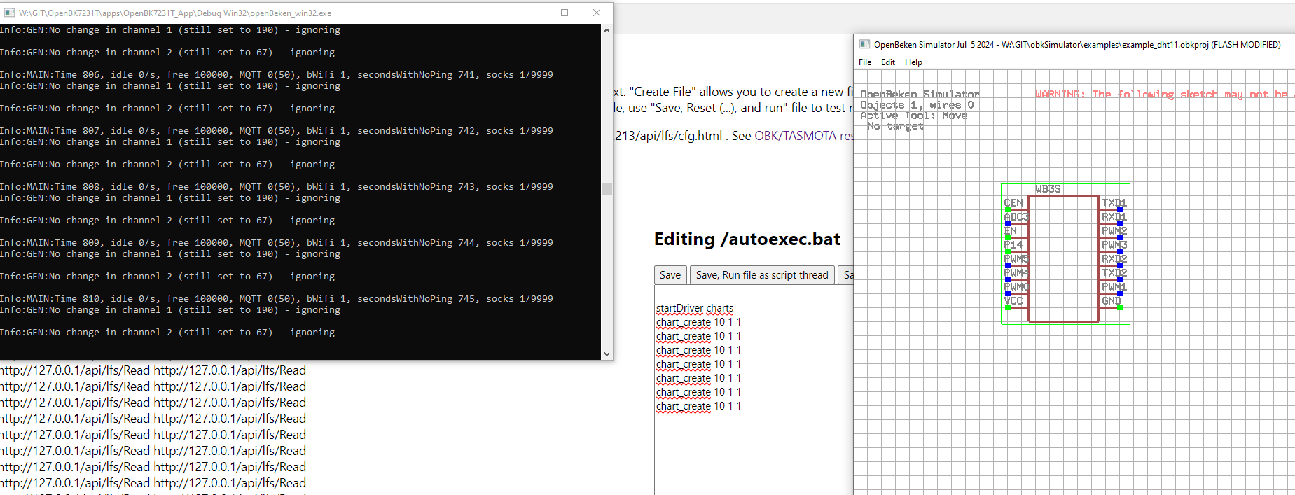

    I am unable to reproduce this issue, however I've tried only on Windows:
    OpenBeken simulation with code and error console.
    I've also pushed a fix for a rare case when malloc fails during chart creation.

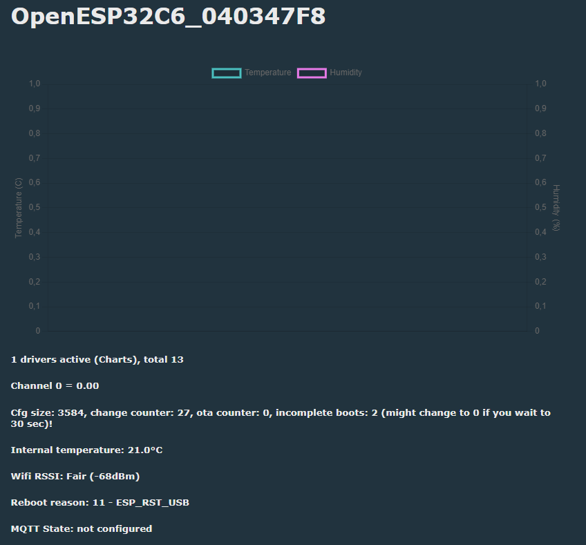

    With last patch - creates ok, even chart_create 24 2 2, but as soon as i request main http page - it crashes
    with all set
    View of the OpenESP32C6 control panel with temperature and humidity charts.
  • #12 21224744
    Posts: 14663
    Help: 656
    Rate: 12679
    But you didnt' set axes, right?

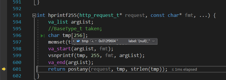

    I guess your platform doesn't like NULL in vsnprintf:
    Screenshot of Visual Studio code editor with highlighted code for chart label.
    On Windows, it's tolerated and does not crash. Okay, let me secure it now.
    Screenshot of a code snippet in an IDE.
    Trust me, being able to run OBK on Windows is a blessing.

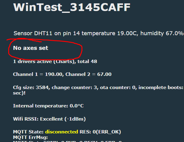

    Ok added check:
    Screenshot of a system test named WinTest_3145CAFF with an error No axes set highlighted.

    >>21224744 Without patch, just preconfigured axes/vars
    Spoiler:
    Chart displaying temperature and humidity data from an OpenESP32C6 unit.
    evaluating $CH0*0.1 isn't working, it just adds to chart as $CH0
    startdriver aht2x 0 1 0 1
    startDriver charts
    startDriver NTP
    waitFor NTPState 1
    chart_create 48 2 2
    addRepeatingEvent 10 -1 chart_addNow $CH0*0.1 $CH1
  • #14 21224804
    Posts: 14663
    Help: 656
    Rate: 12679
    The following observation indicates that you may be missing ability to expand variables (or, whatever they are called). Do you have:
    #define ENABLE_EXPAND_CONSTANT		1
    enabled for your platform?
    If that's your OBK config:
    https://github.com/NonPIayerCharacter/OpenBK7231T_App/blob/_esp_idf/src/obk_config.h
    Then I guess not.

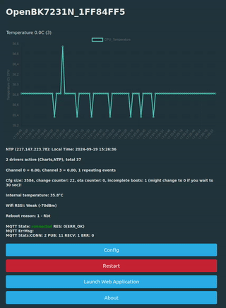

    Finally I had some time to check out this driver and I hope it's o.k. to give some feedback or proposals:
    At least for me the chart is never refreshed, to be exact, the graph is refreshed, but only with the data present at time of the last page refresh - tested in Firefox and Chromium.
    I struggled with the same issue with my graph: if a JS variable is changed in the XMLHttpRequest, it seems that if you later use the variable, it still has the original value. Don't know if it is cached, it's not intended to work this way ...
    Do you have the same situation? I "solved" this by separating the values from JS code, putting them into a (hidden) input field and using the input elements value as input to the chart.
    I would suggest to put the JS code for the chart outside the "state" div:
    Now you e.g. load the external chart.js source every time the page status is renewed. If you only put the "data" there and refresh the graph this should work with heavily reduced traffic.
    Furthermore for me it's kind of annoying, that the graph is "animated" - every second the graph is redrawn and the points "move upwards" from the x axes...
    User interface with CPU chart and buttons in OpenBK7231N application
    For some of the points I made a PR, didn't find the time to change the position of the graph "outside" the state-div yet.

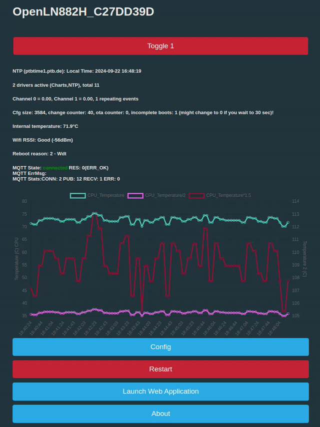

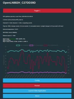

    I just made another change to "move" the chart on the webpage - now it's "below" the "state"-div and will not be replaced on every load of "state".
    In https://github.com/openshwprojects/OpenBK7231T_App/pull/1358, also containing the ringbuffer change.
    Now the graph is "smoothly" animated and not flickering anymore (at least here).
    Image is at 10x speed
    OpenLN882H application interface displaying CPU temperature graph

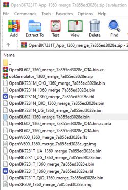

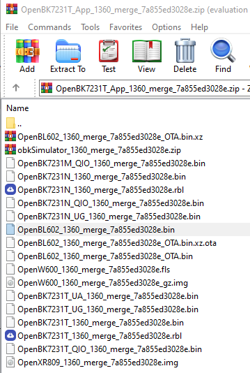

    Screenshot of the OpenBK7231T interface with a temperature and humidity chart. Screenshot of the OpenBK7231N interface with temperature and humidity charts.

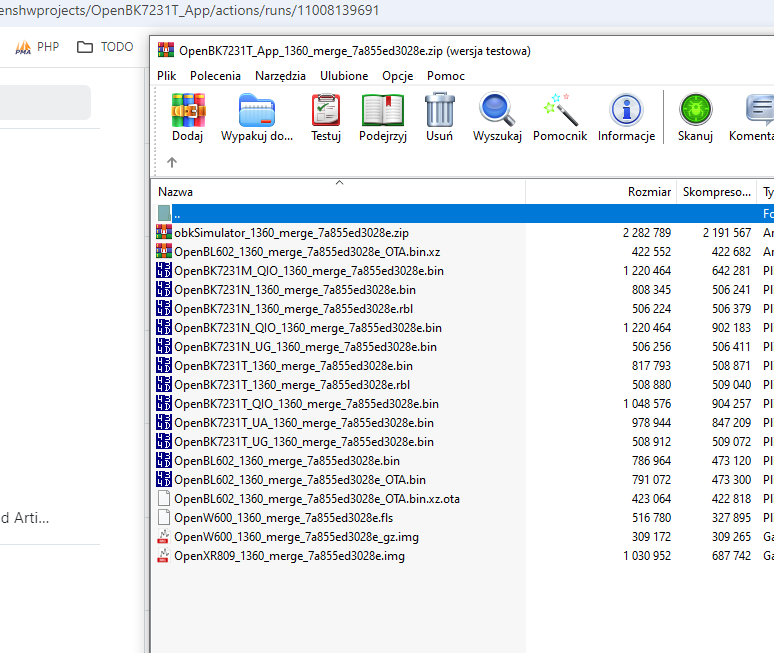

    so hang on, which have Charts driver in that PR?
    Screenshot of a file archive displaying the contents of a ZIP file with multiple binary files.
    Screenshot of the OpenBL602_10D964D1 command tool displaying a list of available drivers and errors related to chart commands.
  • #27 21238516
    max4elektroda
    Posts: 756
    Help: 48
    Rate: 187
    Good morning,
    thanks for testing. Sorry, I didn't set "#define ENABLE_DRIVER_CHARTS 1" for BL602 in this PR.
    For the brave tester, I will attach the version for BL602 together with the files for platforms needing an additional entry for
    scr/driver/drv_charts.c
    in the Makefiles (W600, W800, LN882H).
    But since the changes are made in HTML / JS part, I would expect it should work on all platforms, if it's working on Beken ones...
    Thanks again!
    • dev_20240925_033504.zip (4.27 MB) You must be logged in to download this attachment.

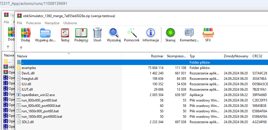

    @max4elektroda , by the way, did you see Simulator build? It's now available as exe in Releases and you can also test charts there.
  • #29 21238660

    Hmm:
    Screenshot of a file management program showing a list of various files and their details.
    Screenshot of an archive management program showing the contents of a ZIP file with obkSimulator and several DLL libraries.
    Well, for me it looks like it actually is, but maybe you meant something else? It's simulator Windows build with DLLs and examples pulled from:
    https://github.com/openshwprojects/obkSimulator
