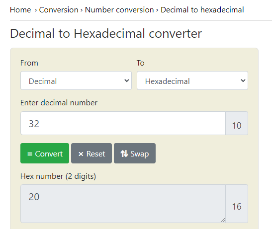

    #5 20767660
    salvoitaly
    Hello p.kaczmarek2,
    I have the following problem with the Week's timer:
    When I add this timer:
    addClockEvent 12:00:00 0x16 1 power on
    the socket is switched on at 12:00 on Thursday.
    Everything is OK as far as it goes.
    If I insert this timer:
    addClockEvent 12:00:00 0x32 1 power on
    then this timer is also activated on Thursday.
    Why not Friday?
    Am I doing something wrong?
    Are these WeekDayFlags correct?
    Sunday = 0x01
    Monday = 0x02
    Tuesday = 0x04
    Wednesday = 0x08
    Thursday = 0x16
    Friday = 0x32
    Saturday = 0x64
    Thank you, and thank you for your very good work
  • #6 20767676
    Posts: 14767
    Rate: 12906
    You are using hexadecimal notation incorrectly. If you want to have decimal 32, please write:
    That is, 32 decimal is a 32 without any prefix.
    If you want to have hex 32, then you write:
    See:
    Screenshot of a decimal to hexadecimal converter with a result.
  • #7 20767702
    salvoitaly
    Thank you very much.
    I thought I had made a mistake somewhere.
    Thank you
