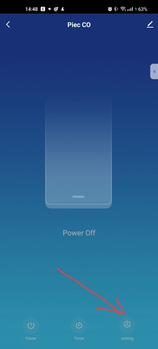

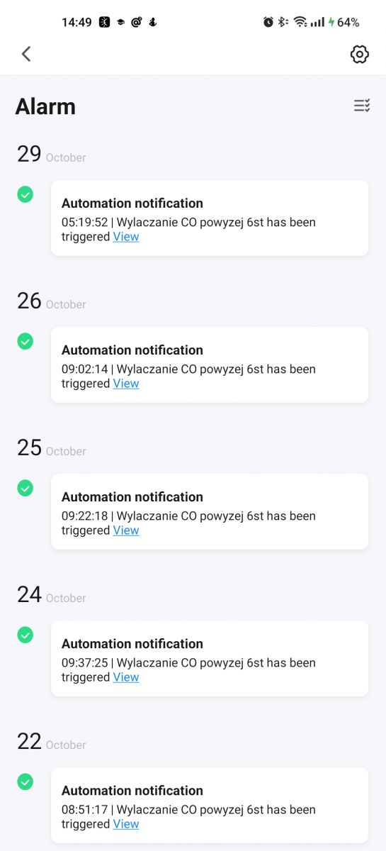

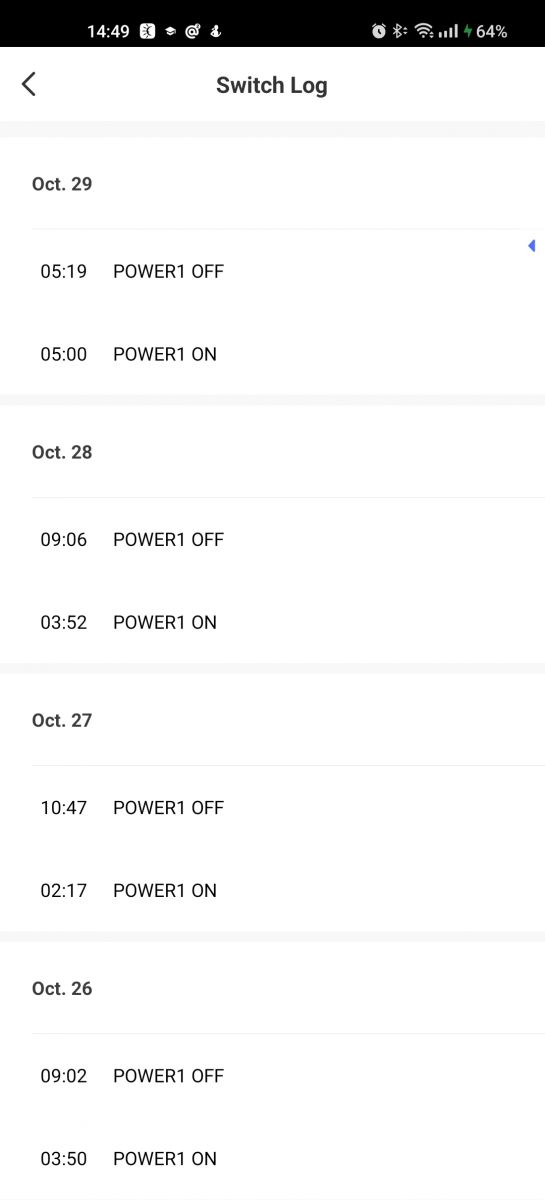

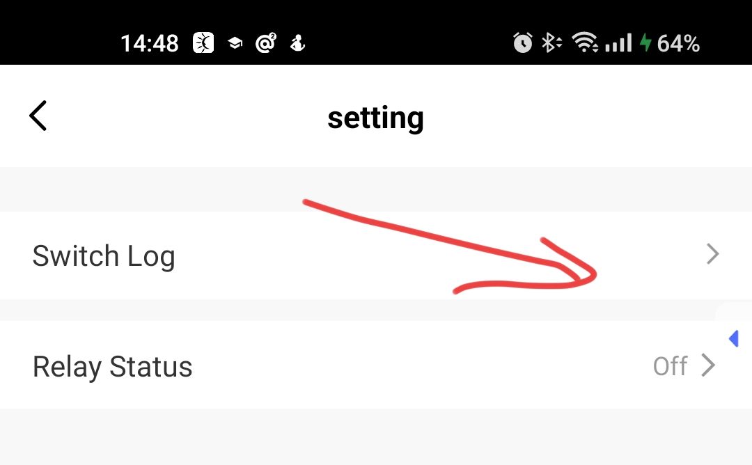

    Every device seems to enable this. You can always even generate additional information for the "Message centre".
    Which Smart Life WiFi switch or plug records on/off status history in the app? .
    "Switches" also have a "switch log".

    Indeed, thanks a lot, I had forgotten about the existence of the alarm list :) .

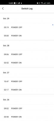

    >>21281393 .
    I've looked at all the smart devices I own and none have the "Switch Log" option you indicated, generating additional information to the "Message centre" throws up an alarm on my phone - so that option is out (I can't turn off alarms because I use them), I'm leaning towards buying a switch that has this log. Can you give me the name of the switch from which you have pasted the screenshot above?

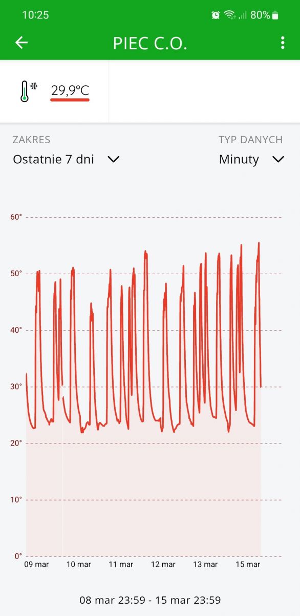

    >>21281369 I have tried various devices on Tuya, Smart Life, but Supla has proven to be the best if you just need an accurate history. I have this in the central heating furnace as in the screenshot, the DS18B20 sensor is in my opinion the best for accurate temperature measurements. I bought one like this: https://allegro.pl/oferta/sonoff-wifi-z-czujn...temperatury-ds18b20-10m-termostat-12132341004
    You have to download Supla but it's not a problem and you have SUPER history: last 24 h, 7 days, 30 days or the whole year, you have a preview or you can export, print etc. I have control. Do a search, as they come with different cable lengths, but in Supla you will match the reading with an accuracy of 0,1'C and a correction - a few degrees.
    Graph of temperature changes in a boiler from the Supla app.
