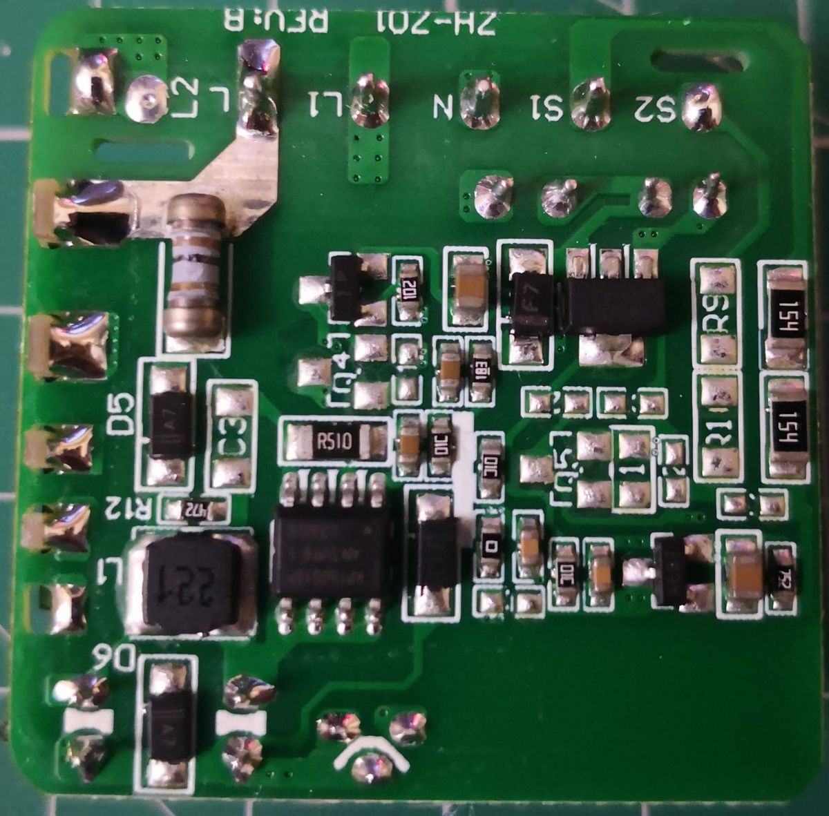

    Controller MCU: WB3S
    Relay: 10A 250V
    Teardown Images
    OKOS 1 Gang Switch with countdown and Remember last power state function - HA OKOS 1 Gang Switch with countdown and Remember last power state function - HA OKOS 1 Gang Switch with countdown and Remember last power state function - HA OKOS 1 Gang Switch with countdown and Remember last power state function - HA OKOS 1 Gang Switch with countdown and Remember last power state function - HA OKOS 1 Gang Switch with countdown and Remember last power state function - HA OKOS 1 Gang Switch with countdown and Remember last power state function - HA OKOS 1 Gang Switch with countdown and Remember last power state function - HA OKOS 1 Gang Switch with countdown and Remember last power state function - HA
    autoexec.bat
    // Relay is connected to pin 6
    setPinRole 6 Rel
    // Set external switch pin
    setPinRole 8 TglChanOnTgl
    // Set led pin
    setPinRole 9 LED
    [inContentAd]
    // Set button pin
    setPinRole 26 Btn
    // Assign pin 6, 8, 9 and 26 to channel 1
    setPinChannel 6 1
    setPinChannel 8 1
    setPinChannel 9 1
    setPinChannel 26 1
    // Set countdown channel
    setChannelType 2 TextField
    // Set countdown channel(2) to 0 when channel 1 state is either 0 or 1
    addChangeHandler Channel1 == 0 setChannel 2 0
    addChangeHandler Channel1 == 1 setChannel 2 0

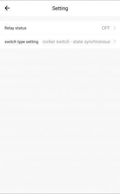

    Restore Startup State
    How to configure switch restore state from home assistant
    In configuration.yaml file, enter the below code
    Code: YAML
    Here, we are defining the configure startup api of OpenBK firmware, this take 3 parameters, 1) IP address of the device, the switch/channel number as index and the state of the switch/channel, this information is provided via automation.
    Next we need to create an input_select helper with 3 values as 1) Off for state 0, 2)On for state 1 and 3)Remember last power state for state -1
    And last, the automation. In automation.yaml file, enter the below code
    Code: YAML
    In this automation, we first do the mapping of the states (0, 1 or -1) based on the trigger ID and pass this information to the reset api. Automation is fired as soon as the trigger state is changed.
