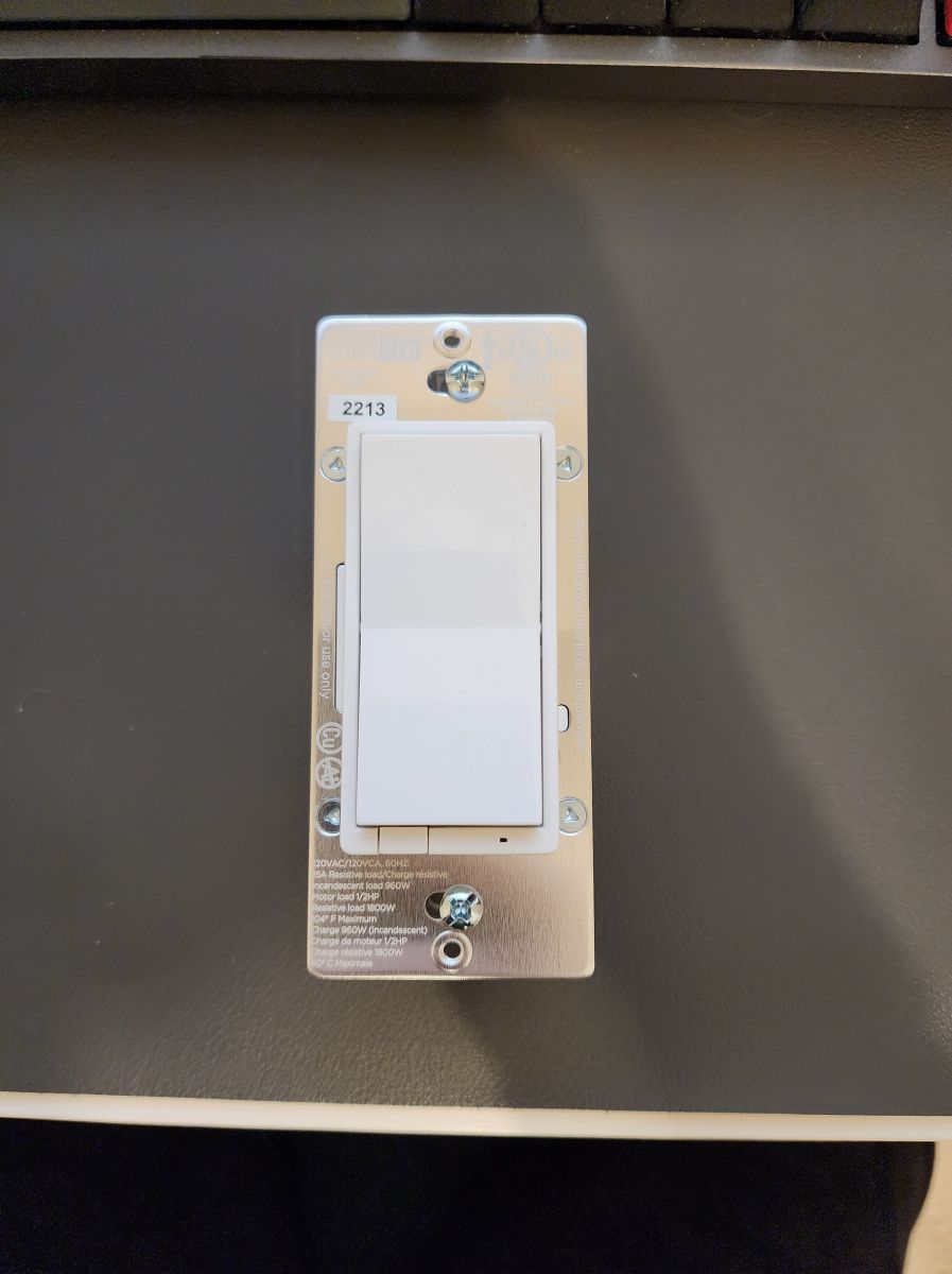

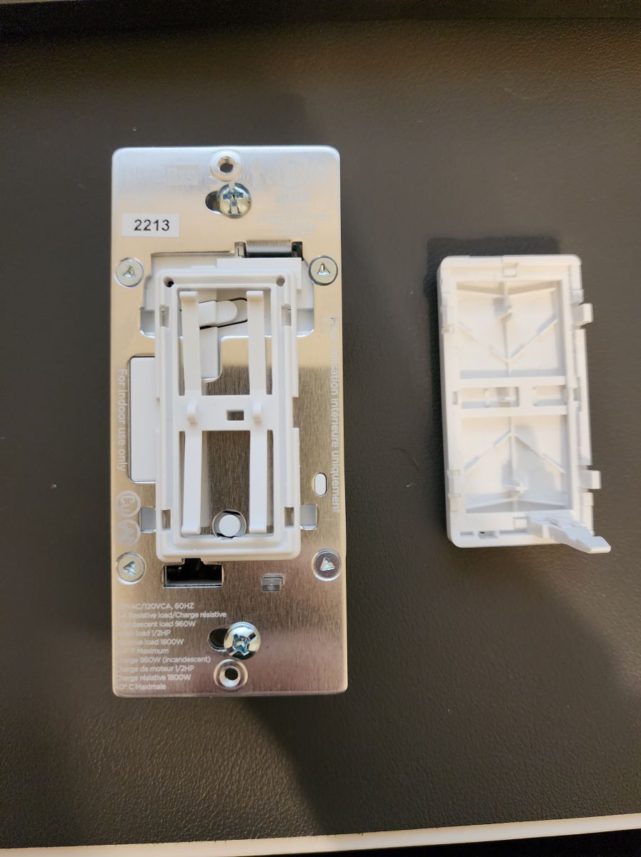

    Teardown:

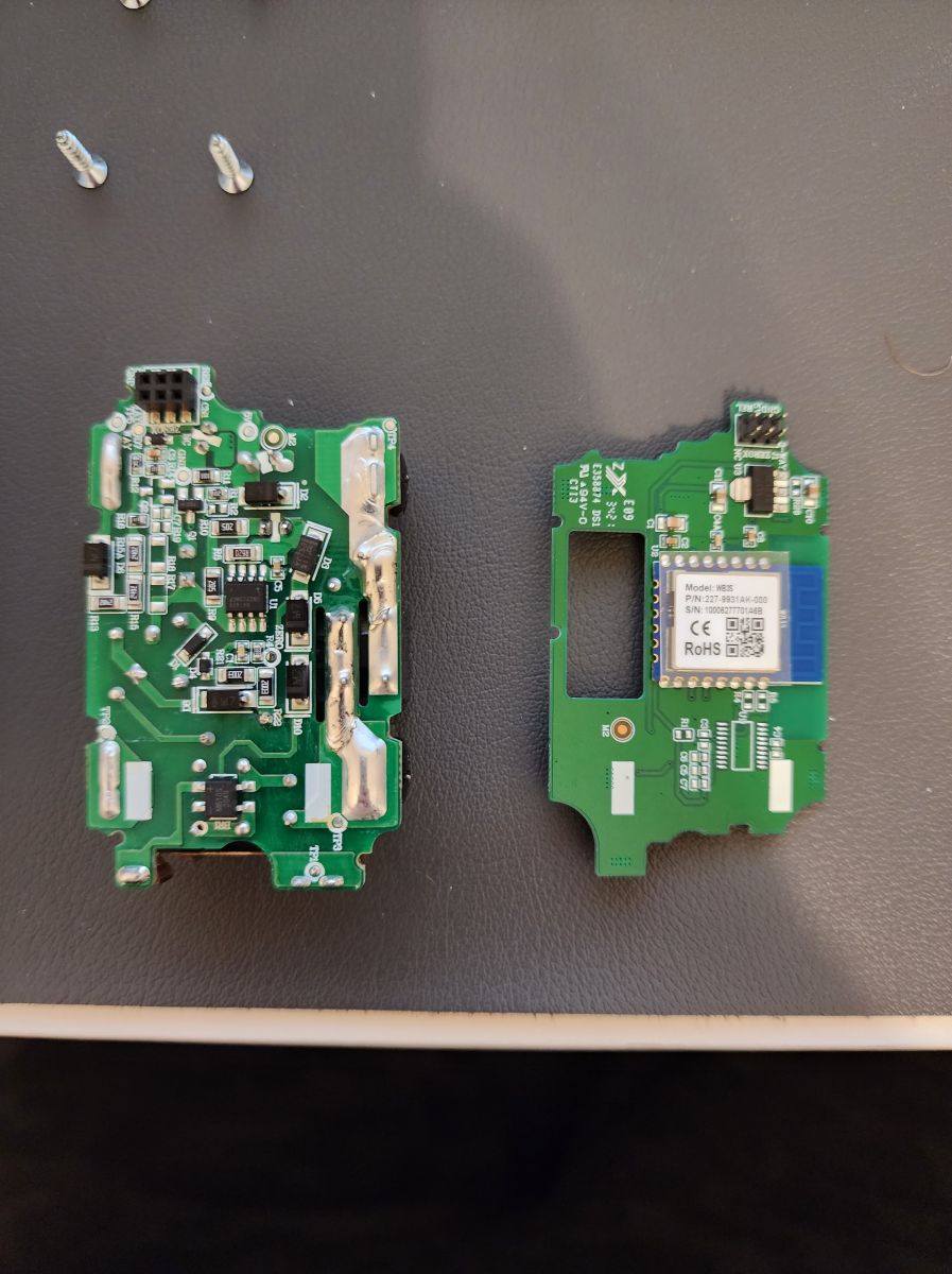

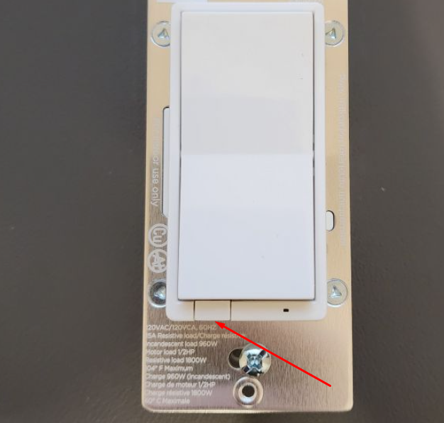

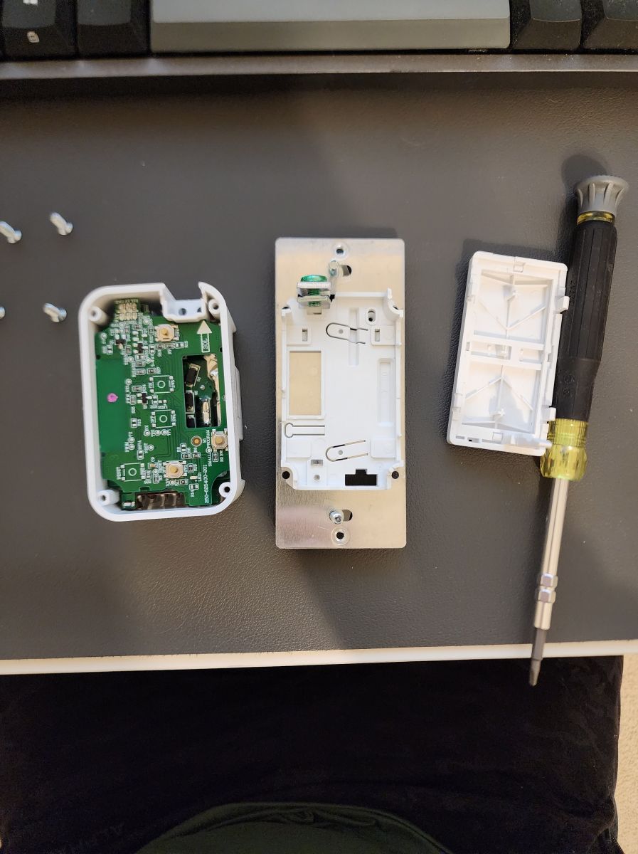

    This is pretty easy to get into, just pop off the front switch cover by pulling on the tabs on either side. Once the front cover is off, you can easily get to the 4 triangle screws (not sure the proper name of these, but I happened to have a bit in a precision screwdriver set from Klein). Once these are removed, the entire metal faceplate can be easily removed.
    [BK7231T WB3S] UltraPro WFD4001 3-Way Smart Wall Switch [BK7231T WB3S] UltraPro WFD4001 3-Way Smart Wall Switch [BK7231T WB3S] UltraPro WFD4001 3-Way Smart Wall Switch [BK7231T WB3S] UltraPro WFD4001 3-Way Smart Wall Switch [BK7231T WB3S] UltraPro WFD4001 3-Way Smart Wall Switch [BK7231T WB3S] UltraPro WFD4001 3-Way Smart Wall Switch

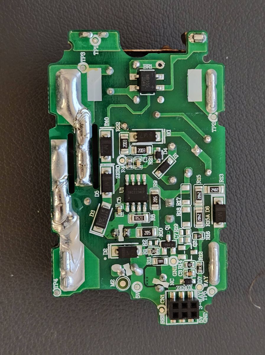

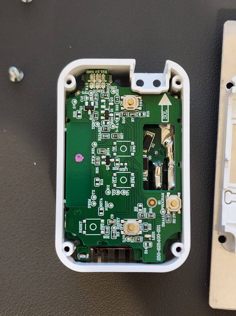

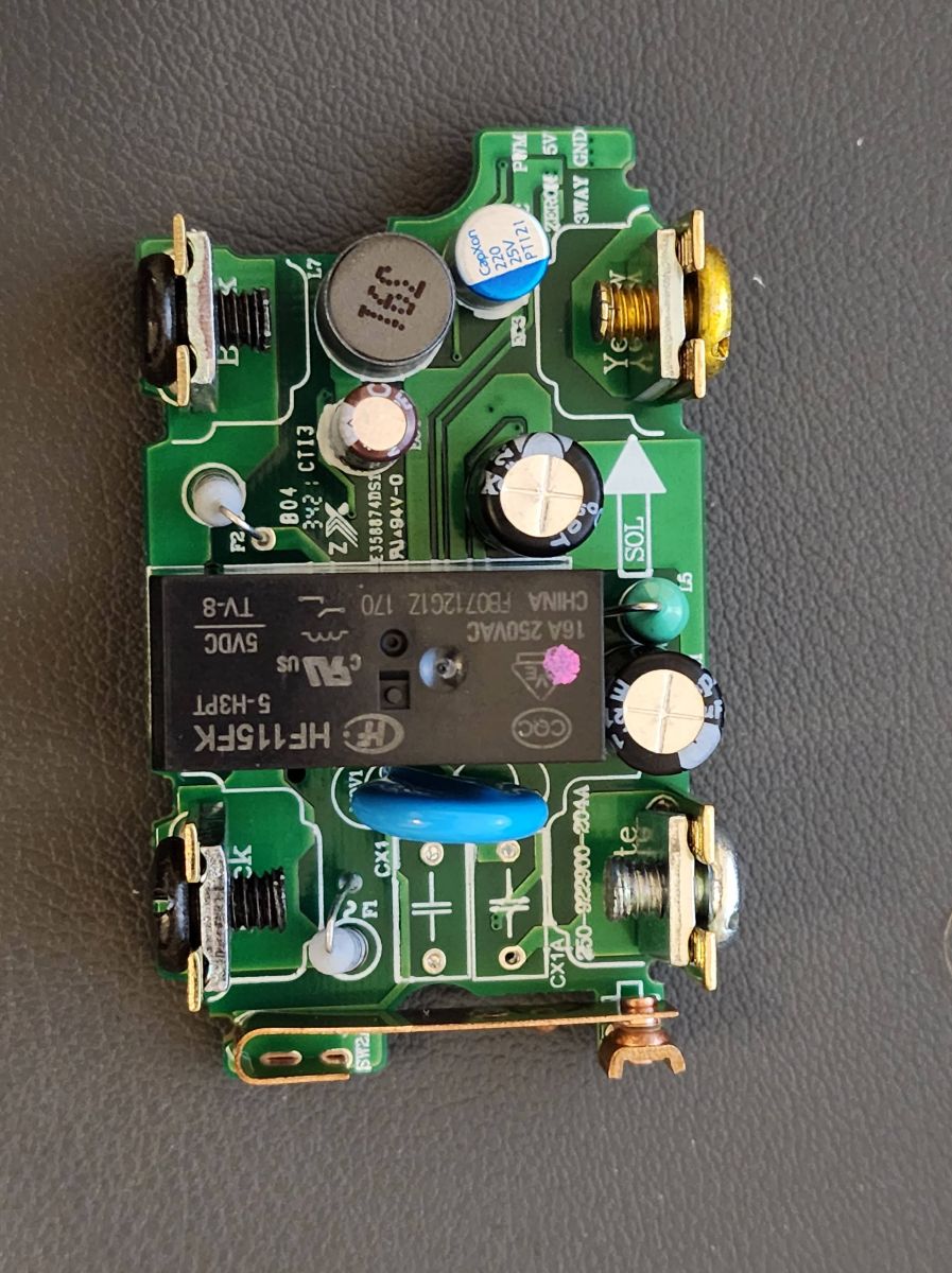

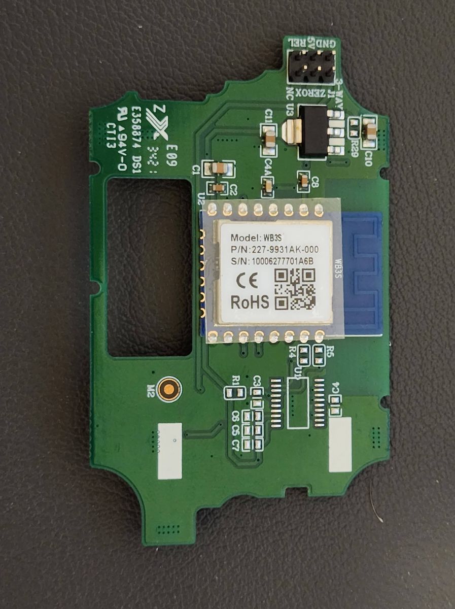

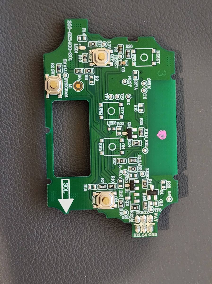

    The board is split into two parts that I will call the control board and the power board. Both of these boards can be removed by just pulling them out, no other screws or tabs are holding them in, although the power board is held in a little bit by the screws terminals, but these can be pushed out from the side. The control board sits on top and has the WB3S chip, as well as the up and down buttons. This is connected to the power board via a 6-pin header, so be careful to pull the control board straight out so the pins don't get bent. A closer look at the 6-pins has them labeled as REL, 5V, GND, 3-WAY, ZEROX, and NC. The REL is also labeled as PWM in some spots - I'm not sure if this is because it terminates to a PWM pin on the WB3S chip, or if there is some other functionality that I don't know about. I could not find where the NC and ZEROX pins go to, so I'm not sure what they are used for. The NC doesn't seem to go anywhere on the board, but the ZEROX looks to be connected to a few components.

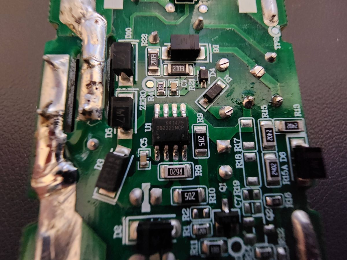

    The power board has an 0B2222MCP chip which is described as a "PWM Power Switch", but I'm not sure if there is anything useful for us here.

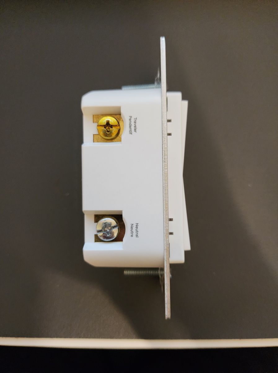

    This switch works a bit differently from the one that you have, it only has a single relay and a single traveler line, so the switch is able to reliably/accurately report its state (the one relay output is either 1 or 0). The ADC value is only measuring the output of the traveler wire/secondary switch and is independent of the relay - whether the relay is on or off, the traveler/ADC will report the value of the secondary switch. I was hoping that as soon as I switched the traveler, the ADC would either go high or low (the state of the secondary switch), but this doesn’t seem to be the case unfortunately.
    Another note, the way this 3-way switch is set up is a bit different from a normal 3-way switch, but is typical of some other 3-way smart switches I’ve used. In a traditional installation, two traveler wires run between the two switches and behave like the animation in your first reply. In this setup, one traveler is tied directly to the load, and the other traveler is just used to pass a signal to the “master” switch (the smart switch). The master will then use the signal from the traveler to toggle the relay. The code I was trying to use was something like:
    addChangeHandler ADC > 50 toggleChannel 1
    addChangeHandler ADC < 50 toggelChannel 1
    Unfortunately the ADC value is not reliably high when the secondary switch is high which seems crazy to me… maybe I need to double check the wiring to make sure I actually set it up correctly - I hope I didn’t miss something obvious :/

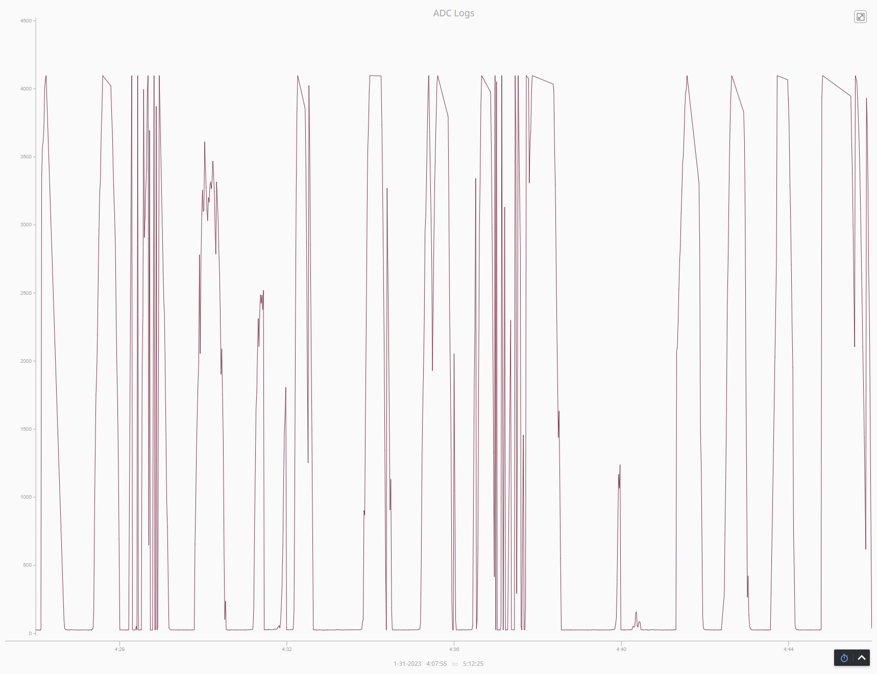

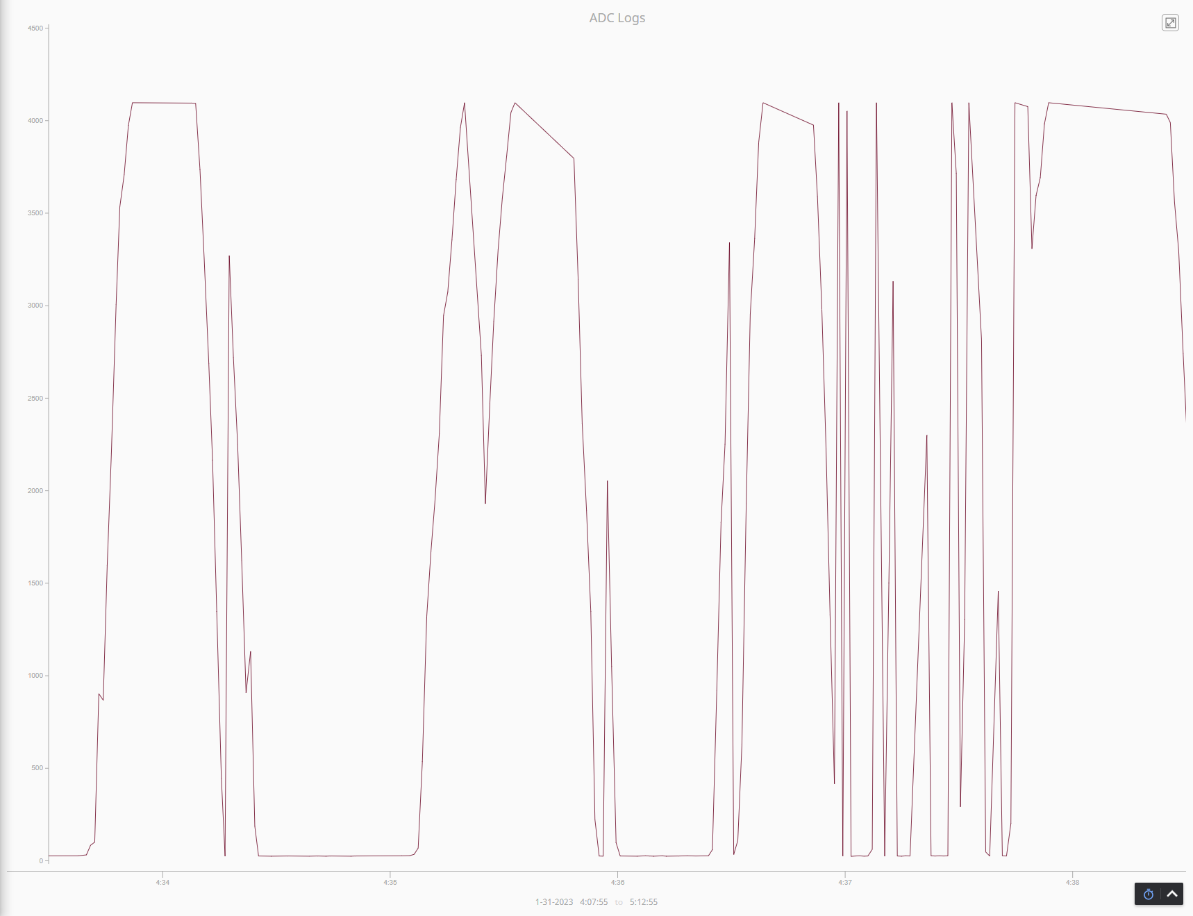

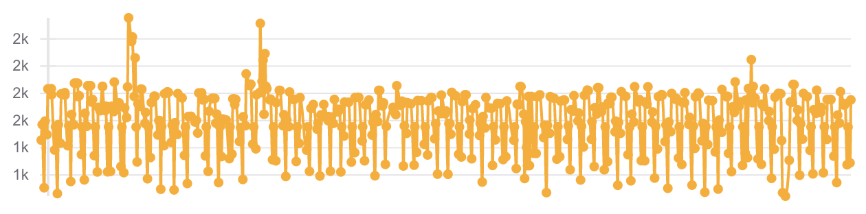

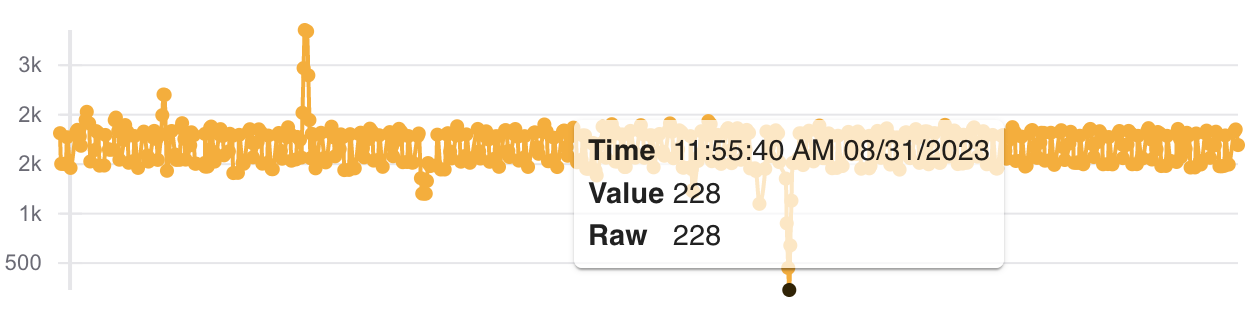

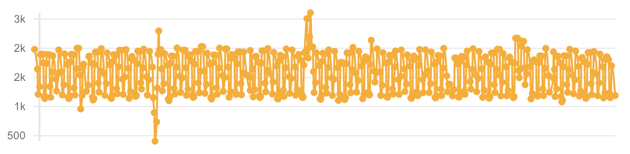

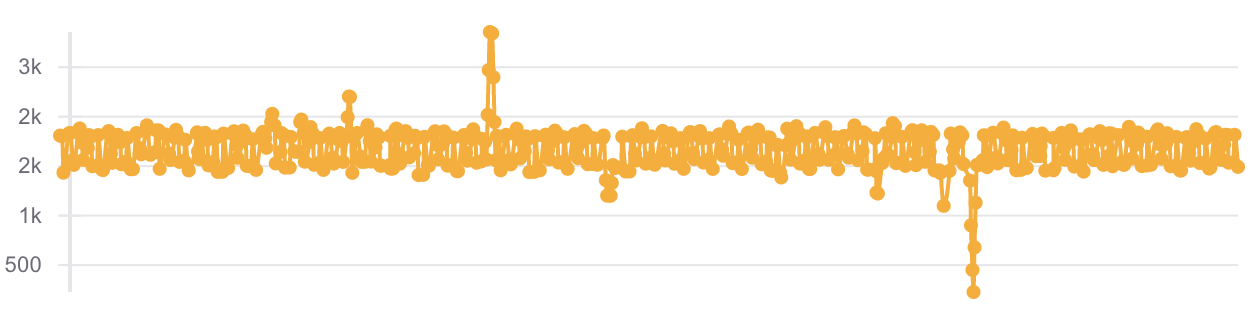

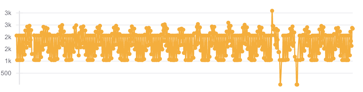

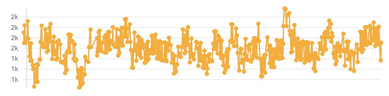

    Added after 5 [hours] 32 [minutes]:

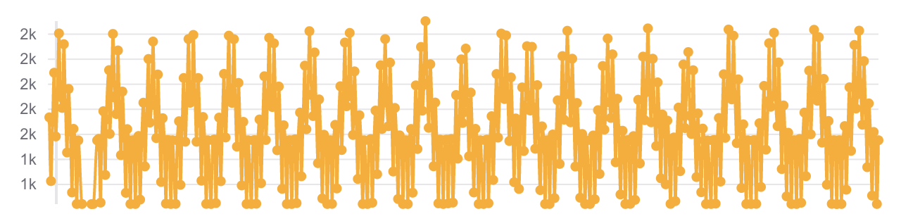

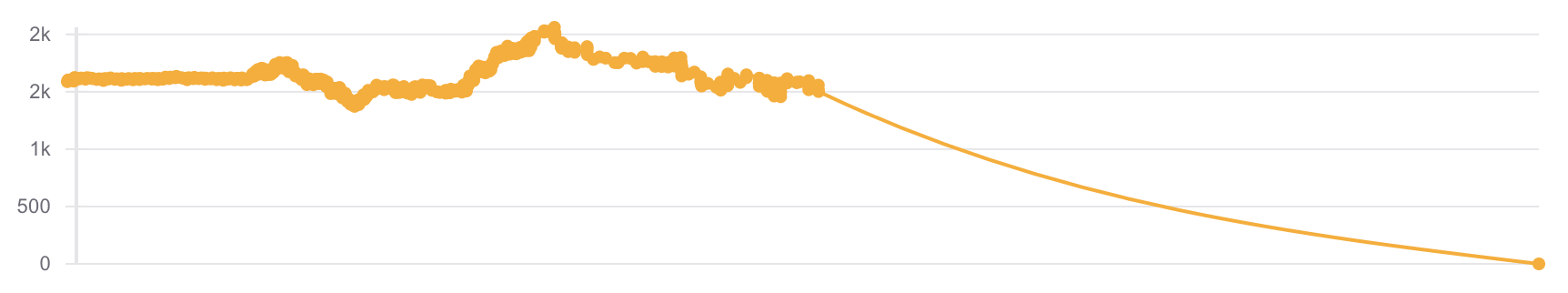

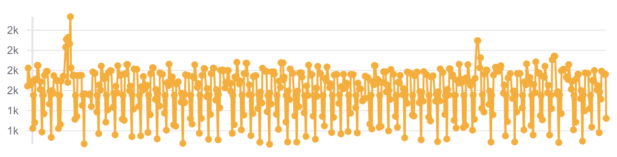

    Well I tried changing the switch with a stock switch, and the 3-way functionality worked, so at least we know its not my installation that was off.
    I was also able to log some data from the ADC pin. Here are a couple of screenshots of charts:
    I've also attached the raw CSV file with the values. WFD4001_20...6_logs.csv (115.53 kB)You must be logged in to download this attachment.
    A couple of notes on this
    - The first few minutes (around 4:08 to 4:12) the secondary/traveler is off, and we can see the values stay low, in the 21-29 range (I think there is only one spike to 29)
    - At 4:12, I turned the traveler on, and we can see continual spikes from the 20s all the way up to 4095
    - The values and timestamps were taken over MQTT, but the timestamp doesn't change unless the value changed. I added a new row every second regardless, so there are many duplicated values.
    - There is a gap between 5:04:05 and 5:07:38 where I stopped logging. Nothing interesting happened here, there is just missing data.
    - After I initially turned on the traveler, it stayed on for the rest of the logging.
    I don't think there is really any useful information here, but interesting to see what its doing. My thought is that this won't prove to be useful, but perhaps there is something that happens the moment the traveler changes state - I will need to do some more testing to see if any other pins can provide more info. I did test every pin with ADC to see if they did anything, and I found that P2, P3, P4, P5, P12 and P13 all report some values, but they don't seem to change at all when the traveler state is changed.
    One final thing - P14 does not report a value when set to ADC, but when set to TglChannelOnTgl, it continually toggles the channel its associated with. I'm not sure what this pin does, but best guess is some sort of clock? Not exactly sure what else I can do to test it further.

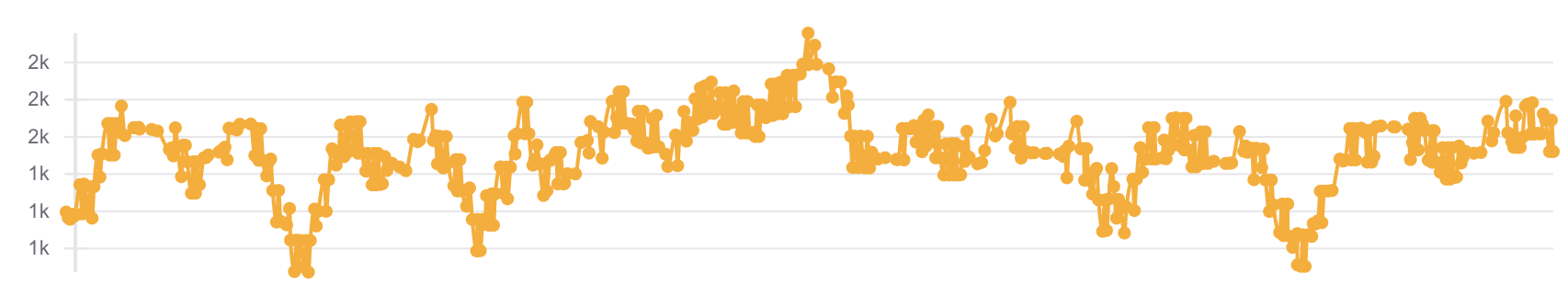

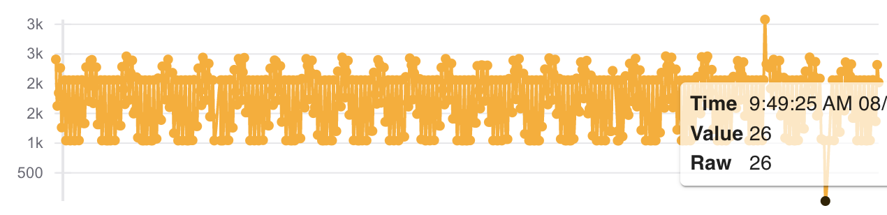

    I hope 6 months isn't too long to bring a thread back to life, but I recently bought and flashed one of these WFD4001 switches, and I think I have some new data and insights to bring to the topic.
    After setting pins according to @Subternatural's first post (many thanks, this thread has been very helpful in getting me this far), along with ADC_Button on Pin 23, I ran the following commands:
    StartDriver ADCButton
    AB_Map 2060

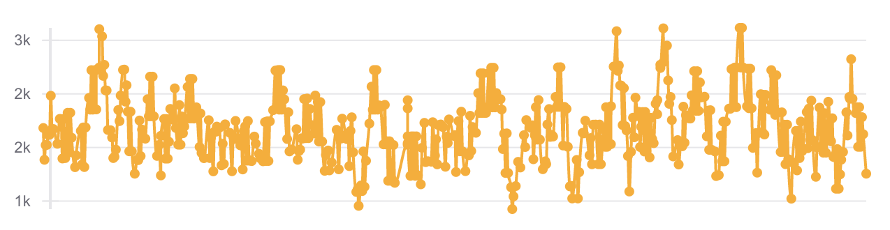

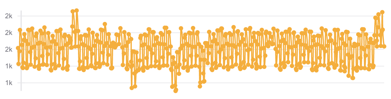

    and watched the logs though the webapp. Unlike MQTT, which gets updates once per second at most, the logs seem to be showing around 8 samples per second. When the traveler is low, the values hang out in the 25-30 range, and when high, they fluctuate anywhere between 25 and 4095. Logs for each scenario attached.
    I believe this comes down to the input being AC (120v 60Hz) vs what I assume is the normal ADC use case of DC. When the traveler is low, some noise is being picked up as the 25-30 value signal, and when high, the signal is fluctuating smoothly between 25 and 4095, peaking 60 times per second. The chip sampling at 8Hz or so doesn't stay in phase with the 60Hz signal (60/8 = 7.5), resulting in sporadic values being read, and the MQTT graphs @Subternatural posted (which match what I was seeing from MQTT values, as well).
    One solution would be to smooth the fluctuating signal out, either by taking a moving-window average over the past N samples (which, for this application, might result in a signal around 2060), or by taking the highest value of the past N samples. The latter seems more reliable to me, and considering most sets of 8 samples contain a 4095 instance, N=8 would give the smoothed value a response time of <=1s, which might be reasonable for a smart light switch. Based on my logs, N=4 might even be possible.
    Is there anything in the current version of OpenBeken that would accomplish this smoothing? Happy to experiment here to get this working 100%.

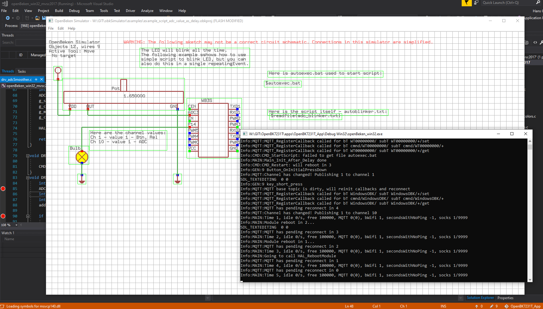

    I am glad to hear it's working. I didn't expect it to be so straightforward, especially that I haven't even tested my code on a real physical device before submitting, I only ran it in simulator:
    View of OpenBeken simulator with console window and connection schematic.
    Let's test it a bit longer and we will see if any issue arise.

    #22 20716901
    eternicode
    Level 4  
    Posts: 7
    Alright, I got a chance to set the driver up in various configurations to test stability of the low/high value, and I think with tight enough values, this is working very well and can be very responsive when flicking the traveler switch, to the point you wouldn't think there was any smart delay happening.
    Wall of text detailing my testing, with numbers and logic and graphs, in the spoiler tag:
    Spoiler:
    For testing, I configured the following pins, and enabled flag 6:
    P2 Rel 10
    P3 Rel 11
    P23 ADC_Button 5
    P2/P3 are set to Relay so their values automatically get sent to MQTT, and P23 is set to ADC_Button on a dummy channel so the raw values are not sent to MQTT. I then used mqtt-explorer to graph the reported values for channels 10/11 over time, watching for consistency in channel 10 (smoothed values) and stability in channel 11 (high/low value).
    Before I get to the results, a bit about why I picked the values I picked.
    Firstly, the ADC cycle being 60hz, it's (theoretically) important to pick a driver sample rate that will avoid "syncing" with the input (simply, you want a rate that does not divide evenly into the input); if that happens, your sampling will (again, theoretically) always hit the same points in the cycle, meaning you will get a consistent, but limited, smoothed value. On a practical level, there will probably be some drift over time, which may be what @Subternatural saw with a 50ms / 20hz sample rate -- the initial sample segment was high, but over time it drifted downward, triggering the low. Choosing an out-of-phase sample rate causes the sample segment to fluctuate quickly, avoiding staying in the "low" range for too long.
    Secondly, a response time of around 250ms or less "feels" best when physically flipping the traveler switch. I'm pretty sure there's research to back that up, but it's certainly subjectively true; I tried configurations that allowed anywhere from 250ms to 1,000ms lag between flipping the switch and seeing the lights change state, and anything above about the 333ms mark starts to feel clunky.
    So here are the results of various test runs. Graphs are from mqtt-explorer, taken after running the command, deleting channel 10's data, and letting it re-accumulate until the graph begins scrolling.
    Test # Command Samples per second (Hz) Samples averaged Response time (samples/Hz) Stability Smoothed graph
    1 ADCSmoother 23 4 60 10 50 11 16.666Hz 4 samples 240ms Unstable Orange bar chart showing data changes. Graph of variable values over time in orange.
    2 ADCSmoother 23 8 60 10 50 11 16.666Hz 8 samples 480ms Stable for 1hr Graph with orange dots showing data variability ranging from 1k to 2k.
    3 ADCSmoother 23 15 37 10 50 11 27.04Hz 15 samples 555ms Stable for 1hr Line chart showing data variability ranging from 1k to 2k.
    4 ADCSmoother 23 8 134 10 50 11 7.46Hz 8 samples 1,007ms Stable for 1hr Scatter plot with orange data points, showing values from around 1k to 2k.
    5 ADCSmoother 23 8 124 10 50 11 8.06Hz 8 samples 995ms Stable for 1hr Scatter plot showing variable data values ranging from 1k to 2k.
    6 ADCSmoother 23 9 37 10 50 11 27.04Hz 9 samples 333ms Stable for 1hr Scatter plot showing stability test data with fluctuations and some outliers. Data chart showing value stability over time.
    7 ADCSmoother 23 11 19 10 50 11 52.63Hz 11 samples 209ms Stable for 1hr Scatter plot displaying variable data in orange.
    8 ADCSmoother 23 7 37 10 50 11 27.04Hz 7 samples 258ms Unstable Scatter plot showing ADC value stability.
    9 ADCSmoother 23 12 8 10 50 11 125Hz 12 samples 96ms Stable for 1hr Graph showing data variability over time.
    10 ADCSmoother 23 24 4 10 50 11 250Hz 24 samples 96ms Stable for 1hr Graph showing dynamic measurement data with an orange trend line.
    11 ADCSmoother 23 100 1 10 50 11 1000Hz 100 samples 100ms Breaks MQTT publishing? Line chart showing a decreasing trend in values.
    The configuration I ended up with for a "purely physical" (ie, not hooked up to home assistant) setup:
    P8 Btn 1 "Up" button
    P9 Btn 2 "Down" button
    P23 ADC_Button 5
    P24 WifiLED
    P26 Rel 0
    Flags: Just flag 6 (I also have flags 2, 10, and 21 enabled, but those are MQTT related)
    autoexec.bat:
    # Channels:
    # relay = 0
    # up btn = 1
    # down btn = 2
    # adc smoother high/low = 3
    StartDriver ADCSmoother
    ADCSmoother 23 11 19 4 50 3
    addEventHandler onChannelChange 1 setChannel 0 1
    addEventHandler onChannelChange 2 setChannel 0 0
    addEventHandler onChannelChange 3 toggleChannel 0
    With this setup, the lights responding to the traveler switch feels instantaneous, and of course the up and down buttons work exactly as expected (up always turns lights on, down always turns lights off).
    My HA integration is going to be a whole other journey, but I expect it will be in line with other threads describing "detached" switches.
    Thanks again @Subternatural for kicking this off and @p.kaczmarek2 for whipping this driver up for us! If there are any more performance concerns with this driver, I'm happy to poke at them, but for the moment it seems to be working for me.

  • #27 20963329
    syntaxerr66
    Sorry to resurrect an old thread, but how did you guys get the switch into AP mode for cloudcutter? I've tried almost every combination of button presses and power cycling that I can think of, but it's still in the quick connect mode and never goes into ap mode.
  • Reset button and 5-second AP mode hold
    #28 20963749
    Posts: 14827
    Rate: 13012
    I may be wrong, but isn't here a tiny RESET-specific button?
    Photo of a smart wall switch with a highlighted button.

    Has anyone attempted to flash these switches with ESPHome? I have ESPHome running on these and they function as expected, both at the switch and via HA, but I cannot figure out the 3-way ADC detection. I've used the following:
    sensor:
      - platform: adc
        pin: P23
        update_interval: 50ms
        samples: 10
        internal: True
    which yields incredibly inconsistent results like:
    [15:52:23][D][sensor:093]: 'aux_switch': Sending state 0.23500 V with 2 decimals of accuracy
    [15:52:23][D][sensor:093]: 'aux_switch': Sending state 3.21800 V with 2 decimals of accuracy
    [15:52:23][D][sensor:093]: 'aux_switch': Sending state 0.19800 V with 2 decimals of accuracy
    [15:52:23][D][sensor:093]: 'aux_switch': Sending state 4.09500 V with 2 decimals of accuracy
    [15:52:23][D][sensor:093]: 'aux_switch': Sending state 3.98100 V with 2 decimals of accuracy
    [15:52:23][D][sensor:093]: 'aux_switch': Sending state 3.96200 V with 2 decimals of accuracy
    [15:52:23][D][sensor:093]: 'aux_switch': Sending state 0.12900 V with 2 decimals of accuracy
    [15:52:23][D][sensor:093]: 'aux_switch': Sending state 3.94700 V with 2 decimals of accuracy
    [15:52:23][D][sensor:093]: 'aux_switch': Sending state 3.94600 V with 2 decimals of accuracy
    [15:52:23][D][sensor:093]: 'aux_switch': Sending state 3.92500 V with 2 decimals of accuracy
    [15:52:23][D][sensor:093]: 'aux_switch': Sending state 0.08700 V with 2 decimals of accuracy
    [15:52:23][D][sensor:093]: 'aux_switch': Sending state 3.91600 V with 2 decimals of accuracy
    [15:52:24][D][sensor:093]: 'aux_switch': Sending state 3.91000 V with 2 decimals of accuracy
    [15:52:24][D][sensor:093]: 'aux_switch': Sending state 4.09500 V with 2 decimals of accuracy
    [15:52:24][D][sensor:093]: 'aux_switch': Sending state 3.88400 V with 2 decimals of accuracy
    [15:52:24][D][sensor:093]: 'aux_switch': Sending state 0.01000 V with 2 decimals of accuracy
    [15:52:24][D][sensor:093]: 'aux_switch': Sending state 3.82200 V with 2 decimals of accuracy
    [15:52:24][D][sensor:093]: 'aux_switch': Sending state 0.04900 V with 2 decimals of accuracy
    [15:52:24][D][sensor:093]: 'aux_switch': Sending state 3.83500 V with 2 decimals of accuracy
    [15:52:24][D][sensor:093]: 'aux_switch': Sending state 3.81100 V with 2 decimals of accuracy
    [15:52:24][D][sensor:093]: 'aux_switch': Sending state 3.82500 V with 2 decimals of accuracy
    [15:52:24][D][sensor:093]: 'aux_switch': Sending state 0.03100 V with 2 decimals of accuracy
    [15:52:24][D][sensor:093]: 'aux_switch': Sending state 2.88300 V with 2 decimals of accuracy
    [15:52:24][D][sensor:093]: 'aux_switch': Sending state 0.03000 V with 2 decimals of accuracy
    [15:52:24][D][sensor:093]: 'aux_switch': Sending state 3.75900 V with 2 decimals of accuracy
    [15:52:24][D][sensor:093]: 'aux_switch': Sending state 3.69400 V with 2 decimals of accuracy
    [15:52:24][D][sensor:093]: 'aux_switch': Sending state 3.71400 V with 2 decimals of accuracy
    [15:52:24][D][sensor:093]: 'aux_switch': Sending state 0.01800 V with 2 decimals of accuracy
    [15:52:24][D][sensor:093]: 'aux_switch': Sending state 3.64700 V with 2 decimals of accuracy
    [15:52:24][D][sensor:093]: 'aux_switch': Sending state 3.69900 V with 2 decimals of accuracy
    [15:52:25][D][sensor:093]: 'aux_switch': Sending state 4.09500 V with 2 decimals of accuracy
    [15:52:25][D][sensor:093]: 'aux_switch': Sending state 3.61800 V with 2 decimals of accuracy
    [15:52:25][D][sensor:093]: 'aux_switch': Sending state 3.49400 V with 2 decimals of accuracy
    [15:52:25][D][sensor:093]: 'aux_switch': Sending state 0.01500 V with 2 decimals of accuracy
    [15:52:25][D][sensor:093]: 'aux_switch': Sending state 2.67400 V with 2 decimals of accuracy
    [15:52:25][D][sensor:093]: 'aux_switch': Sending state 0.01400 V with 2 decimals of accuracy
    [15:52:25][D][sensor:093]: 'aux_switch': Sending state 3.52300 V with 2 decimals of accuracy
    [15:52:25][D][sensor:093]: 'aux_switch': Sending state 3.48100 V with 2 decimals of accuracy
    [15:52:25][D][sensor:093]: 'aux_switch': Sending state 0.01200 V with 2 decimals of accuracy
    [15:52:25][D][sensor:093]: 'aux_switch': Sending state 3.40100 V with 2 decimals of accuracy
    [15:52:25][D][sensor:093]: 'aux_switch': Sending state 3.46600 V with 2 decimals of accuracy
    [15:52:25][D][sensor:093]: 'aux_switch': Sending state 3.37700 V with 2 decimals of accuracy
    [15:52:25][D][sensor:093]: 'aux_switch': Sending state 3.41100 V with 2 decimals of accuracy
    [15:52:25][D][sensor:093]: 'aux_switch': Sending state 3.32500 V with 2 decimals of accuracy
    [15:52:26][D][sensor:093]: 'aux_switch': Sending state 3.22200 V with 2 decimals of accuracy
    [15:52:26][D][sensor:093]: 'aux_switch': Sending state 4.09500 V with 2 decimals of accuracy
    [15:52:26][D][sensor:093]: 'aux_switch': Sending state 3.20400 V with 2 decimals of accuracy
    [15:52:26][D][sensor:093]: 'aux_switch': Sending state 0.01100 V with 2 decimals of accuracy
    [15:52:26][D][sensor:093]: 'aux_switch': Sending state 1.74900 V with 2 decimals of accuracy
    [15:52:26][D][sensor:093]: 'aux_switch': Sending state 0.01000 V with 2 decimals of accuracy
    [15:52:26][D][sensor:093]: 'aux_switch': Sending state 2.42200 V with 2 decimals of accuracy
    [15:52:26][D][sensor:093]: 'aux_switch': Sending state 2.99900 V with 2 decimals of accuracy
    [15:52:26][D][sensor:093]: 'aux_switch': Sending state 2.07600 V with 2 decimals of accuracy
    [15:52:26][D][sensor:093]: 'aux_switch': Sending state 4.09200 V with 2 decimals of accuracy
    [15:52:26][D][sensor:093]: 'aux_switch': Sending state 3.04600 V with 2 decimals of accuracy
    [15:52:26][D][sensor:093]: 'aux_switch': Sending state 2.94100 V with 2 decimals of accuracy
    [15:52:26][D][sensor:093]: 'aux_switch': Sending state 1.90600 V with 2 decimals of accuracy
    [15:52:26][D][sensor:093]: 'aux_switch': Sending state 2.71300 V with 2 decimals of accuracy
    [15:52:27][D][sensor:093]: 'aux_switch': Sending state 1.55800 V with 2 decimals of accuracy
    [15:52:27][D][sensor:093]: 'aux_switch': Sending state 0.01100 V with 2 decimals of accuracy
    [15:52:27][D][sensor:093]: 'aux_switch': Sending state 2.85900 V with 2 decimals of accuracy
    [15:52:27][D][sensor:093]: 'aux_switch': Sending state 0.01000 V with 2 decimals of accuracy
    [15:52:27][D][sensor:093]: 'aux_switch': Sending state 4.09500 V with 2 decimals of accuracy
    [15:52:27][D][sensor:093]: 'aux_switch': Sending state 1.92600 V with 2 decimals of accuracy
    [15:52:27][D][sensor:093]: 'aux_switch': Sending state 2.55800 V with 2 decimals of accuracy
    [15:52:27][D][sensor:093]: 'aux_switch': Sending state 4.08100 V with 2 decimals of accuracy
    [15:52:27][D][sensor:093]: 'aux_switch': Sending state 2.49000 V with 2 decimals of accuracy
    [15:52:27][D][sensor:093]: 'aux_switch': Sending state 4.06800 V with 2 decimals of accuracy
    [15:52:27][D][sensor:093]: 'aux_switch': Sending state 2.43100 V with 2 decimals of accuracy
    [15:52:27][D][sensor:093]: 'aux_switch': Sending state 1.04000 V with 2 decimals of accuracy
    [15:52:27][D][sensor:093]: 'aux_switch': Sending state 2.29400 V with 2 decimals of accuracy
    [15:52:27][D][sensor:093]: 'aux_switch': Sending state 0.82600 V with 2 decimals of accuracy
    [15:52:27][D][sensor:093]: 'aux_switch': Sending state 2.30800 V with 2 decimals of accuracy
    [15:52:28][D][sensor:093]: 'aux_switch': Sending state 0.01000 V with 2 decimals of accuracy
    [15:52:28][D][sensor:093]: 'aux_switch': Sending state 1.39200 V with 2 decimals of accuracy
    [15:52:28][D][sensor:093]: 'aux_switch': Sending state 0.01100 V with 2 decimals of accuracy
    [15:52:28][D][sensor:093]: 'aux_switch': Sending state 4.09500 V with 2 decimals of accuracy
    [15:52:28][D][sensor:093]: 'aux_switch': Sending state 1.99500 V with 2 decimals of accuracy
    [15:52:28][D][sensor:093]: 'aux_switch': Sending state 4.03300 V with 2 decimals of accuracy
    [15:52:28][D][sensor:093]: 'aux_switch': Sending state 1.98700 V with 2 decimals of accuracy
    [15:52:28][D][sensor:093]: 'aux_switch': Sending state 1.90200 V with 2 decimals of accuracy
    [15:52:28][D][sensor:093]: 'aux_switch': Sending state 1.85200 V with 2 decimals of accuracy
    [15:52:28][D][sensor:093]: 'aux_switch': Sending state 1.81600 V with 2 decimals of accuracy
    [15:52:28][D][sensor:093]: 'aux_switch': Sending state 1.80900 V with 2 decimals of accuracy
    [15:52:28][D][sensor:093]: 'aux_switch': Sending state 0.00900 V with 2 decimals of accuracy
    [15:52:28][D][sensor:093]: 'aux_switch': Sending state 1.83100 V with 2 decimals of accuracy
    [15:52:28][D][sensor:093]: 'aux_switch': Sending state 1.53600 V with 2 decimals of accuracy
    [15:52:29][D][sensor:093]: 'aux_switch': Sending state 1.52500 V with 2 decimals of accuracy
    [15:52:29][D][sensor:093]: 'aux_switch': Sending state 4.04400 V with 2 decimals of accuracy
    [15:52:29][D][sensor:093]: 'aux_switch': Sending state 0.01000 V with 2 decimals of accuracy
    [15:52:29][D][sensor:093]: 'aux_switch': Sending state 1.56700 V with 2 decimals of accuracy
    [15:52:29][D][sensor:093]: 'aux_switch': Sending state 4.00300 V with 2 decimals of accuracy
    [15:52:29][D][sensor:093]: 'aux_switch': Sending state 1.27500 V with 2 decimals of accuracy
    [15:52:29][D][sensor:093]: 'aux_switch': Sending state 1.28400 V with 2 decimals of accuracy
    [15:52:29][D][sensor:093]: 'aux_switch': Sending state 4.09500 V with 2 decimals of accuracy
    [15:52:29][D][sensor:093]: 'aux_switch': Sending state 1.27900 V with 2 decimals of accuracy
    [15:52:29][D][sensor:093]: 'aux_switch': Sending state 0.82500 V with 2 decimals of accuracy
    [15:52:29][D][sensor:093]: 'aux_switch': Sending state 1.09400 V with 2 decimals of accuracy
    [15:52:29][D][sensor:093]: 'aux_switch': Sending state 3.96100 V with 2 decimals of accuracy
    [15:52:29][D][sensor:093]: 'aux_switch': Sending state 0.96400 V with 2 decimals of accuracy
    [15:52:30][D][sensor:093]: 'aux_switch': Sending state 0.89400 V with 2 decimals of accuracy
    [15:52:30][D][sensor:093]: 'aux_switch': Sending state 0.97200 V with 2 decimals of accuracy
    [15:52:30][D][sensor:093]: 'aux_switch': Sending state 3.79700 V with 2 decimals of accuracy
    [15:52:30][D][sensor:093]: 'aux_switch': Sending state 0.87000 V with 2 decimals of accuracy
    [15:52:30][D][sensor:093]: 'aux_switch': Sending state 0.01000 V with 2 decimals of accuracy
    [15:52:30][D][sensor:093]: 'aux_switch': Sending state 0.71200 V with 2 decimals of accuracy
    [15:52:30][D][sensor:093]: 'aux_switch': Sending state 4.09300 V with 2 decimals of accuracy
    [15:52:30][D][sensor:093]: 'aux_switch': Sending state 0.69800 V with 2 decimals of accuracy
    [15:52:30][D][sensor:093]: 'aux_switch': Sending state 4.09100 V with 2 decimals of accuracy
    [15:52:30][D][sensor:093]: 'aux_switch': Sending state 0.68600 V with 2 decimals of accuracy
    [15:52:30][D][sensor:093]: 'aux_switch': Sending state 4.08400 V with 2 decimals of accuracy
    [15:52:30][D][sensor:093]: 'aux_switch': Sending state 0.64600 V with 2 decimals of accuracy
    [15:52:30][D][sensor:093]: 'aux_switch': Sending state 0.55100 V with 2 decimals of accuracy
    [15:52:30][D][sensor:093]: 'aux_switch': Sending state 0.58900 V with 2 decimals of accuracy
    [15:52:30][D][sensor:093]: 'aux_switch': Sending state 3.73700 V with 2 decimals of accuracy
    [15:52:30][D][sensor:093]: 'aux_switch': Sending state 0.53100 V with 2 decimals of accuracy
    [15:52:30][D][sensor:093]: 'aux_switch': Sending state 3.68600 V with 2 decimals of accuracy
    Any suggestion on a more accurate ADC config?

How do I open the switch for a hardware teardown?
  1. Pry off the rocker paddle via the side tabs.
  2. Remove four triangle-head screws (Klein precision bit fits) to lift the metal frame.
  3. Slide out the stacked control and power PCBs—no latches holding them [Elektroda, Subternatural, post #20414165]

How do I enable reliable 3-way traveller detection?
  1. Start ADCSmoother: StartDriver ADCSmoother.
  2. Apply filter: ADCSmoother 23 11 19 4 50 3.
  3. Toggle relay on change: addEventHandler onChannelChange 3 toggleChannel 0 [Elektroda, eternicode, post #20716901]
What sampling values proved fastest yet stable?
11 samples with a 19 ms interval (≈ 52.6 Hz) gave a measured 209 ms detection plus 96 ms light response, staying stable for >1 hour [Elektroda, eternicode, post #20716901]

Can ESPHome achieve the same 3-way detection?
Raw adc: readings fluctuate 25–4095 mV due to 60 Hz AC coupling, causing false triggers [Elektroda, Rickerdo, post #21231450] ESPHome needs an external moving-window max or average filter (~8–12 samples) to replicate ADCSmoother functionality.

What if my filtered value still drifts into the low range?
Increase either the sample count or the margin (e.g., set margin to 80) to widen the high window; this removed false lows at 16.6 Hz sampling [Elektroda, eternicode, post #20716901]
