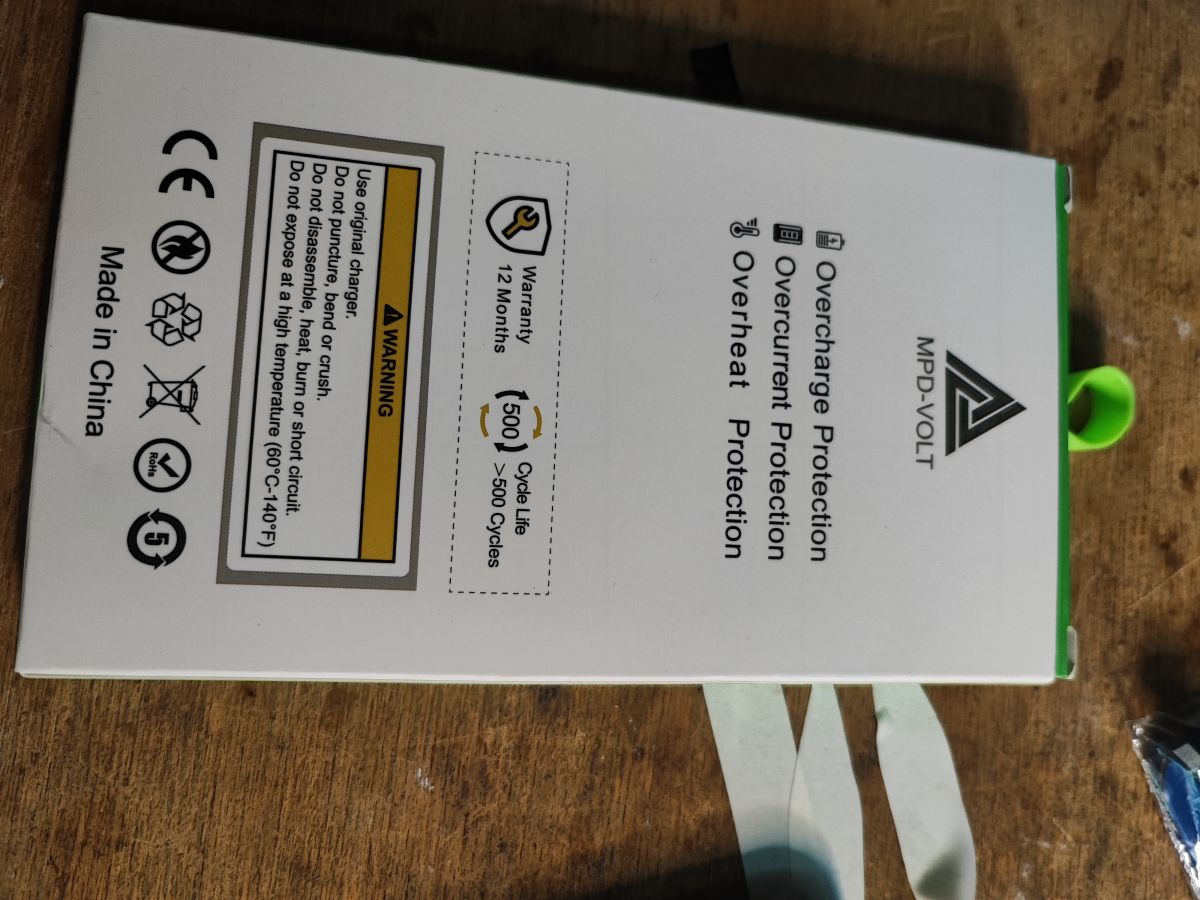

    The battery here is unlikely to be original, but as long as it works I won't complain. You can get shipping for free, so for now the cost of play is 60zł....
    The kit should be matched to the phone you have - the battery for the iPhone 7 Plus does not fit the iPhone 7 itself, etc!

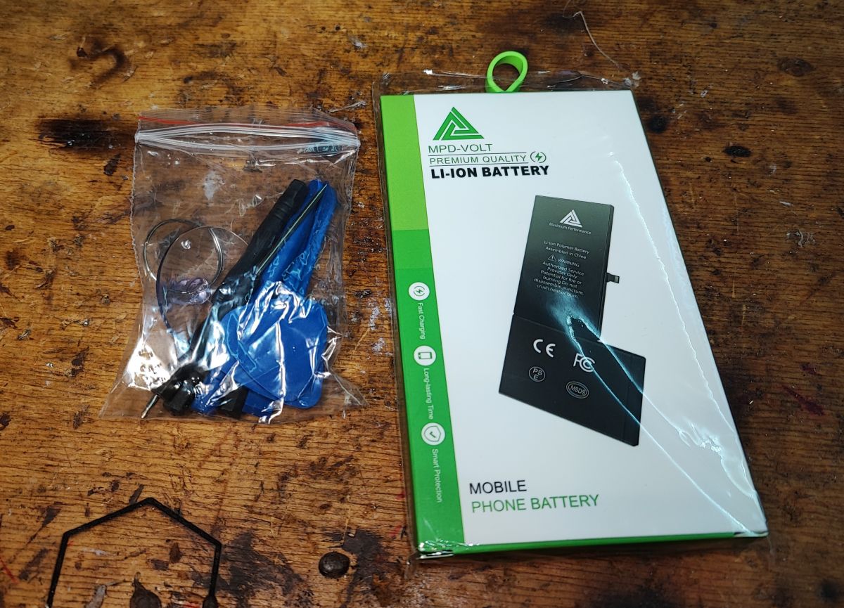

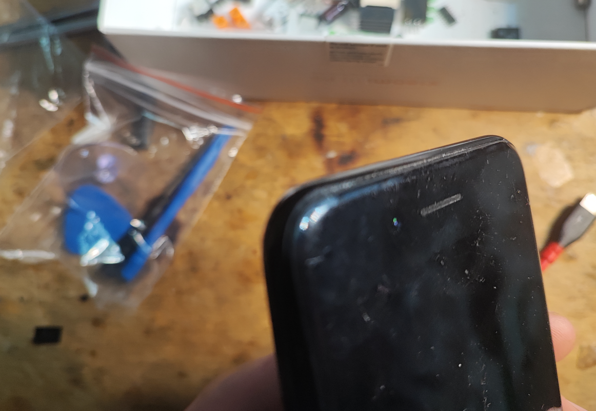

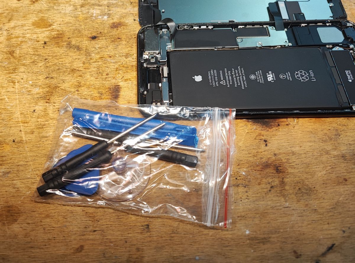

    I made sure the battery was completely drained and the phone switched off. I prepared the kit:
    iPhone battery replacement kit showing a battery package and tools in a ziplock bag. .

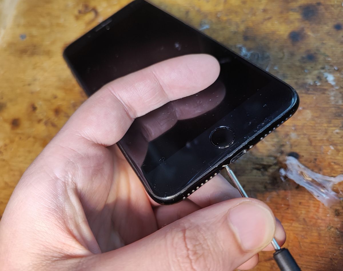

    I started by removing the two 3.4mm pentalobe screws at the USB port:
    A person unscrewing iPhone screws on a wooden surface .

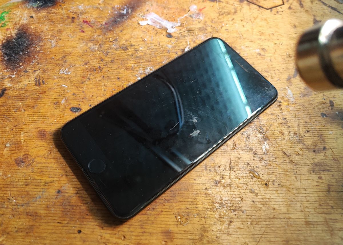

    I then took to heating the screen. Heating will make the glue stick less well. I used hot air without a tip, temperature the lowest possible, 100°C, heating from a distance, with a feel. You might as well use a hair dryer:
    iPhone lying on a wooden workbench next to hot air for screen heating .

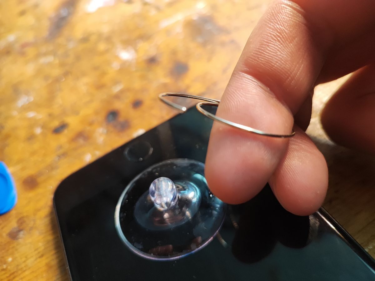

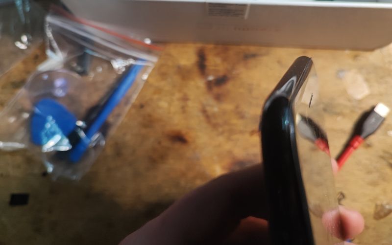

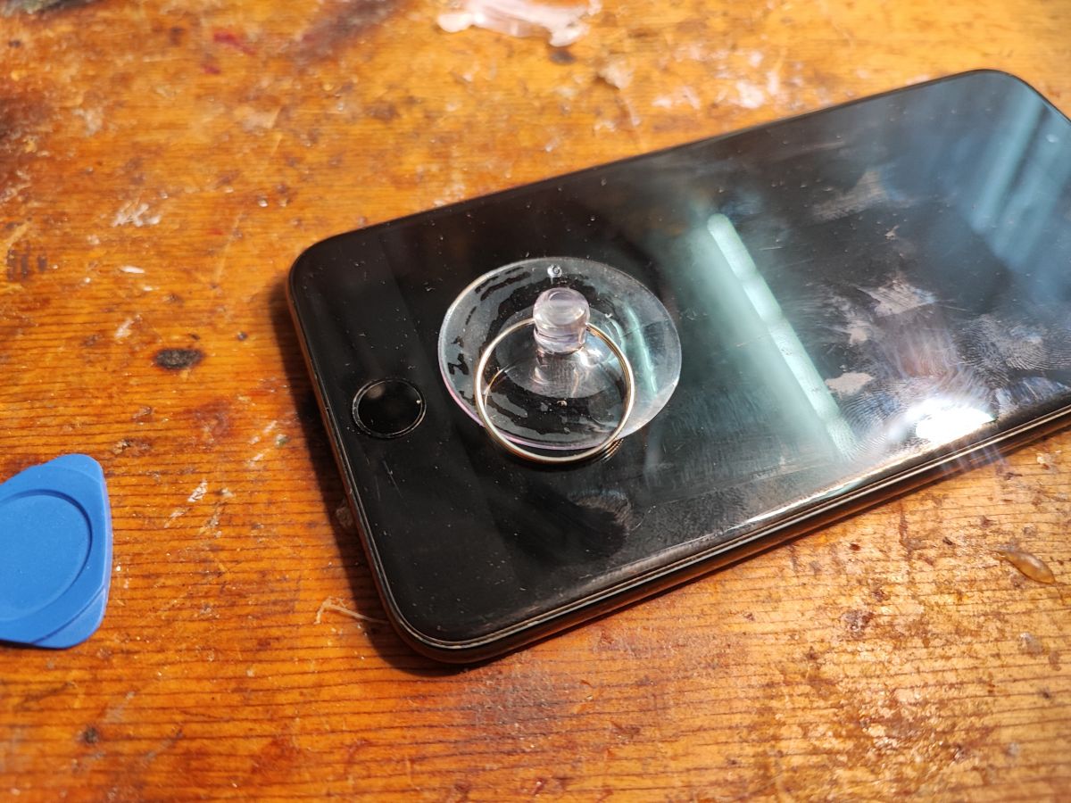

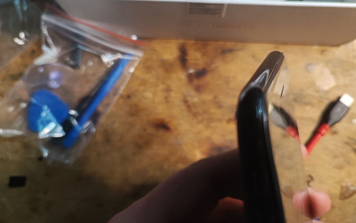

    I then tried to lift the screen with a suction cup. The suction cup has to be placed over the Home button, but it cannot be hovered over it:
    Phone with suction cup on the screen and a guitar pick lies on a table. .

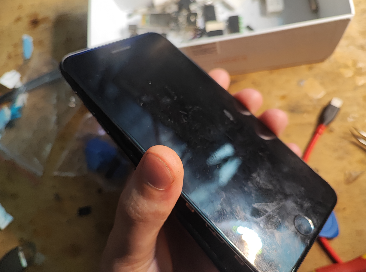

    It seems so easy on the videos on the internet.... And in my case the ring has come apart from the suction cup:
    Suction cup on smartphone screen with damaged ring .

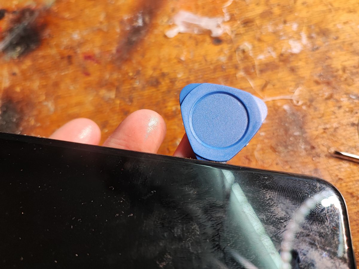

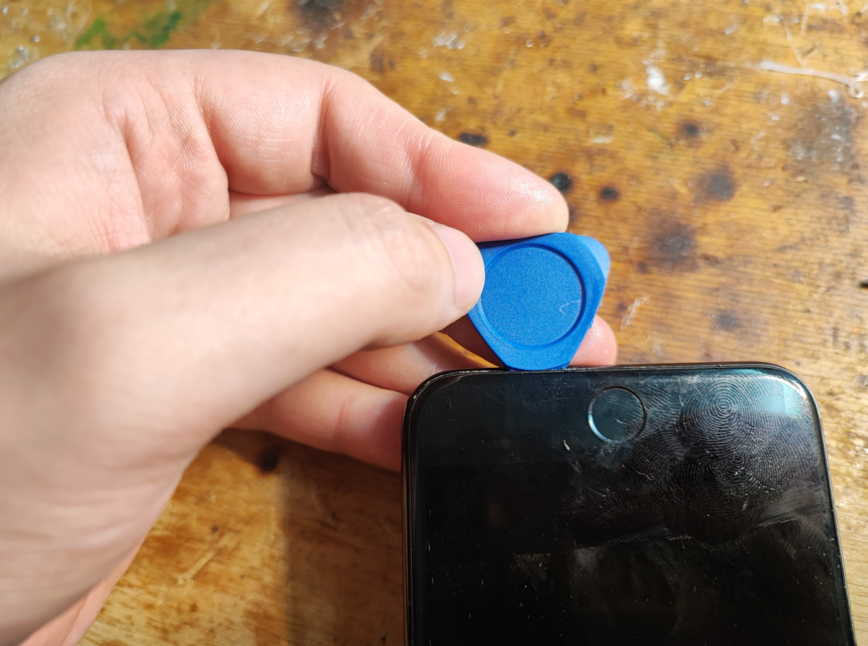

    In the end I had to go against common sense, take a chance and help myself with a flat wide screwdriver, carefully, no deeper than 2-3mm, then inserting a guitar pick into the slot:
    A person uses a blue guitar pick to pry open an iPhone screen. .
    I went around the phone with it, carefully, not putting it in too deep, as there are ribbons there:
    Smartphone being opened with a flat plastic tool on a wooden table. .

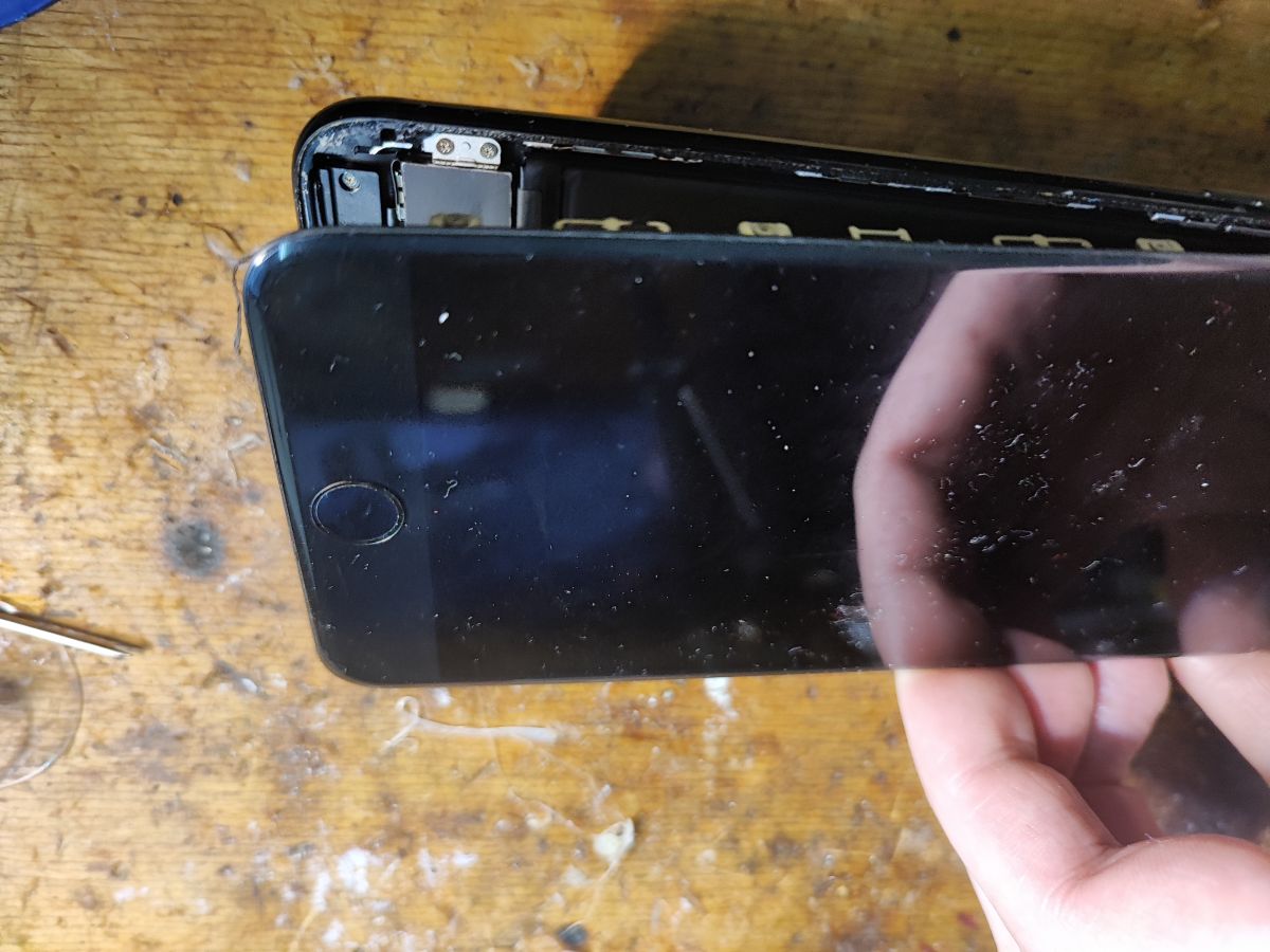

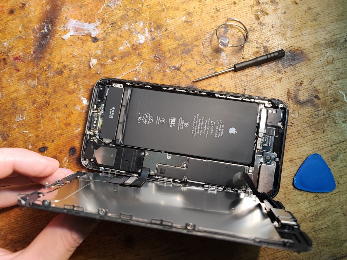

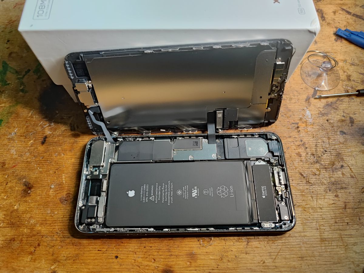

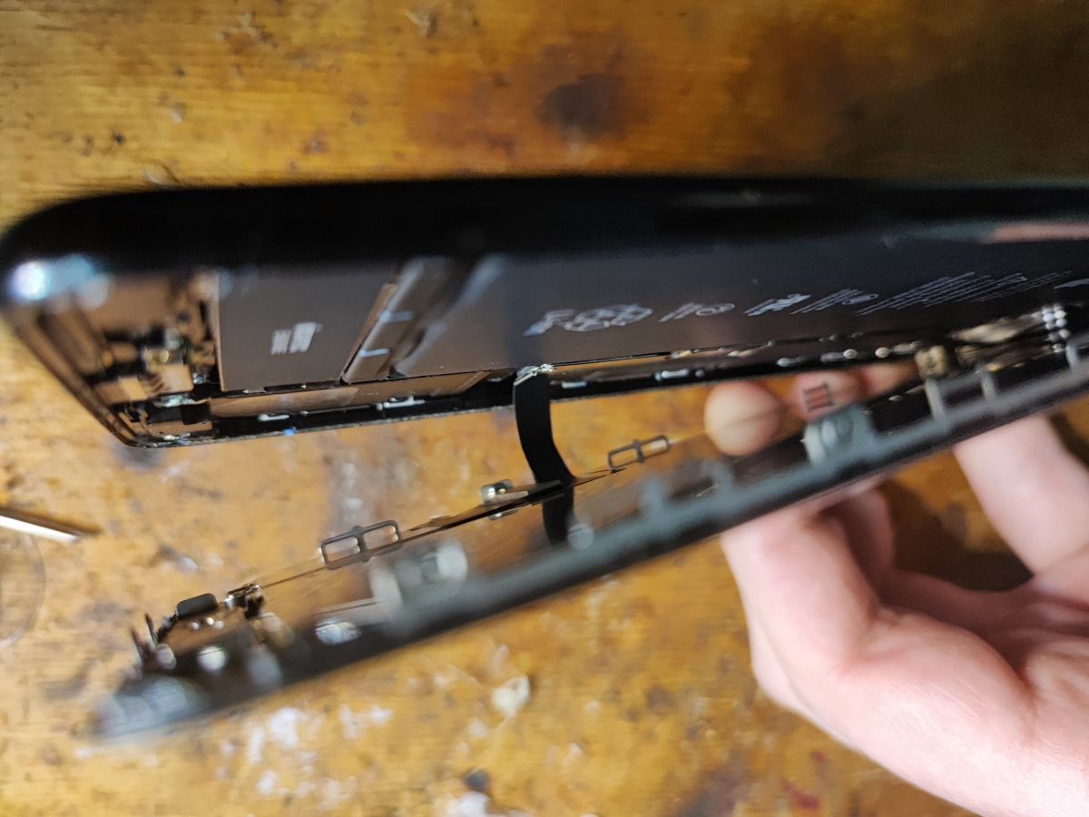

    The phone opens like a book - details coming soon:
    Inside view of an opened iPhone showing the battery and ribbons. iPhone screen partially detached from the casing during battery replacement. .
    The ribbons will still hold the screen, so it's a good idea to stand some sort of box next to it to avoid stretching them:
    Open interior of an iPhone showing components, including the battery and screen. Open interior of a phone with visible battery and tools .

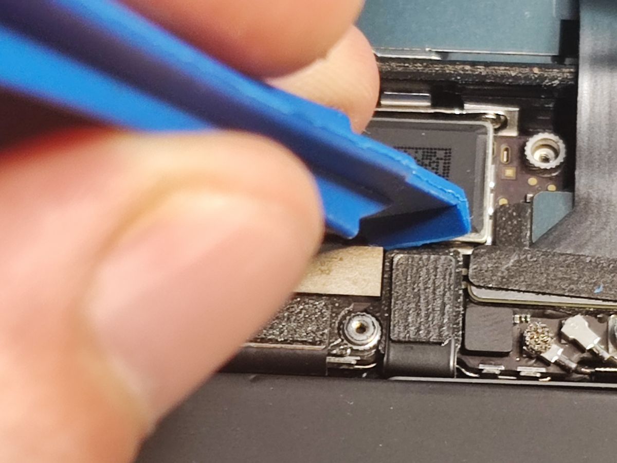

    Now it's time to disconnect the screen and battery.

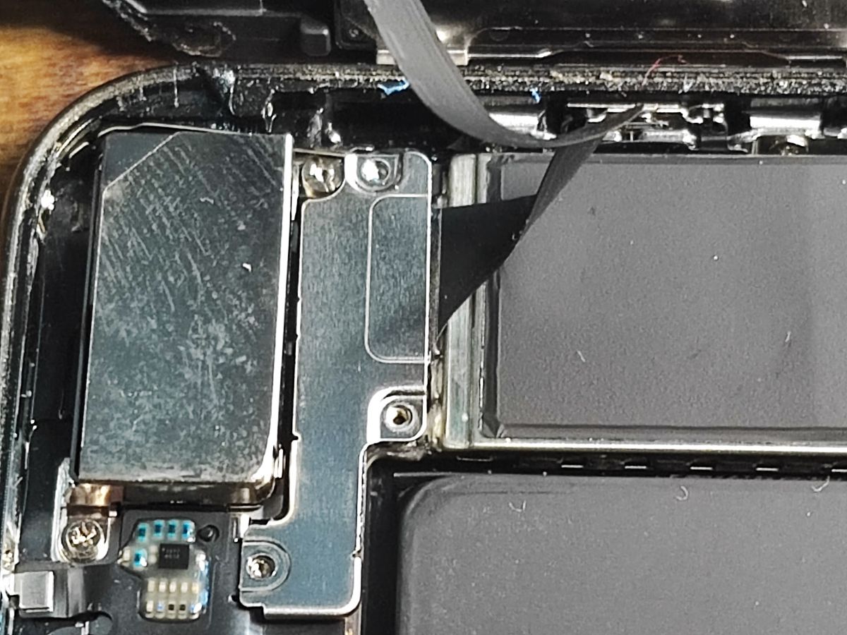

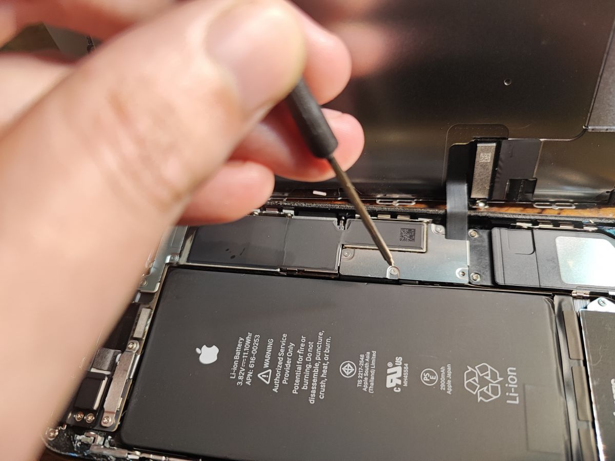

    The connectors need to be exposed, I took a Y000 "triangular" screwdriver and removed four screws:
    Person unscrewing screws inside an open iPhone. .
    And actually three, because by the fourth the screwdriver refused to obey and no longer unscrewed anything.... by some miracle it had dulled. .
    I reported the problem to the dealer who sent me another set:
    Battery replacement tools and an open iPhone on a wooden table.
    And only then did it work:
    Open iPhone showing internal components, including the battery. Close-up of an open iPhone interior, showing cables and connectors. .

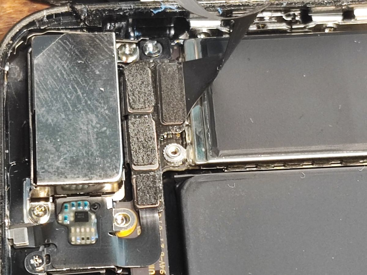

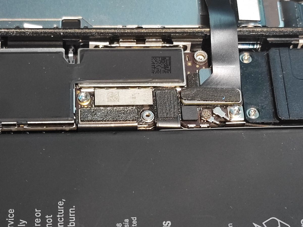

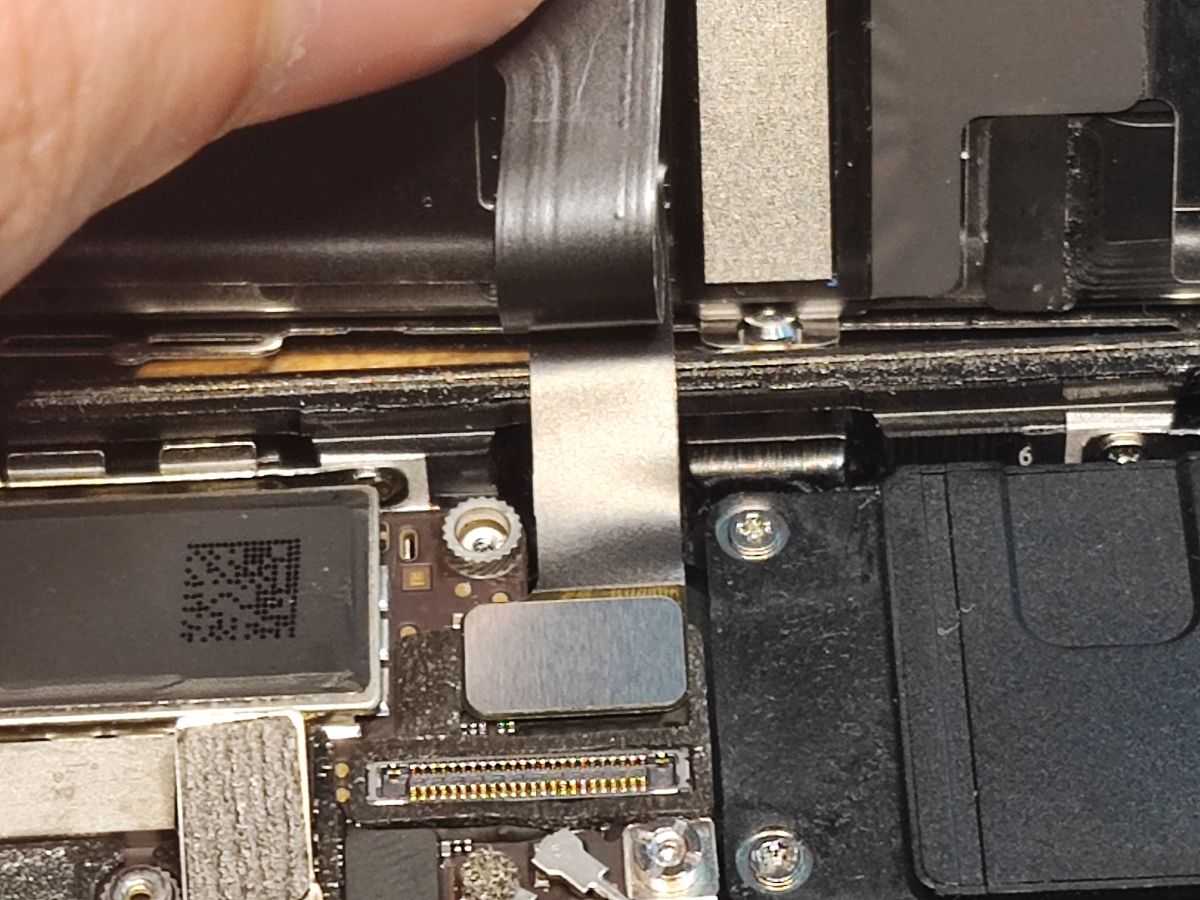

    I have disconnected the ribbons:
    Close-up of opening tool during iPhone disassembly. .
    Same with the other ribbon going to the screen, I unscrewed the screws, Y000:
    Close-up of connectors inside an open iPhone. Interior of an opened iPhone during battery replacement Close-up view of the inside of an iPhone showing components and ribbons. .

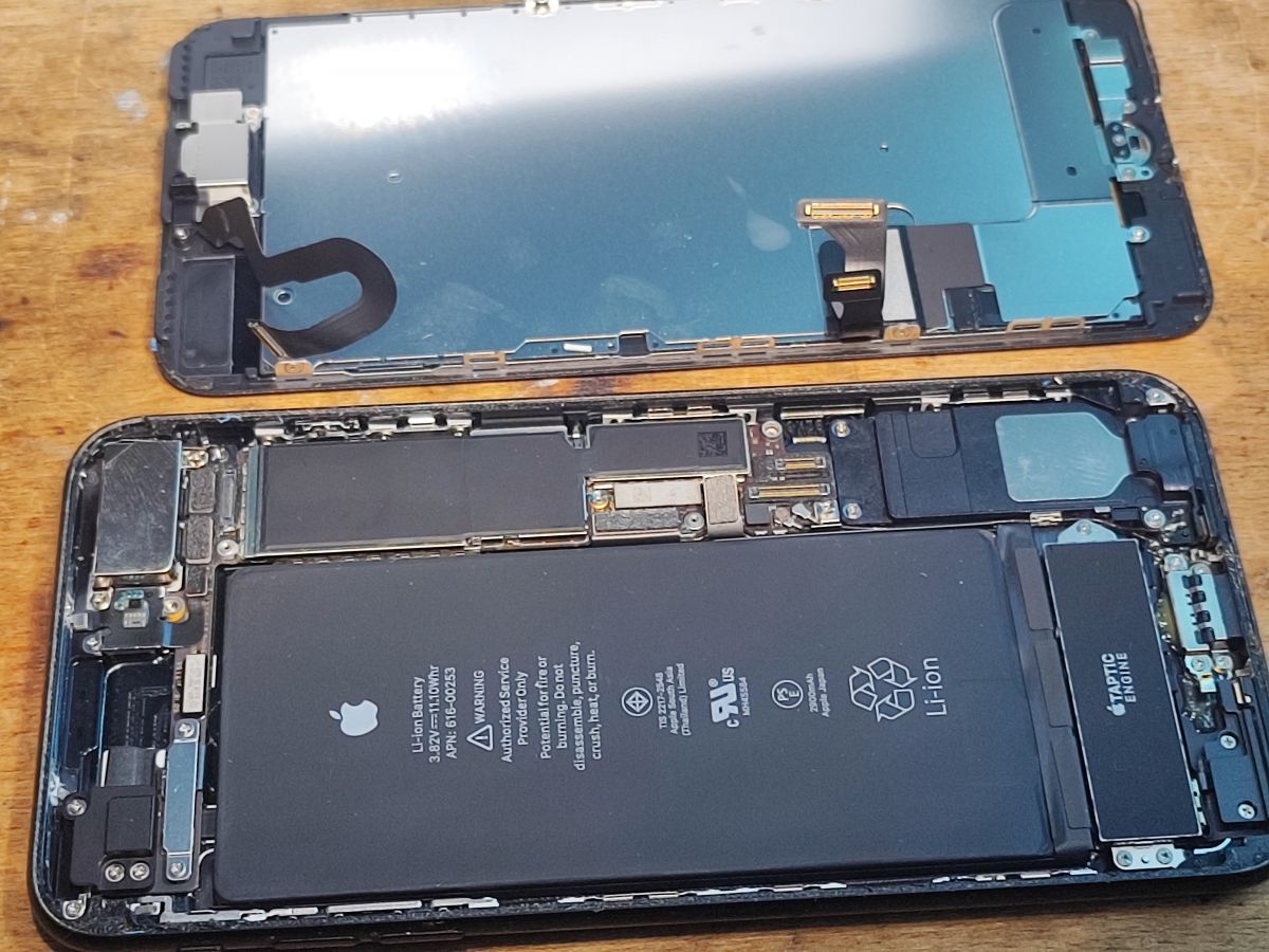

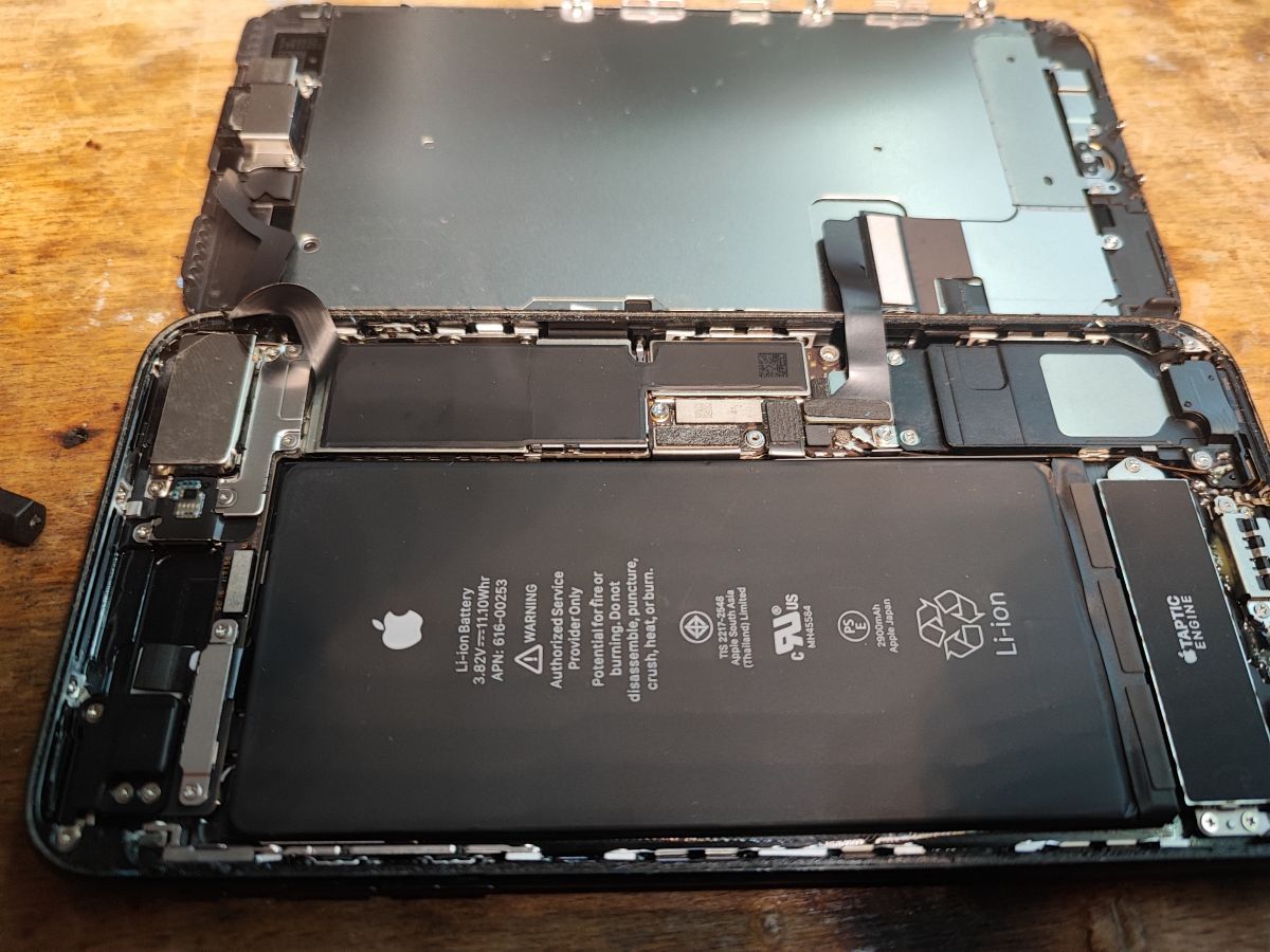

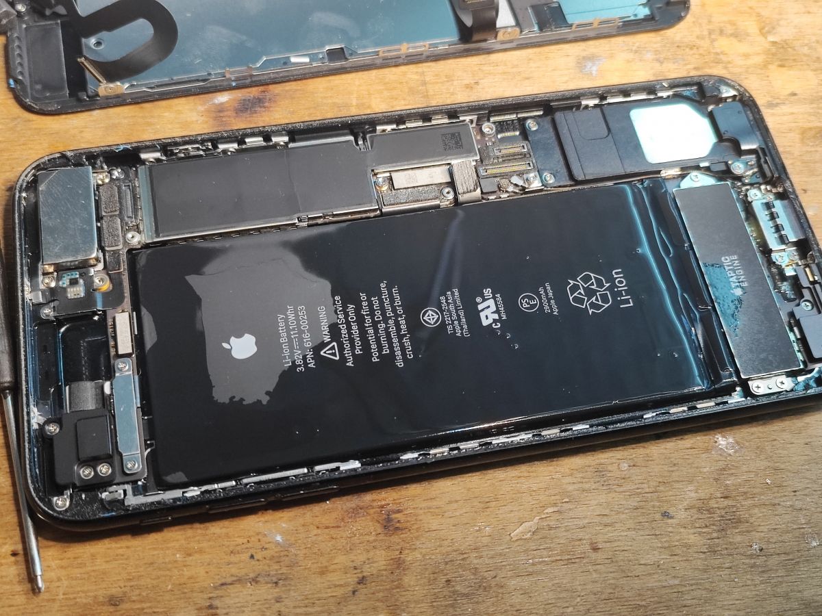

    The screen has been released:
    Open iPhone with exposed battery and detached screen. .
    On the internet, some people here are still unscrewing the Taptic Engine, but I didn't move it.

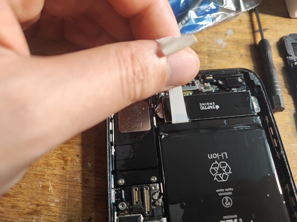

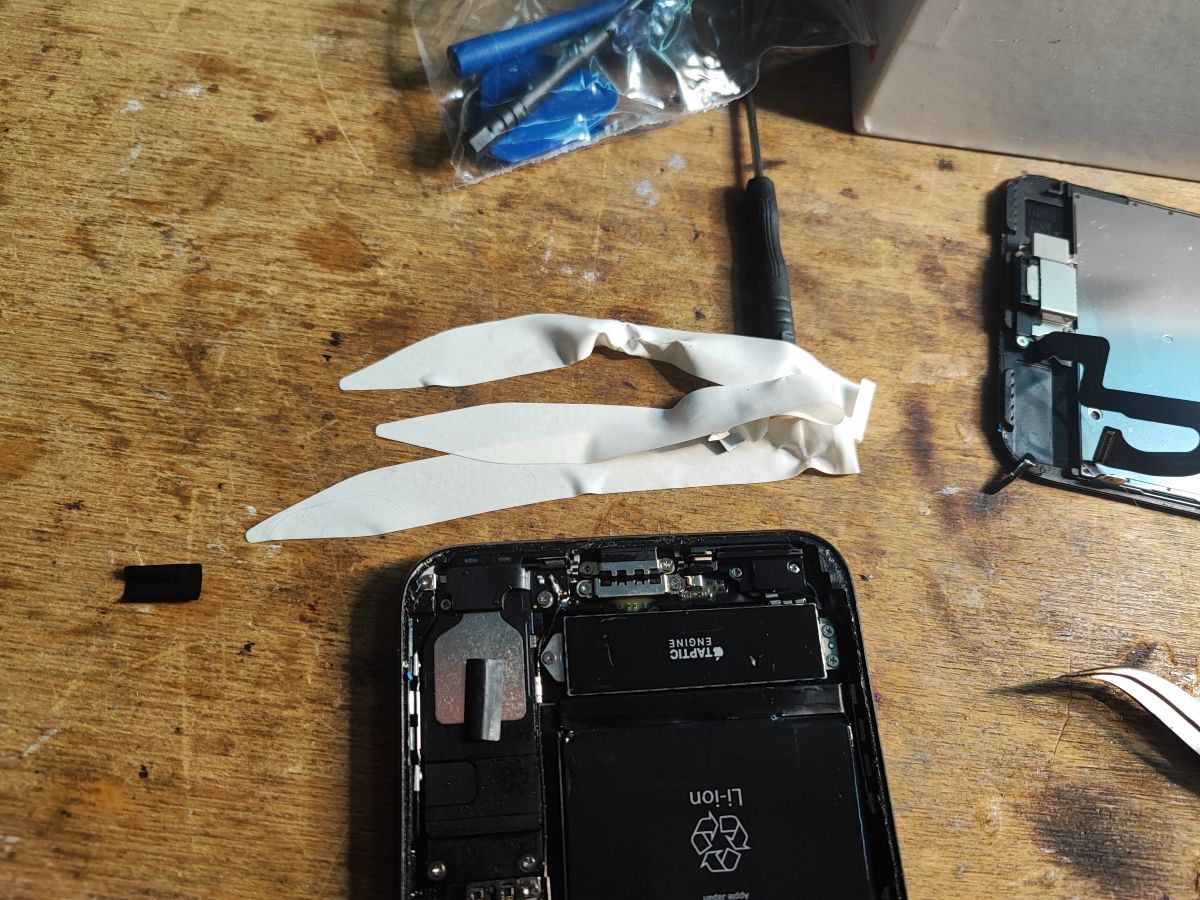

    Now it was time to remove the battery. I sprayed it with isopropyl alcohol, spreading it underneath so that the glue from the three strips of double-sided ribbon let go a bit:
    Disassembled iPhone with exposed battery on a table. .

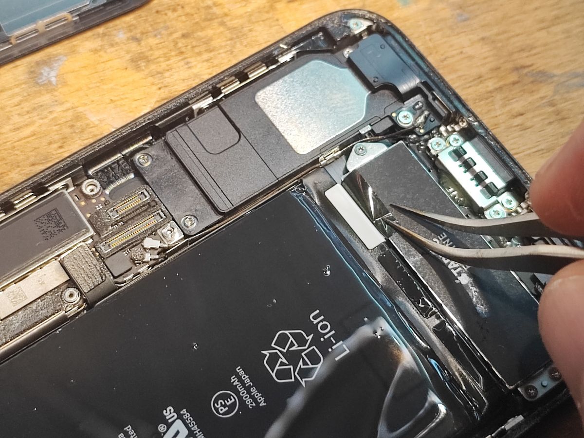

    I then started to remove these ribbons:
    iPhone battery replacement using tweezers .
    Here on the net it was mentioned that they were easy to break off, but in my case nothing like that happened. They rolled up and out nicely:
    Hand holding a strip during iPhone battery replacement. Interior of a disassembled iPhone with a battery being replaced .

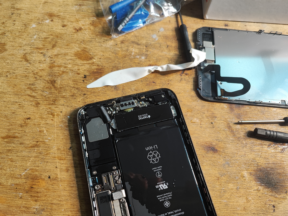

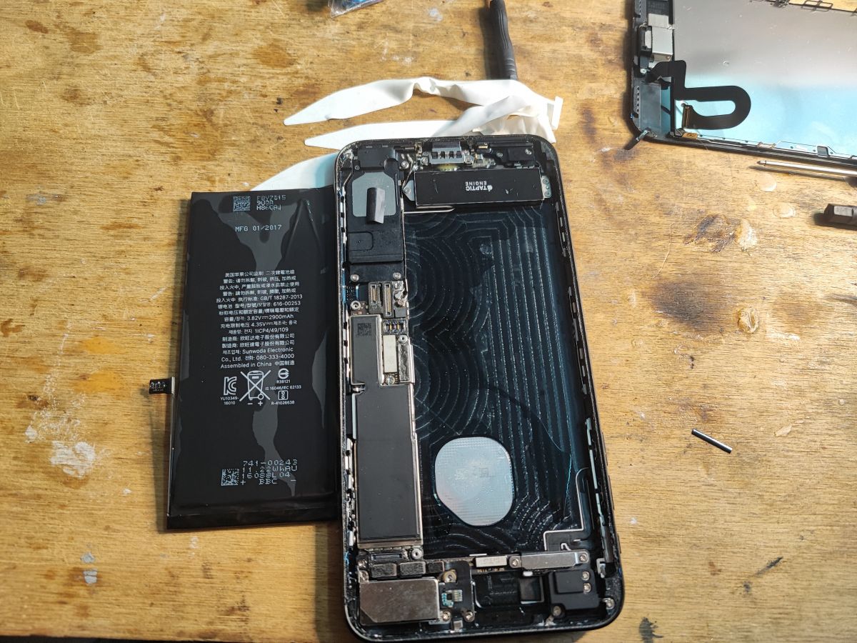

    Please, here are all three in full:
    Disassembled iPhone on a wooden table with visible adhesive strips. .
    The link can now be removed without any problems:
    iPhone battery replacement - view of phone interior .

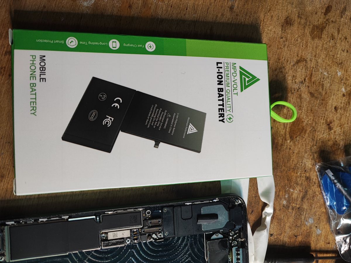

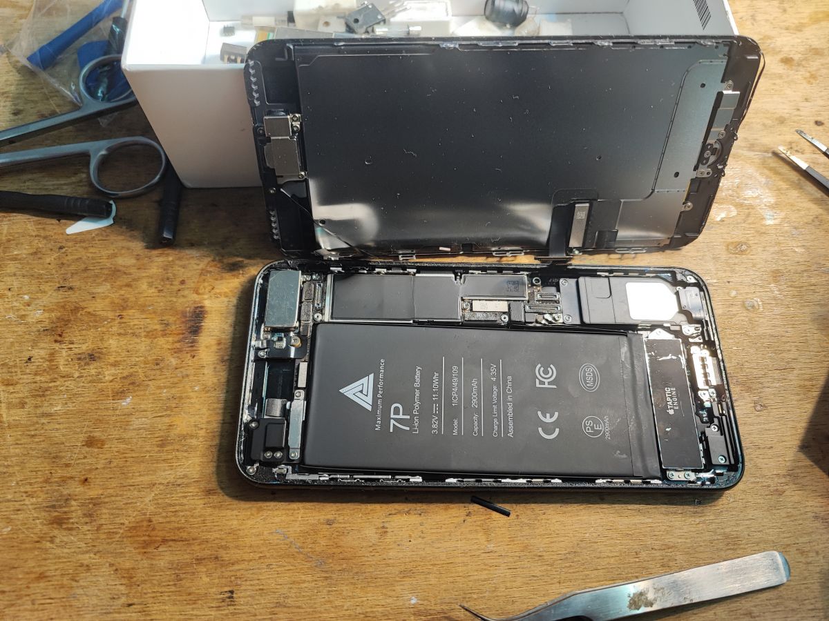

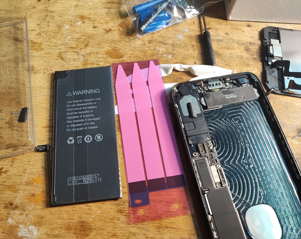

    Replacement:
    Lithium-ion battery replacement kit with a phone missing its battery. iPhone replacement battery with warning label. .
    There is also tape included for the replacement, but it got slightly tangled for me so I only had to glue the battery onto part of it:
    Disassembled iPhone battery and screen during replacement. .
    I attached the ribbons:
    Opened iPhone 7 Plus with a new battery visible and tools on the workbench. .

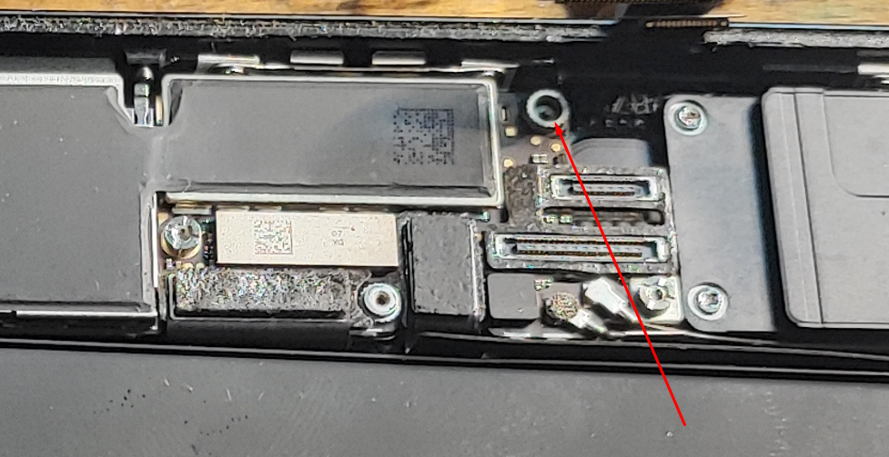

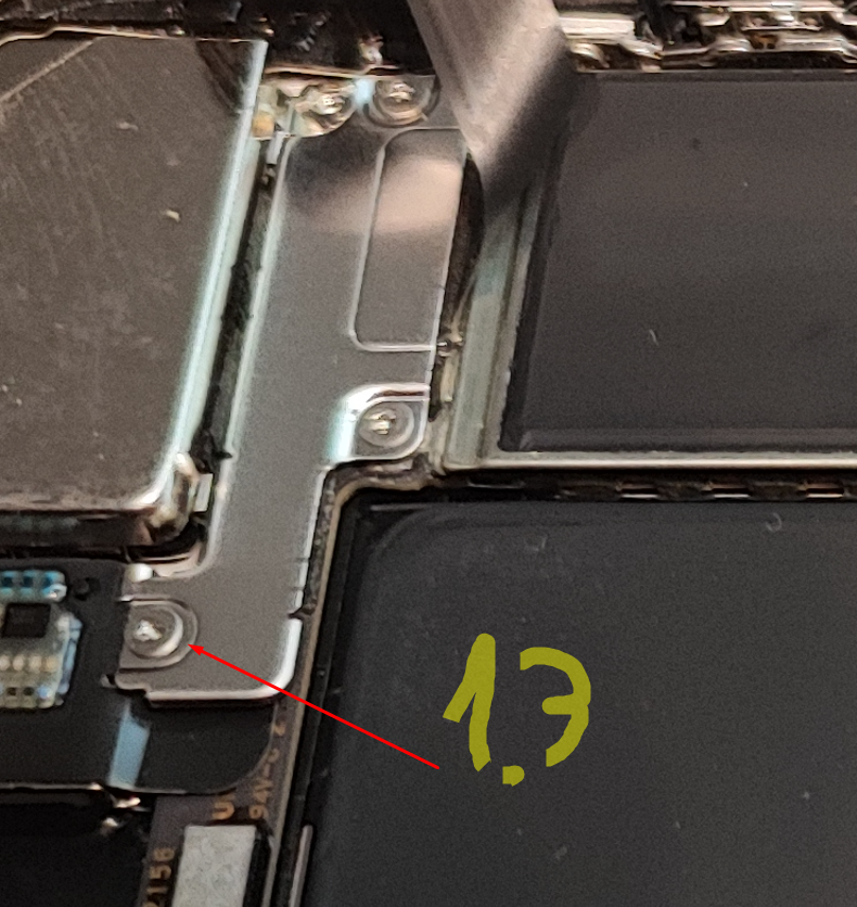

    NOTE: The three screws here are 1.2mm, the fourth is 2.6mm. I have marked the place for the 2.6mm with an arrow:
    Close-up of an open iPhone interior, marked with an arrow. .
    Similarly, here we have two 1.0mm and one 1.3mm:
    Close-up of iPhone interior with marked 1.3 mm screw .

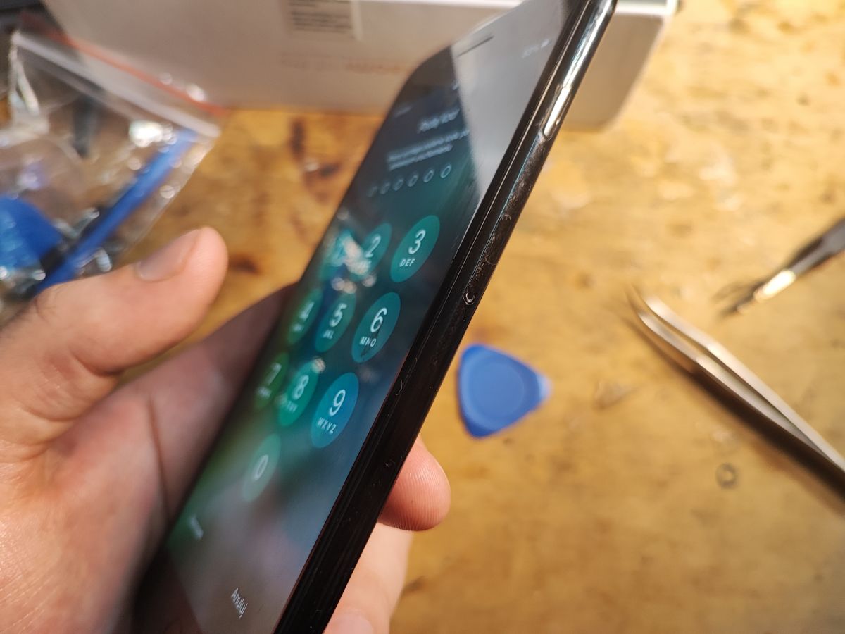

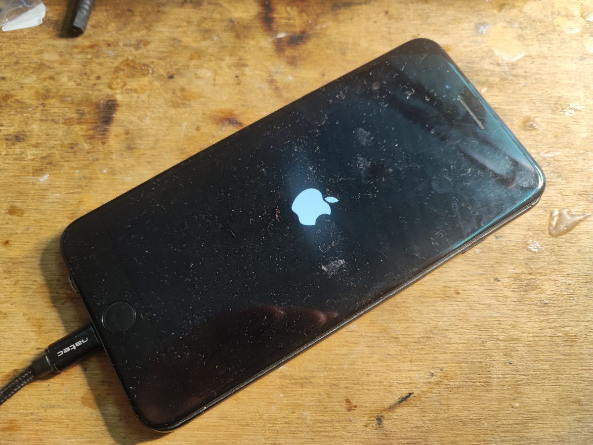

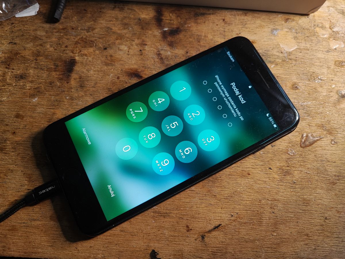

    For now, I fired up my phone for a test run:
    iPhone with display on showing startup screen, lying on a wooden surface iPhone displaying lock screen on a wooden table .
