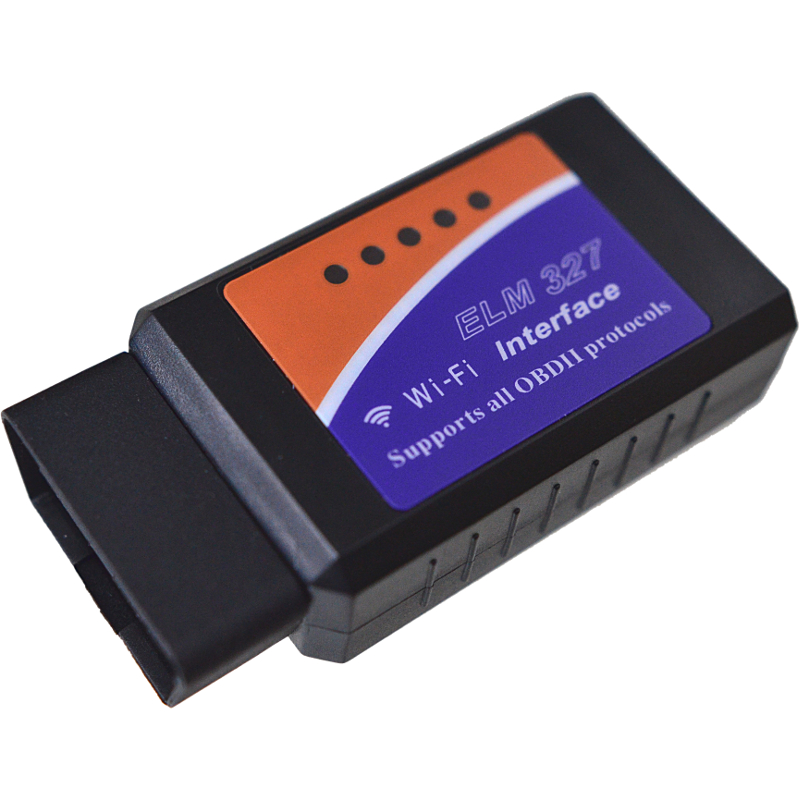

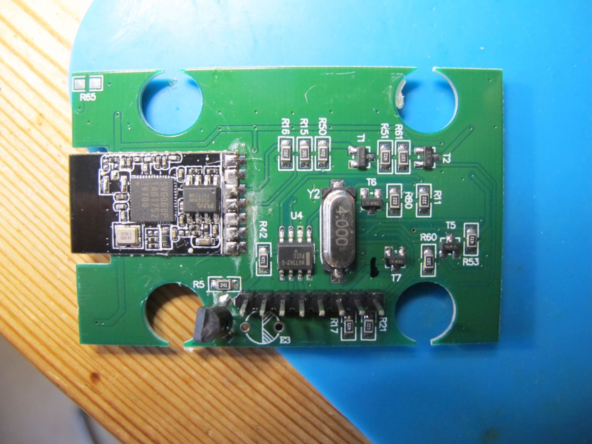

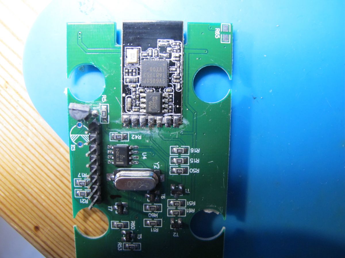

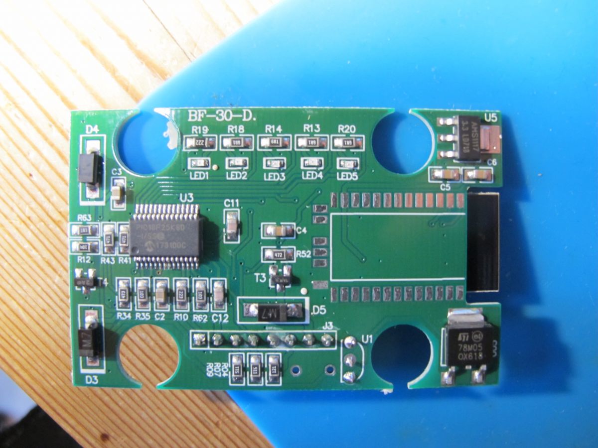

    Just using this as a dumping ground for info relating to the iComm SV6060P MCU inside my ELM327. I was expecting/hoping for a Transa Semi/ESWIN TR6260.
    ELM327 diagnostic interface for OBDII with Wi-Fi support.
    Circuit board with visible electronic components such as resistors, capacitors, and a PH9SFF25K6D chip on a wooden background. MCU iComm SV6060P circuit board inside an ELM327 device with visible electronic components. Close-up view of a circuit board with electronic components.

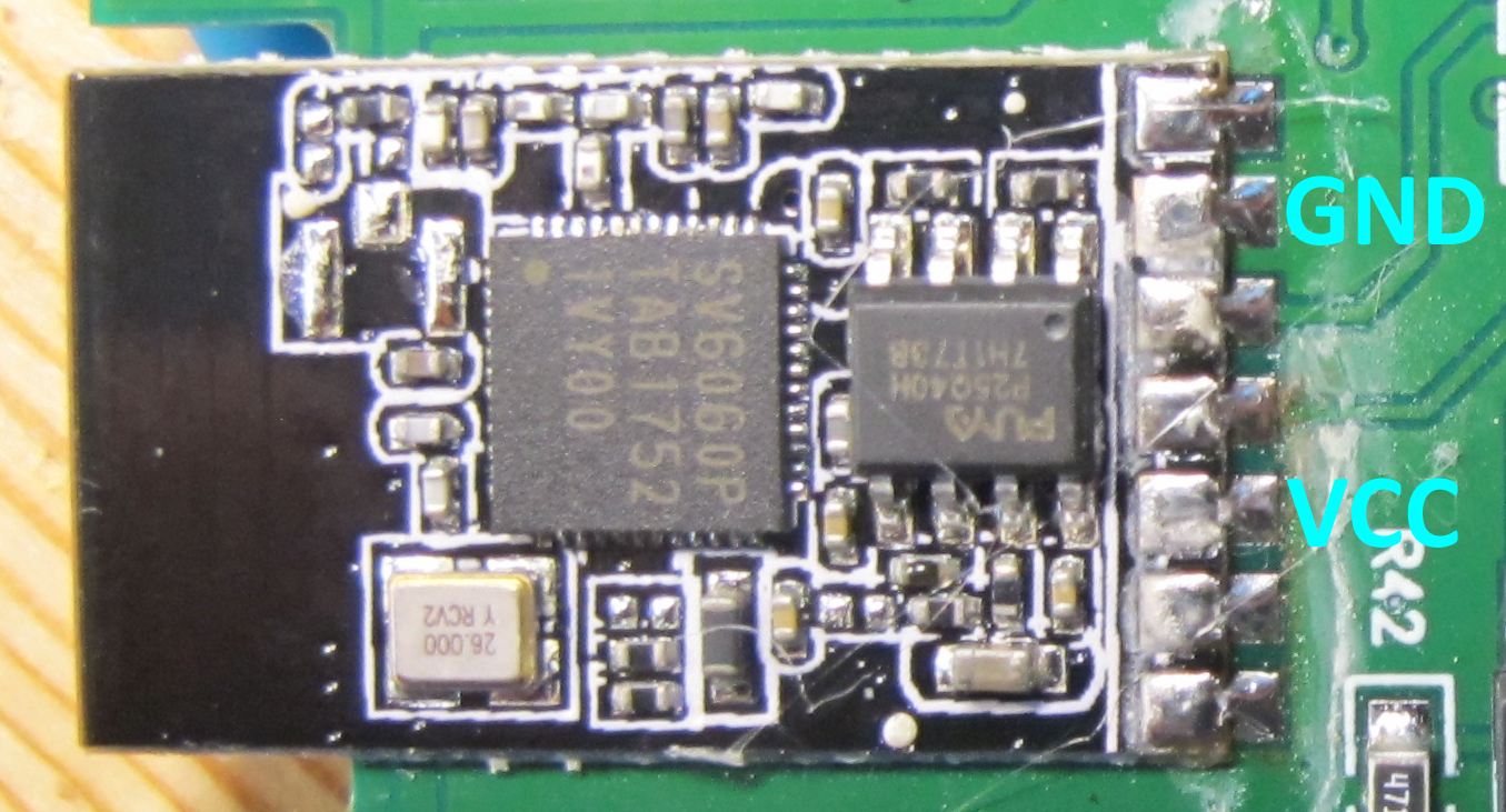

    Close-up of the SV6060P integrated circuit module on a PCB with GND and VCC labels.

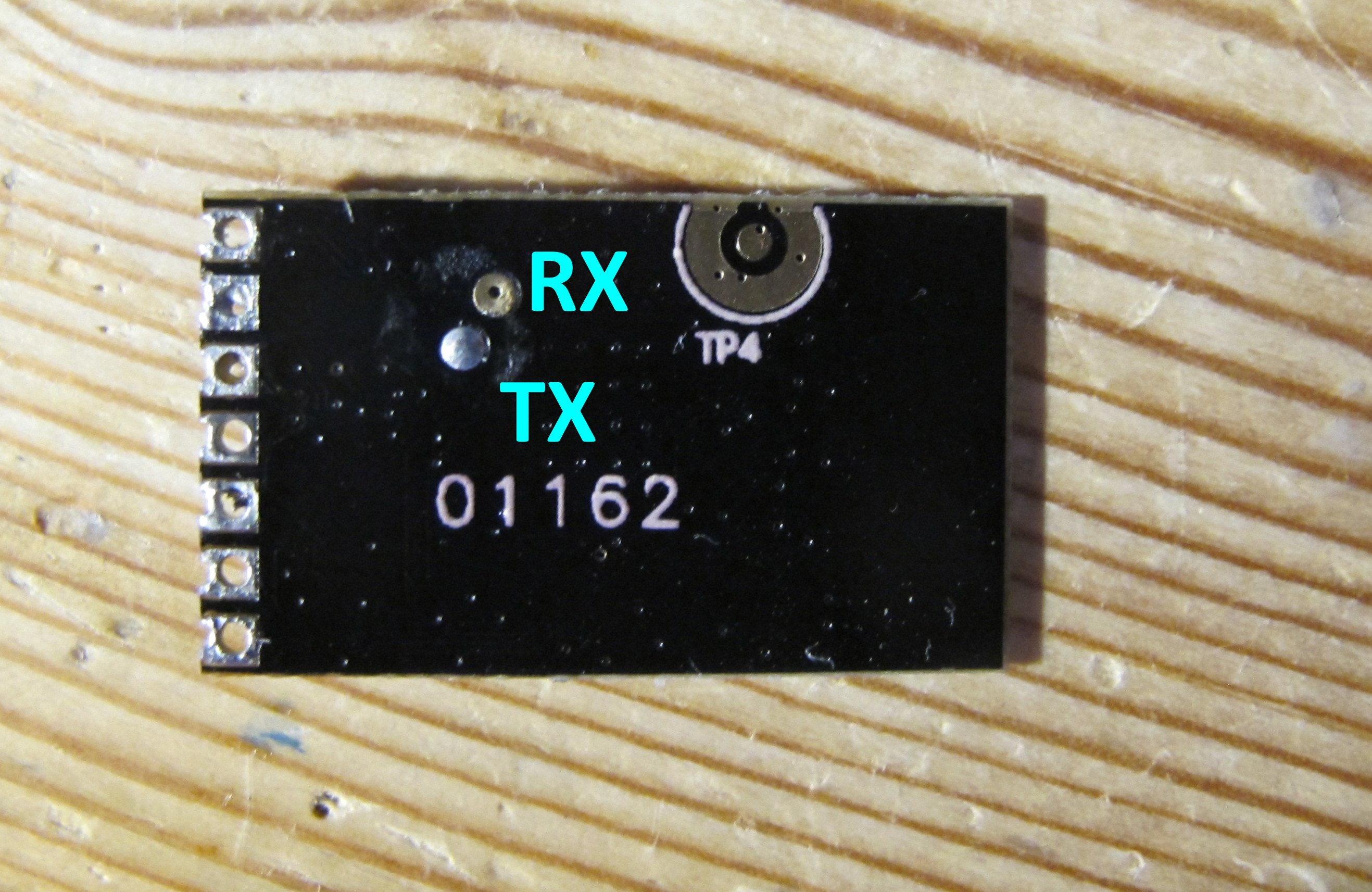

    boot log. 120000 baud
    Photo of a small electronic module with RX and TX markings on a black background.
